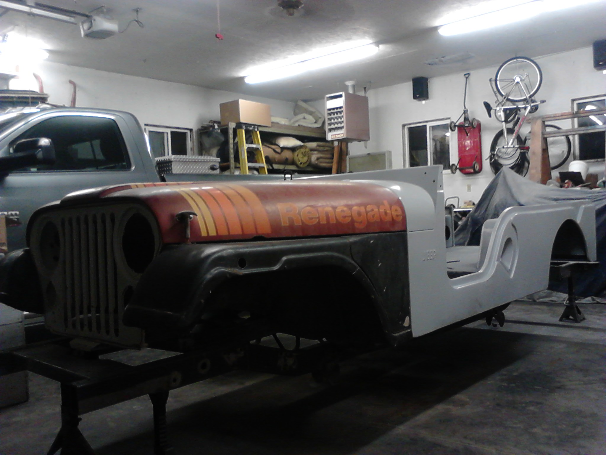

Been working on this for a while. Finally fitting the CJ6 body onto the after market CJ8 frame. Final plans is for a 4bt Cummins under the hood backed up with a NV4500 and a twin stick NP205.
bodywork 88.JPG (386 KiB) Viewed 4816 times

Planning on it being a fair weather daily driver. Hope to get it out west to run some fire roads, and mild trails. Not building it with heavy enough axles for extreme trails, Dana 44 front and 9" Ford rear axle with 33/10.50-15 tires. Have too much time into body work and getting too old to get real stupid!

Figure I'll be around a third of the cost of a new Rubicon and hopefully even get better fuel mileage.. It will have defrosters, if nothing more than for show. Since I'm not sure with all the work I've done to the body if a hard top will fit right, and the only soft top available for a CJ6 isn't the greatest. So it will be topless, not winter friendly.
It's quite the combination of parts with a grill off a CJ5, the body from a CJ6, the hood and roll bar off a CJ7, the frame is for a CJ8, the front fenders are from an unknown CJ model, and front axle is from under a Wagoneer!
