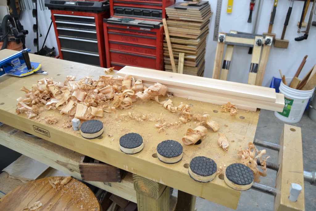

Ah! Hand plane. I have a drawer full, every size and shape. But, I'll have to sharpen them first... so I get out the plane I want to use and take out the "iron"... (blade) and move over to the sharpening table where I keep my water stones. Splish splash... DMT diamond stone... then 1000 grit water stone, 4000 grit stone, and draw it across a leather strop with some honing compound and I'm ready to go. Of course, I had to sharpen the favorite block plane while I was at it. An hour has passed.... :P ... where does the time go?

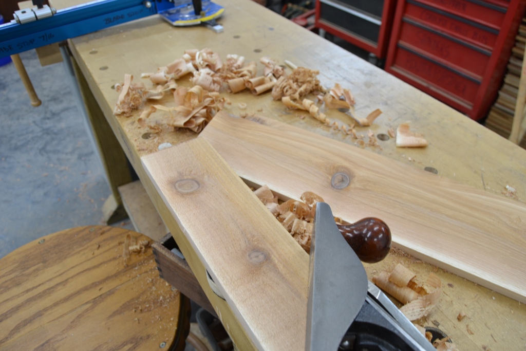

A sharp plane makes the rough face disappear and makes some cool shavings. If you look closely at this first picture, you can see the fuzzy roughness on the board under the plane, and the smooth face on the two I have already planed. This saves a LOT of sanding on the back end.
I planed all four boards, and will be ready to move onto knocking out the rest of my portion of the project after lunch. If the wife decides, I have another cedar board stacked against the wall and can knock out a second group of rests. The projects normally go a lot quicker if you have done them before and learned the quirks. (and the plane is already sharp.)
Check out the pile of shavings and think how much sanding that would have taken. I could have used the desktop power planer, but it screams like a banshee and doesn't give as smooth a finish these days. I need to change the blades. Frankly, I just don't feel like it. :)

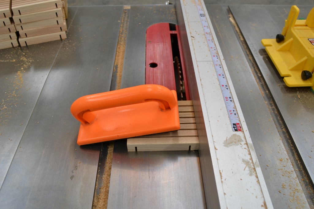

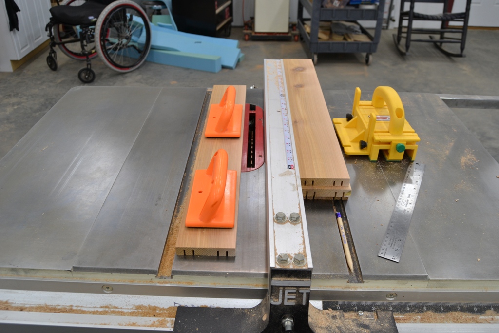

Step one, is to set up the fence at a 1/2 inch from the blade and the blade depth to 3/4 of the depth of the thickness of the wood. Then, run the wood across the blade, spin it and make the same pass again, for all four pieces. This puts the grooves in the wood. I use TWO push pads, and at no time do I risk my hands near the blade. ;)
We perform the process a total of three times, with the blade spaced at 1/2 ", 1", and 1-1/2" and that gives us six evenly spaced grooves. These grooves wick away the moisture from the soap placed on the "soap rest." The initial set up takes as long as making the cuts does. If this was a bulk operation, you could knock out a pretty good number of these things in an afternoon, especially after you had done them for a while. 8-)

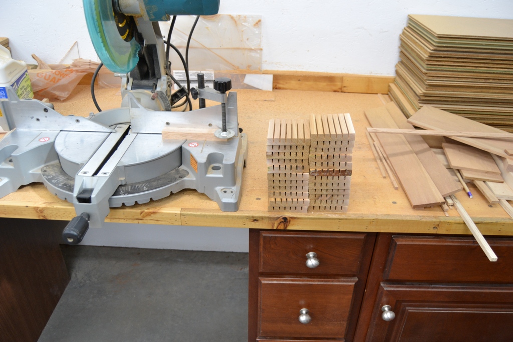

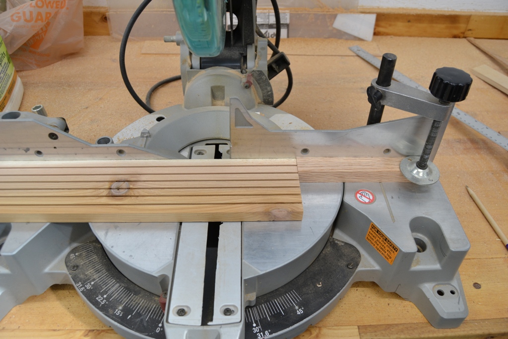

The next step is to set up the miter saw with a stop block at 4" so that you don't have to measure the cuts on the four grooved boards. We want to cut them into the 3-1/2" by 4" rests. Cut, pull and stack, slide to the stop, cut, pull and stack, slide to the stop, repeat til you need a new board.
Well, that worked out really well. :)

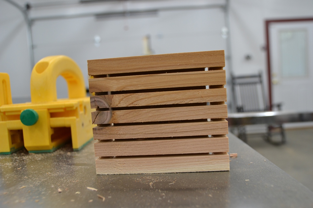

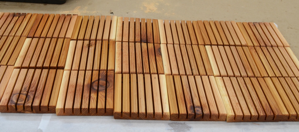

Moving back to the table saw, I set the fence back to 1/2" from the blade and pass the rests across the saw, across the 3-1/2" width, perpendicular to the grooves on the top, making cross cuts on the bottom, one on each end. These cuts are at the same depth as the cuts on the other side, therefore they create dual drain holes in each groove, one on each end. (of course, I used the push pad turned 90 degrees from where it is in the picture, I just turned it that way so you could see the orientation of the "rest." The pad neatly covers most of the rest when you actually make the cuts.

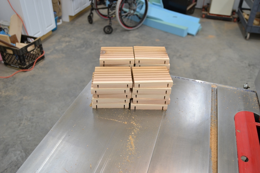

The process went smoothly, and I quickly ended up with a nice pile of Soap Rests. Look carefully at the second picture, and you'll be able to see thru the drain holes. :P

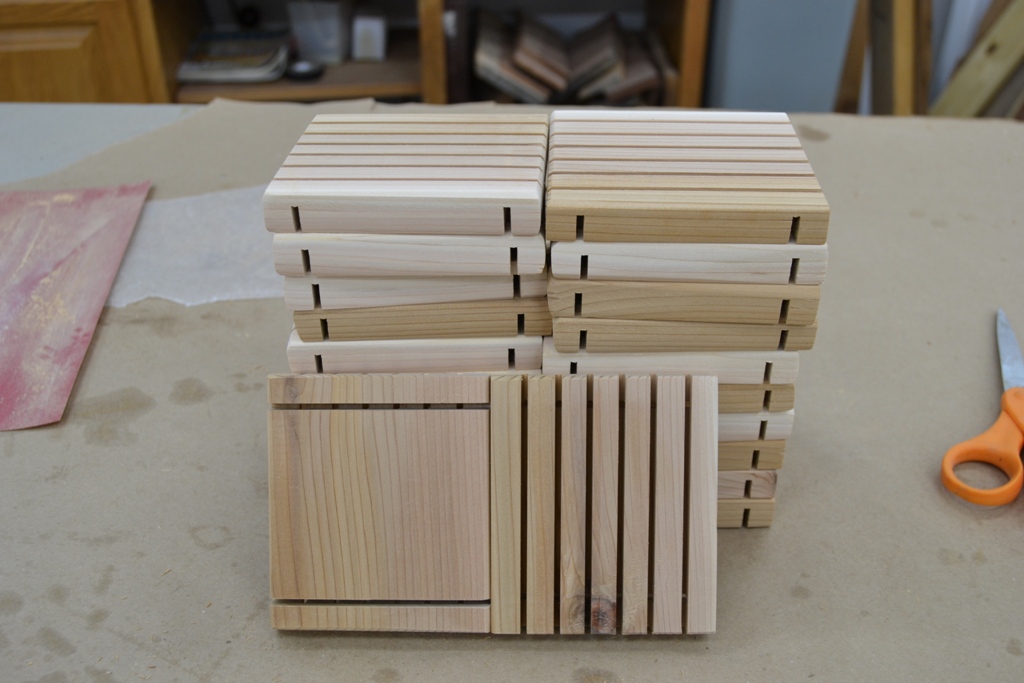

Post by BrokenolMarine » Fri Aug 25, 2017 5:24 pm
Looks like a miniature pallet, doesn't it? ;)

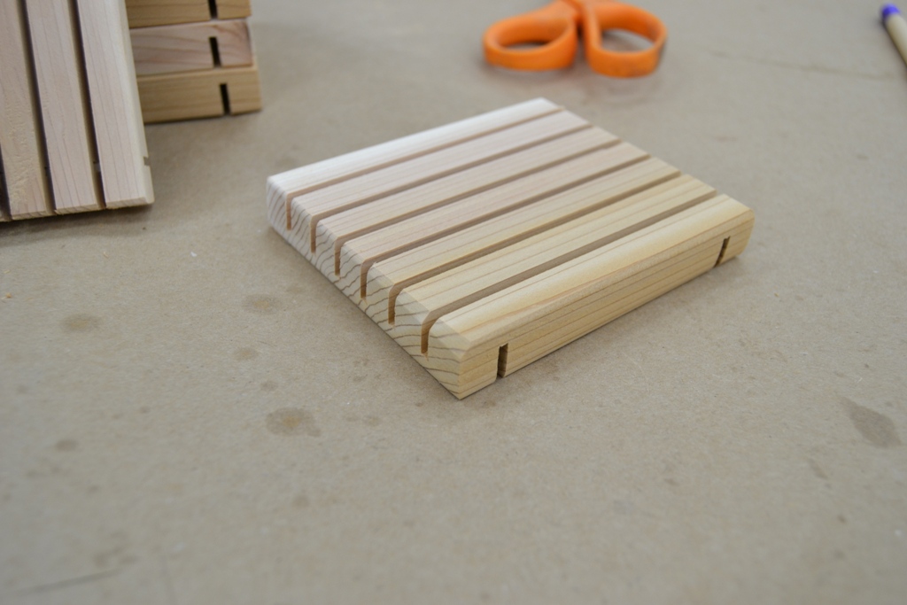

Today's shop time was simple: Sanding, Sanding, and more... you guessed it... Sanding. :shock:
Sand all six faces of the soap rest, then roll the sharp edges.
Done, right? ;)
:evil:

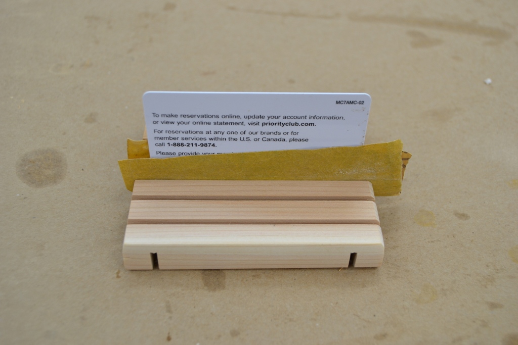

Not hardly... all those grooves have fuzz in them. If you want the job to look professional... you gotta sand inside the 1/16th of an inch wide groove.
:roll: Sheesh... how do you do that? Remember all those fake credit cards you get in the junk mail? I save every one of them. :) They are good for all kinds of things... spreading glue, mixing JB weld and two part expoxy... and sanding tight spaces. Use them and throw them away. More will come in the mail.. free of charge. :lol:
Wrap a piece of sandpaper around it and slide it thru the groove like you are scanning your card at McDonald's... and boom... two or three passes, No more fuzz. :P

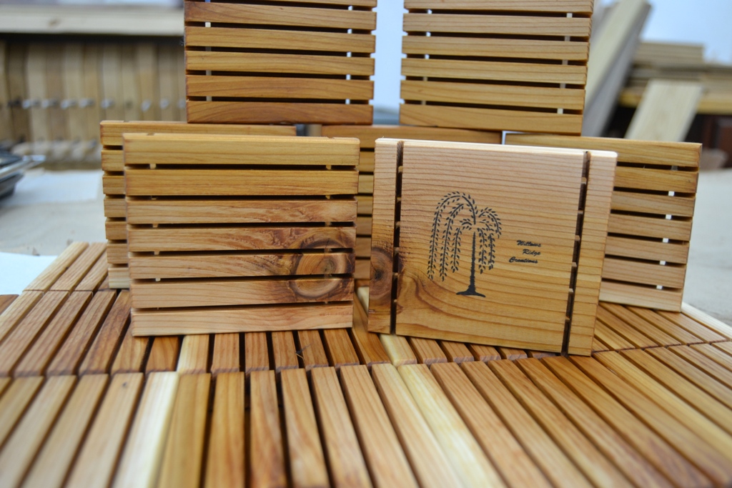

This one is knocked out as well, the finish just needs to dry. When it does, I'll post one last pic for you guys, showing the rest with a bar of her soap laying in place. ;)

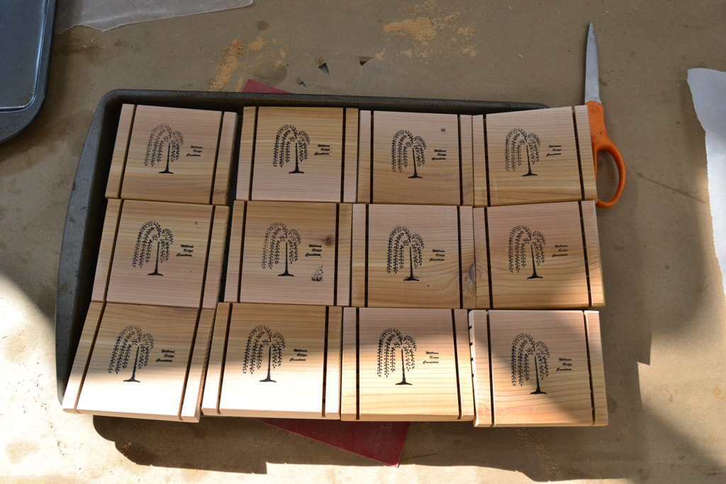

Started out the morning with Miss T stamping her logo on the back of all the waiting rests, and letting them dry for a half hour.
Then I coated them all with Mineral Oil as a finish, it's a food safe coating. Not that I think anyone will lick them, but since the people who use organic soaps are concerned about their health... :roll: A safer finish is what the "boss" wanted. :lol: The finish looks good and lasts a long time. It's what chefs use on butcher blocks.
I used an acid brush to get down into those 1/16" slots, and made sure there was a good coat on everything. All the little soldiers are lined up drying.
