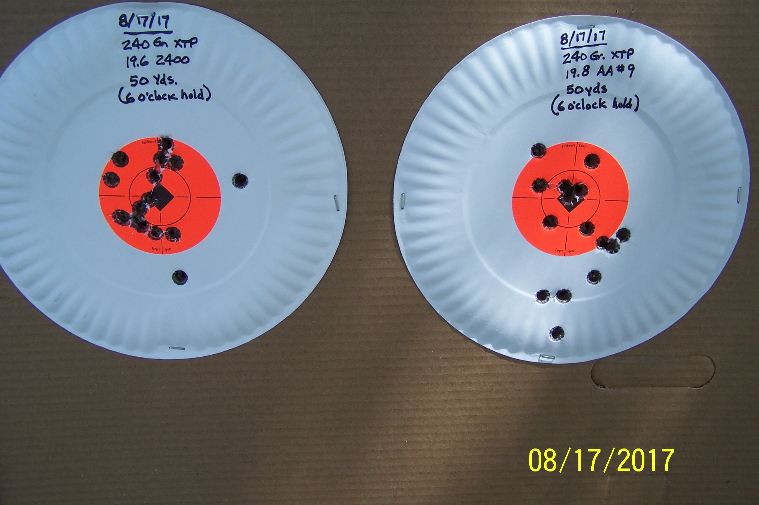

Went to the range to test new .44 magnum load with my standard .44 magnum load. Since I can't find Alliant 2400 powder, I wanted to find a powder and load that would have the same POI at 50yds without having to adjust the iron sights.
Target on the left is 16 rounds using my standard 2400 load of 19.6 grains under a Hornady 240 gr. XTP JHP bullet.
Target on the right is 16 rounds using 19.8 grains of AA#9 under a Hornady 240 gr. XTP JHP bullet.
I am pretty satisfied that this load meets the POI I wanted but the 2400 seems to group better (but it could be the shooter not the powder)

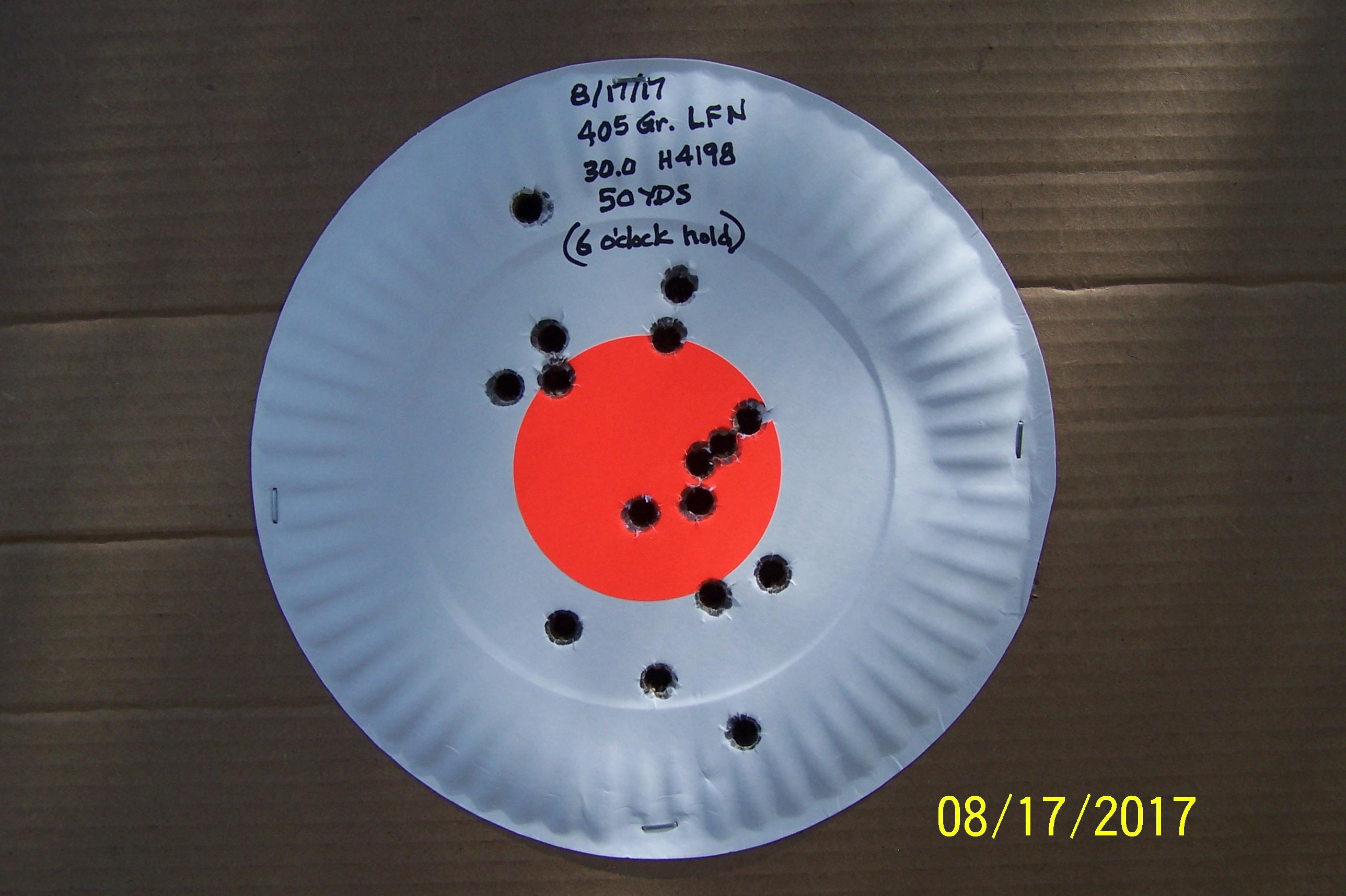

Also took the .45-70 just to check out my set up at 50 ydas. My standard load is 30.0 grains of H4198 under a MB 405 grain LFN bullet.

On the basis of this one test, I would conclude that your standard load is the more accurate load unless your shooting was really way off with the other load. Might want to give it another try, though, just to be sure.

not bad at all .... were the targets above fired from a rest :?:

I was resting the rifles on my range bag.
With my old eyes, at 50yds the 3" orange dot is quite small. The front bead sight (1/16" bead) will completely cover the orange dot - that is one reason I use the 6 o'clock hold. I am using a Skinner barrel mount peep sight on both of these rifles.

Nothing wrong with using a rest when testing ammo... eliminates some of the shooter induced variation from the test. Good shooting.

A range back isn't a very good rest either. I have had groups cut in half by using a firmer rest. Sandbag, shooting rest, even a hand between the gun and a log. Hard rests and too soft rests both hurt repeatability.
