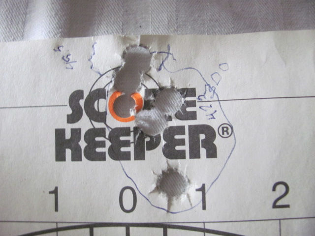

while I load 300, 400, 405, 430, and 500 gr bullets for our 45-70, for deer hunting my plan is to use Nosler's 300 gr ballistic silver tip bullets .... pushed by 51.5 gr of IMR 4198 our chrony consistently shows 2225 +/- .... they have a pretty flat trajectory out to 100 yards .... I haven't had an opportunity to fire them at 200 yards but according to the tables, if zeroed at 200 yards it would be about 5" high at 100 yards

Post by BigAl52 » Sun Aug 13, 2017 9:43 pm
Jim
Id like to see some of your groups with that 300gr Nosler. I see some of those on sale at Shooters Pro Shop I was thinking about maybe ordering some. Al

Post by JEBar » Sun Aug 13, 2017 10:09 pm
BigAl52 wrote:Jim
the only one I have right now is shown below .... the two bullet holes on the left were loaded with 49.5 gr of IMR 4198 .... the three on the right were loaded with 47.5 gr .... distance 35 yards .... they were fired when I was messing with our Chrony so I wasn't fully concentrating on grouping .... I hope to load some more tomorrow or the next day but I'm due for knee replacement surgery a week from tomorrow .... my next week looks like it will be pretty busy and I have no clue how long it will take after the operation so I have no clue when I'll get back out there
