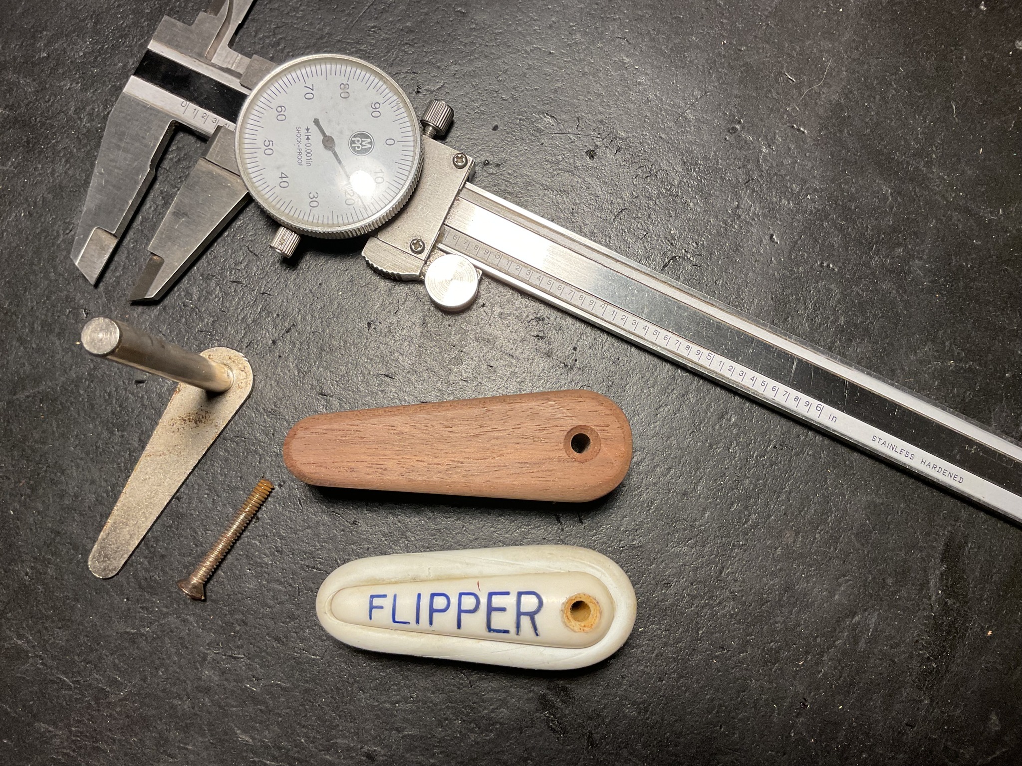

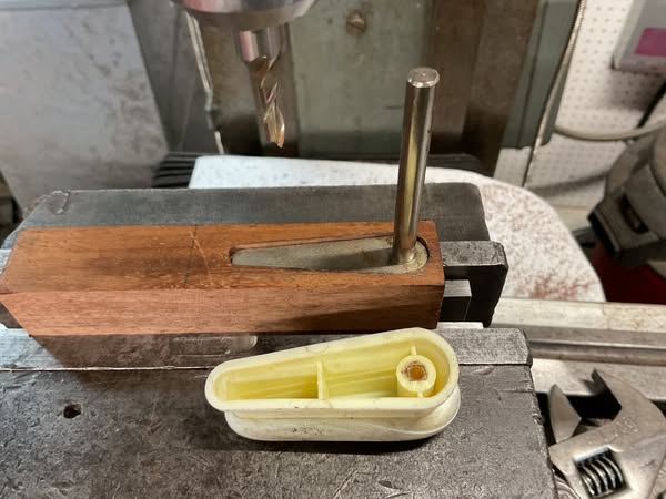

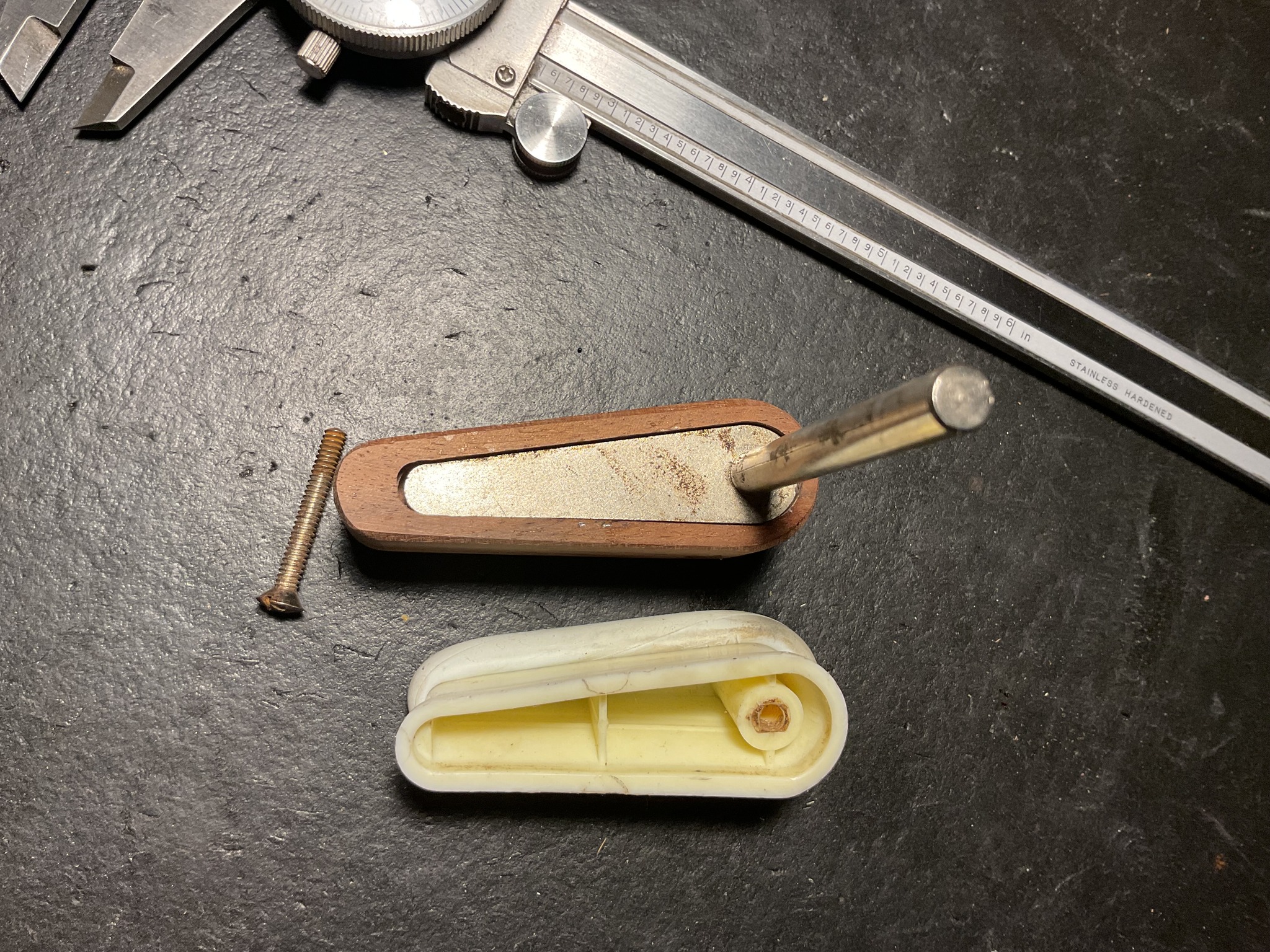

On my Kicker pinball machine I wanted to try a flipper 1/4 inch longer to try and catch a few of the balls headed down the center to the exit. This game makes you work hard to gain points which is fun and frustrating at times. Of course can't find anything like that so off into my shop with a piece of walnut I had and into the mill. After precise measurements and some good guessing had to mill pocket for it to locate on the flipper base.

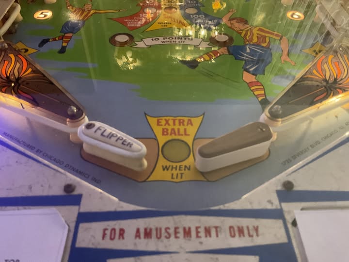

After machine work done and some finishing I added several layers of white plastic tape to act as a bumper and blend in with the white.
Turned out well and did help catch a ball or two and the flip action was improved after adding a new shaft bushing as it was dragging a bit with the original flipper. Thinking of making another one for the left side which would still leave plenty of free space for ball to go between both flippers but give me a edge on catching a few more gutter balls. :lol:
