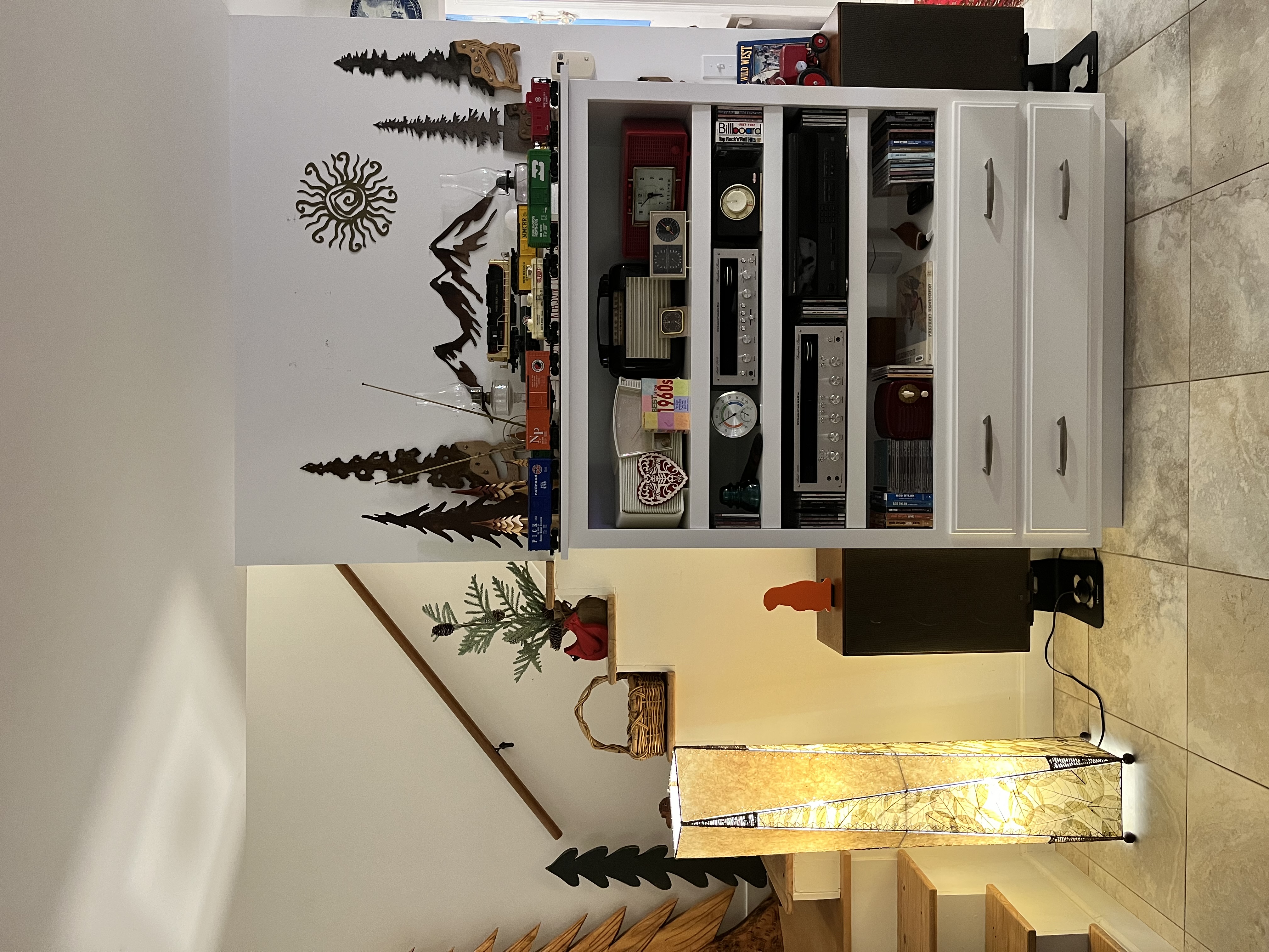

Post by Sir Henry » Mon Jan 20, 2025 7:05 pm

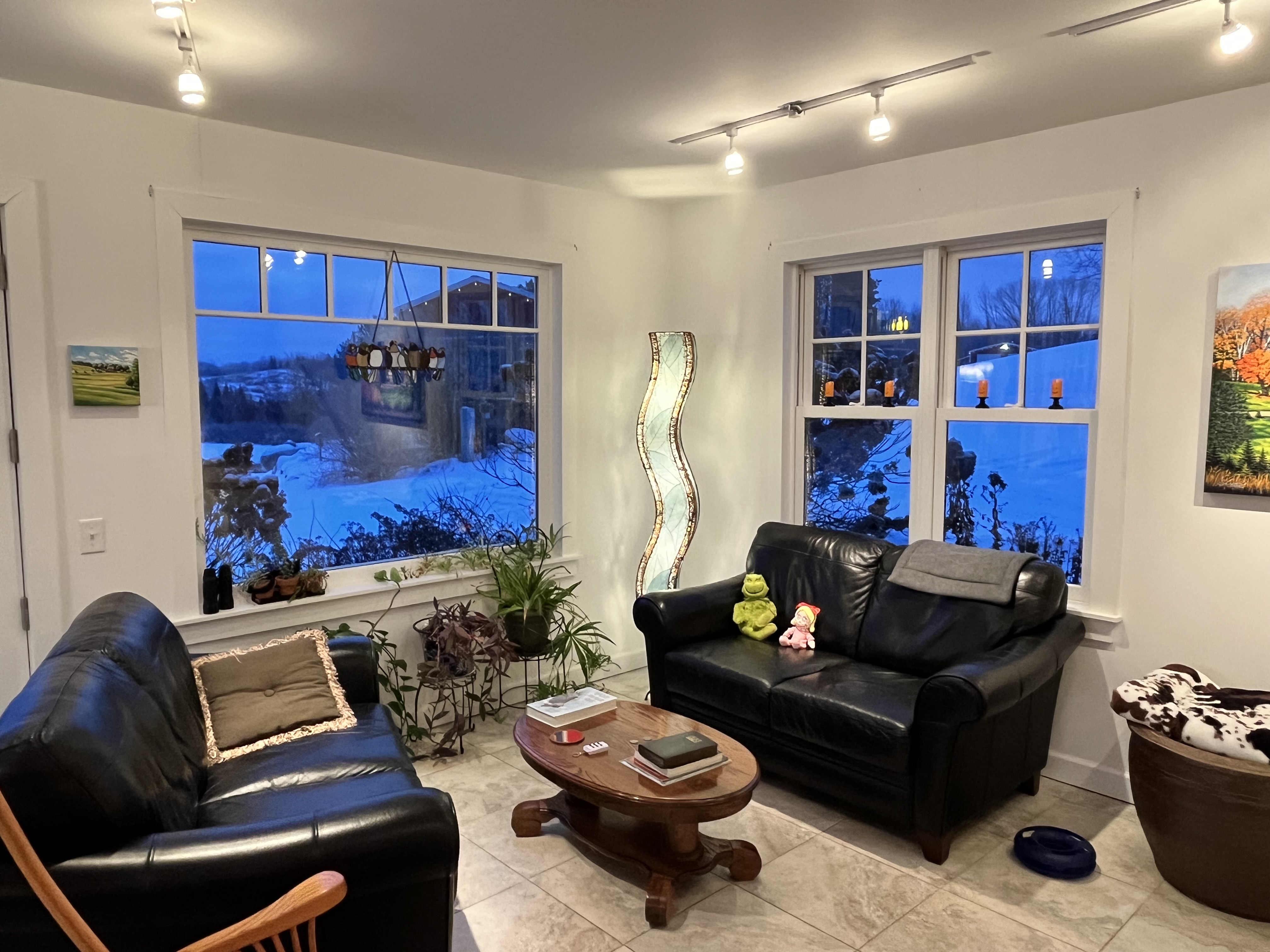

On Wednesday I’m have an electrician come and install track lights to illuminate two walls and provide theatrical lighting over the loveseats.
I’ll have ceiling tracks to illuminate these two walls.
Each wall will have its own track and be on one switch.
Then each loveseat will have a track directly over them and they will both be on one switch.

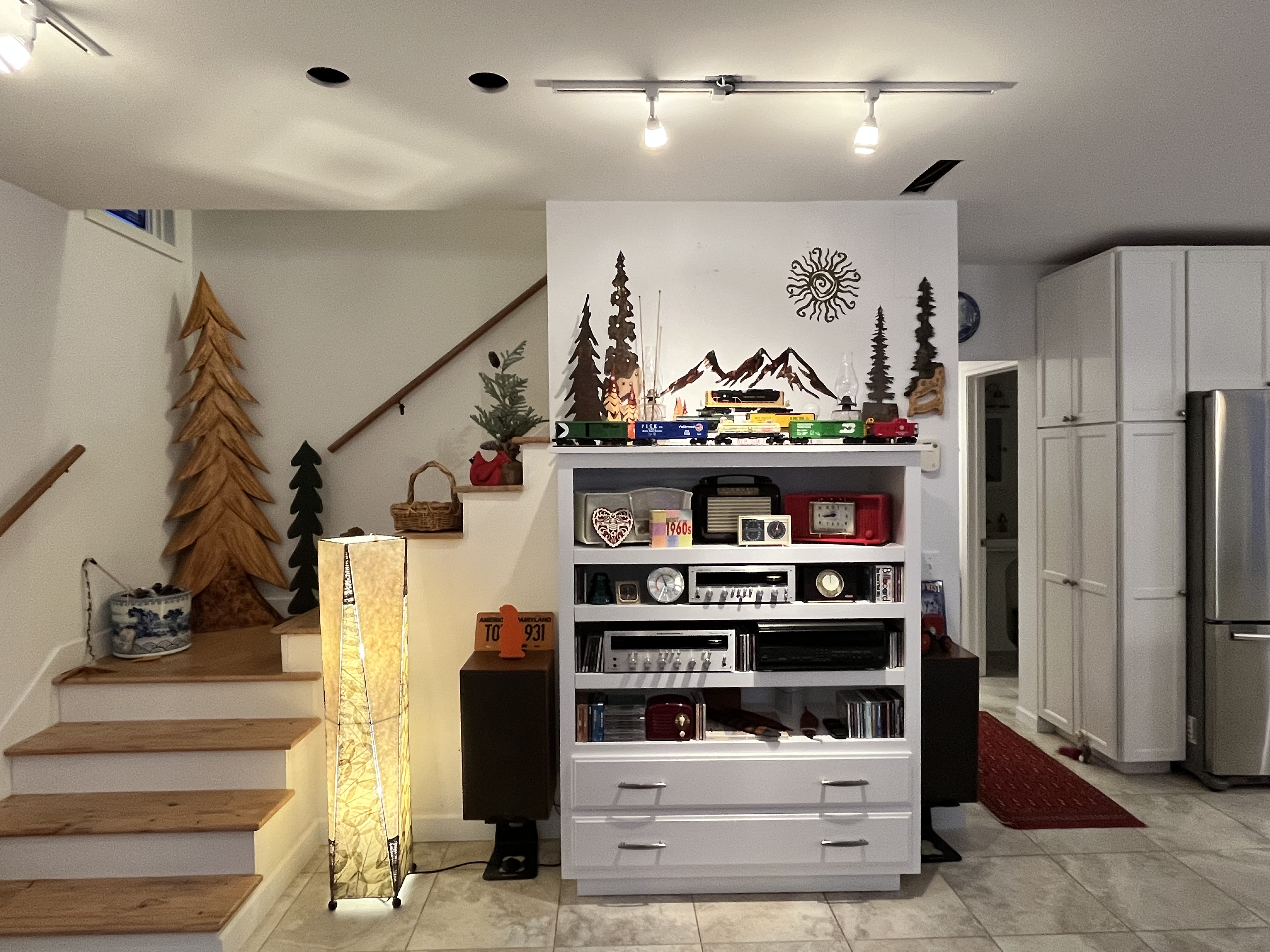

Those tree art pieces made from old saws are wonderful.

Your home is beautiful Gene! and I might add, tastefully decorated. 👍👍

They are my favorites too.
Tue Jan 21, 2025 11:59 am
It’s a modest house but people like to visit. I’m always getting new stuff and people want to know the latest thing I’ve drug home.

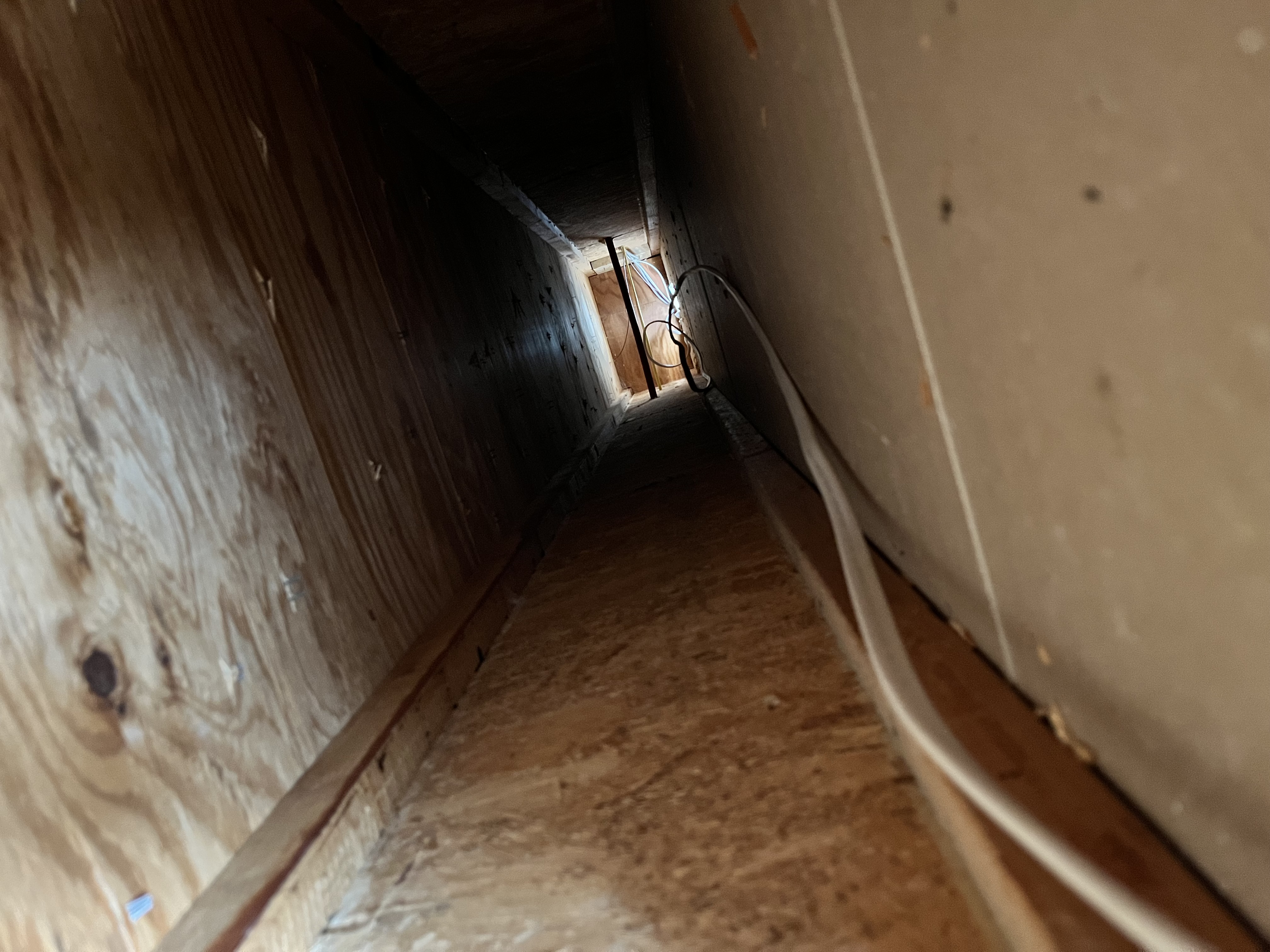

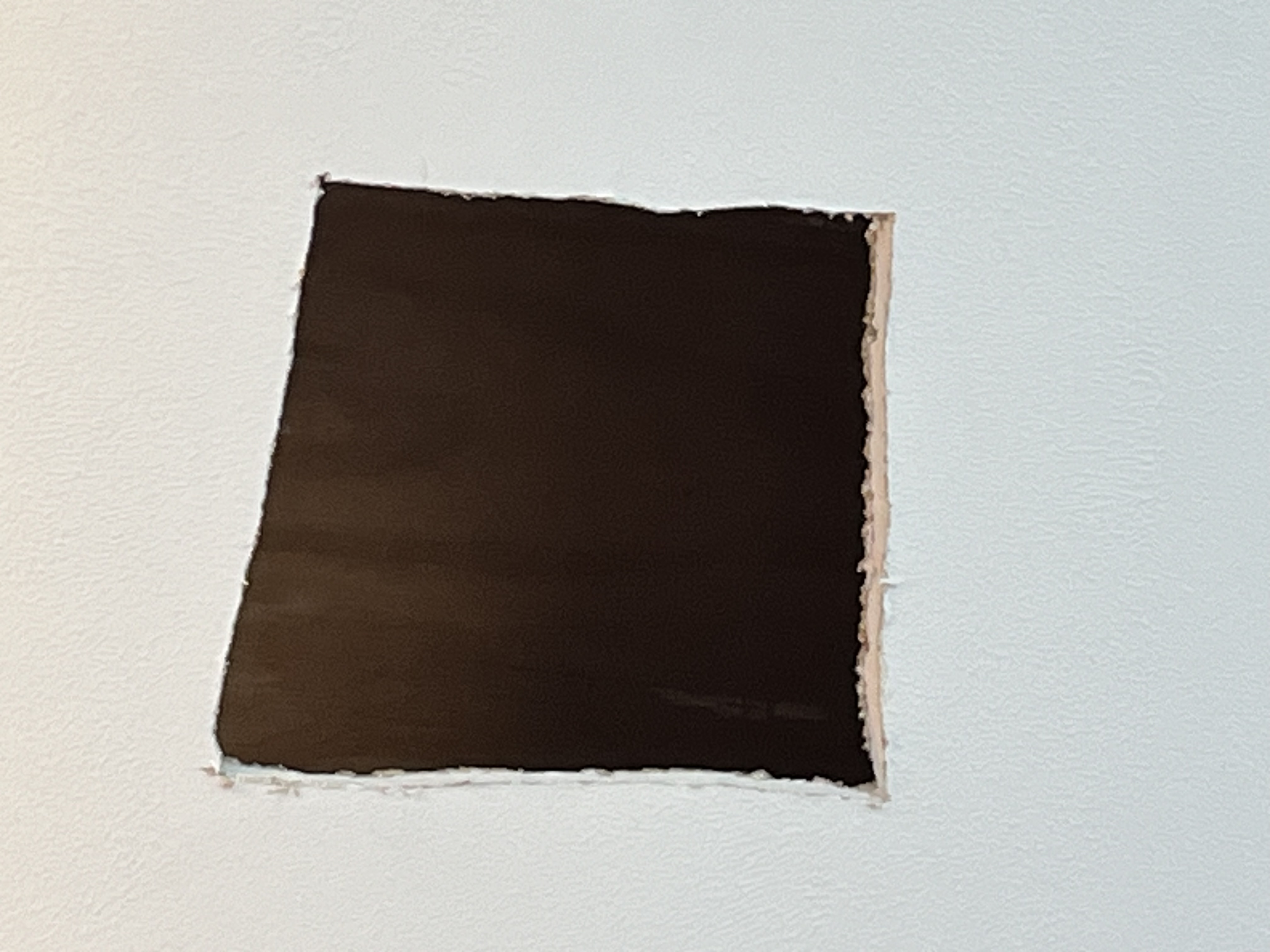

Post by Sir Henry » Wed Jan 22, 2025 12:39 pm

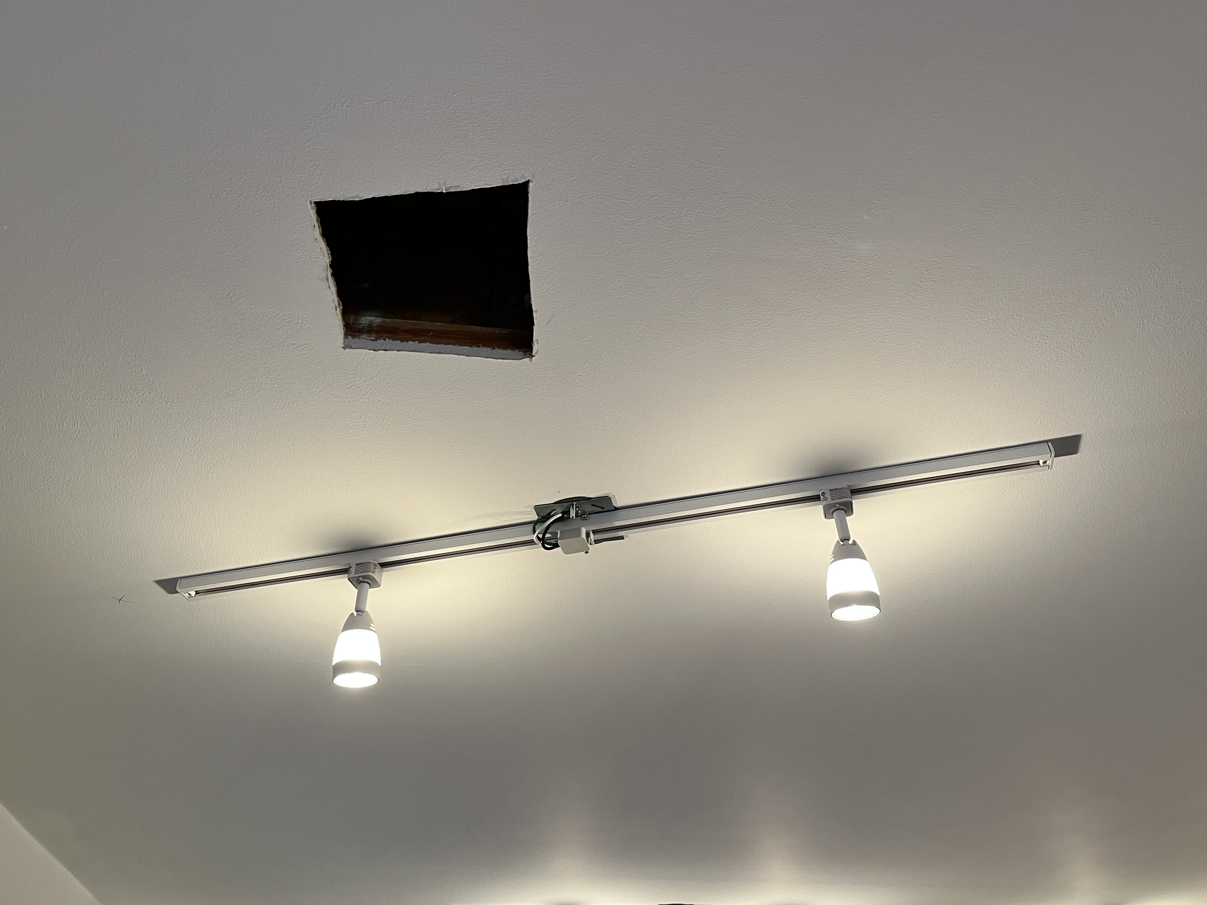

The electrician is here. He had to remove some Sheetrock for access. I’ll be doing the drywall after he leaves.

Post by Mags » Wed Jan 22, 2025 1:37 pm
I think your electrician over did it on sheet rock removal. We had similar work done and the electrician used a 6" hole saw bit on the wall and ceiling. Then used a right angle drill and auger bit to poke holes in the wall top plate. Very simple, less obtrusive sheet rock repair as a result.

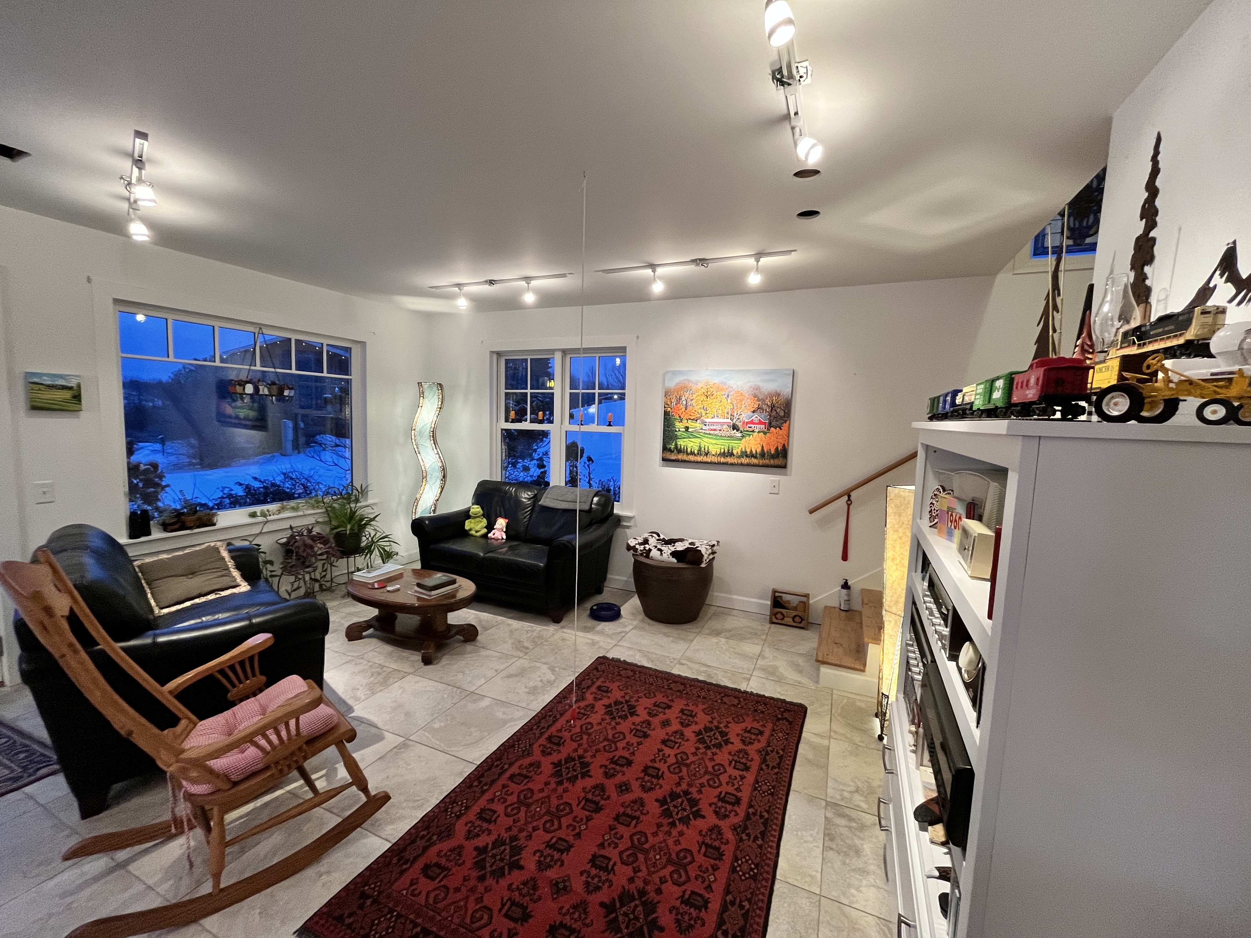

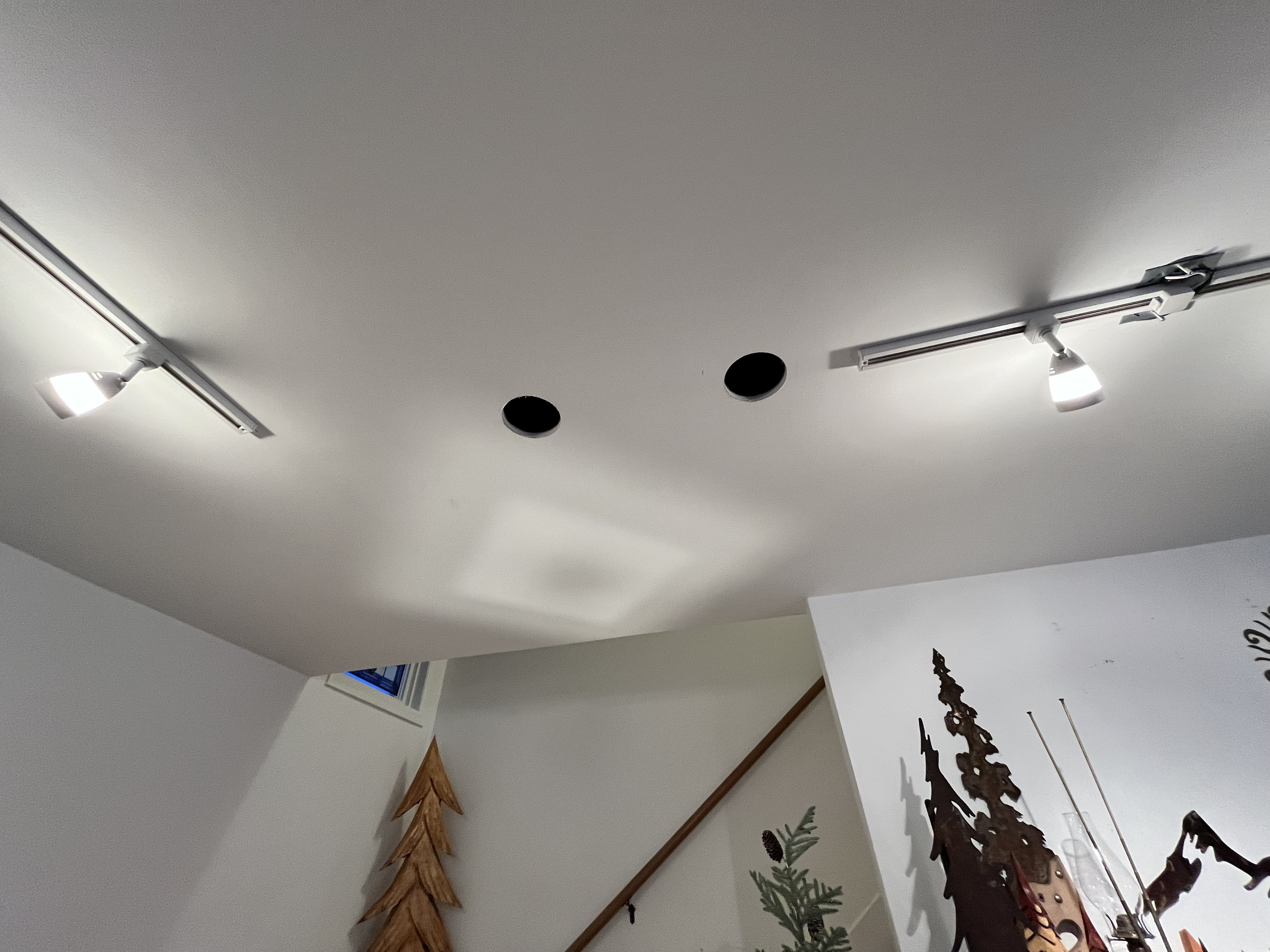

Post by Sir Henry » Thu Jan 23, 2025 8:29 am

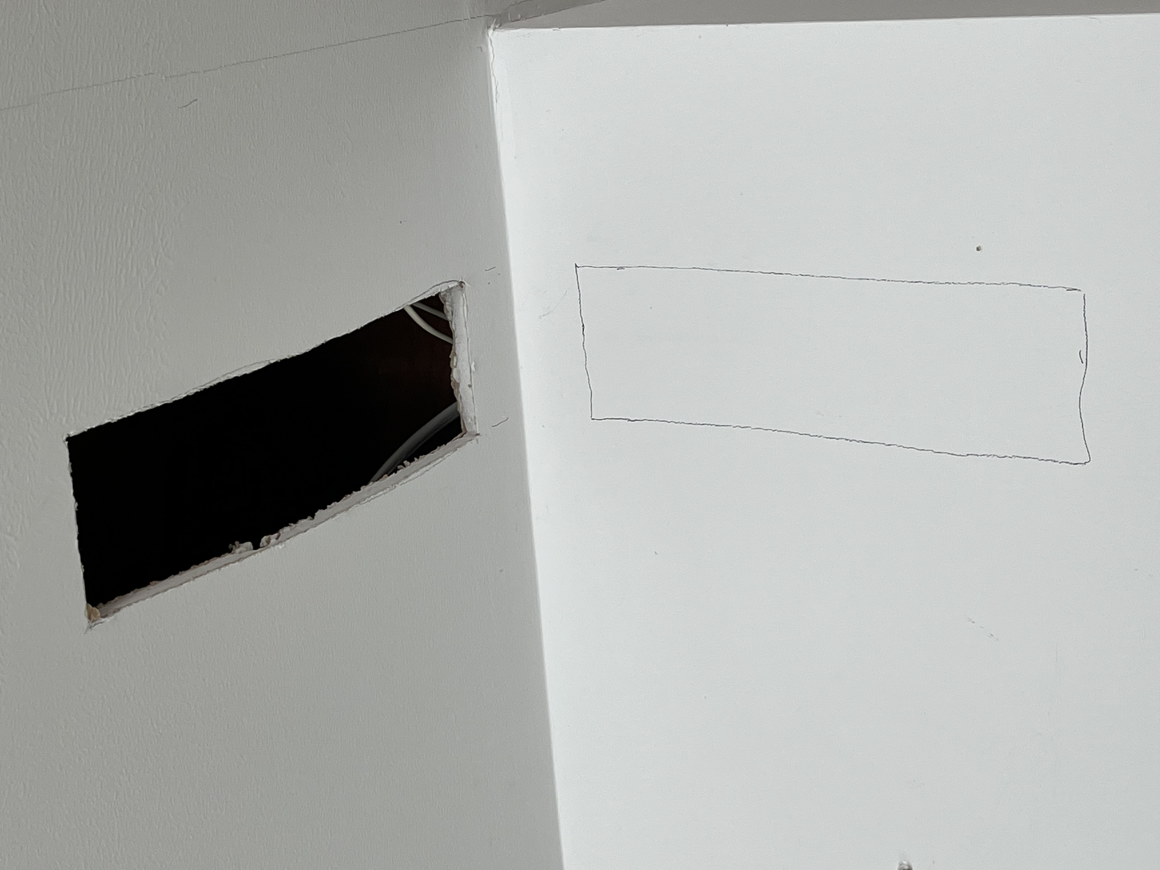

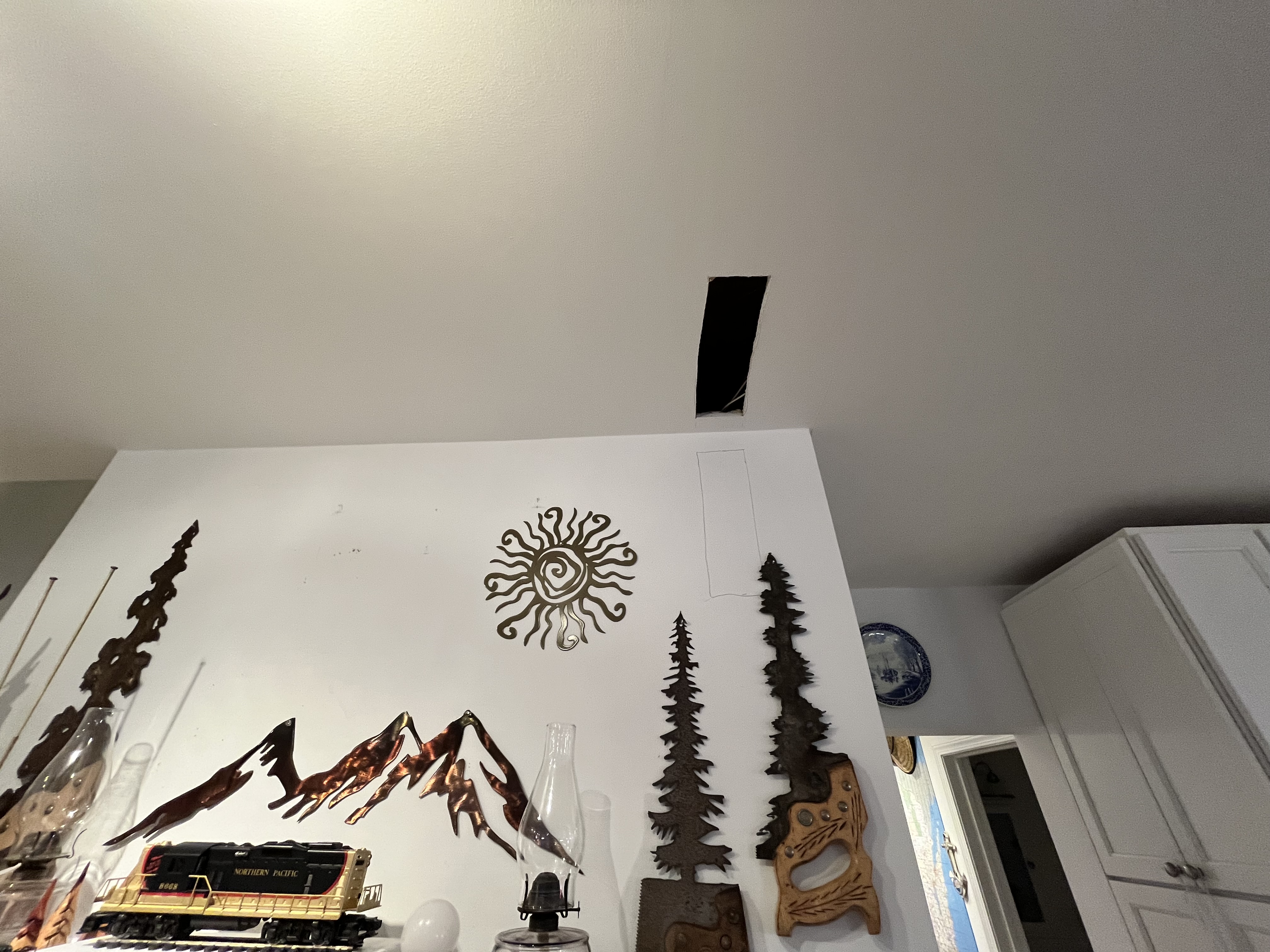

That was the first holes to see what was up there Once he knew he drilled smaller round holes. This was the first.
The second
Then the are small. Remember he had to get a drill up through it.

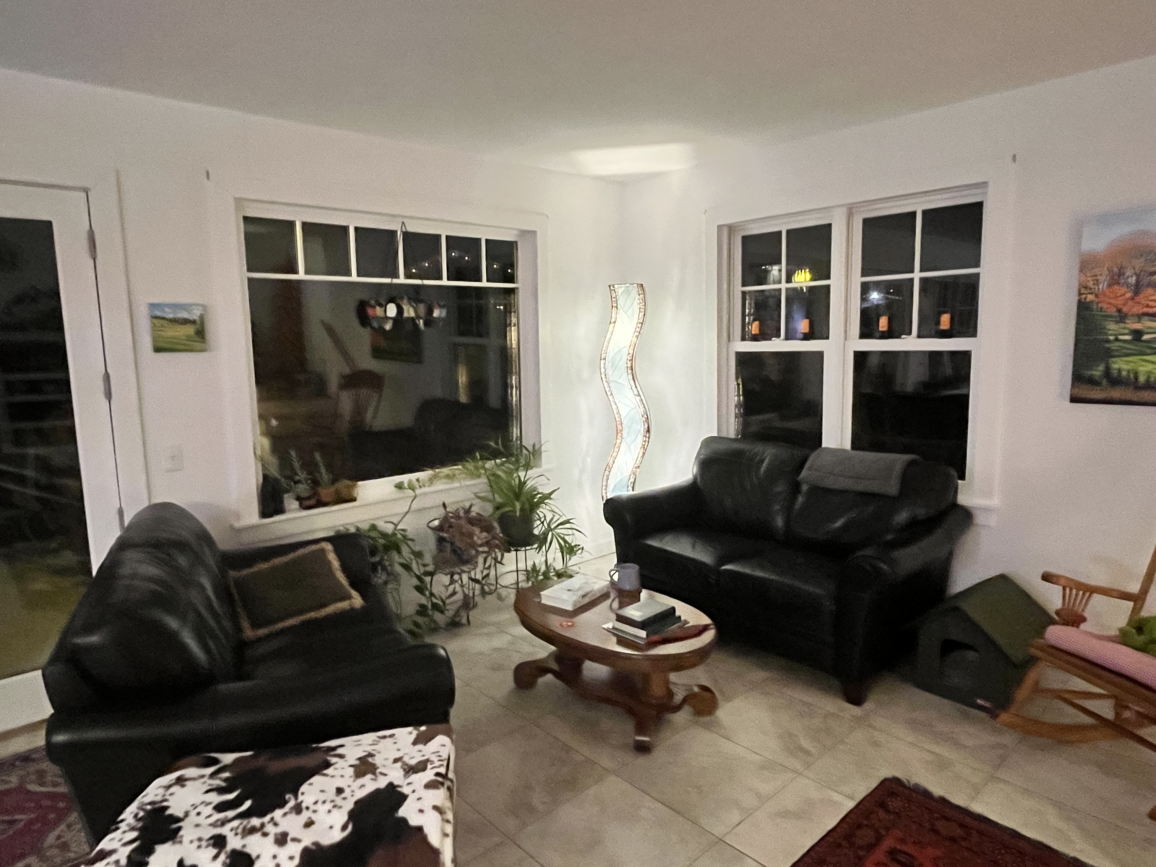

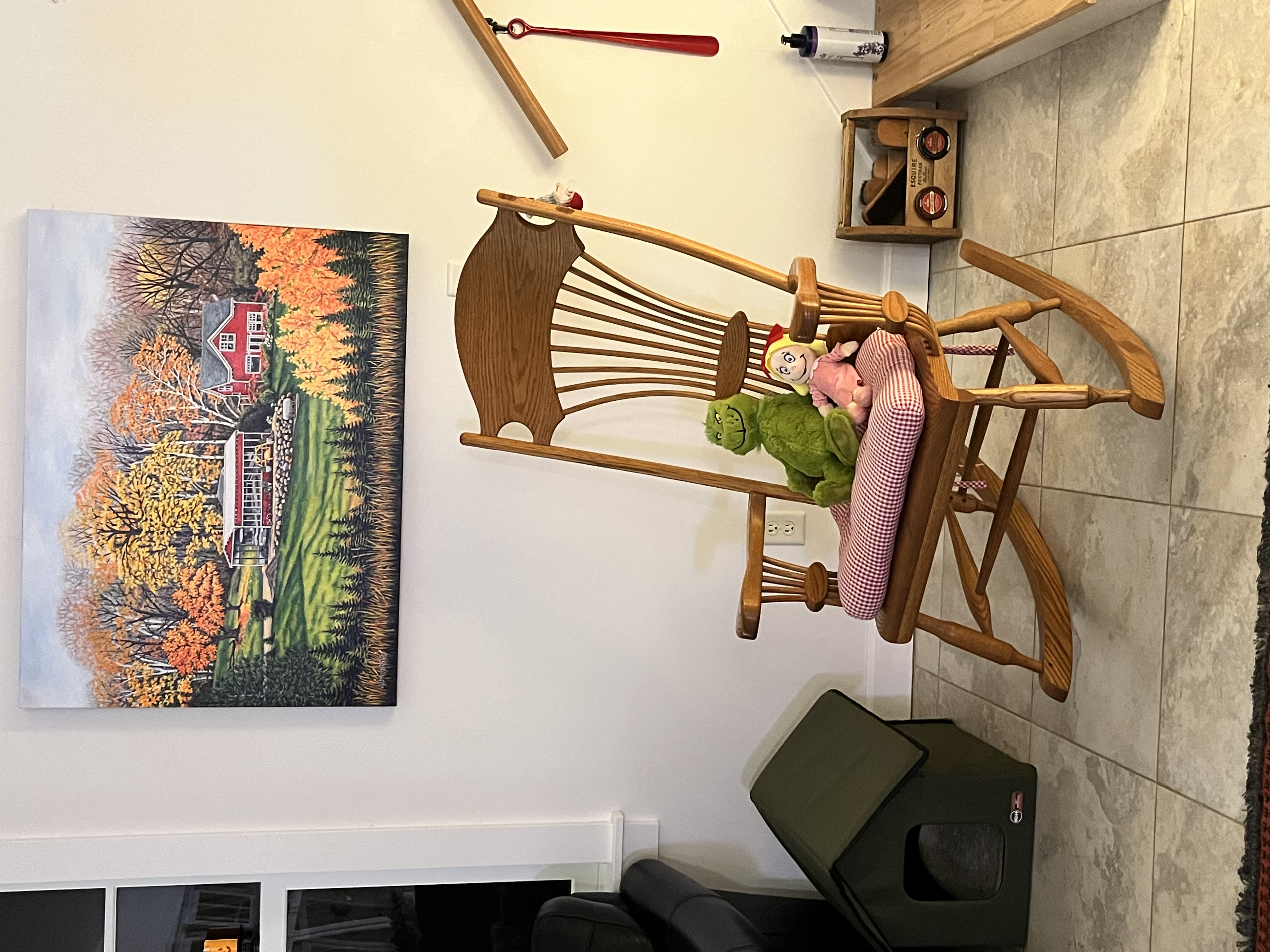

I’m really happy with the result.
When you sit on the loveseats you have theatrical lighting. If you were to film someone sitting like in an interview it would be perfect.

Post by dave77 » Fri Jan 24, 2025 12:11 am
What's the line hanging down from the ceiling in the last photo, a cat toy?
Posts: 14755
Re: Track Lights
Post by Sir Henry » Fri Jan 24, 2025 6:29 am
Yes.

Post by GunnyGene » Fri Jan 24, 2025 7:38 am
Love what you've done with your place! But I have to tell you that I got a touch of vertigo from that top down picture of the wiring. :shock: ;)

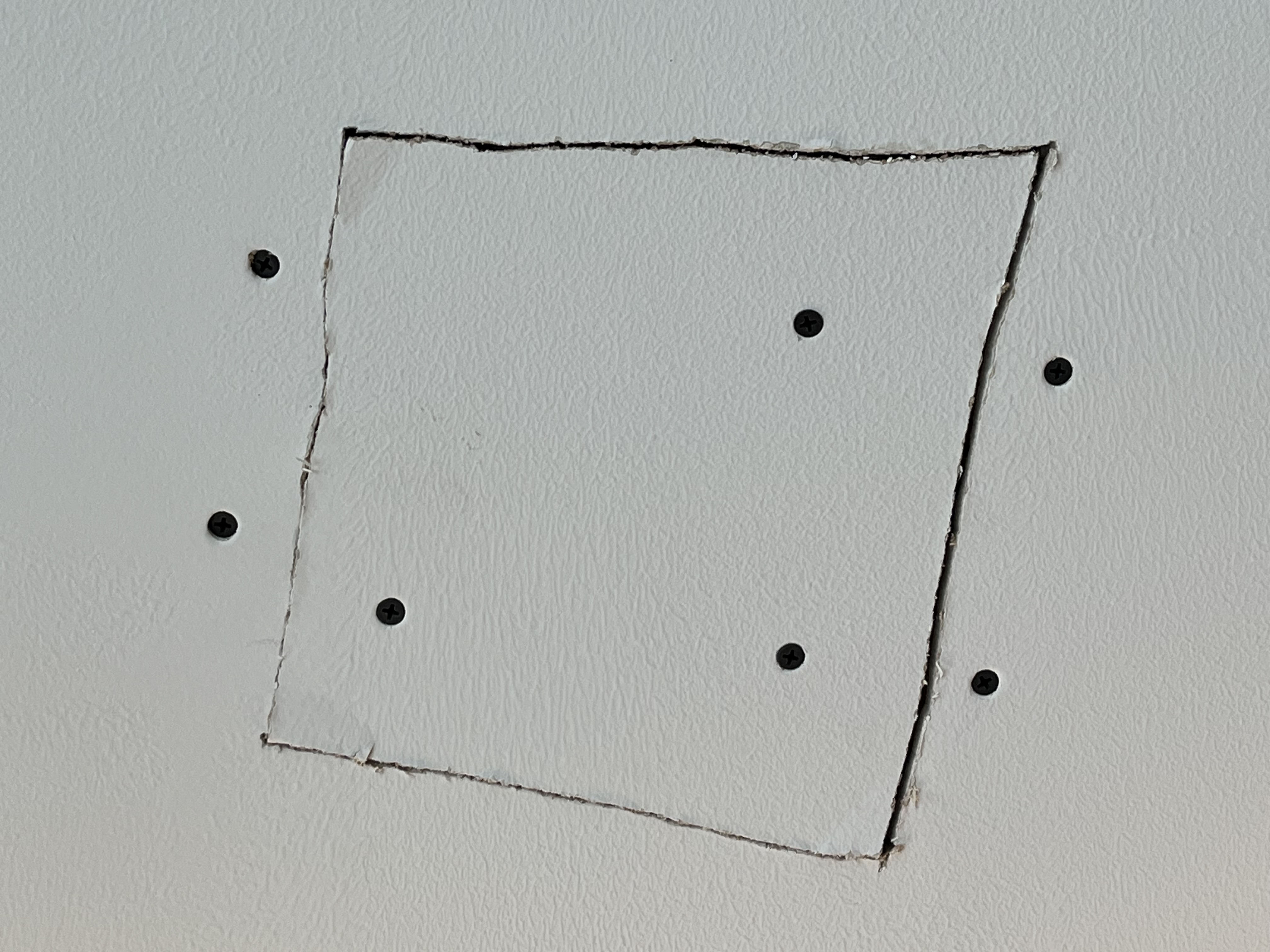

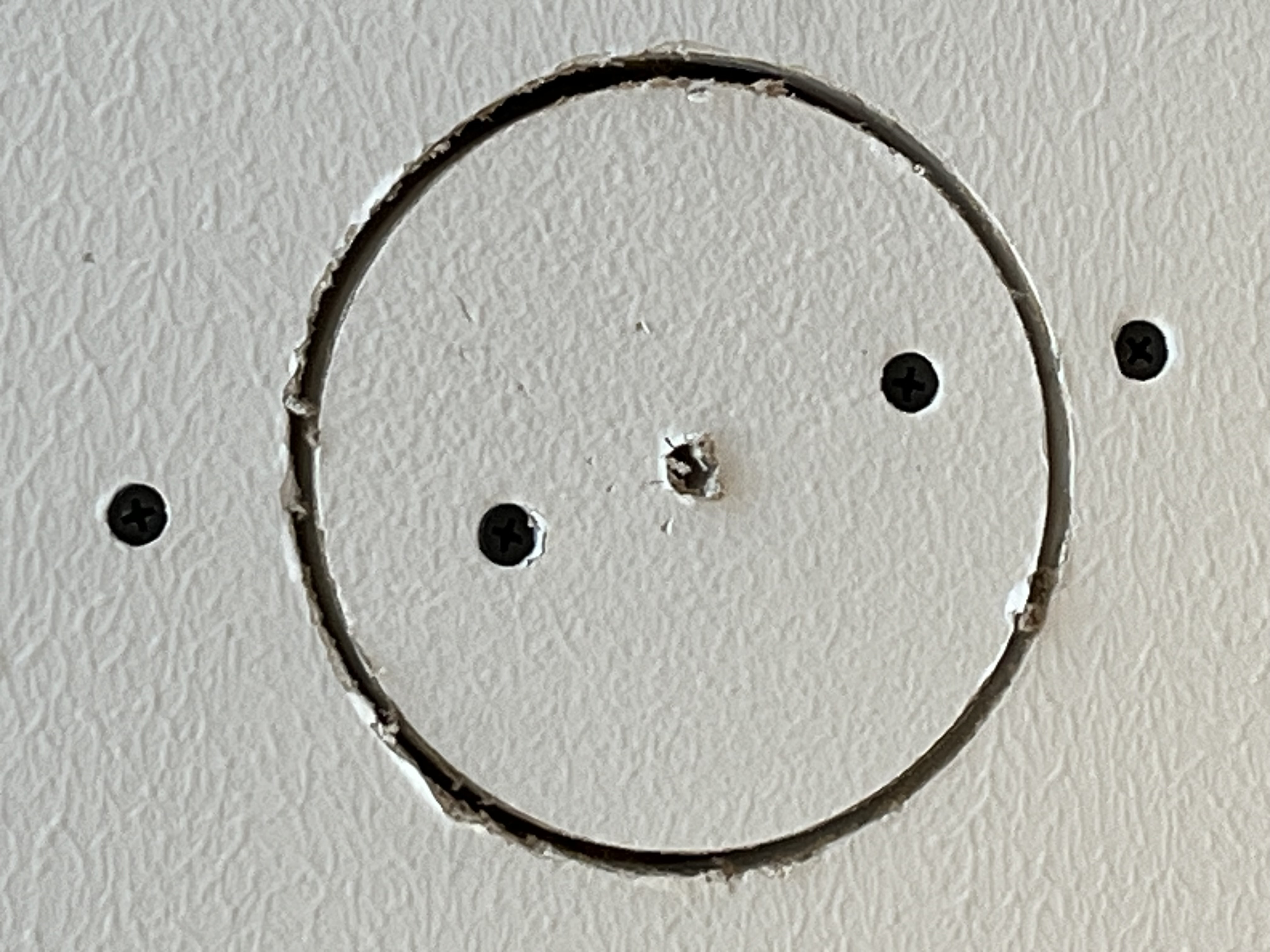

Post by Sir Henry » Sun Feb 02, 2025 4:24 pm

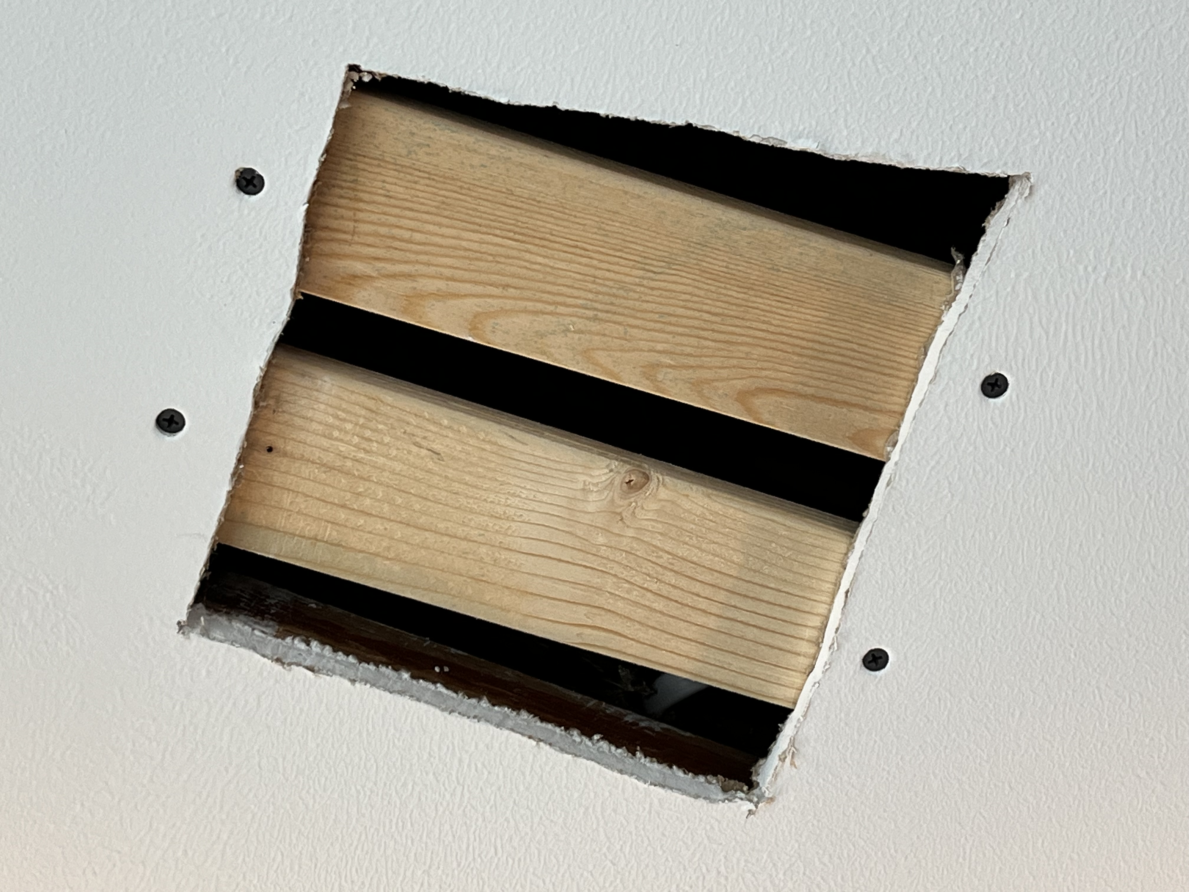

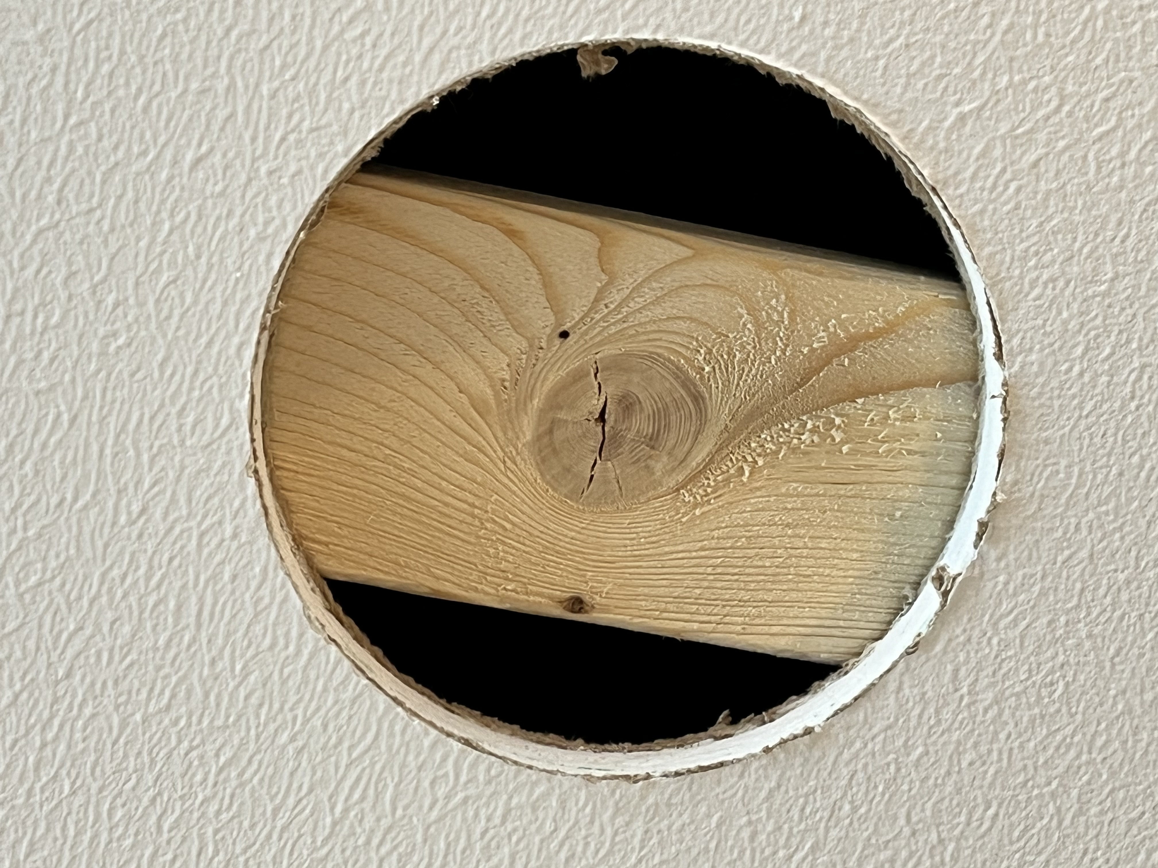

I worked on patching the ceiling yesterday. The first step is to cut a 1x4” board about a foot long and place it in the hole.
Then put two screws into the sheet rock in the ceiling and then into the plugs that were removed.
I saved the pieces taken out and they will fit back in perfectly.
I have more time in taking the pictures and posting than I do thus far.
I still have one more screw and then of course the mudding.

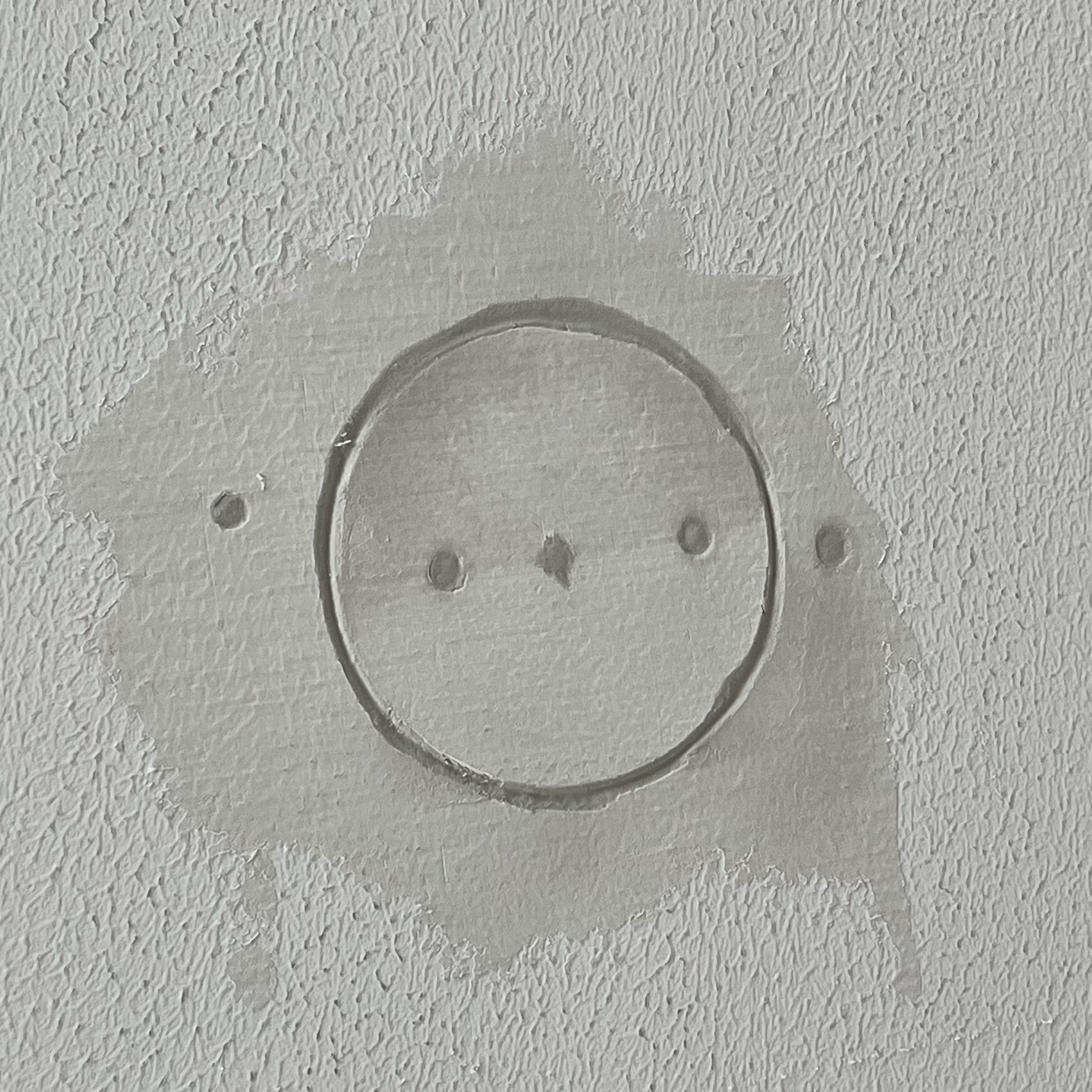

I did some filling today. I estimate it will take me three fills to get it right. The picture was taken when it was still wet. The gaps now are much lighter.
When it’s completely dry I’ll take a damp cloth over the excess and then fill the gaps in again.
