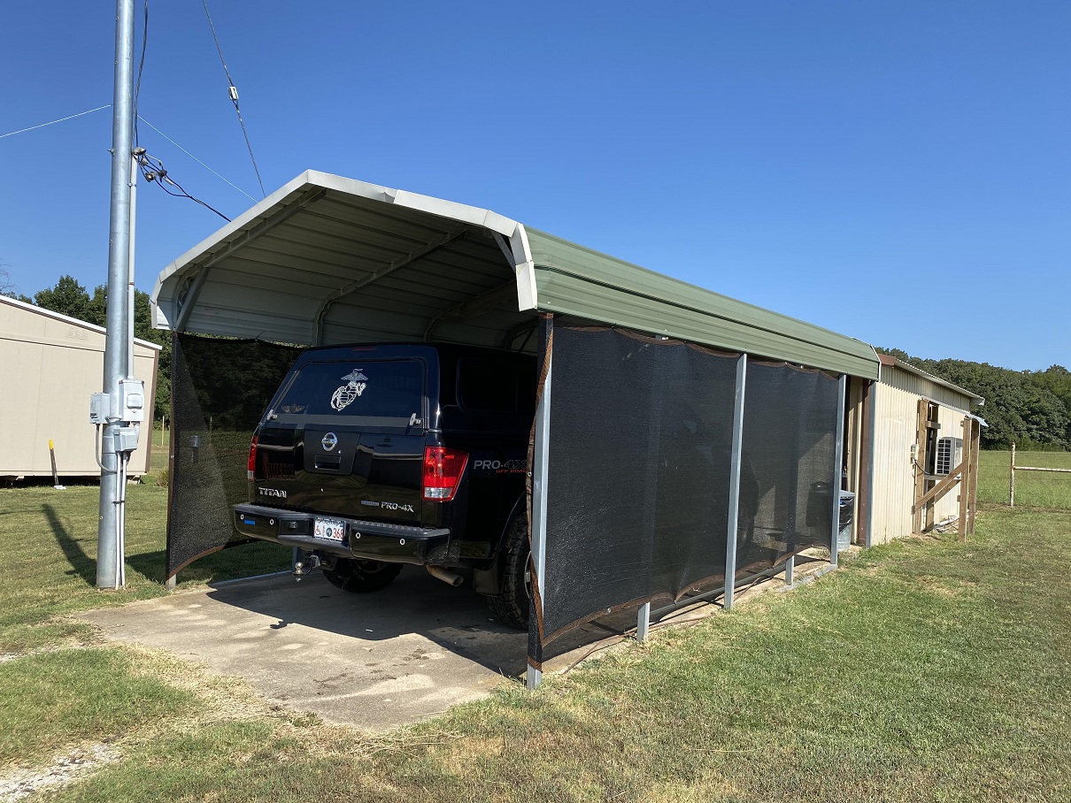

We have kept the Titan in a Carport since we bought it new, it's a 2010. It still looks good, not faded or weather beaten. The one concession we made to Oklahoma weather was to buy breathable sunscreen sides for the carport here. So far so good.
carport shade cloth.jpg (427.36 KiB) Viewed 13160 times
The advantage to the permanent carport is you can set up folding tables outside in the covered area when you need a larger work space or doing major cutting with the chop saw and wished the sawdust would just blow away, and cut outside under the carport out of the sun/rain in the spring, summer, fall... I have often set up a pair of 8' folding tables to give me an 8' x 8' assembly area there. just back the Titan out and get at it. :) With the concrete pad I have rolled the table saw out there and done major cutting out there as well.

Don't want to get too crazy but I need to do something that won't end up at the county seat in the next storm. :lol:

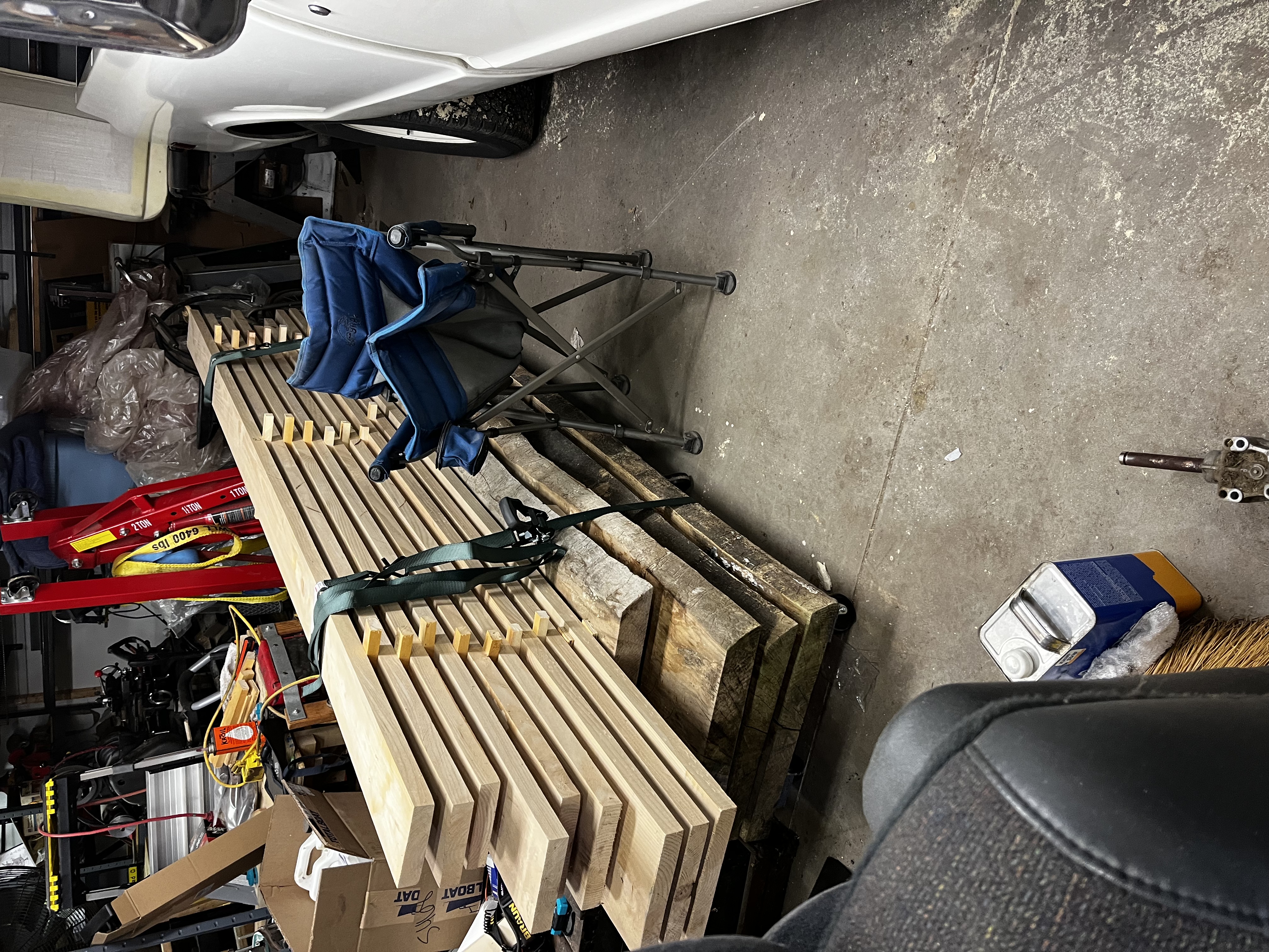

Got held up on the bench building a garage for the truck. 15 X 24
Got the base parts jointed, planed, mortise and tenons cut and assembled into both ends. That is the vise on the left. I have to trim it down a bit.
Have the stretchers to join the ends jointed, planed with tenons and pockets routed out for the nuts and washers and I am ready to drill the holes for the carriage bolts.
Once the base is assembled then I begin to true up and size the boards for the butcher block top.
