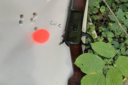

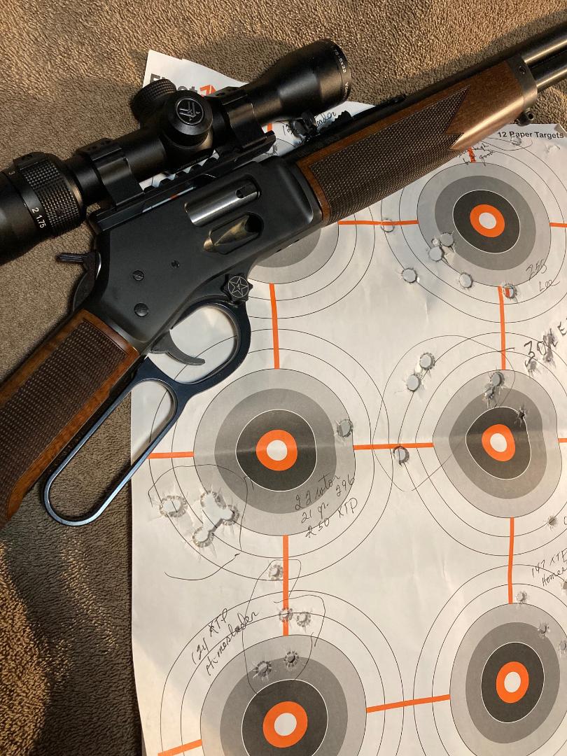

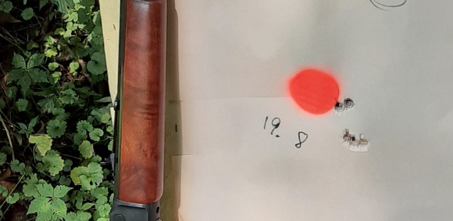

I mostly shoot cast through mine, but did test some 250 gr xtp's last year. Mind ya neither is scoped. Top pic is the Rossi and the second is a Marlin Cowboy. These were shot at 50 yds. The circle is about 2".
