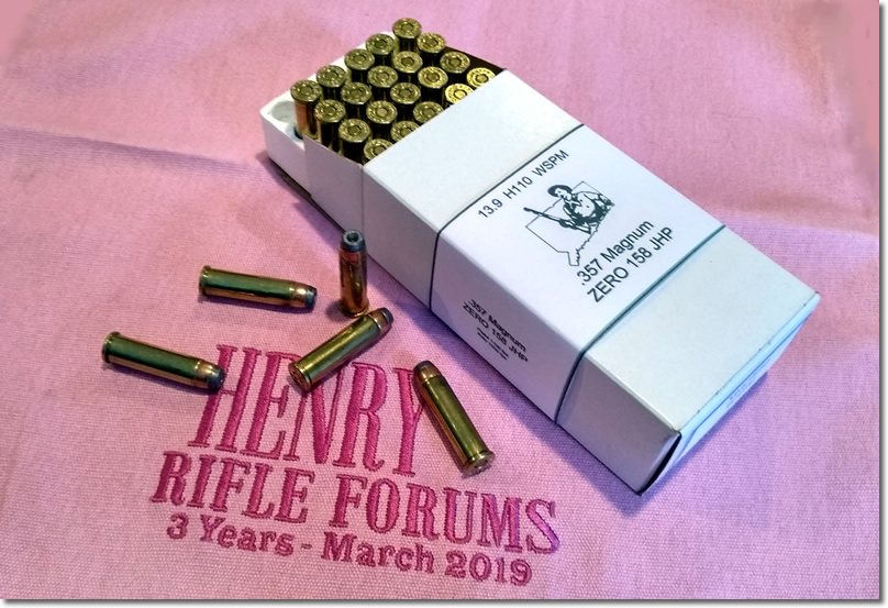

I bought 50 white ammo boxes from Midway when I first started to reload about ten years ago. On the end flap of each box I identify the mfgr and the number of times the brass has been fired. I use a "cigar ring" label to identify the bullet and the powder used. It seemed like a good idea and I've stuck with it.
I also use a single stage press and always visually check each step in the process, round by round, to insure that I'm consistent. No music. No videos. No distractions. I just focus on the very important task of making good ammunition for my guns.
Factory ammo brass kept in original lots

NHshtr
Posts: 191
Location: Southern NH
Re: Headstamp
Post by NHshtr » Thu Jan 04, 2024 3:25 pm
Very nice....looks great. Henry cloth and "cigar ring" label.
Maybe we should all try to have Henry merch in the pictures we post. Sure makes the pics of ammo more interesting.
