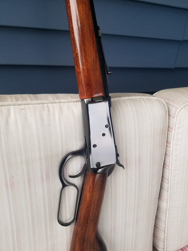

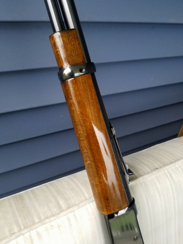

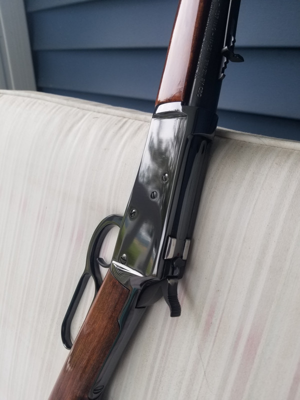

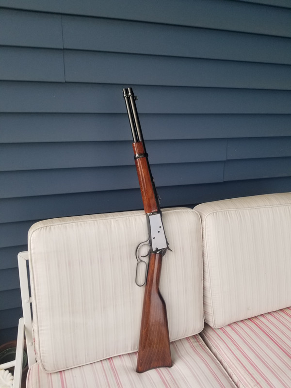

This little rifle is light, compact and very fast handling, not to mention very, very accurate.
Sure, it got a facelift and a few minor surgeries but it has turned into a beauty. Ive actually given this one a name, ElCheapo Guzman.

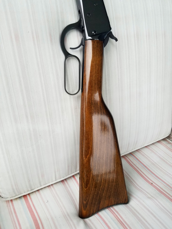

I took the whole firearm apart and stripped the stocks down to bare wood to do a little clean up and smooth out some sharp edges and most of all to get rid of that horrendous red stain they put on them, used some medium Walnut dye, not stain but dye on both pieces and put Tru-Oil back on, 7 coats. Added a new SS follower and new mag spring. New front sight from DawsonPrecision, the best FO sight on the market period. Put in a reduced power ejector spring, cleaned up the sears along with a new hammerspring. Now this little thing is lightning fast and very smooth with a light and very crisp trigger break. The funny thing is is that the 16" model is only supposed to hold 8 rounds of 357, well, mine loads 10, go figure. Im not complaining. For the money Im quite happy with it. Ill confidently say I have over 2500 rounds through it at this point and I have not had a single malfunction of any kind. This is the kind of buy makes me happy.
