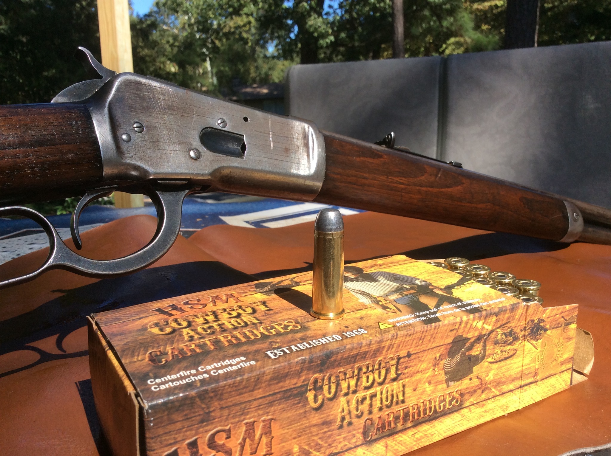

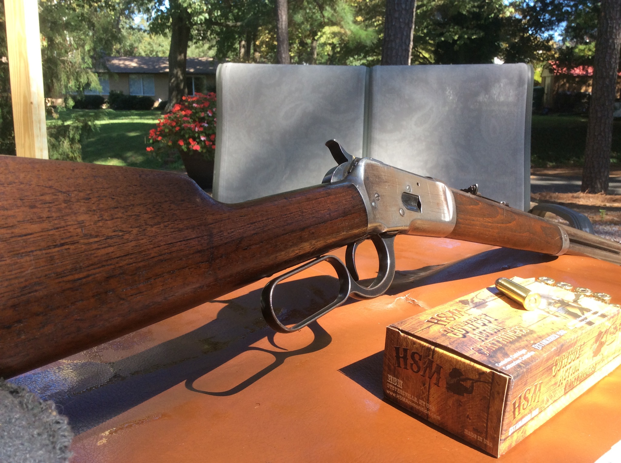

Brought it home and headed out to my shooting shack for a bore clean...lube the action and to try it out for cycling and ejecting a round. Loading up the new HSM 44-40 rounds was very smooth and it chamber a round easily. However there was an issue where the extractor would not grip the case head to eject it. I checked out the extractor and found it was gummed up a bit and would not spring down on case head. A little spray and wipe with Ballistol loosend it up and now it ejects round perfectly. Firing pin still in one piece and seems to be okay.
Doesn't look bad for it's age and headed to the range tomorrow for a few shots!

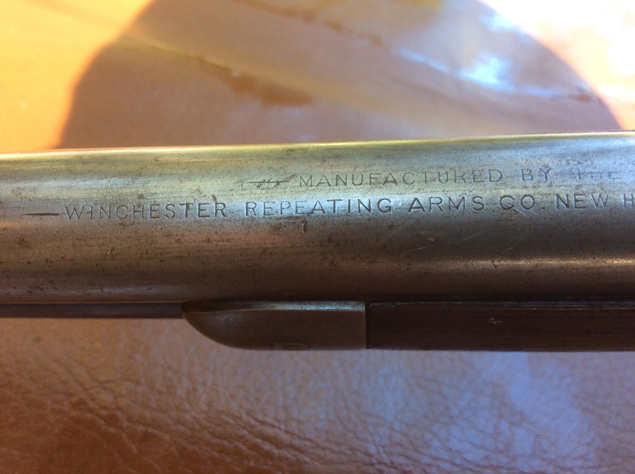

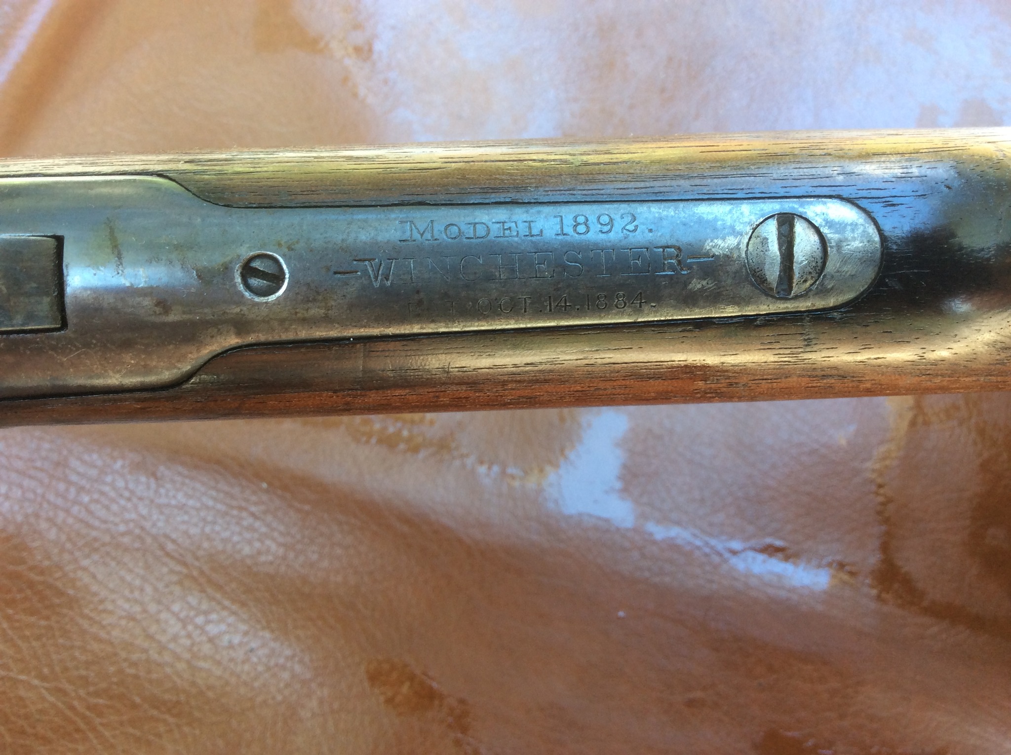

- winchester 1892 44-40.jpg (726.23 KiB) Viewed 1805 times
- winchester 1892 44-40 cal built in 1894.jpg (784.32 KiB) Viewed 1805 times
- real winchester 44-40.jpg (563.97 KiB) Viewed 1805 times
- built in 1894 by serial number.jpg (618.05 KiB) Viewed 1805 times
