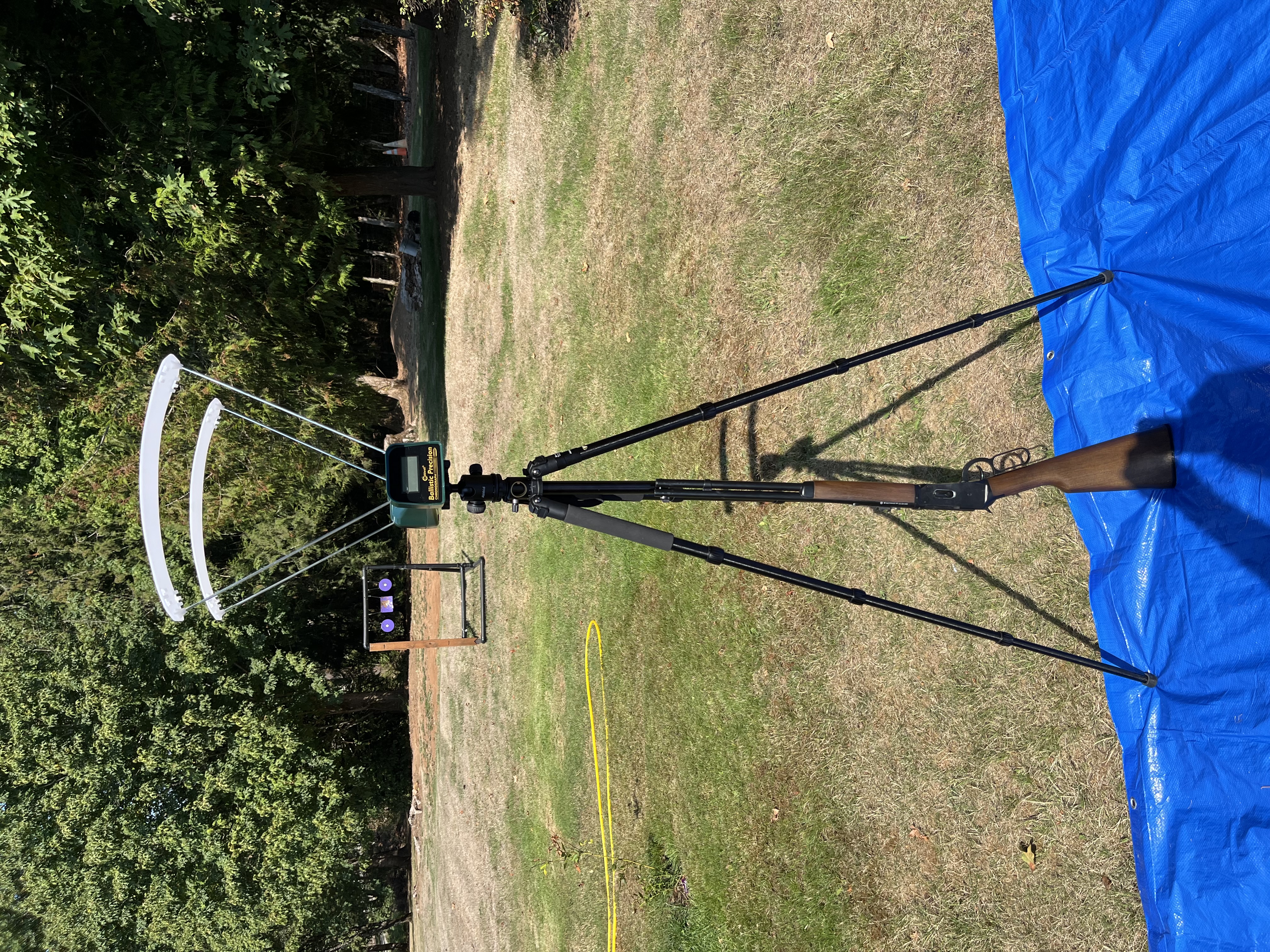

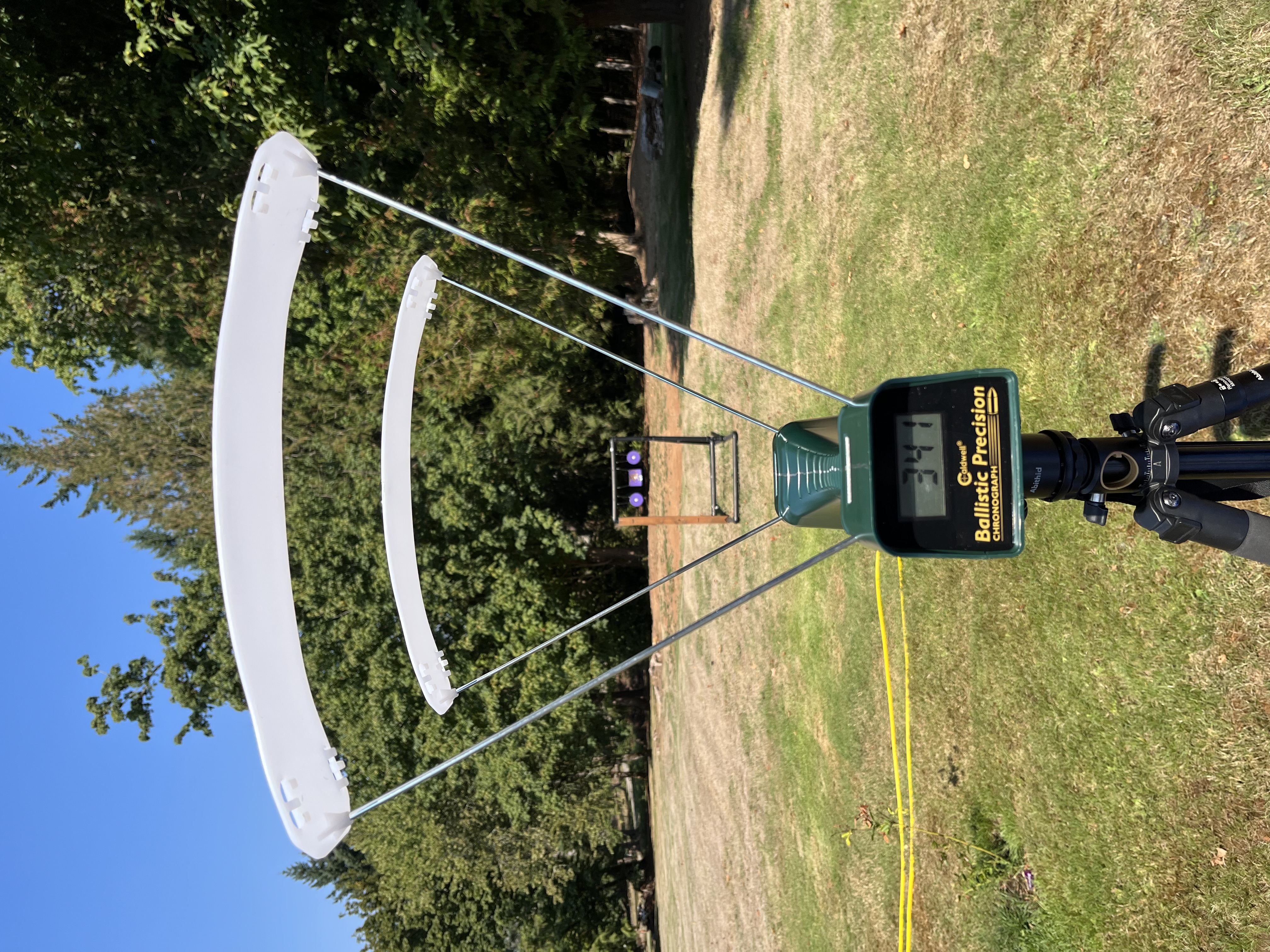

Took the chronograph and the BB rifle out today to play a bit with both of them. Only "problem" was that its a nice, sunny cloudless day with the sun almost directly overhead around 1:00-1:30~ish. So the lighting was probably near perfect; I need to retest under more "sideways sunlight" types of situations. Maybe sometime next week.
Here's how my little "Home Range" setup looks thru the chrono: (please take note that I didn't do the greatest job of setting the chrono's "tilt", or "roll" in aviation terms)
Here's my Umarex BB Lever Rifle & chrono/tripod setup. It's sort of a copy of a Winchester 1892.

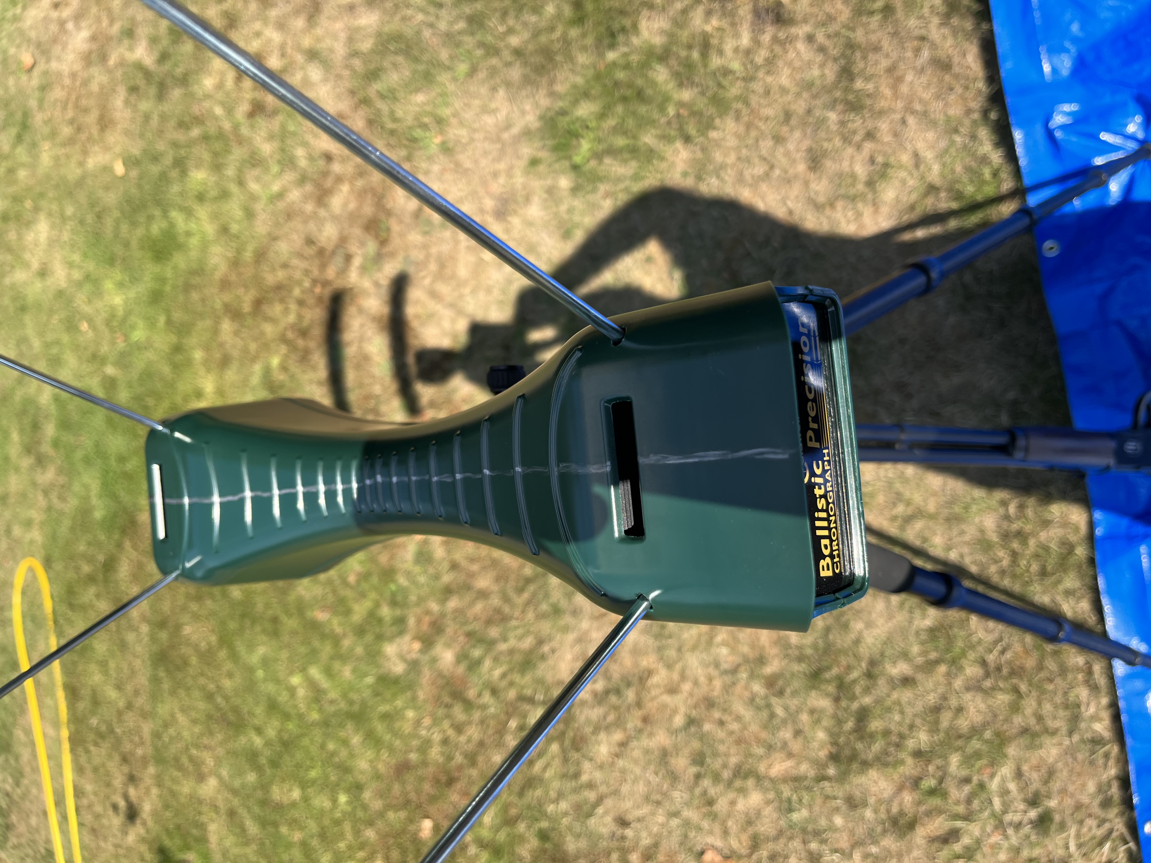

Here's a crrummy pic of the silver stripe I paint penciled on down the middle of top of the chronograph. Helps align to the target a tad easier. One of the bench rest shooters at my gun glub suggested this:

The app gives some decent calculated info for ES and SD. I need to give it a bit more info to calculate lbs./ft. of energy. But I didn't know the weight in grains of a BB, or it's ballistic coefficient.
I shot three 10-shot groups today. The first one, I stood back around 5-6 feet from the chrono (shooting offhand), and it recorded no errors whatsoever. On the next 2 groups, I started off standing maybe around 2' away from the chrony, fired a shot, and instantly got an error message, both of these last 2 groups. So I stepped back one step from the chronograph, bent my knees slightly to attempt to get the shot to go through the timer's "sweet spot", per Caldewell's instructions. The next 9 shots all recorded, for both of those groups.
Conclusions, for now, sorta??
This thing is kinda finicky about shooting through the zone Caldwell outlines in the instructions. It's also kinda finicky regarding light, I *think*. Need to play with it a tad more to draw a definitive conclusion about that, and possible solutions. The first time I had it out to the local rifle range, it was a cloudy overcast day. Caldwell's instructions stated in Tip #8 to "Remove the sunshades on heavy overcast or shaded conditions. The sun shades are only necessary in sunny or partly cloudy conditions, and by removing them in other conditions you'll allow more light into the chronograph." " This did not work on that day.
Tip #9 states "On sunny days place the chronograph in the shadow of a building or opaque wall." It has further expanations for each tip, and for this one states "Ensure the sensors have a clear view of the sky, but the chronograph itself is in the shade. You could alternatively add sun shields to create a shadow. The goal is to eliminate direct sunlight on the chronograph, while still insuring the sensors have a direct view of the sky. However, avoid placing the chronograph in the shade of a tree. The uneven sunlight that filters through the tree will cause more problems than it will solve." At any rate, using the sun shields, while being in a sorta shady spot allowed the thing to work on that first range trip. And ditto for Thursday's range session. :? :?:
There are 15 "Tips" in total, and to me, some are pretty confusing.
I'll just say this: If there are less picky/finicky units out there, that would probably be a better buy, depending on your needs, price, and etc.. I can neither afford to start a chronograph collection, nor have the desire to, so I'll have to learn to live with this one. I don't have any bad regrets about buying this brand, for as much as I will use one. But again, if there are easier ones to live with, those might be better to buy? I dunno if others have similar issues or not.......
In the bright light of today, using the sun shields, it worked really well on the BB gun. I only had to remember to adjust my stance a few inches lower to put the BBs in the "sweet spot" per Caldwell's diagram after each of the 2 error codes. It worked fine at the range 2 days ago, basically sitting in some shade about 12'-13' from the muzzle, using the sun shields, from about 5:30 to 7:00 p.m.. Did not miss a shot, no error codes.
Again, I hope this helps some. I also hope that others can post what their experiences, likes, and dislikes about ones they have used or own. I actually had a nice gift card for the local gun store awhile back, and considered getting a MagnetoSpeed chronograph, but not their kit. I bought ammo & powder instead. I believe the price was somewhere in the $170 range?? But with those, I don't see how you could use them for shooting handguns through. I think Lever rifles might be possible If you put them on the side, rather than underneath. The tube magazine would probably prevent using them in the conventional way, but again, I think there's a "workaround" for that. I could not slip the cost of a LabRadar doppler-type chronograph past the wife, so those are out. The Oehler is pretty spendy; hate to shoot one of those...... So, being a Rat on a Budget (an old 80s rock band; I always related to their name.....), I try to get by with the less expensive spreads.
