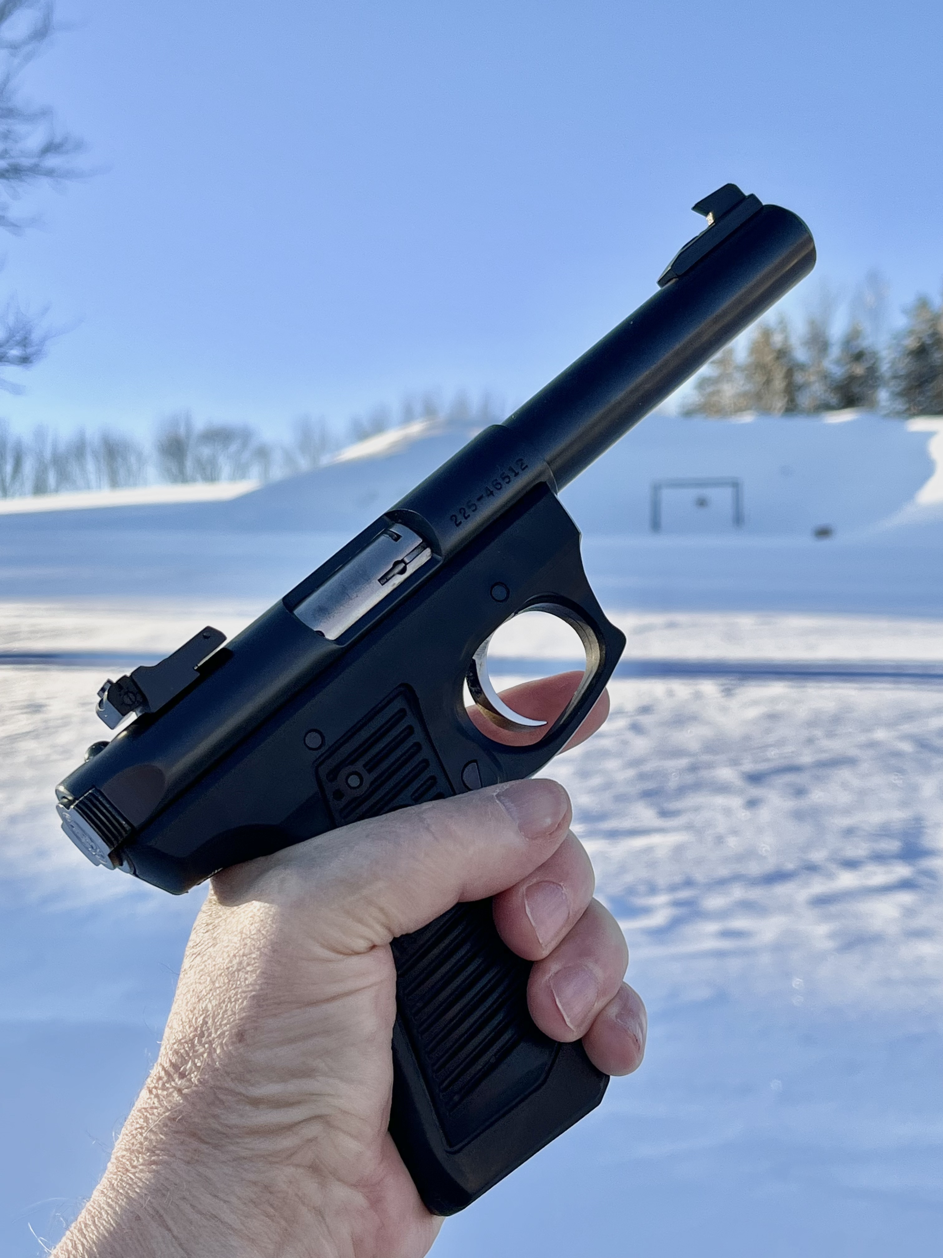

BigAl’s post prompted me to shoot my 22/45. I haven’t shot it much since moving to Wisconsin. I shot SV and was having problems with it cycling. Part of the reason is it’s -15F and the other problem is it’s very dirty. I hate cleaning it. Actually I hate putting it back together after cleaning it.
In the past this has been one of my most accurate pistols.

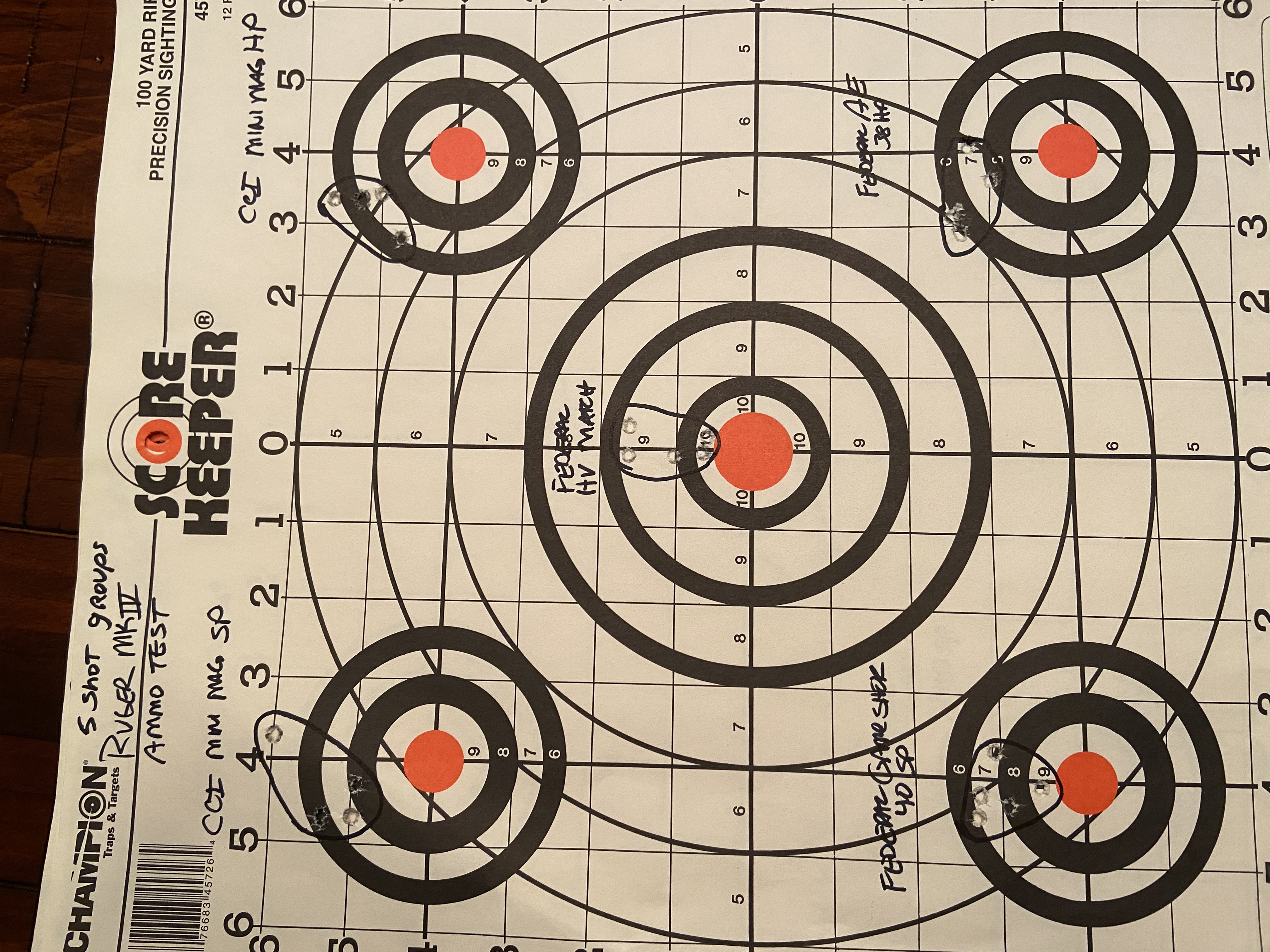

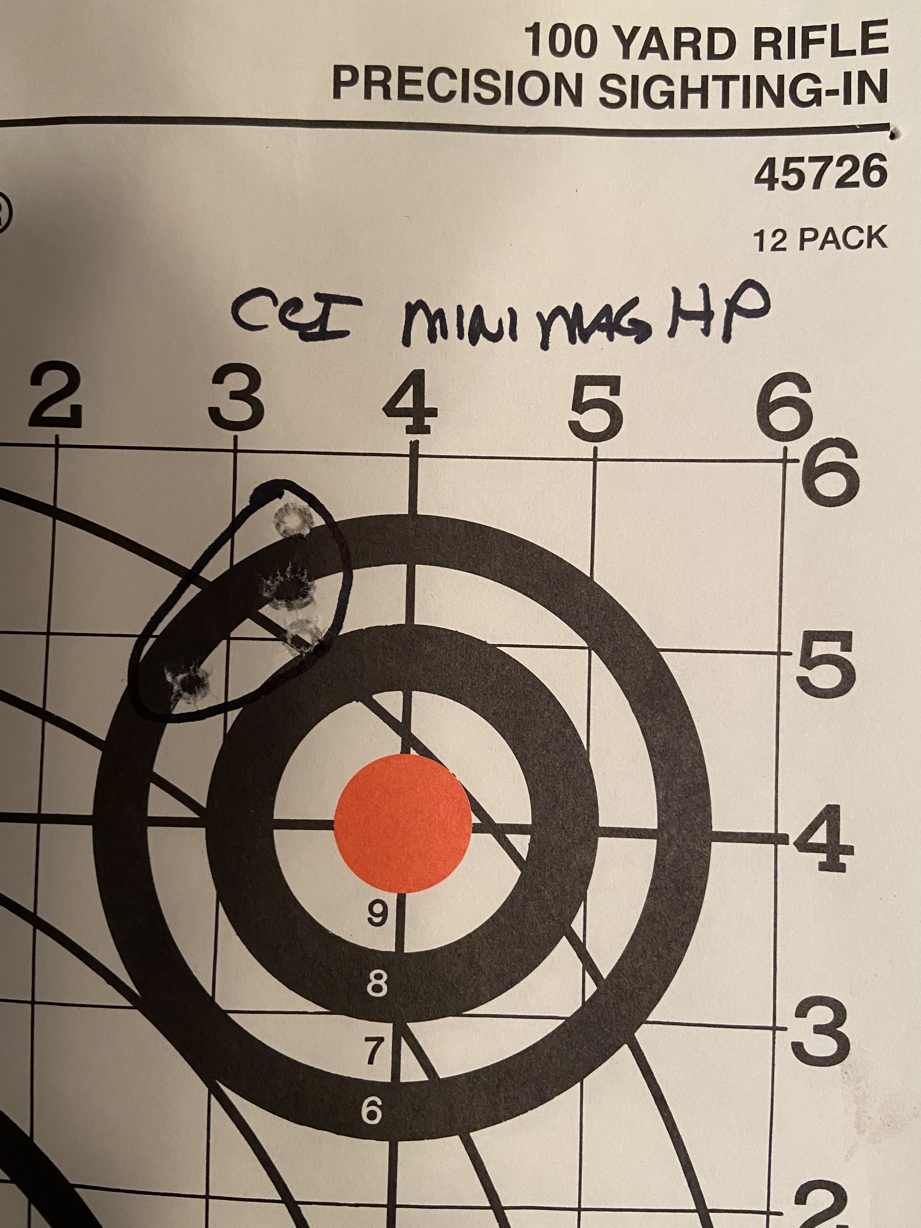

Mine is a MK IV but otherwise similar to yours and it likes HV just fine. But in fairness I didn’t run a lot of different ammo types in it but just what I had on hand. Here’s my results.

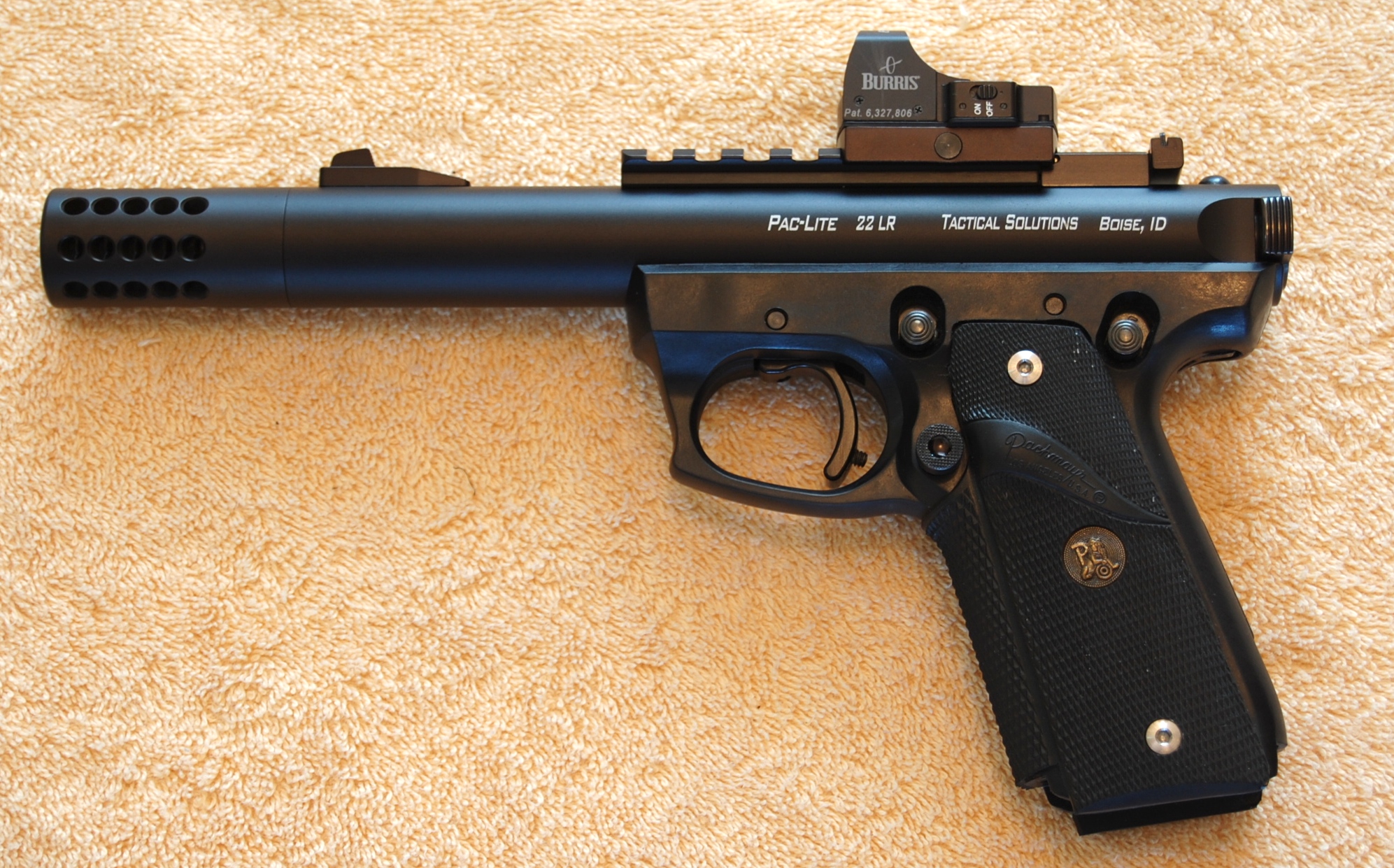

I shoot only Mini Mag HPs in mine, it is boringly accurate IF I do my part. Putting 50 shots inside a 3 inch bull at 25 yards offhand is unusual but not surprising for me. I do have a red dot. And a Tac-Sol upper. And Volquartson trigger. These are great guns. I am not much of a shooter, so those really help.

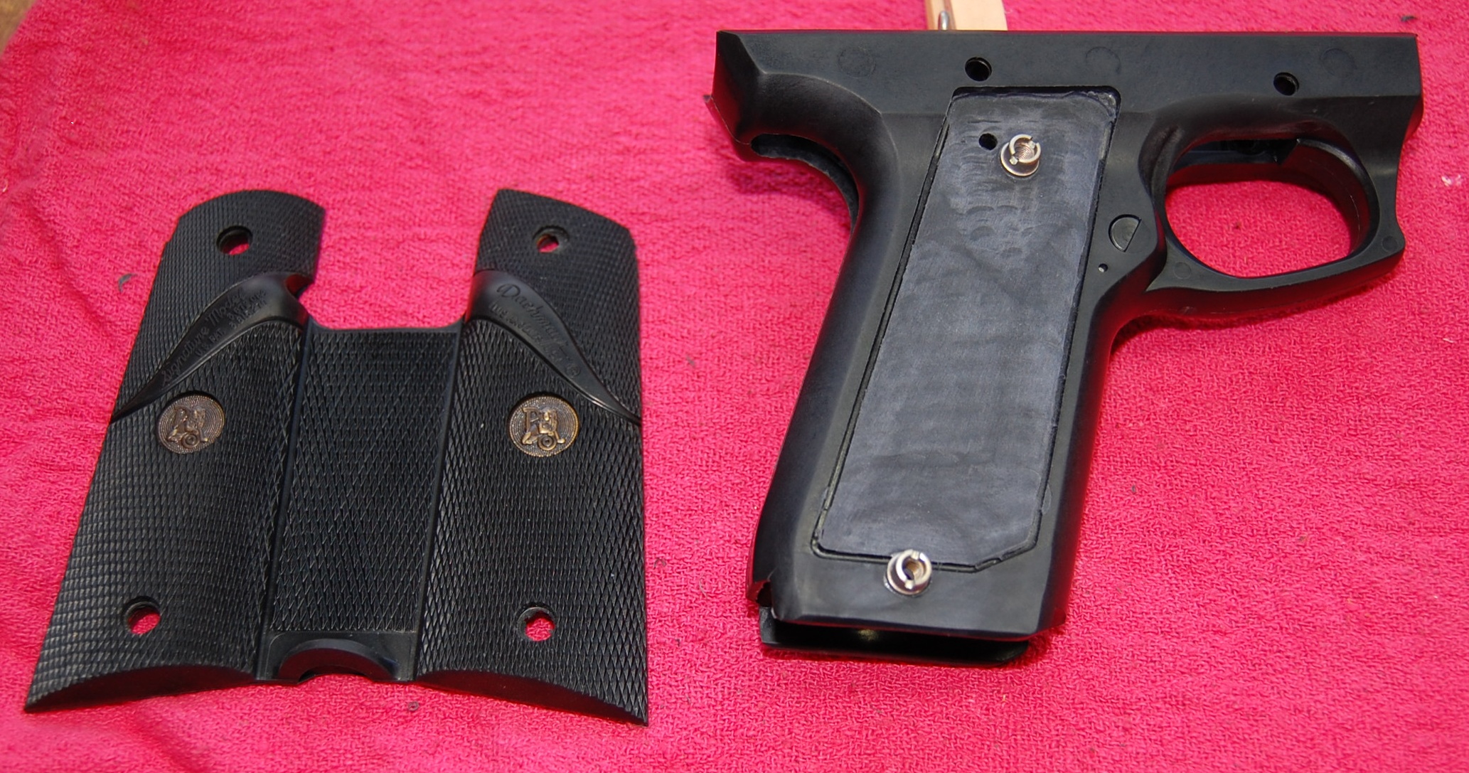

Mine is a Mk 1 and I milled the frame so I could add 1911 grips.

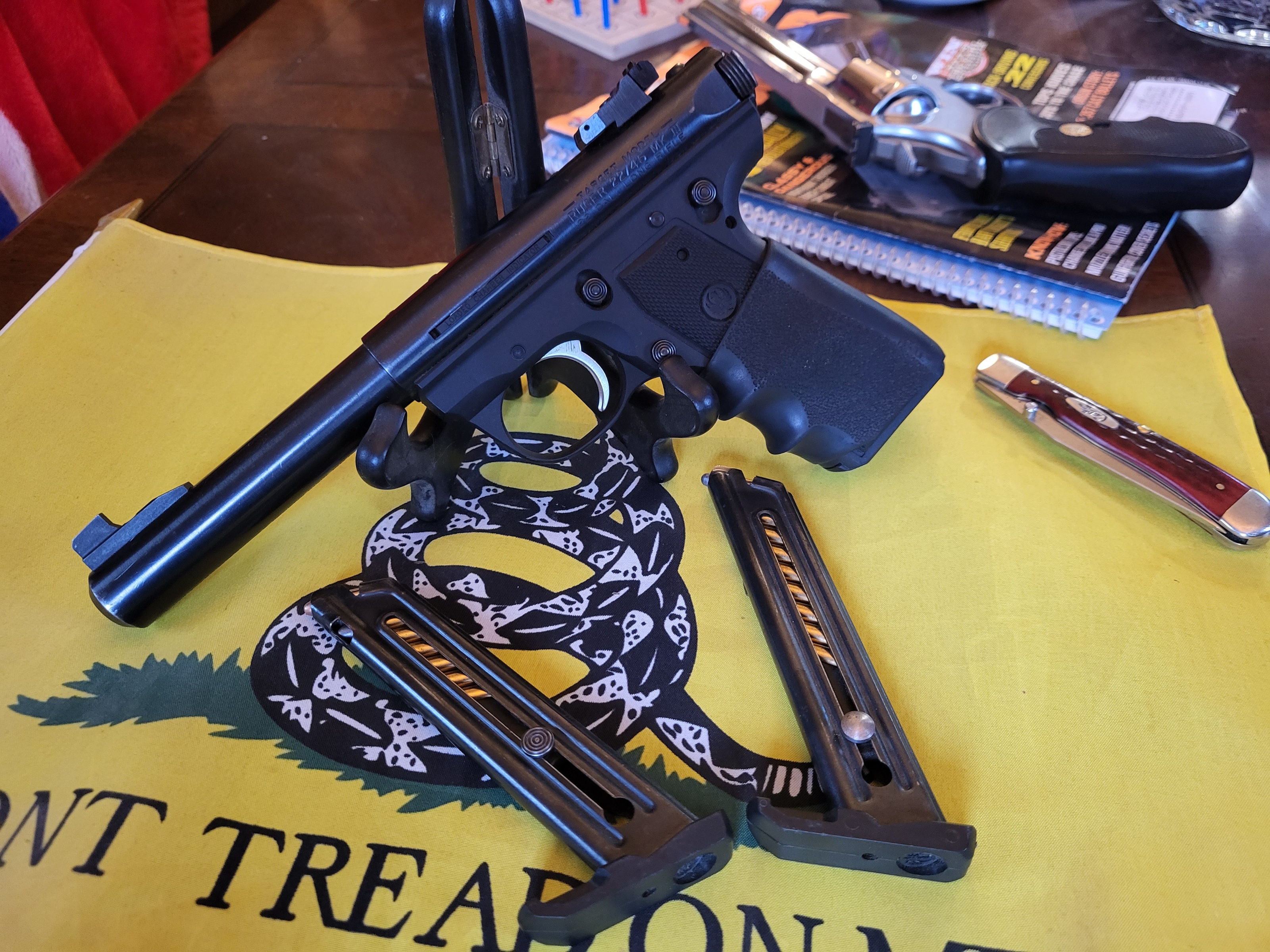

I like my 22/45 as well, probably just a little bummed up in the cold temp so a shot of remlube oughta fix it. I have the mark IV version it disassembles and assembles with the push of a button
John E Davies
Posts: 885
Location: Spokane WA
Re: Range Report: 22/45
Post by John E Davies » Sun Feb 05, 2023 10:20 am
North Country Gal wrote:
Thu Feb 02, 2023 10:16 am
Not that Ruger Marks are especially collectible, but that's one to keep in the Ruger Mark hierarchy.
My original 22/45 made me very mad when the Mk 3 came out, I really lusted after the replaceable grips, so I milled the sides of my grip flat and installed grip bushings….. I suppose I could have tried to buy a newer frame, but I wanted to use real 1911 grips, and those would not have worked anyway. I guess I destroyed the value of my pistol, but the original receiver is long gone plus the internals are different, so that is moot.
BTW complete grip frames are not cheap these days. I don’t know if Ruger will sell you one a stripped one.
