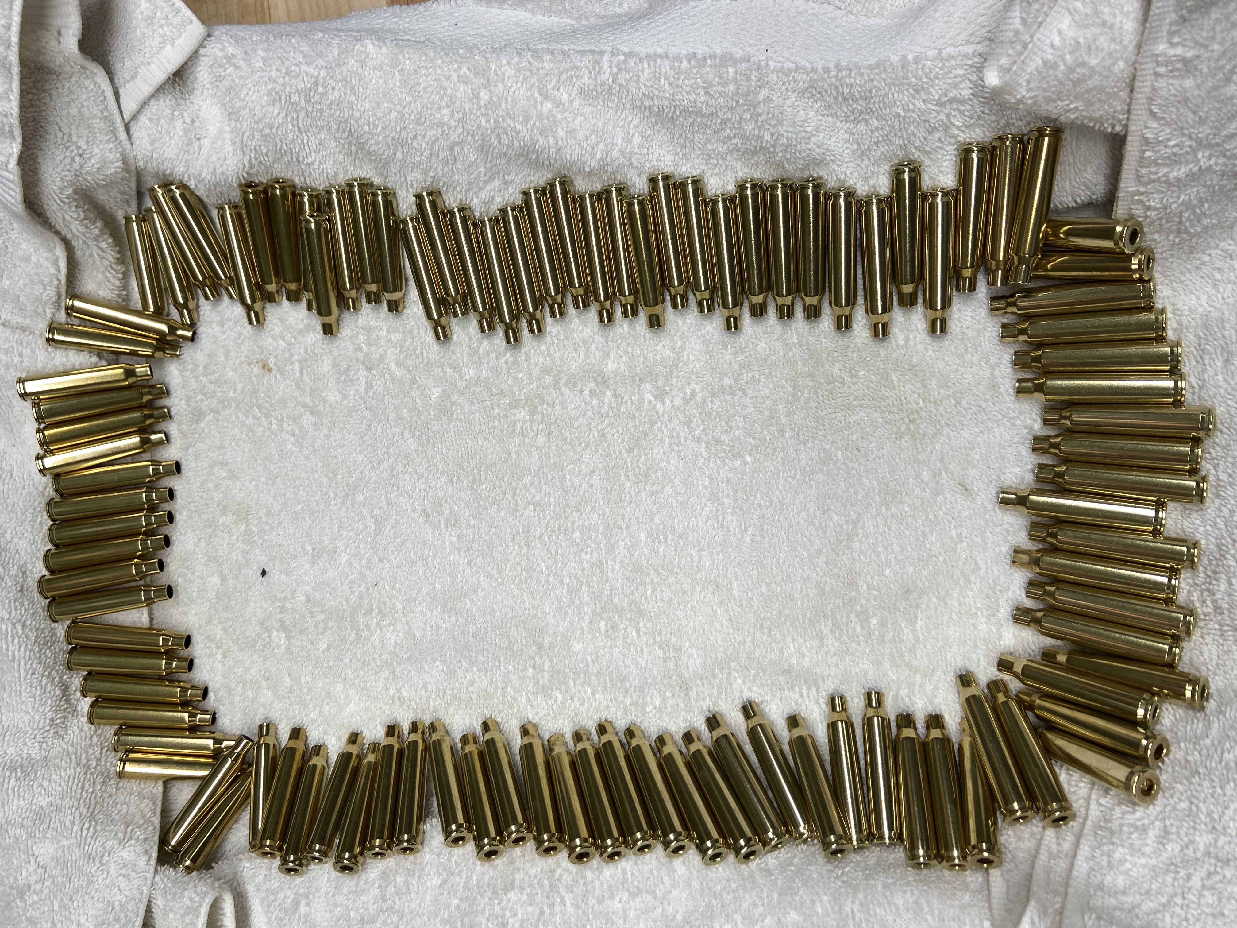

I use a Thumblers M/B wet tumbler and have great success with it. My understanding is I need to keep the total weight of the water, brass and pins to a certain weight. (I’ll come back with the details, not available to me right now). I use Dawn detergent and Lemi Shine and have gotten to the point that I just give the Dawn a squirt and the Lemi a shake. It’s not too critical on the ratios as long as you are in the ballpark. For drying I have an old cookie baking sheet that I place a towel on. I then put the polished brass along the edges with a slight downward angle to help them drain. I let them dry overnight.

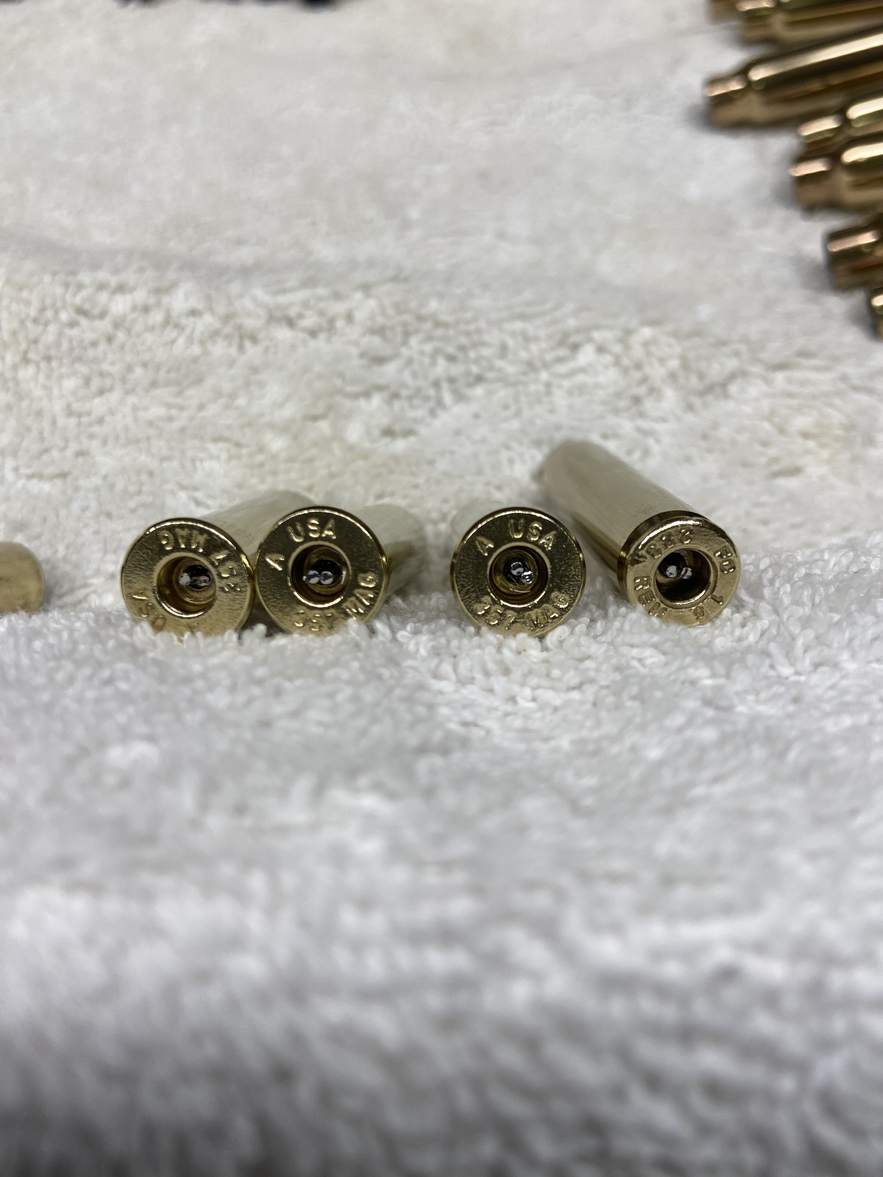

One thing to watch for is pins getting stuck in the flash holes. I have this issue with .223 brass mostly and it’s just maybe 5-6 out of a hundred.
