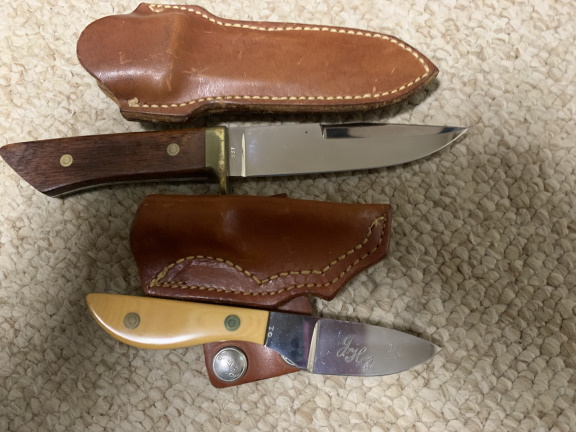

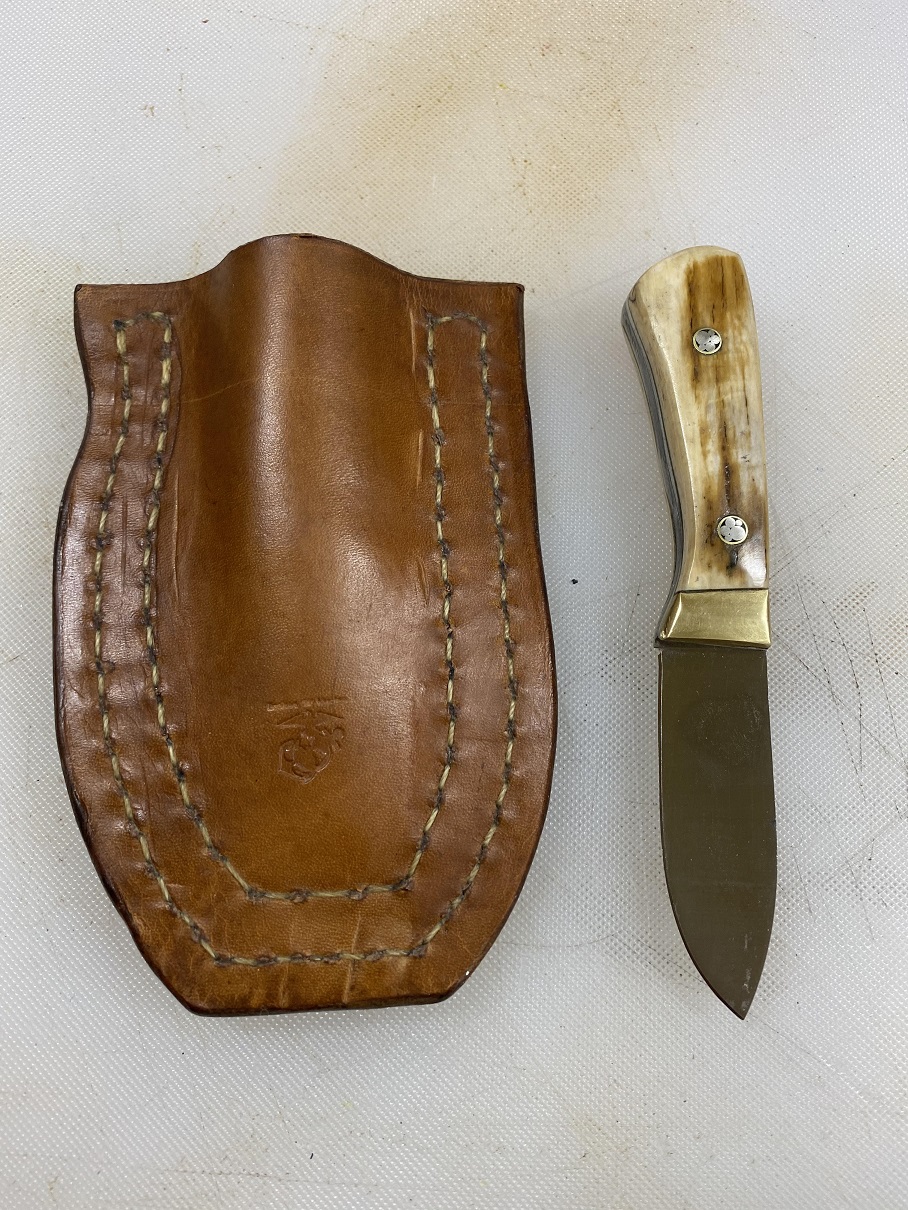

Miss T saw the knives I made for the Doc in VA and loved them. As a surprise for her for Christmas, I made her a couple. The first, and primary, is a big surprise. It is a small daily use knife, with Mammoth Ivory Scales and mosaic pins. The brass bolsters were cut from brass barstock and hand shaped on the belt sander and with strips of sandpaper. Turned out better than I had hoped. The sheath protects the knife and is flat and can be worn on the waistband of shorts or sweatpants by means of a pocket clip. NO belt needed, which is a good thing as the boss rarely wears one. :) I made the sheath from distressed 8 ounce leather absent of fancy tooling other than my makers mark, but did hand stitch it with a double row of heavy waxed linen thread to insure it would last. It's a working sheath rather than a fancy dress/decorative sheath.
See both in the pic below:
21 sheath and ivory done.jpg (494.96 KiB) Viewed 1139 times

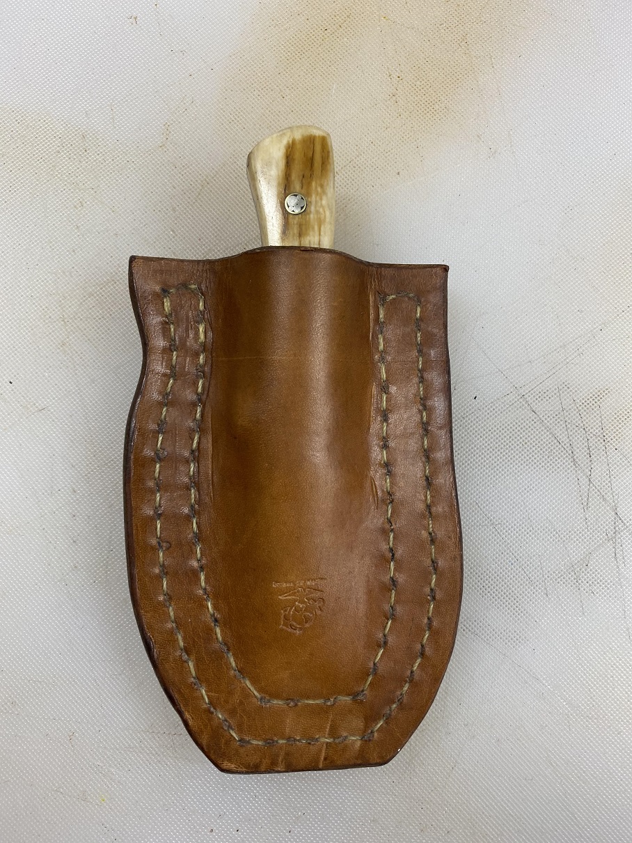

In this second pic, you can see how her knife fits. She hasn't seen it yet, nor did she see any of the in progress pics.
22 knife fits.jpg (499.96 KiB) Viewed 1139 times

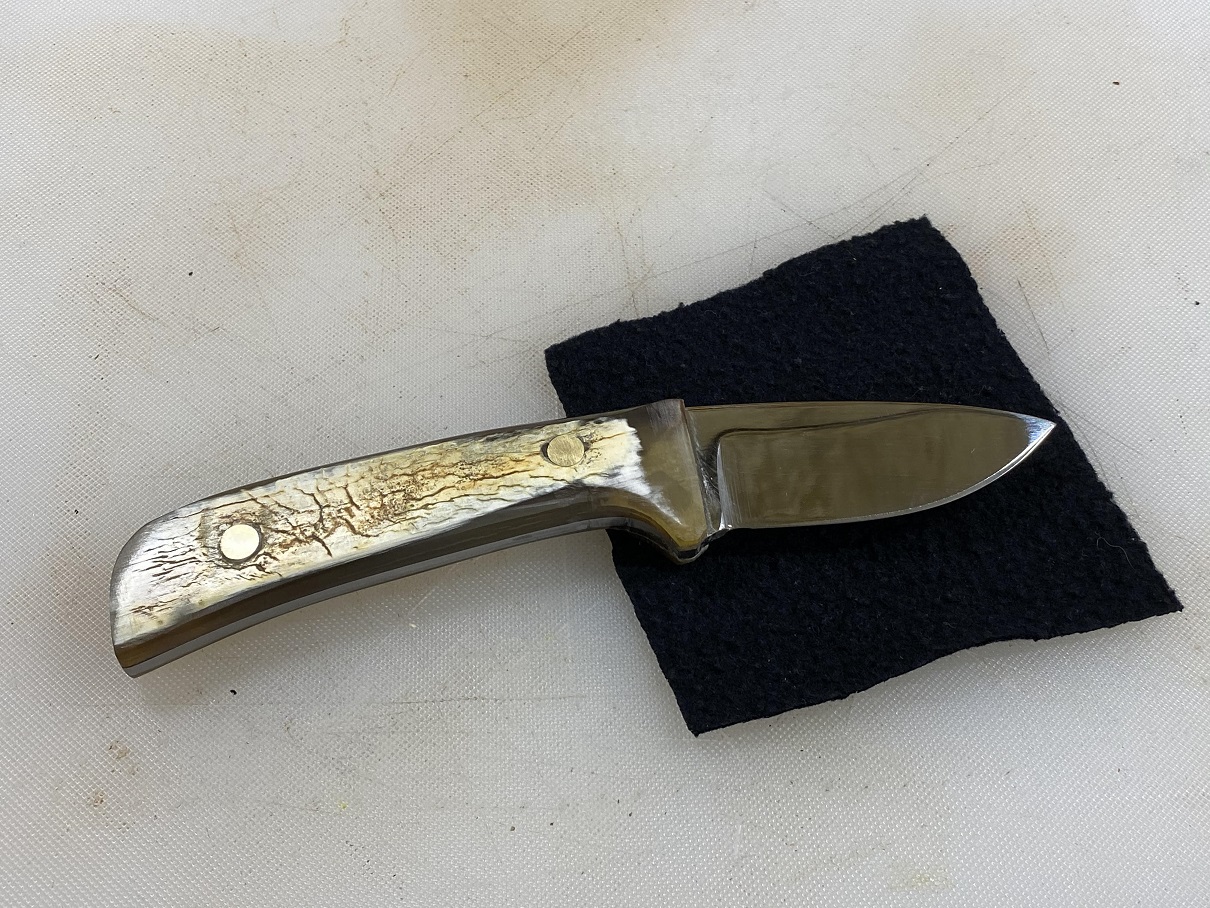

I made her a second, larger working knife, and if she wants a sheath, I'll make one, but this would be too large for use without a belt. I made it more because she liked the bone handled knives I made and she commented on the horn we saw in the bins in the Jantz Knife Supply. This is Ox Horn. My only criticism was that the pattern on the horn is very thin and during shaping of the scales a lot of the color was lost. You learn as you go... lesson learned.
10 ox done.jpg (488.36 KiB) Viewed 1139 times

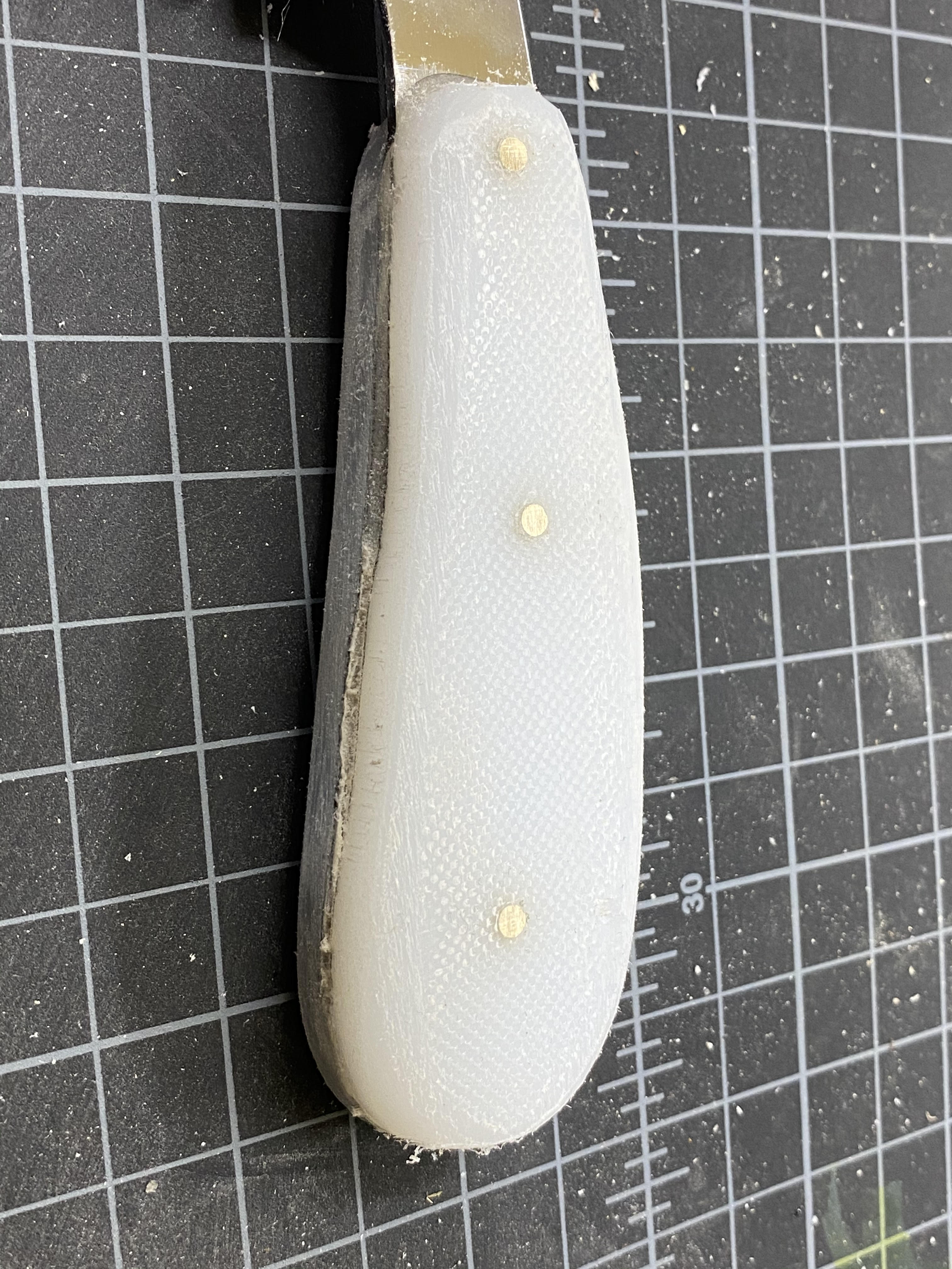

My daughter called and wanted me to knock her out a fillet knife as she has been helping her butcher process deer in exchange for venison. She can't eat many things these days because of allergies. No beef, chicken, pork, etc. She can eat fresh venison that has NOT been seasoned, same with elk and bison. So, I picked up a fillet blade blank and in order to build a WORKING knife that would be impervious to the blood and constant cleaning she would give it in all that use, I used remnant sections from a cutting board I had used in another project to make HER scales. Water proof and resistant to damage. I thought I had saved a decent picture of the completed knife, but the best I could find was the "forming" picture of the scales. I spent a bit more time shaping and smoothing, moving up a couple more grits and finalizing the shape, but you'll get the idea.
03 shaped.jpg (1.52 MiB) Viewed 1138 times
I made a "sheath like" blade cover for transport, but forgot to take a picture. When she opens it this Christmas, I'll get better pictures of the knife and the mock sheath.

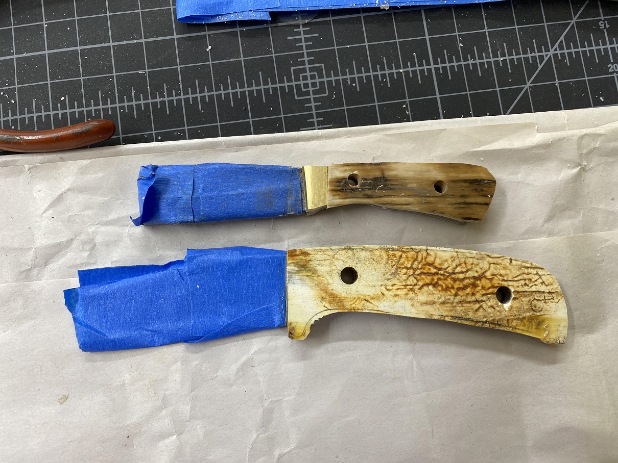

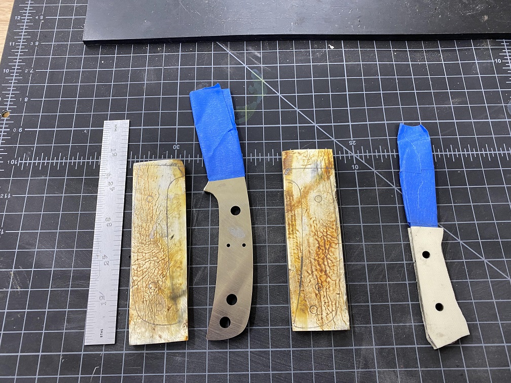

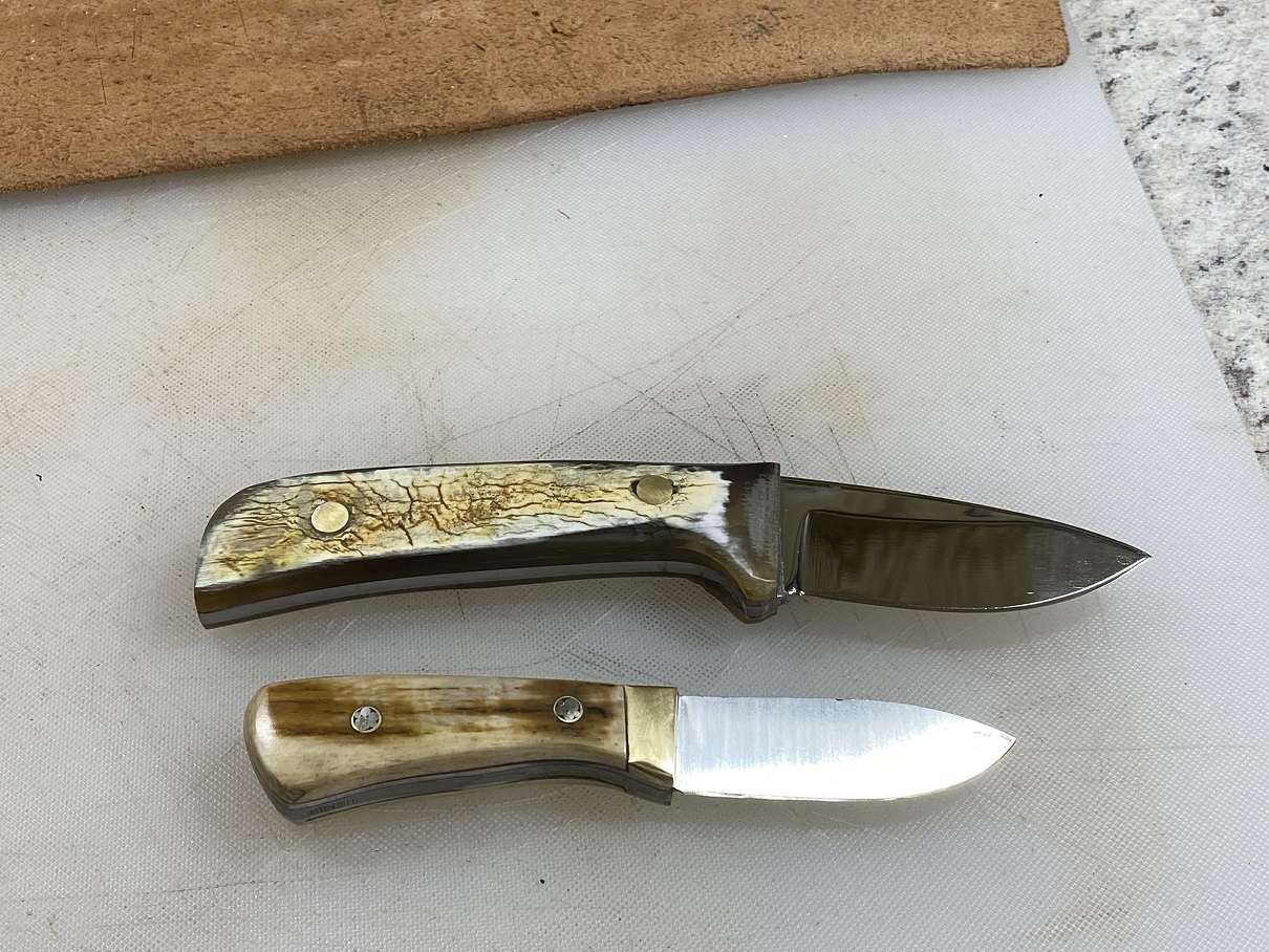

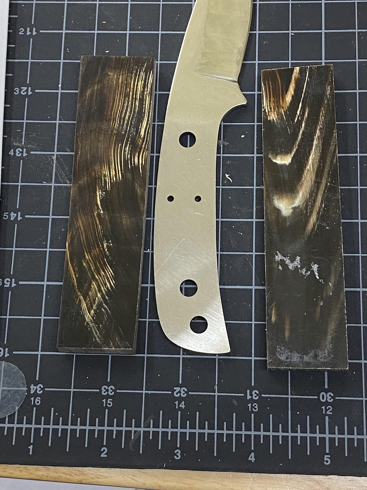

The ivory scaled knife is about 5-1/2 inches overall. Very light. The Ox Horn knife is about 7-1/2 inches overall and has some weight to it. :P In the picture below you can see the G10 liners have been roughed out and added to the blank for the ivory knife and the Ox Horn scales are laying beside the blank for the larger knife.
01 layout.jpg (393.96 KiB) Viewed 1118 times
Later in the process, both blanks have begun to take shape.
05 one side roughed out.jpg (451.46 KiB) Viewed 1118 times
For a side by side comparison of size, this pic gives you a feel... they are completed, sort of. More finish work and polishing took place.
07 completed pair.jpg (482.24 KiB) Viewed 1118 times

I was just disappointed that it didn't continue thru the horn. It was lost when I started shaping the scales and rounding the edges. ;)
But, that's how you learn. I have a buffalo horn scale and I'll use it later, and see if the same thing happens.
buff horn.jpg (665.46 KiB) Viewed 1077 times
I have to decide which knife blank to use it on and if I want to combine it with a cocobolo or some other wood for a nice contrast, or just make another full bone scale. Once I start shaping THIS one I'll find out if the accents leave like the Ox Horn or they go all the way thru.

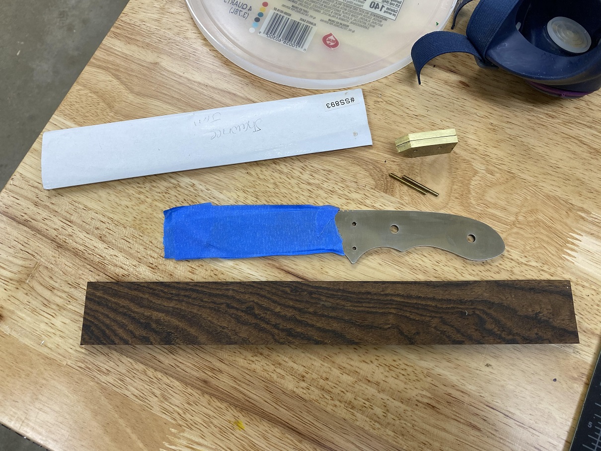

Just so's y'all know... I'm starting on the next project.
It's another Shawnee Knife
This one, for me. It's going to be a challenge to make it as nice as the Doc's but I'm going with Walnut. Brass Bolster again, but maybe some accent?
01 getting started.jpg (483.98 KiB) Viewed 664 times
So far I have just polished the edges of the brass and chosen the wood for the scales. I am still fiddling with layout, thinking about maybe some horn for an accent strip between the walnut and brass. Maybe ebony or ivory. Don't know yet. Or, at the very end, an inlay in the right panel. Who knows.
I like a challenge. I have decided I'll do a pancake sheath.

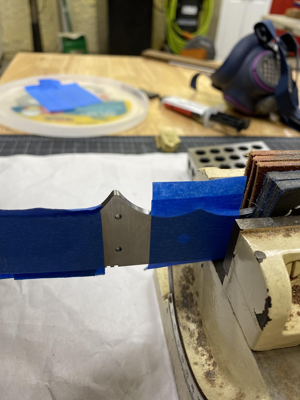

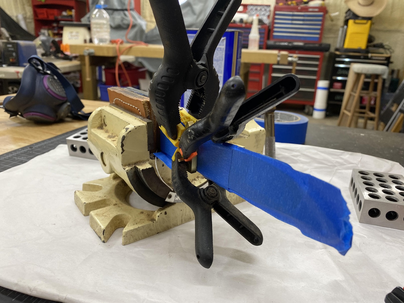

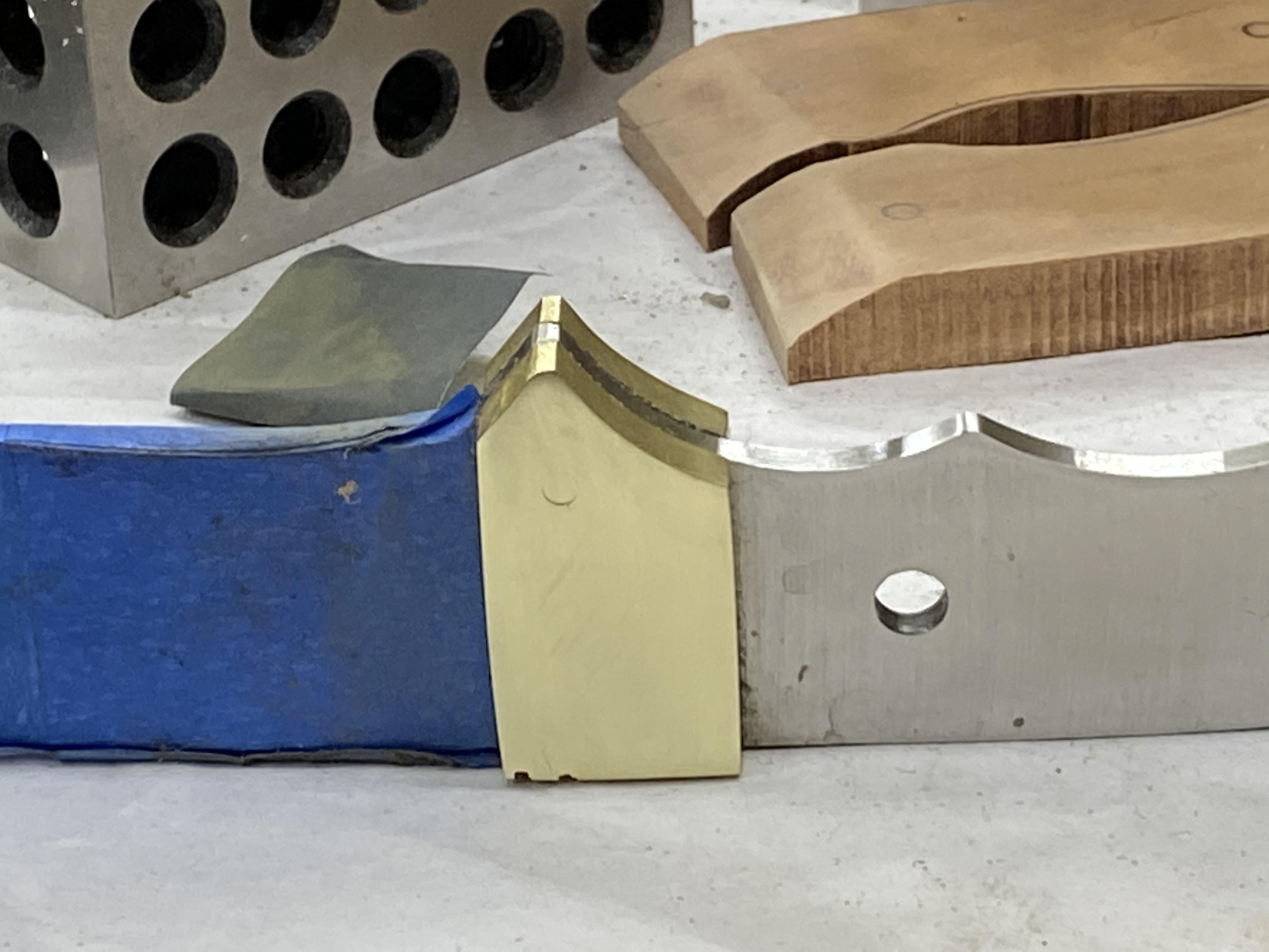

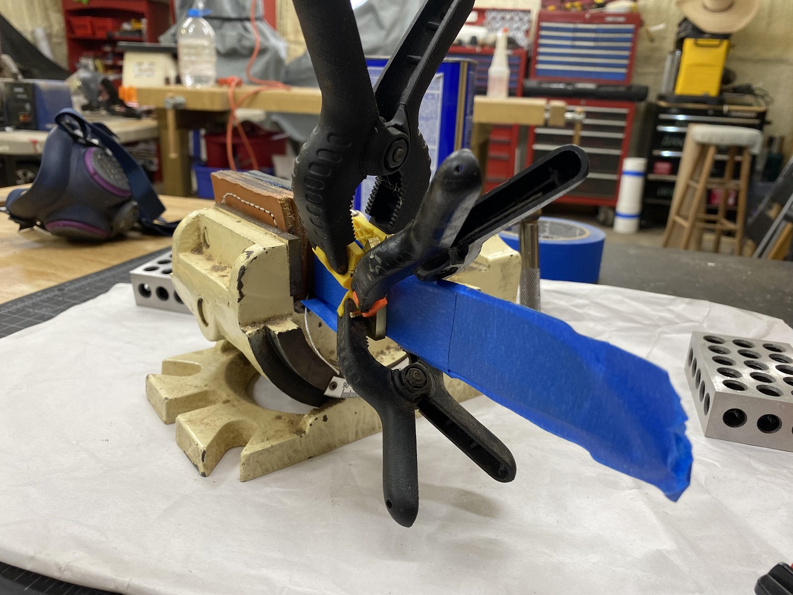

I prepped the rough Bolster, then taped off the blade blank, and epoxied and pinned it and let it sit in the clamps for about six hours. Then I shaped it and buffed it to 600 grit to give it a bit of polish before I started on the scales.
I used the painters tape to identify the area for the epoxy application:
02 taped off for bolster.jpg (490.17 KiB) Viewed 656 times
Carefully applied the epoxy, then the rough bolster blanks seen in the pic #1 above. The front edge was polished to 600 grit before starting to avoid marring the blade later.
03 bolster pinned and epoxied.jpg (531.06 KiB) Viewed 656 times
The next step was to carefully shape the curves of the rough bolster to match the blade blank. Sand and shape, then check. Sand and shape, then check.... repeat until:
04 curves shaped.jpg (207.09 KiB) Viewed 656 times
The sharp edges of the bolster will be rolled and polished to a high gloss in the last phases of the shaping of the scales. For now, the bolster is polished to 600 grit. I'll take it to 1,000 later in the process.

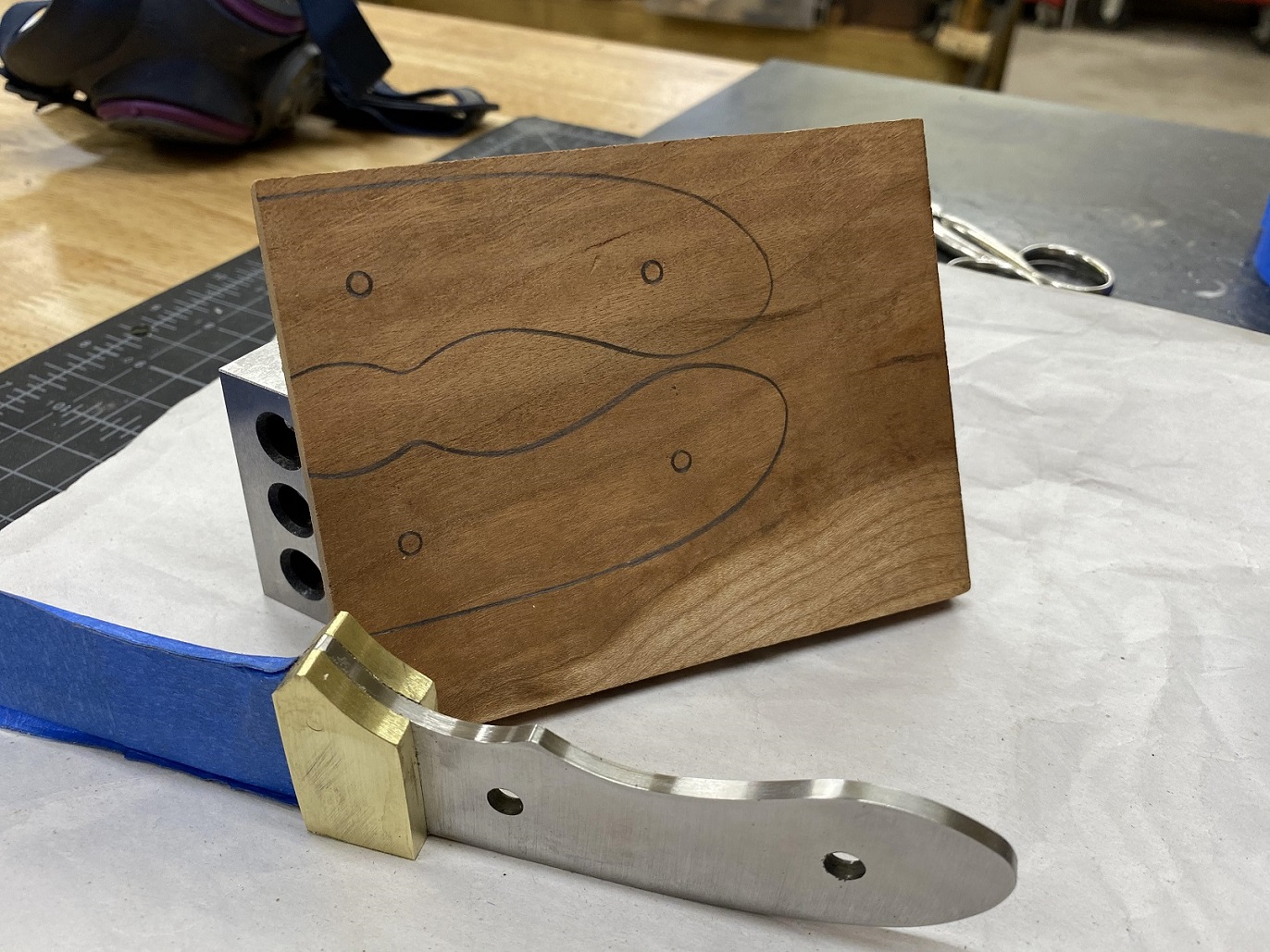

After careful inspection I rejected the walnut blank I had planned for the scales, and selected instead a curly cherry blank. I marked and cut that, and did some test sanding and fitting, but nope, didn't get it.
05 curley cherry marked.jpg (452.03 KiB) Viewed 656 times

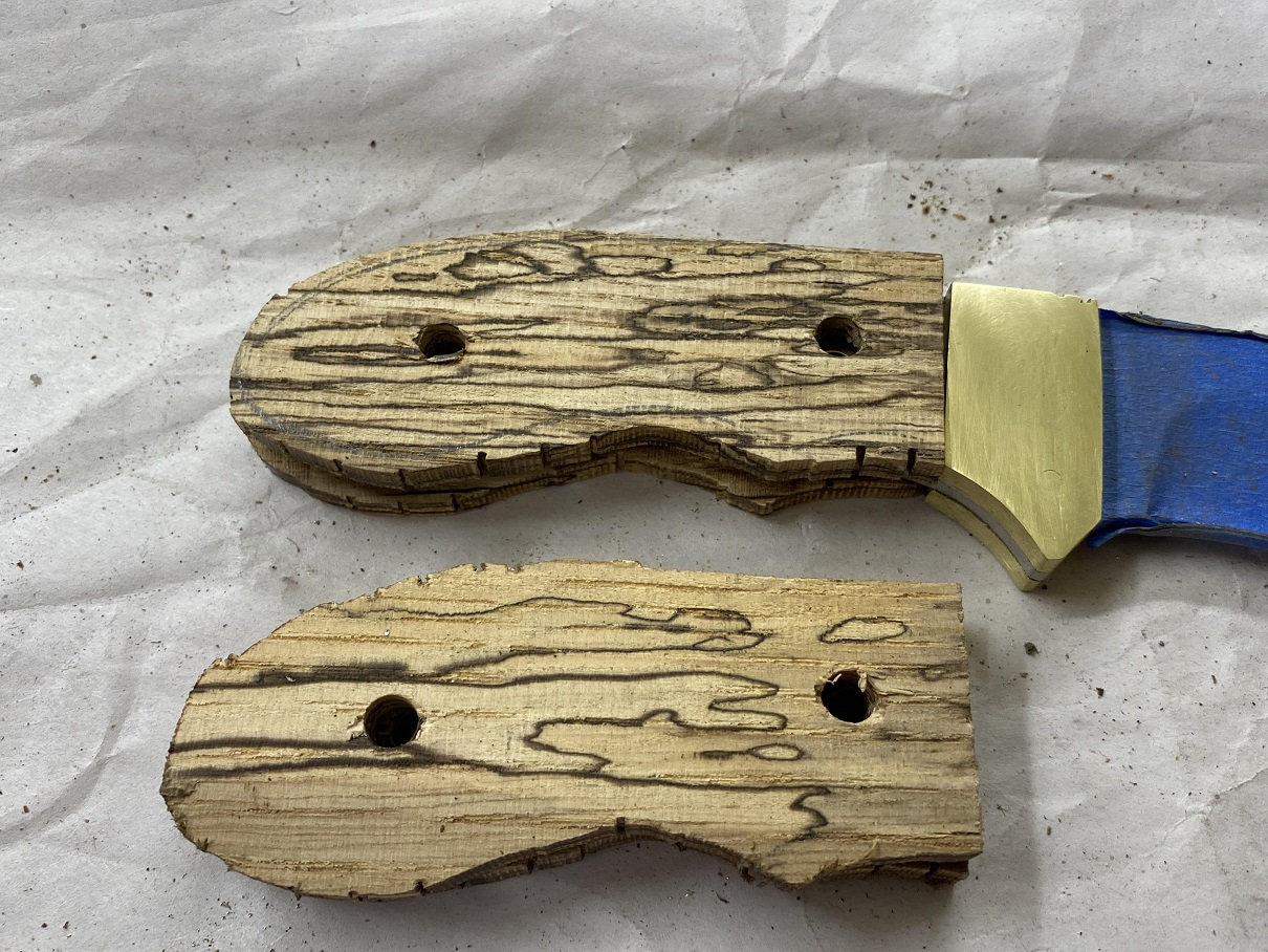

I went thru two drawers of small wood stock to find a piece that caught my attention. Nope. Nothing spoke to me. Then, 8-) I remembered the spalted maple I had run thru my band saw mill before leaving Virginia. A silver maple we planted when we first bought that farmhouse, had become infested with bugs and spalted. We had to cut 'er down. This would make the knife a memory of the former place. I chose a highly figured piece and marked the two scales.
This should be good. The only downside. I think Miss T will steal my knife. :lol:
07 spalted maple options cut.jpg (483.86 KiB) Viewed 656 times
I bookmatched the pairs so I ended up with two sets. I like the upper set with the tighter grain. Hmmm, I may have to order another blank and bolster from Jantz.

** Note, they are just laying there, there won't be a gap when they are mounted. ;)
