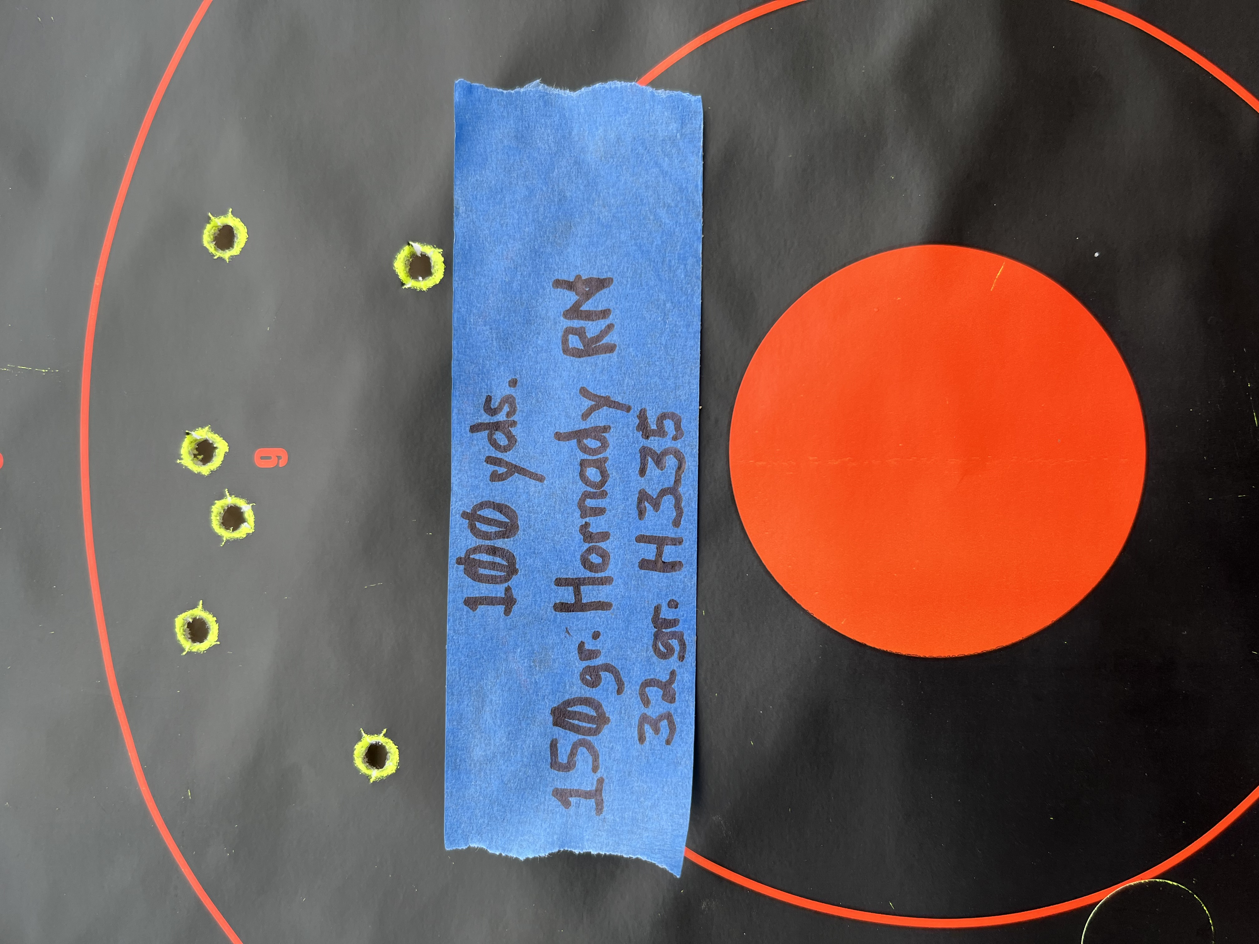

For funsies, I shot some factory rounds and reloads of 150 grainers at 100 yds., mostly to fireform some brass. Not really groups to be proud of, but again, with iron sights and my eyes at a hunnert, I'm okay with 'em....... ;) Don't plan to actually shoot that far on a hunt if I can help it.
From some groups of rounds, I was having the primers "back out" somewhat. Probably as much as 015" or so? No mushrooming of the primer, or craters around the firing pin divots. These rounds all fed, fired, and flung out reliably. Some were different factory rounds, some were my "starting point" reloads. With the reloads, as soon as I upped the powder charge, the backing out was pretty much not happening. I've read that this occurs in lot of .30-30 rifles, and for the most part, isn't really anything to worry about. It seems to be the nature of a beast for a cartridge that's sized to fit ANY chamber of ANY .30-30 rifle, is designed to headspace on the rim, and sometimes loaded to "safe" levels for older guns out there in service. Again, not really anything to worry about given no other signs of excessive pressure I mentioned above.
Even with my old eyes and iron sights, I noticed a kind of "trend" with some of my reloads. The rounds that I've shot before then resized tended to group a bit better than with the cases I was given that were shot from another rifle, or some factory rounds. These were the rounds that I set my FL sizing die up a bit from the manufacturer's recommendation ("Raise up the press' ram, screw the die down until it touches the shellholder, back the ram down, then screw in the die another half-turn"). I (and many others) don't do it that way. The catch is you do need a way to measure your fired and resized cases to do this right.

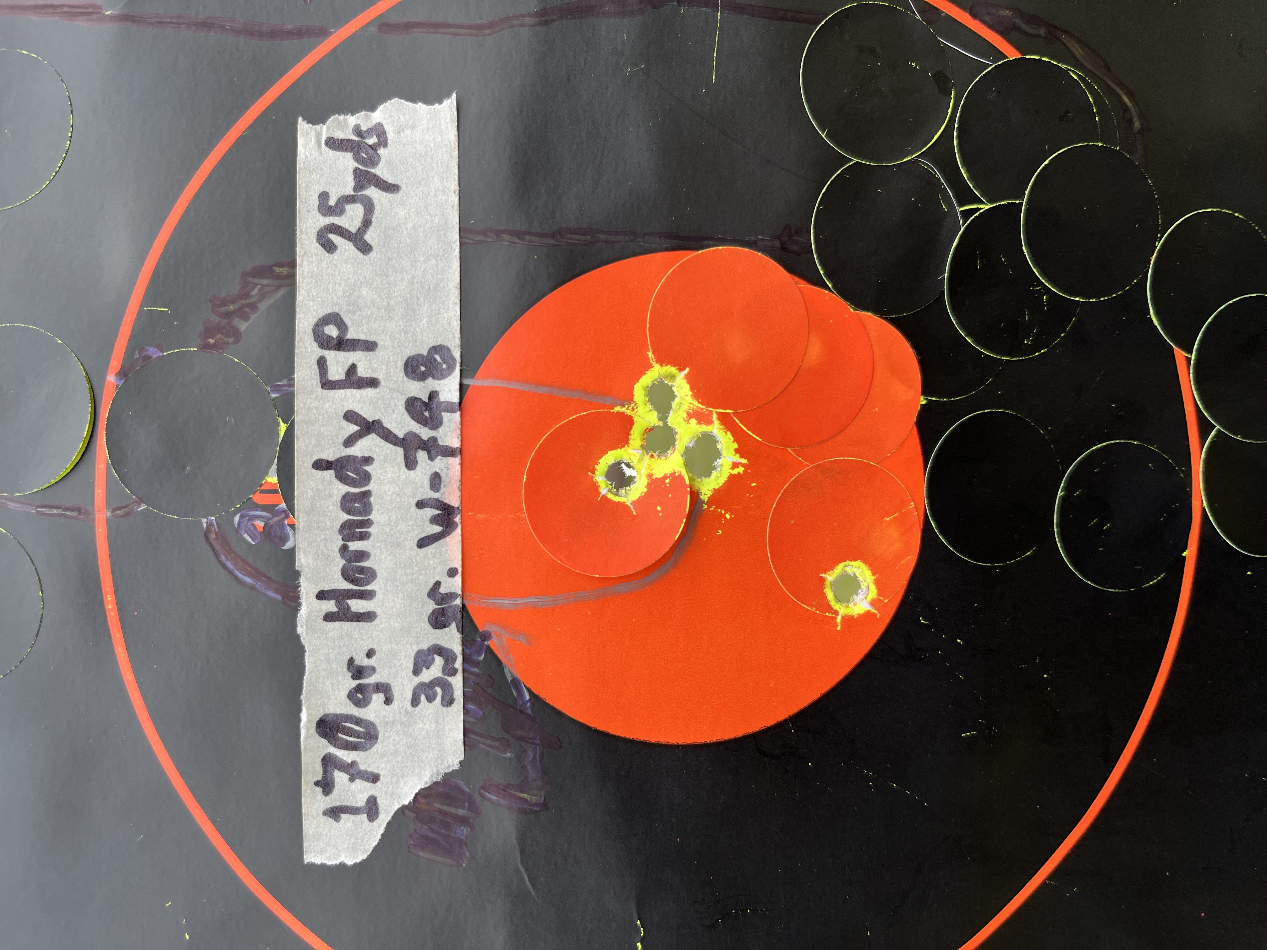

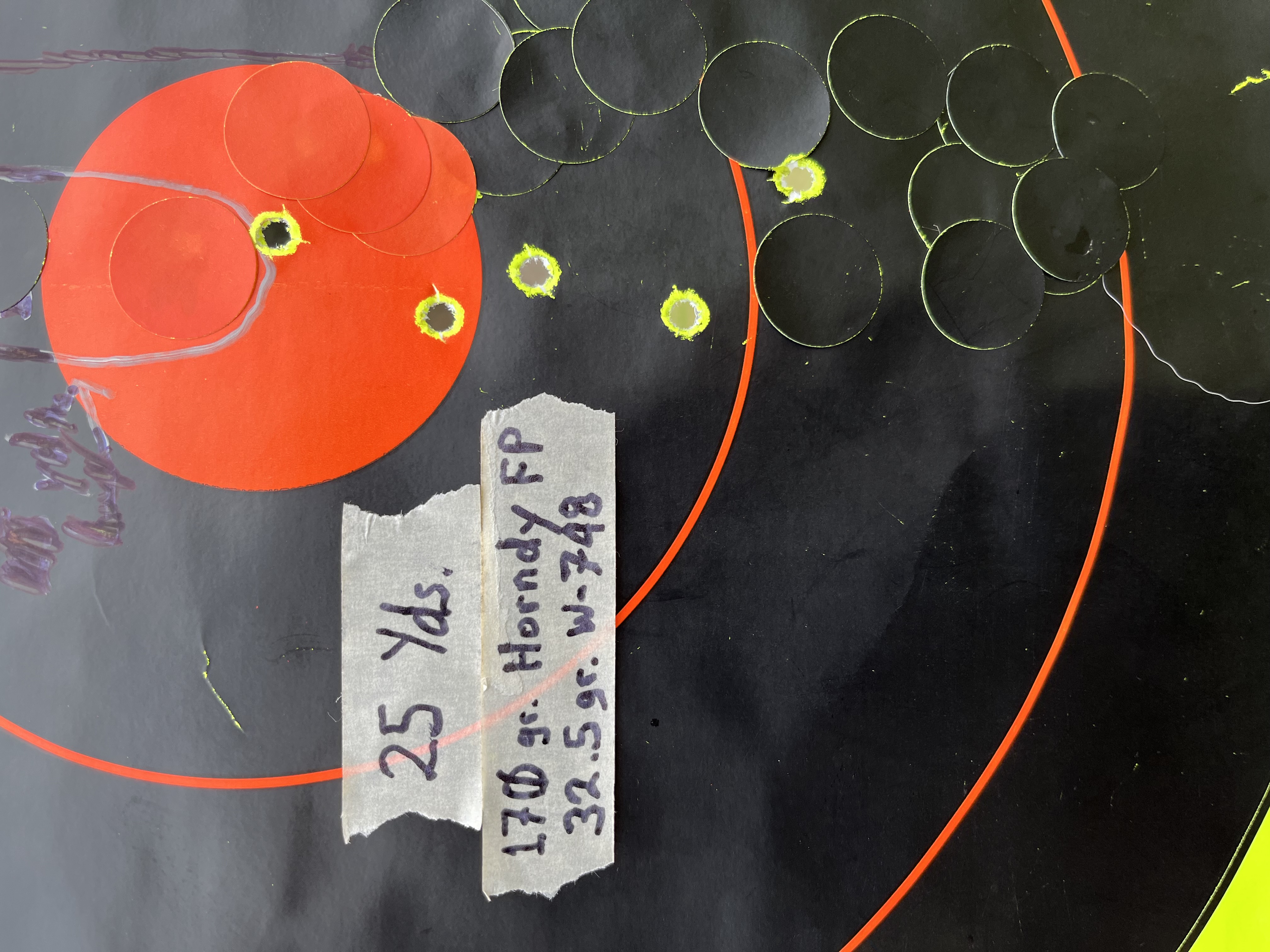

Mr. N, heck of a write up on 30-30 load development. Nicely done. My standard load for the 150 and 170gr Hornady FN, has been 33.0-34.0gr Win 748 with a mag primer to give that 748 some kick. And it works. Very accurate in my Mod 94 Winchester. 30-30's are a hoot.

Thanks, Rifletom, and thanks for the load info. Very much appreciated. I am slowly "workin' my way up" on the powder charges. I'm thinkin', for now, I'll have to settle for the Hornady 170s and whatever-powder-charge works best. Nice to know that I may still have a grain or so more powder to stuff in there. Were you shootin' 33 or 34 grain of w-748 in the 170 load?

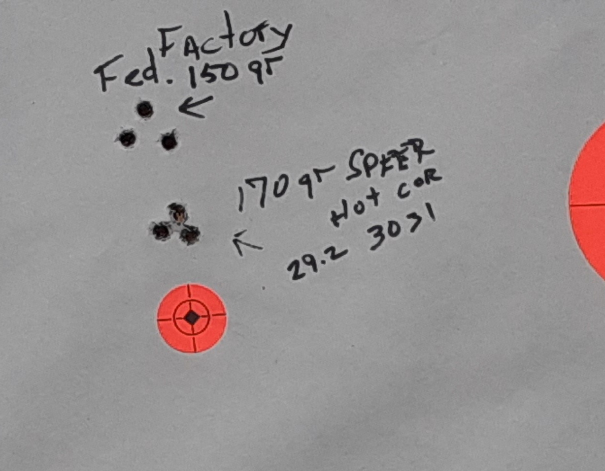

Good write up for sure, myself I've been using Sierra's 170 gr Pro hunters, and Speer Hot cor in the 30-30's and the Marlin 308 MX.
Have yet to lose an animal, or recover one of those bullets. In the 30-30's it's been mostly 29.2 grs. of 3031.
I did work up a load for one of the 30-30's using 748 with the same bullet and it was around 29.5 for the best accuracy.
I do have a 100 each of 150 gr pills by both companies, but as of yet I haven't tried them.
This was last year right before our deer season.

I haven't looked in a while so I'm not sure. I still have one and a partial box left.
Also several boxes of the Sierra's, probably enough to last me the rest of my hunting days.
