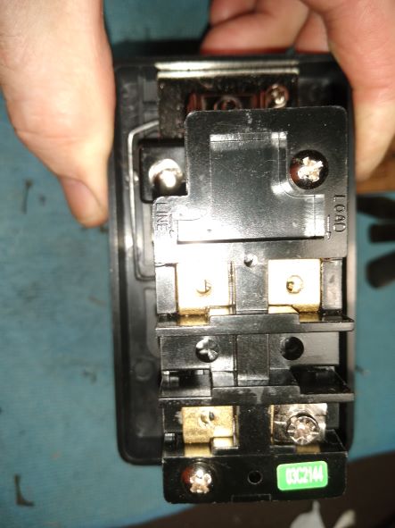

I have an old lathe and all of a sudden my on/off switch doesn't work. I can turn it off and it still runs. Okay, so I ordered and new switch and wired it incorrectly because the breaker tripped. The old switch has poles with the white wire on the bottom on one side with the black on top. The other side has two black wires (?) top and bottom. I didn't wire it originally as I purchased it that way. My new switch has the "load" on the one side and "line" on the other. I think that "load" is the side that goes to the motor and "line" is the side that has the power coming to it. Correct me if I'm wrong.

... My new switch has the "load" on the one side and "line" on the other. I think that "load" is the side that goes to the motor and "line" is the side that has the power coming to it. Correct me if I'm wrong.
that is correct

When in doubt, I would use a multi meter (they can be very cheap and still do this job) and ring it out- See which contacts have continuity make and break as the switch is operated. Black wires are generally hot on machines, the white one is probably a return line to provide for a light.. Is the switch illuminated when it's on?
Anyway, to avoid further surprises I'd check continuity and make a note of how it works. Then connect it up.

I looked up the wiring diagram and got it working. I was right the first time but don't know why it was tripping the breaker. I guess I didn't have a wire tightened down or perhaps something touching that should not have been. Thanks for all the replies.
