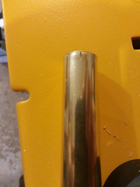

Seems to me like my .45-70 brass fails much sooner than my .357 magnum or ,44 magnum brass. Sometimes after just 3 reloads, I have a failure. Always the same kind - a split that begins in the case mouth. Even though just a small split, I choose not to use them again. So far I have only used Remington and Starline brass. Just curious if anyone else has noticed this behavior with your .45-70 brass.

That type of split tells me you are working the case mouth too much. Maybe try less of a crimp and use the minimum flare at the case mouth. Just use enough flare to get the bullet started. Hope this helps.

I have Federal, RP, and WW brass and I do get split necks but it is very rare . Some I have reloaded five or six times. What brand of dies are you using?I have Marlin G.G .but most of my 45-70 shooting is done with my Rolling Block some of it with black powder duplex loads.

I have 'nicked' 45 colt brass that looks similar. My mistake in not having the case mouth aligned when putting it into the RCBS Prep Center deburring bit. I inadvertently lowered the case mouth on the edge of the bit instead of inside it. The cutting edge snagged the case mouth nicking it.
I use Lee dies.
The only rifle I use for these is my Henry BBS .45-70.
The cases do not split during the reloading process. The splits appear after the rounds were fired but I went ahead and cleaned the split brass with the other brass.

I think you may be missing the point. The reloading process overworks the brass and make it weak and brittle. Then the brass splits when fired next time. So back to my original post and try less crimp and less flare.
