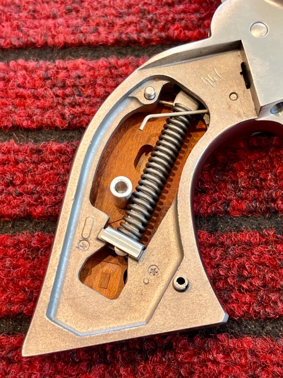

I finished my volunteering late this afternoon and thought I would shoot my New Model Single-Six. First a quick lightening of the trigger. It must have taken me a full 60 seconds!

Yes indeed the poor mans trigger job! All my SA Rugers have that and works great. Nice group of Treaters there!

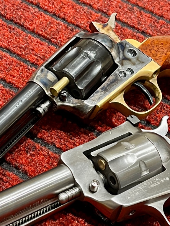

I’m still getting used to it. Tx Gun Rn told me the Uberti is a better firearm than the Ruger because the cylinder is reamed different. The casing easily slips inside the front of the Ruger cylinder because it’s the same size as the casing all the way through. The Uberti is only reamed as far as LR casing and the rest of the cylinder is the bore of the barrel. This picture demonstrates that however I’m not sure that it makes any difference. I think he was saying there is less blowby in the cylinder and when it jumps the gap there is less variance.North Country Gal wrote: ↑Sat Oct 29, 2022 8:06 pmHey, for a pound of treats, I might even show up. I'd have to get costume, though.

Gene, yes, I remember that argument from our old friend about the absence of a constriction at the end of the cylinder in Ruger 22 LR revolvers affecting accuracy. I have had some late 50s vintage Single Sixes that did have a constriction at the end of the chambers and they're quite accurate. On the other hand, I have had some current production New Models without that constriction that were every bit as accurate. In fact, I've had a few New Model SSs that would shot as well as a fine target semi auto 22. Bottom line is that I would regard the presence or absence of that contraction to be a minor factor in accuracy.
Having owned probably two dozen Ruger Single Sixes over the years, I can safely say that you may or may not get match grade accuracy with any given Single Six, but you will always get useable accuracy for at least plinking and practice purposes. And, yeah, you may very well get that match grade accuracy, but you won't know until you actually load any given SS and start shooting.
The caveat, here, though, is to use quality ammo when testing for accuracy. I know you like the CCI Quiets, but that is definitely NOT ammo for accuracy testing and that is based on shooting for groups with a wide variety of guns. It even makes my match grade 22s look bad. At the very minimum, you should be using CCI SV for accuracy testing. Better yet, step up to some match grade 22 LR target ammo. Made a night and day difference in some Single Sixes I've shot.

I don’t think John was convinced of his own argument about accuracy. He was more concerned with tolerances. I do know my Uberti will not cycle if there is any debris in the least in it. When loading the cylinder I have to push the ammo firmly all the way in.North Country Gal wrote: ↑Sun Oct 30, 2022 11:01 amYes, it would, assuming you have a New Model Blackhawk. The Old Model three screws had different action, so it only applies New Models. Give it a try.
