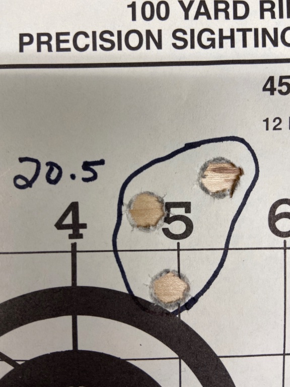

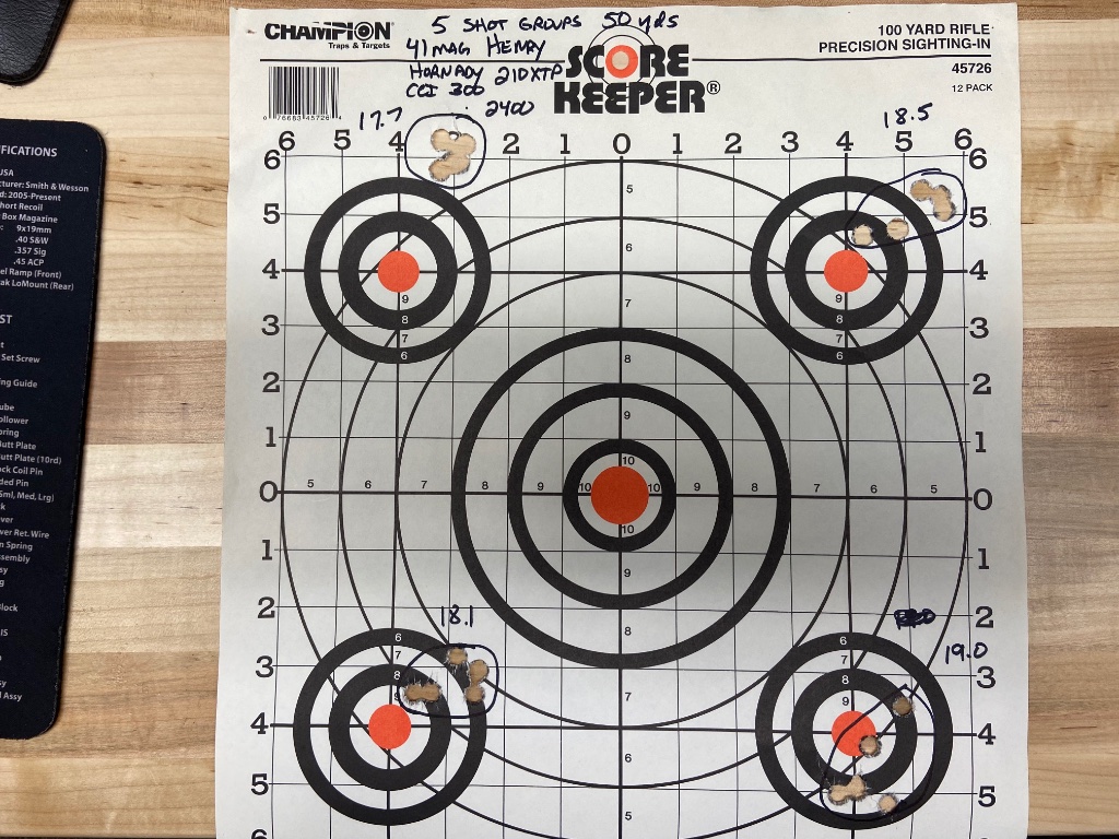

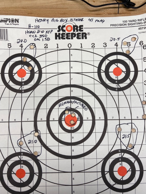

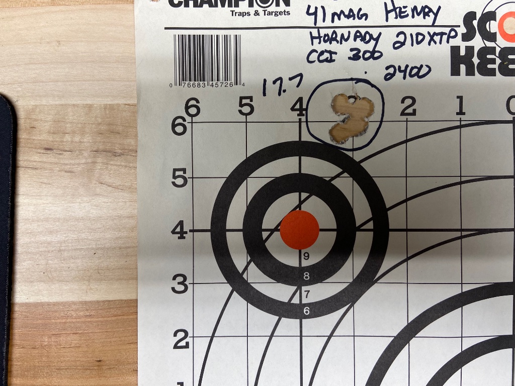

I have some experience loading the 210 XTP and will show the results below. I started with H110 as that was all I could get and on the advice of Big Al I switched to 2400. Better results with 2400 but the H 110 wasn’t horrible. I found the lower velocity 2400 load grouped best but the upper limits did fine. I don’t plan on using my 41 for hunting so I didn’t load with velocity in mind more for accuracy. But I’m sure even the lower velocity 41 mag XTP’s would do a deer justice within the proper range.
Here’s pics of my load devolvement targets showing the components and the charges. If your pic is too small to see the info let me know and I’ll type it in.
First up the H110.
Here is the result with 2400
Posts: 12120
Re: 41 Mag, 210xtp
Post by Vaquero » Wed Oct 26, 2022 10:55 am
Thank you Hatch, that's what I'm talking about.
Good starting points, 👍
I have more 2400 than H110 anyway. 😉

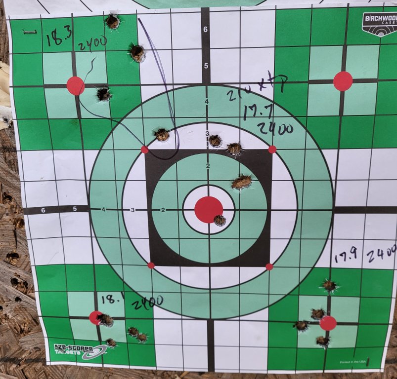

Post by Vaquero » Wed Oct 26, 2022 7:56 pm
Well I got home in time to try out a couple loads.
Stated with the 2400, 17.9 to 18.3.
Five shot groups all from 55yds.
Have tomorrow off so will do some more. Thanks again Hatch, for the reference. 👍
