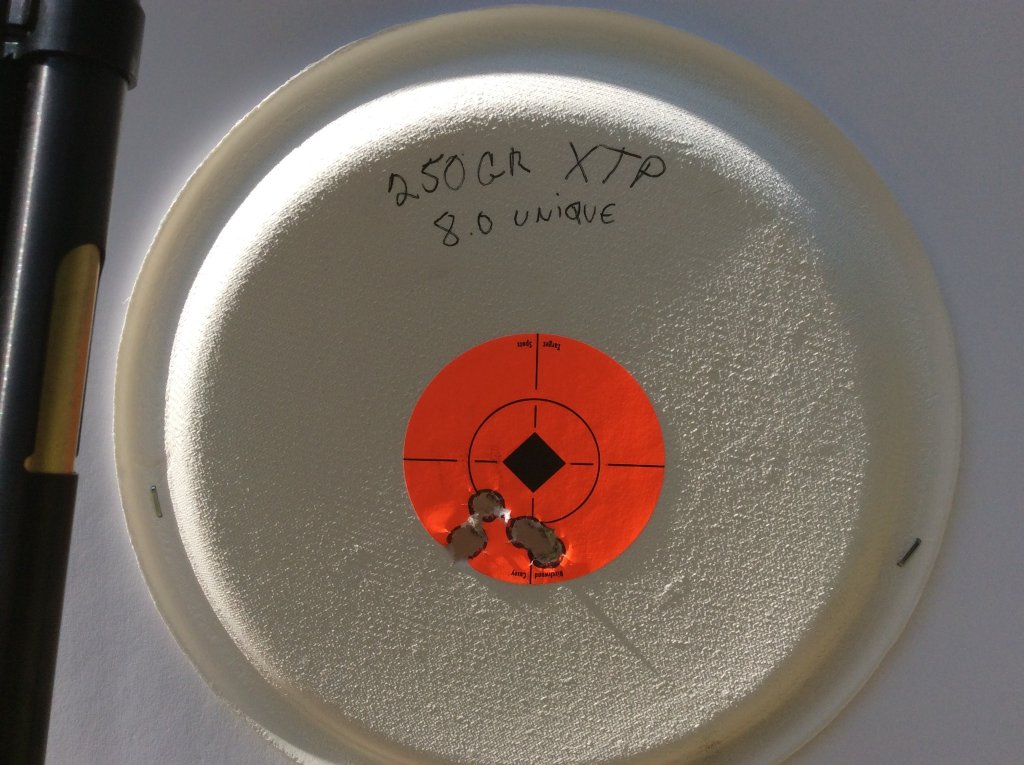

Here is result of the 250 XTP loaded over 8.0 Unique shot out of my Henry X Model 45 with suppressor attached. Speed was below 1100 FPS and expansion was good plus the group is great!
THE load for business 250 gr XTP  45 Colt thru the Henry X Model from 35 yds.jpg

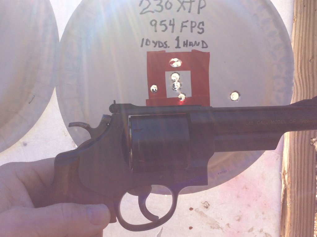

The 45 ACP 230 gr. XTP bullet can work very well too in 45 Colt. This load running within 45 ACP pressure with 9.2 Unique with 45 Colt brass in my S&W Model 25-7. Would work fine in rifle/ carbine at standard pressure.
