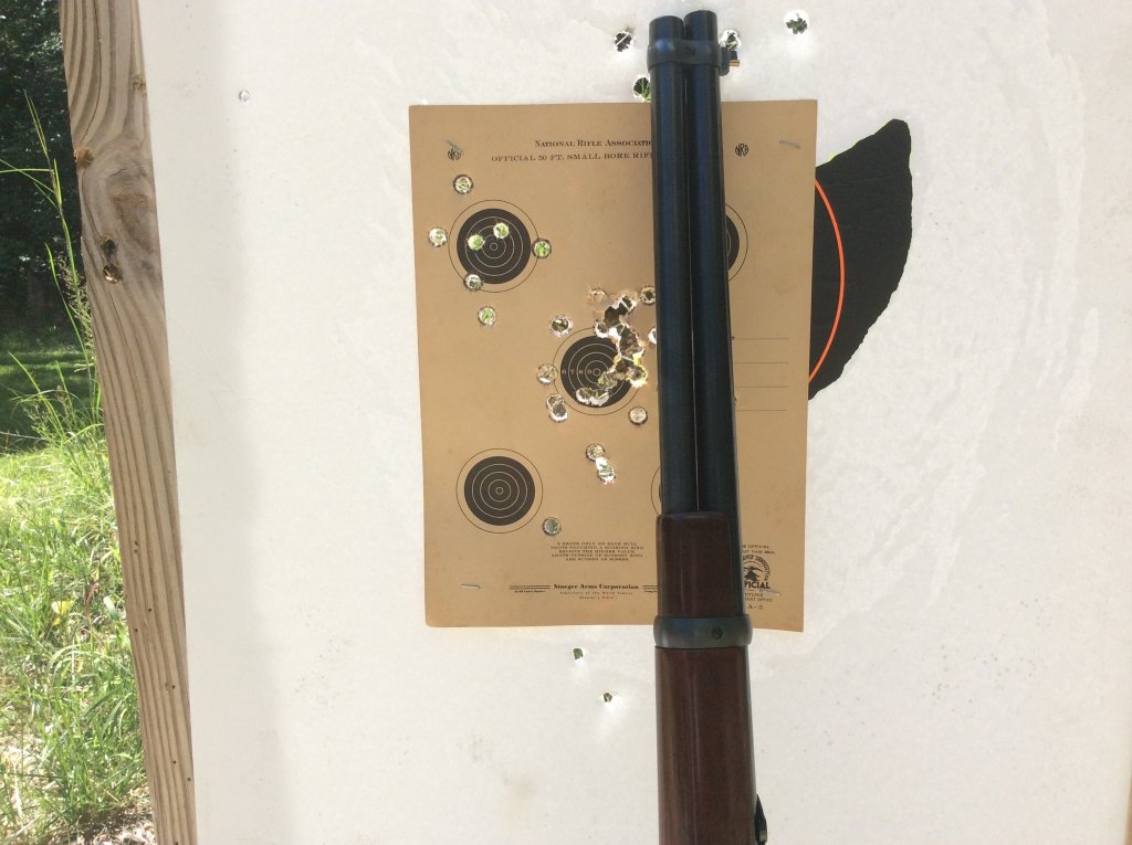

My go to plinking .44 mag load is 200 gr Xtreme plated RNFP with 9 gr. Unique for my Uberti 1873 carbine.
44 magnum 200 gr xtreme with 9 gr. unique    upper left 10 yd ruger sbh and center uberti 1873 carbine 20 yds.jpg
44 magnum 200 gr xtreme with 9 gr. unique upper left 10 yd ruger sbh and center uberti 1873 carbine 20 yds.jpg (105.49 KiB) Viewed 1537 times

With the Xtreme 200 gr RNFP I set the length to 1.565 I use the Lyman 49th,Speer 13 and follow load data I have collected from Hand Loader magazine
articles such as Brian Pearce. Some rifles and handguns like certain bullets and I found the Xtreme plated bullet gave a much tighter group than the 200 gr RNFP coated lead Missouri Bullet I was using in my 1873 Uberti carbine.
