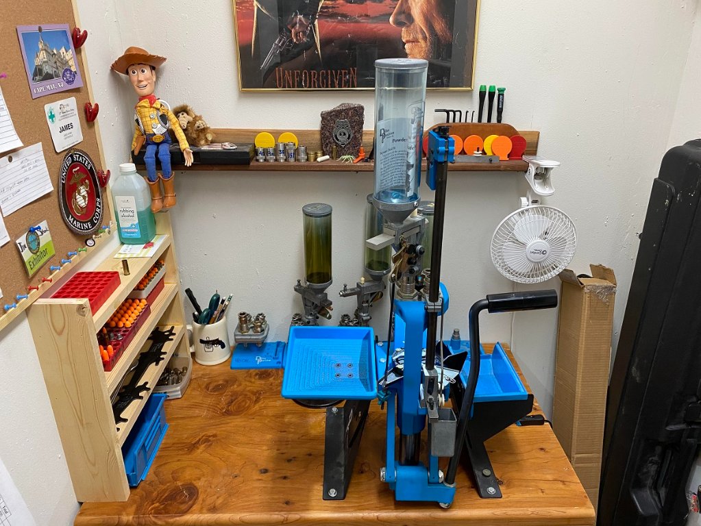

I discovered a couple problems.
We moved to OK from VA back in May of 2020, and I had broken down the loading bench a few months before that and packed it all away in preparation for the move. It all sat in storage for several months until I decided where I was going to have my loading and ammo storage room, and then found the time among the settling in to arrange it, and set up the bench and press. I finally did, but that was that...

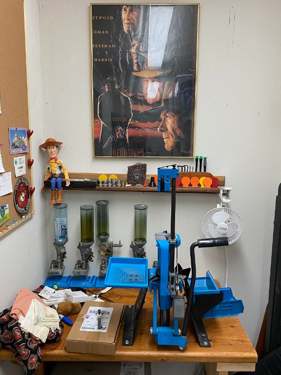

To stay busy, I knocked out the little shelf on the left here, which really neatened up the bench. I made it sturdy but didn't worry about painting or staining. It needed to be functional.

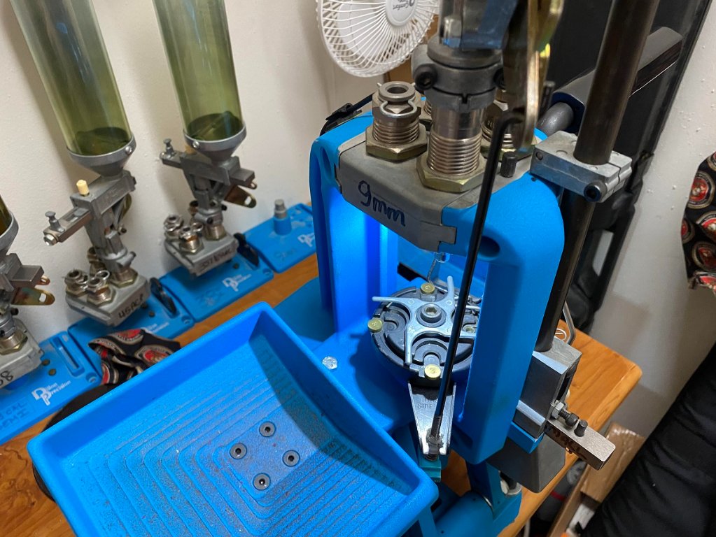

A peek at the LED light that shines down thru the hole in the center of the toolhead on the dillon press. The tool head stand uses the hole to hold up the tool heads when not in use. Some innovative designer created a small LED light that pressed down in the hole and lights up the work area on the press, illuminating the four die stations. Brilliant. I ordered mine years ago directly from the company but Dillon Customers can now order theirs from Dillon's Website. Change the toolhead, pull the light back out of the way, swap the toolhead, and then push the light into the new toolhead. Sweet. :)

That’s a nice neat clean set up and I love the Woody doll on the shelf! :D

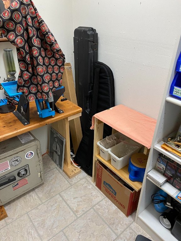

Been in the shop this morning working on another shelf to fit the 12x20 space to my right when I'm at the press. I'll put the press there and have additional storage for loading related items underneath. Glue is setting now. I probably won't paint this one either as very few people will ever see this room or know it exists.

Got the shelf finished and installed to the right side of the loading bench. It's sturdy and serviceable, but I didn't paint or stain it at this point. As I said, very few other than Miss T and myself will ever see this room or know it exists. The shelf will hold the reloading scale on the top shelf and it's associated tools, like verification weights. On the center shelf is the trash can, and a second box that will eventually hold mixed brass waiting for sorting. I just haven't cleaned off the old labels yet. (Hoppes works wonders.) ;) That blue coffee can holds 1,000 9mm bullets waiting for the scale to arrive. Yup, we are getting set up.

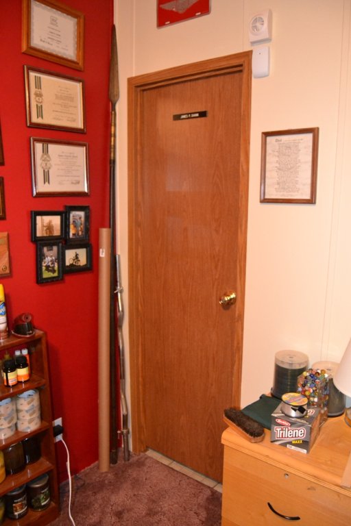

In my old Office in VA there was a long deep closet that was originally two walk in closets when the kids were at home. We moved that wall over three feet and created a small room behind a single door from my office. Behind that door, which was alarmed, was not only my loading bench, but ammo storage, fly rod rack, and a long gun safe, but much more. The room was about 16' deep and nearly 8' wide. I laughed and told Tina that it's too bad I just couldn't make that room disappear.
01 original door.JPG (99.69 KiB) Viewed 1872 times
Driving back and forth to the Veteran's Hospital for therapy, I started to have that statement ringing in my head. "Slight of hand and make it disappear." Hmmmm? :roll: The Office was heavily alarmed, with glass break, entry door, and motion... and the door to the loading room was alarmed.... but what if the door wasn't visible?

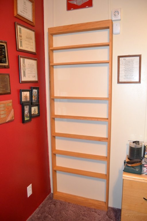

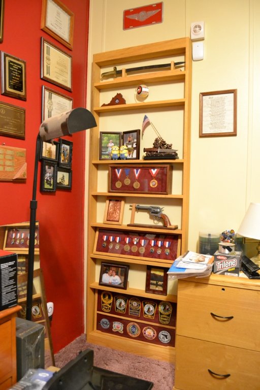

We were going on a ten day vacation and I just didn't like leaving the house unattended, even though there was the alarm system and all the cameras, then it came to me. Slight of hand. I built an Oak Bookcase and put a back on the bookcase the exact color of the wall. I removed all the door trim and the protruding doorknob, installed a deadbolt and flush handle, and then mounted the bookcase / display shelf in front of the door with concealed hinges. ;)
05 new shelf.jpg (92.93 KiB) Viewed 1872 times
Tah-dah, slight of hand. With magnetic latches behind the shelf and lightweight displays ON the shelf, it looked like it was always there. The back on the shelf made it look as if you were looking thru the shelf. It completed the illusion. No-one in the next five years questioned the slight of hand. I added a latch at the top of the shelf for added security to insure it didn't pull away at an inopportune moment.

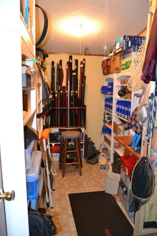

When we put the house up for sale, no buyer questioned the rooms and when one buyer came back to look for the third time, Tina said that it was "Time." The husband looked at her Oddly, but I took HIM alone and showed him the room, telling him that if they didn't buy, I'd appreciate if he'd keep the secret. They bought the house. He laughed and told me he hadn't told the wife about HIS room. :)
02 loading room.jpg (126.62 KiB) Viewed 1872 times
A friend of mine online was concerned about his ammo and firearms and I sent him pics, he designed a similar room under his stairs in the dead wasted space. Only the wife knew, he never told his kids... did the work while they were away at camp. :)
