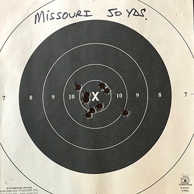

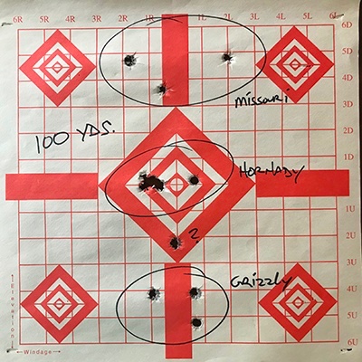

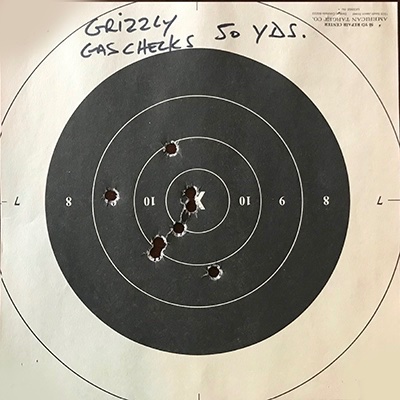

Kissmybrass
Posts: 598
Location: Issaquah
Re: Working up a 45-70 load
Post by Kissmybrass » Mon Aug 15, 2022 11:05 pm
Not sure the grain loads now but the Missouri and Grizzly GCs were charged with IMR 4895 and the Hornady FTX with IMR 4198
All same day with my Henry H010G and a Leupold 1.5-4X scope.
