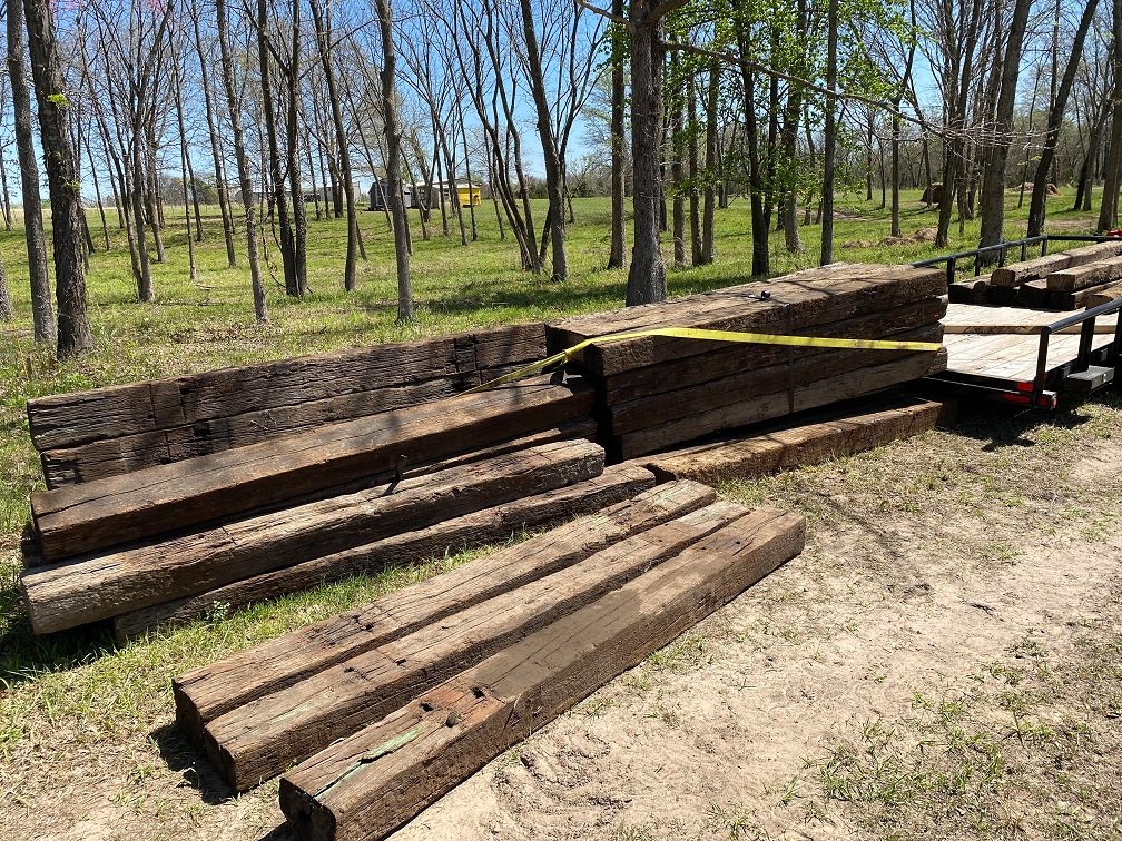

It has been more than a year since the fall that broke my wrist in two places, while unloading the Railroad Ties to start building the Berm for my home range. I would have had nearly 100 yards. :D Oh, wait, broken wrist for the Broken Ol Marine. :shock: :cry:
06 the ties.jpg (379.23 KiB) Viewed 1993 times

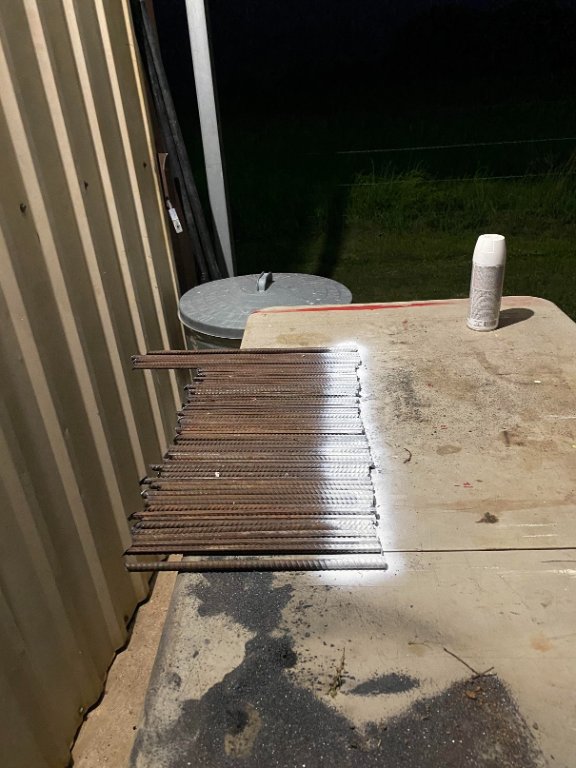

Yesterday, Miss T and I moved the Titan out of the covered carport, and set up a pair of folding tables, the metal cutting chop saw, and got busy on the rebar. We cut about sixty spikes to use to secure the Railroad ties, as we set them in place with the tractor. I cut three 36" long, then twenty five, 24" long. Then reset and cut them all in half with the blade reset at a 45 degree angle so we had a sharp (sort of) point one the end of each half. that gave me six Eighteen Inchers, and fifty Twelve inchers. That should do 'er. Once done, I painted the flat ends white to distinguish these from the almost the right length ones we just tossed in the bucket.
spikes cut 220521.jpg (84.38 KiB) Viewed 1993 times

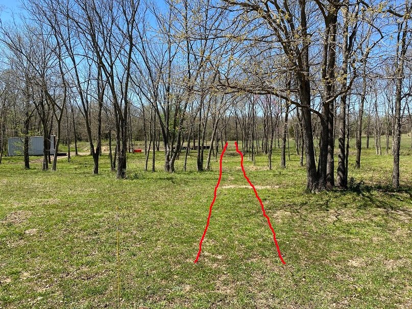

Once we get a nice day again, I'll start setting the RR ties. A year late. ;) Here is a peek uprange from where the berm will sit. The rangehouse (little gray building) is about 95 yards away.

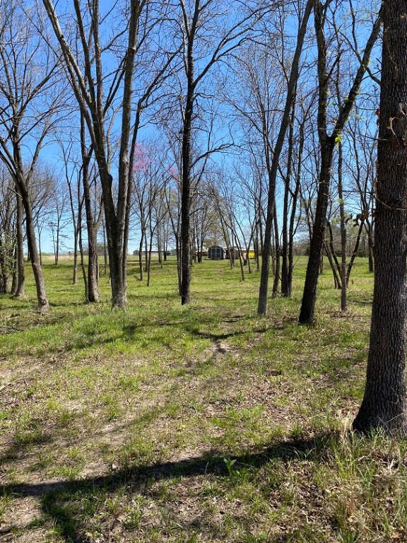

This is the view Down Range...

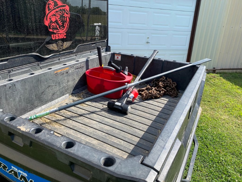

Got at it this morning, with Miss Tina heading down to bush hog around the area we wanted to work in to reduce the chance of snakes, and me finishing my coffee then heading out to load the tools into the UTV. I loaded up the things I thought we might need and turned out I made good choices. We used everything BUT the logging chain... that still might come later. ;)

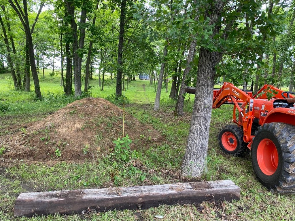

01 tools.jpg (232.24 KiB) Viewed 1201 times

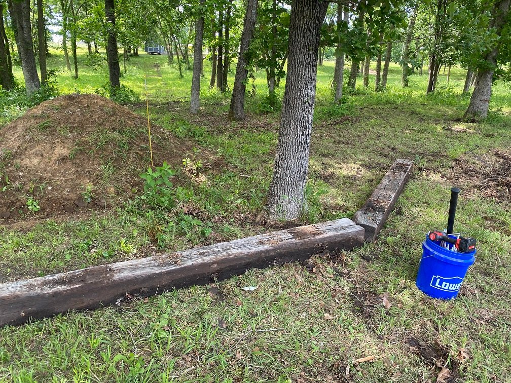

After a half hour spent laying out the exact location of the center of the lane, then deciding where I wanted the first Brick in the wall... (Hear it? I hear it.. the music.... "Just another brick in the wall.) Here she is, the first BRICK in the wall.
02 First Brick.jpg (327.83 KiB) Viewed 1201 times
That first spike was driven in with a fork on the pallet forks. Smooth as butter.

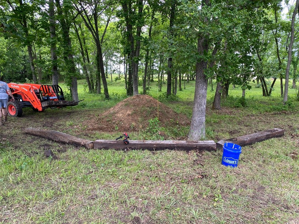

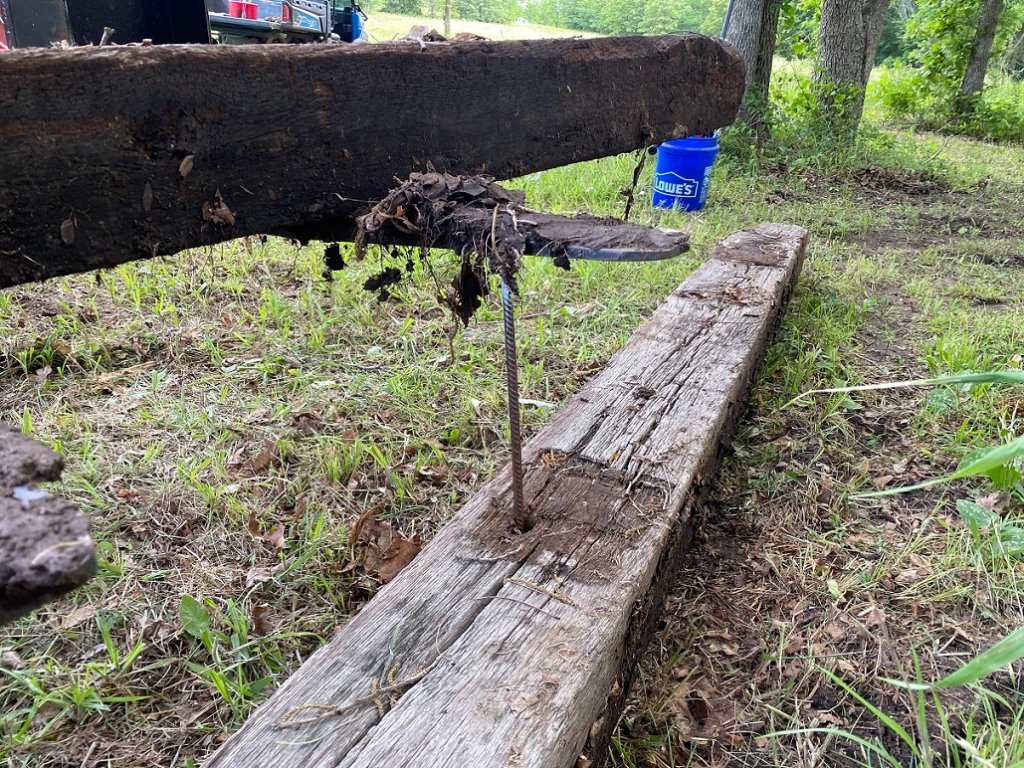

From there it was just a matter of laying out the wings on either side. Get at it, slip and slide the Rail Road Tie after dropping it with the pallet forks. Miss Tina was overly protective and didn't want me lifting or pushing as that right femur has that plate and all those screws in it. The doc warned that if I torque it, ... :shock: :o So... we used the tip of the forks to push and twist, or I levered with the big tamping bar, basically a giant pry bar. I have this cool technique whereas she pulls up and I stab that bar in the ground and when she backs off the RR tie spins against the bar to get the angle correct, then, dump it off. It slides easily on the forks. Work smarter, not harder. The first wing in place.
04 gettin at it.jpg (398.54 KiB) Viewed 1201 times
As each base leg was placed, we drilled thru with the hammer drill and spiked them with 18" spikes. Finally all three were placed and spiked. Tah Dah, an idea what the WALL will look like in relation to the range.

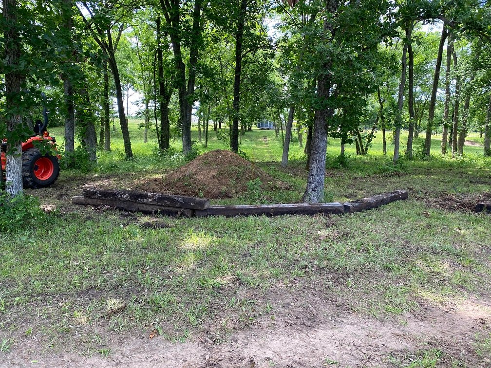

The first leg of the second layer was dropped and spiked into the layer below with a pair of 12" spikes. They will stagger to interlock. The weight of the design will keep them from tilting back toward the camera, and the dirt in front will keep them from going over forward. I plan to set two posts against this side of the center wall as well. Should be pretty stable.
06 a good start.jpg (391.18 KiB) Viewed 1201 times

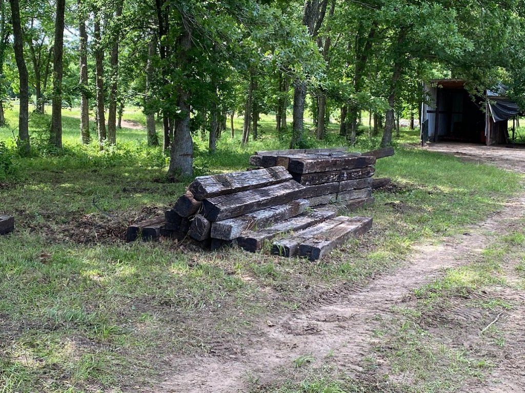

Miss T monitors the old guy pretty close and called it. I had begun to get tired and she said I couldn't chance working tired. There is no rush and we'll split the job up and spread it out rather than risk further injury. THAT, or hire it done. There are plenty more TIES to lay, so we quit for now.
07 plenty more to go.jpg (328.43 KiB) Viewed 1201 times
At least you have an idea where I'm going with this... you see the dirt pile we'll start with. Plenty more around the farm to bring in once we are done with the wall.
