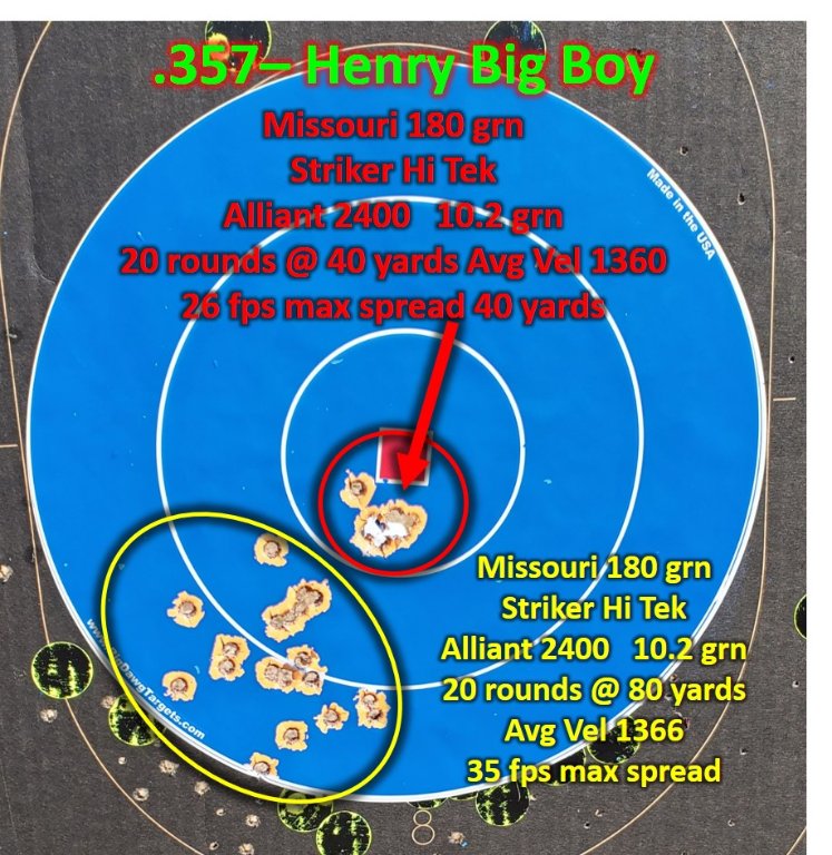

Well, you know I have to put my 2 cents in when you are talkin about Missouri Bullets.
180 grain 357.jpg (144.03 KiB) Viewed 1993 times
10.2 grains of 2400 with 180 gran MB Stikers

Some good shootin RnG. 👍

amazing what you can do with both eyes closed !

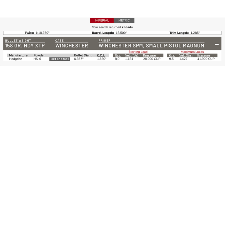

Hornady XTP 158s and Hodgdon HS-6 (9 grs.) have been a fantastic combination for me. Starline and Federal brass. CCI/Federal small pistol mag primers.
Most accurate round I've used in my Big Boy brassie.

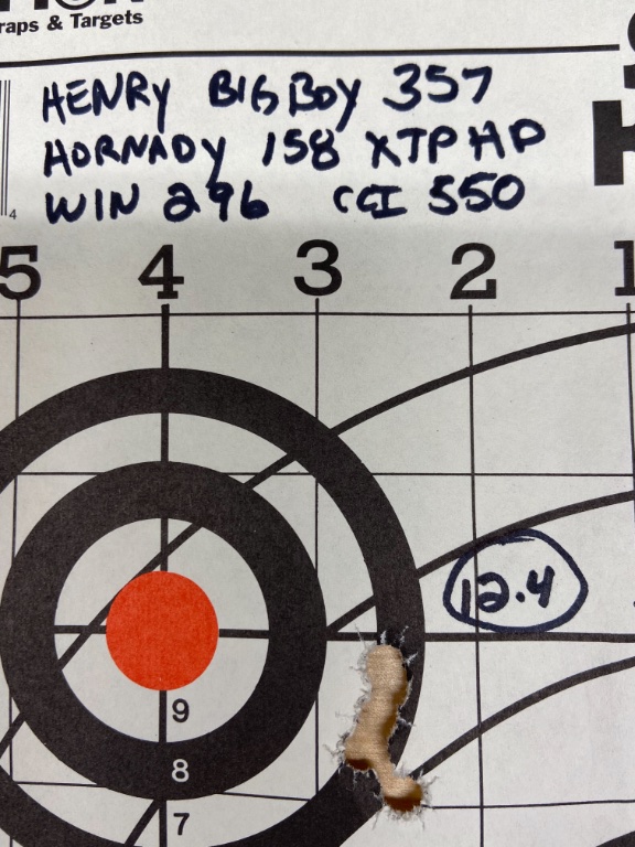

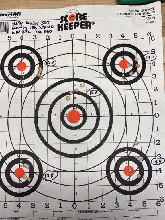

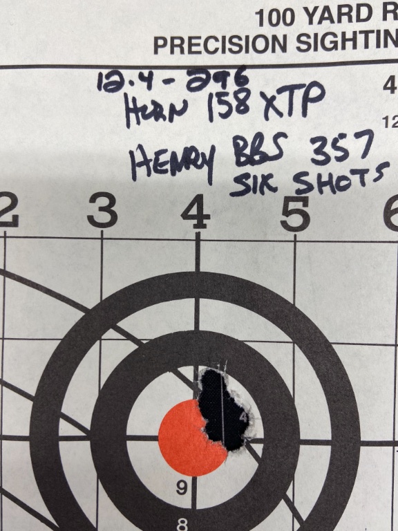

I’ll chime in here even tho I don’t have any info for you on the powders you have on hand.
I have had great success with the Hornady 158 XTP and Win 296. My best group was on the low end of the range of charges I tested so it might be on the light side for hunting. Don’t recall the velocity but can look it up if you’re interested. Didn’t shoot over a chrono so no personal data. Here’s my test target and a close up of the best group. Also is a follow on trip to the range and as you can see the results were the same. Haven’t tried it out in a revolver yet but I bet it will be a nice soft shooting load for one.
All fired at 50 yards from a bench with a 7x scope.

Nice shooting Hatch what range is that shot at

Post by Hatchdog » Sun Nov 07, 2021 10:43 am
Sun Nov 07, 2021 9:48 am
Thanks Al, went back and entered the info but it’s 50 yards, scoped and off a bench. Why yes, I take every advantage I can. :lol:
