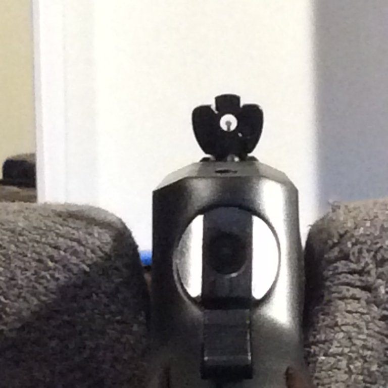

Post by fortyshooter » Mon Oct 11, 2021 10:44 am
Well this works for me on my lever rifles but maybe not the best for 100 yds.
ghost ring sight insert for 44 Henry.jpg (60.21 KiB) Viewed 1787 times

Post by BigAl52 » Mon Oct 11, 2021 11:00 am
I wonder if one of those would work in the single shot flip sight, Im not sure of the notch size I would need to look at it

Post by fortyshooter » Mon Oct 11, 2021 12:46 pm
Take a look Al. It can be ground to any width.

Post by BigAl52 » Mon Oct 11, 2021 8:36 pm
Same one you are making will fit the SS folding rear sight. I looked at my SS today and Im going to leave the red dot on it for now. I like the way it looks and it shoots just fine for me right now.

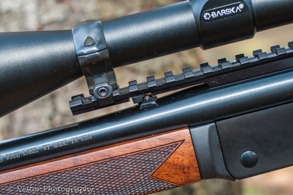

Well I got a rail for the top of the .357. Picked it up at the local shop. The label said it fit Henry Single Shot and Single Shot Shotgun. Well - not so much. So out comes the dremmel. Needed to cut two slots back from the end to get it short enough to get behind the folded down rear site. Then get different rings from the "old ring collection". Got a set that juuuuust allowed clearance for the hammer with an extension on it. Tossed on the Nikon 2X7 shotgun scope. Then Boresight it - the old fashioned way - rifle on bags, open looking down the barrel and adjusting the scope to get it what I think will be "on paper". Took the sling off the 17 HMR too. Now - load up about 20 rounds of 15 grains 2400 under 158 grain XTP's and we'll take a look. For now - here's a couple of pics with her all dressed up....

Post by BigAl52 » Thu Oct 14, 2021 11:42 pm
Looks Good. Keep us post on your load progress
Posts: 12146
Re: New .357 Single Shot
Post by Vaquero » Fri Oct 15, 2021 8:08 am
Looks good Zara, waiting on range report. Good luck.
