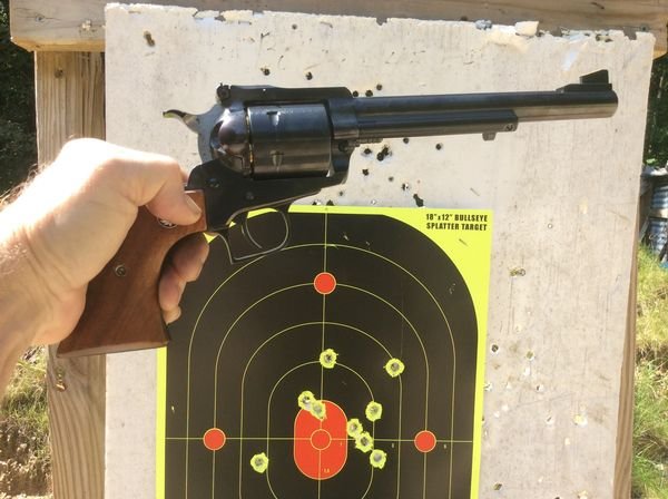

First up was my Ruger with the 240 gr. MB bullet load with 9 gr. Unique and it shot okay from 25 yds one hand shooting. Then I shot same load

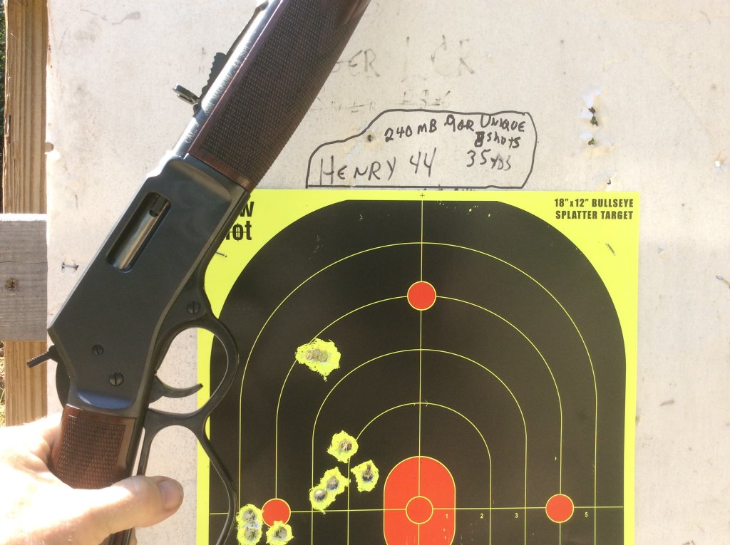

8 shots of it thru the Henry Carbine. Again the shots were to the left but with a couple of nice groups but with one keyhole hit which I think was the first shot.

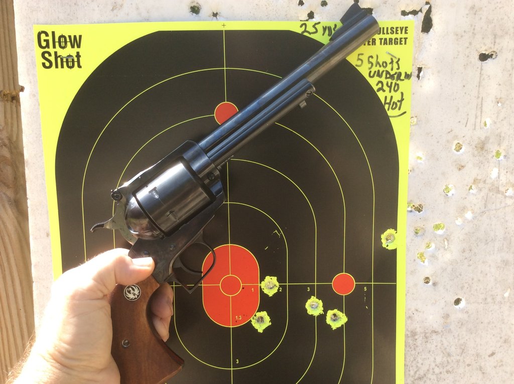

Next I loaded the Ruger with the hot Underwood 240 gr. JHP ammo and they are HOT! Fired 5 from 25 yds. one handed and that was a handful enough!
Result kind of a spread and my pinky finger was hurting since I place it right under the butt of the grip.

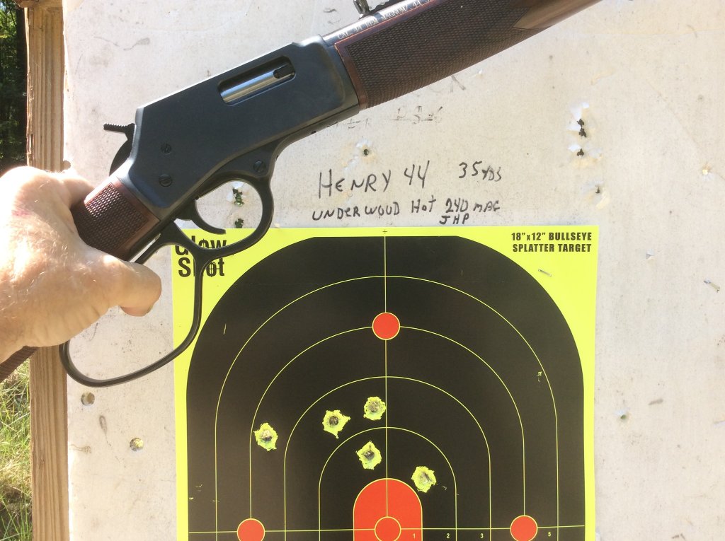

Then fired same Underwood load thru the Henry with a slightly centered spread high of center but no keyhole hits.

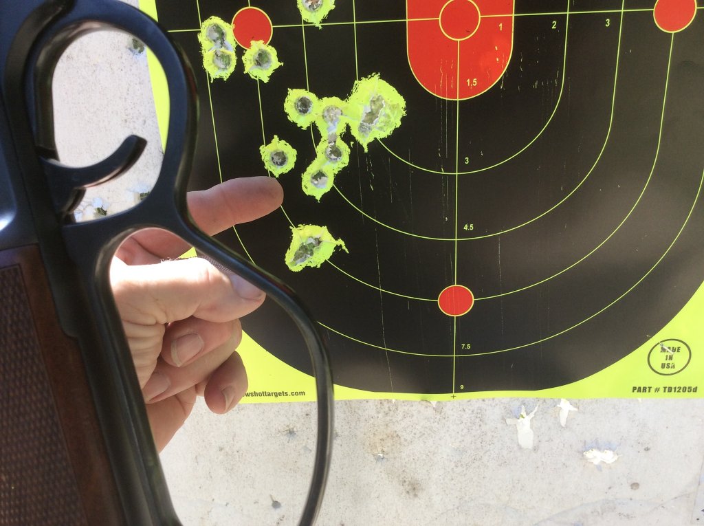

I then fired another 7 rounds of the previous 240 gr MB cast bullet load and aimed lower. The result was to the left again with some consistent groupings but 2 keyhole hits this time. The upper keyhole was first shot and the second one was in the middle of the 7 shot sequence.
If instability of bullet causes a keyhole why do the others tend to form a nice group? Move the rear sight over to get on center and you have some good hits with a couple of keyholes....good or bad?
I recently had slugged the Henry barrel and it measures at .431 The MB coated cast bullets measure .4305 and the Hornady JHP bullets are .430 diameter. No keyhole has been seen shooting the JHP bullets. My MB 240 bullet load speed has been checked at 1300-1320 FPS

- henry 44 carbine 8 shots with one key hole.jpg (122.47 KiB) Viewed 1651 times
- henry 44 2nd group of 7 shots 240 MB cast bullet with 9 gr. unique 2 key holes..jpg (125.15 KiB) Viewed 1651 times
- ruger sbh 44 mag 240 mb bullet with 9 gr unique 25yds.jpg (51.53 KiB) Viewed 1651 times
- ruger sbh 44 mag underwood hot 240 jhp.jpg (128.65 KiB) Viewed 1651 times
- henry 44 5 shots hot underwood 240 JHP load.jpg (127.27 KiB) Viewed 1651 times
