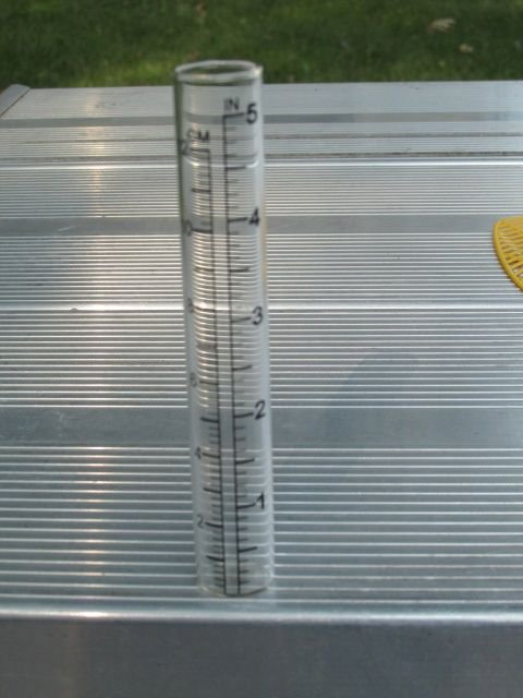

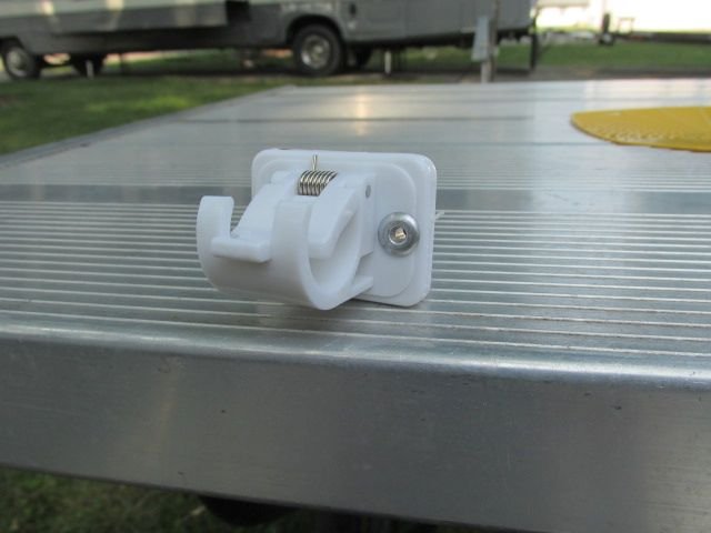

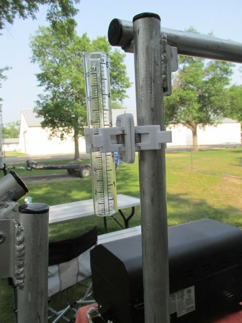

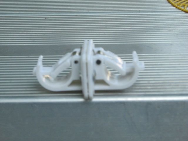

many times over the years we have wished we had a rain gauge but somehow never got around to getting one .... a few days ago I decided to make one .... the first three pictures below show the plastic rod hangers that we used when replacing all of the curtains in our camper .... the next couple of pictures show two of them pop riveted together .... the rest of the pictures show a 5" cylinder ordered from Amazon and it being inserted into the holder and then mounted on the deck we use with our camper .... now all we need is some rain but, unfortunately, not a drop is shown in our current long range forecast .. :?

I like the holder, the one that came with my gauge is metal and scrapes the marking off the glass.

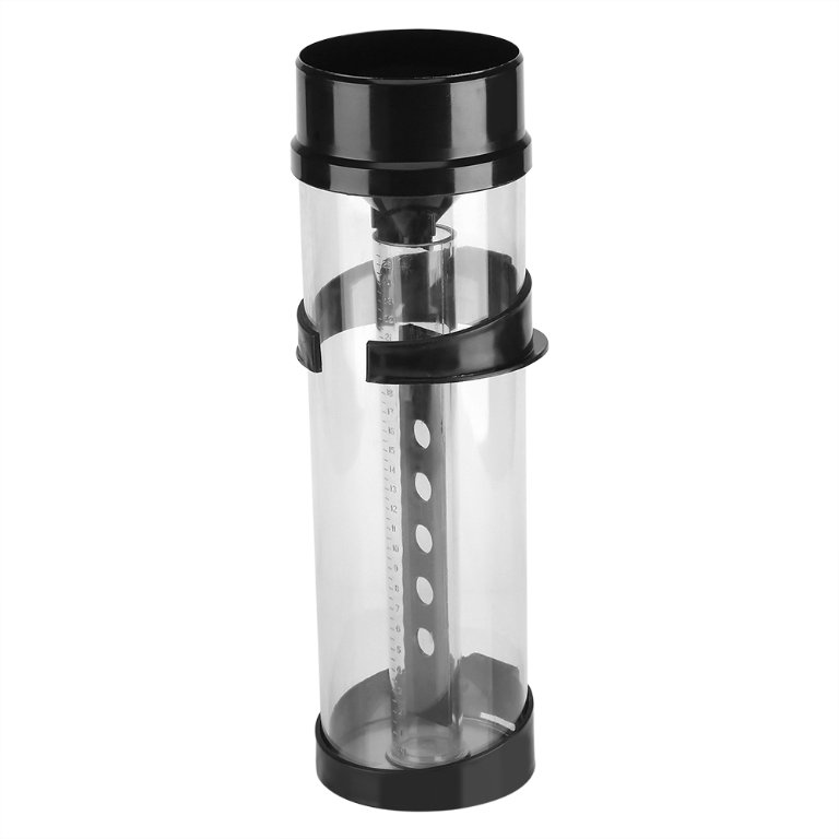

It will give you a rough idea of rainfall, I much prefer this style, the inner tube is calibrated to the funnel size, usually it is around 25mm 1" when full but scaled in points or 0.2mm graduations. If the inner tube fills it overflows into the outer casing that holds around 300mm or one foot.
Not great with snow, ice and hail but will work with lighter falls of these catching them in the cone provided it melts before the cone starts to over flow.
