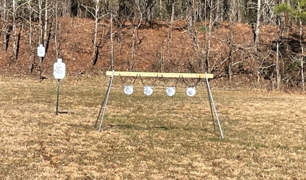

The gong in the picture below is 3/8” AR500 steel. As you can see it’s hanging from chains which are attached to hooks that also will swivel a bit. I have shot it at 100+ yards with 5.56 FMJ and had no problem. I am careful where I put it to add a bit of safety to the shooting. I have some clay target holders coming that I plan to add to the top of the stand. I take a pic when I get them added.
Reactive targets wether steel, clay or plastic spinners/bouncers are some of the most fun casual shooting you can do. The rifle club I belong to doesn’t allow any targets other than paper on their stands so to shoot reactive targets I have to go to public land to do so.

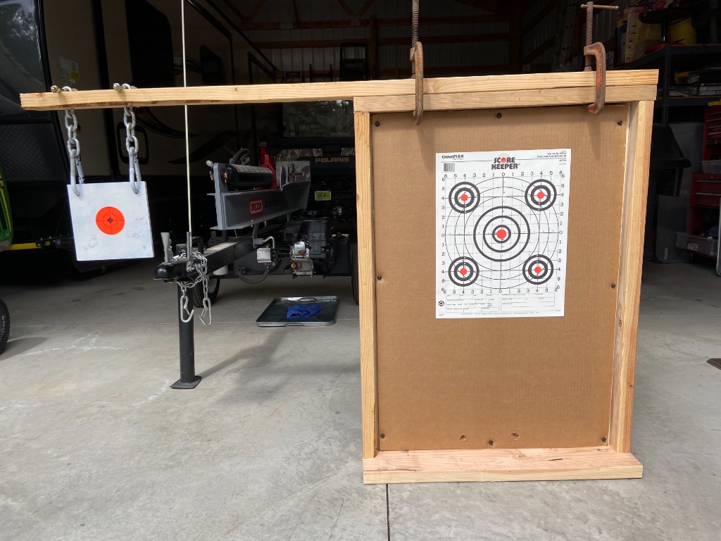

Here is a picture of the setup I use with steel targets. Everything is homemade from scrap or cheap store supplies. The legs for the target stand are made from 3/4" EMT (conduit), available at an electrical supply or home improvement store. Cost is about $6 for a 10 foot length and it makes 2 legs. I welded up some scrap bed frame to fit a 2x4 and welded some rebar to it, to go into the legs. The steel plates (AR500 3/8" X 8") hang from chain (scrap) on hooks screwed into the cross 2x4.
The big silhouette targets are mounted to the fence stake, from a bracket I made from some square metal tube. This bracket sits on to of the stake and the target hangs from one 1/2" bolt. The bolt is loose so the target sits at an angle and moves with each shot.
If you don't have a welder to fabricate stuff, you can buy complete target stand setups like this for about $35. Just check Amazon for steel target and stands.

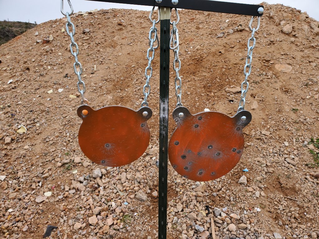

I'm late to the game BI, but I am on board with Forth S and Big Al, I use ST7 for all of my steel. I shoot AR500 in both 1/2inch for the long range high power rifles, and 3/8 inch for everything else. The 1/2 inch splats, the 3/8s gongs. The bigger the target, the bigger the gong.
They also have a great selection of various frames and mounting options. I sue the T-Post for quick set up and when I am shooting a 270 combat range and the framed hanger for long range.
