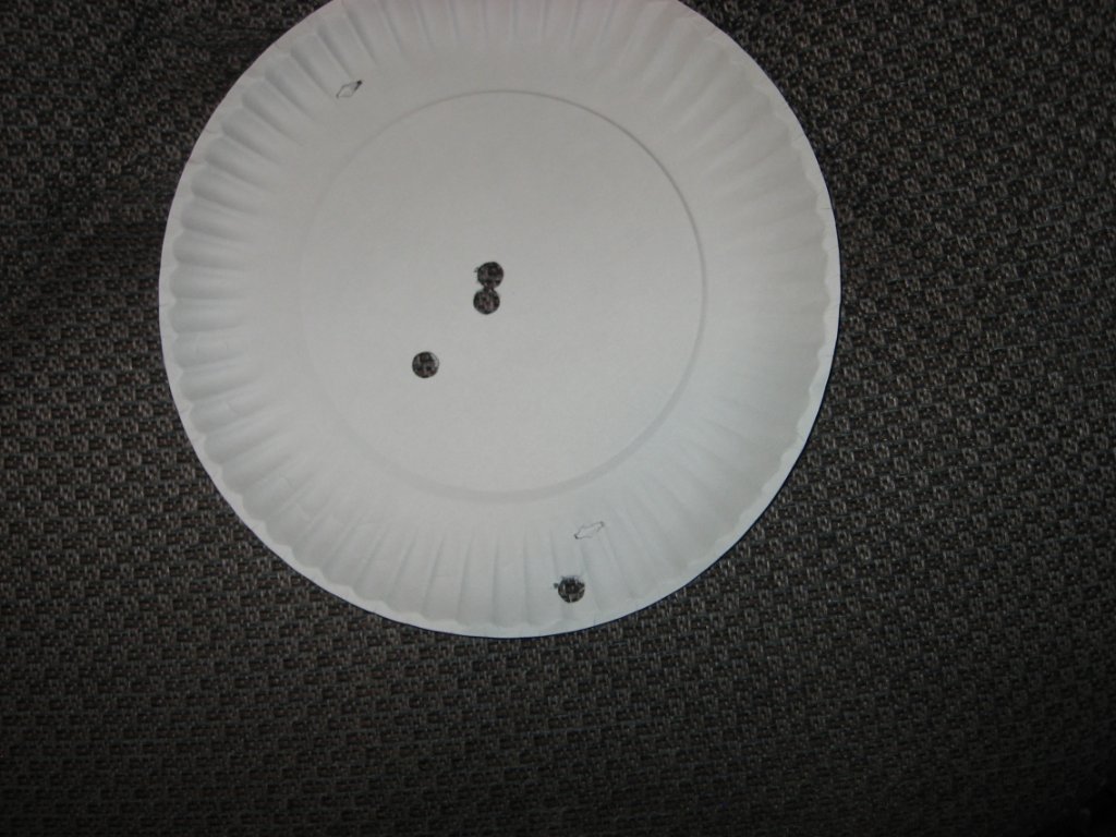

Hello all I just got a BB 357 and have not got out to shoot it until today. The first shot was high and to the left but the rest was right on. I am not to good with iron sights so the fact that I did that good means something. I know this was at only 25 yards but only took 4 rounds with me. I am reloading so I just wanted to see how it was going. I had two that was a little black on the top I don't know it it was to low of a load or what. I am shooting 4.7gr. of Unique with MB 158gr SWC.

Looks pretty good to me! Sometimes, one is not like the others. Maybe, cold barrel? I notice something similar with one of my rifles. As far as iron sights, practice, practice, practice. Some of us have moved to a peep type sight. In any case, happy shooting!

The load you are shooting is a .38 special load, which is fine to shoot in your rifle. If you are using magnum brass, that might account for some carbon residue. I use that load for handgun .38 special loads and the brass does get black. The bullets you are using have an 18 BHN hardness, which is probably too hard for that load. If using .357 magnum brass, you might try 7.5 grains of Unique with that bullet.
Looks like your iron sights are very much in the ball park.
