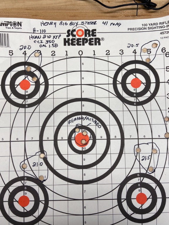

First shots today with the BBS 41 and all went well. About 40 when I arrived and 55 by the time I left with no wind. Beautiful sunny day, nice to be out. All shots from a bench at 50 yards.

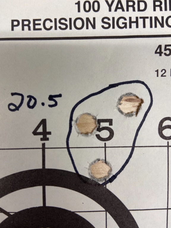

I shot the 41 for load development with four laddered loads using H110 and Hornady 210 gr XTP-HP. I shot 20.0, 20.5, 21.0, and 21.5. None of the groups were great but none were terrible either. Best was the 20.5 but even better was the remanufactured ammo I bought from a guy here locally. I used the reman ammo to get the scope on paper and reasonably zeroed in order to know my loads would be in the area I wanted them. First I shot a couple of shots to check the scope that I had bore sighted using the old fashioned pull the bolt and look down the barrel at a POI and zero the scope to it. To my surprise it was almost exactly on, I must be a genius scope mounter. :lol: Anyway, the first couple of shots were right where I wanted so I shot the next three into the center bull on the target. Best group of them all. :shock: Maybe I’ll chronograph the remanufactured ammo and try to duplicate the velocity with my hand loads.
I’m not super happy with my results and as BigAl52 has suggested when I can get my hands on some 2400 I’m going to give that a try. For now, I’ll load up the remaining 88 Hornady’s with the H110 so I have something to shoot while looking for some 2400.

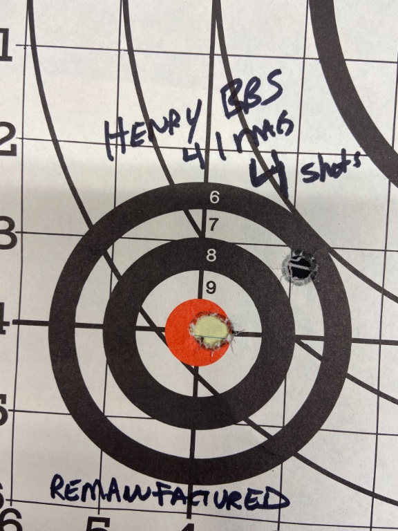

One other note, when I was still shooting the reman ammo I moved to another bullseye and shot four times. Looking thru my spotting scope I could only see two holes and for the life of my I couldn’t find the other two. There was no way that two shots could be off the paper as tightly as that load was shooting. When I pulled the target I’m thinking that three went thru the lower hole seen in picture three. If so, that’s pretty incredible.

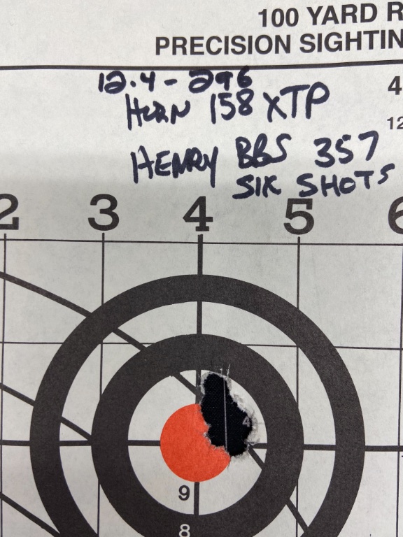

Then I got the BBS 357 out that I had done my load work for a few weeks or so ago. It needed to be zeroed and after a couple of adjustments I felt good about it. I had loaded 10 in the magazine to zero and was happy after four shots. So I moved to a fresh bullseye and shot the remaining six. Much to my surprise I ended up with a one hole six shot group. That’s a sweet shooting rifle. Funny, after shooting the very mild 41 mag the 357 was almost a popcorn fart sounding and feeling shots. I think I giggled a little bit.

Whew, mighty fine shooting Hatch! Pics #3 and 4 are superb. Sure hope you can find some 2400. Darn good shooting.

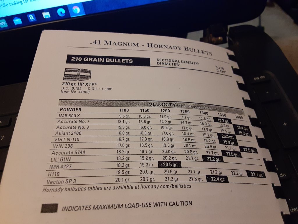

Post by Hatchdog » Wed Mar 03, 2021 9:10 pm
In my reading I understand that when loading handgun cartridges for a rifle that the max charge is reduced. This is due to the fact that a rifle chamber has no pressure loss like a revolver would have with the gap between the cylinder and the forcing cone. Only Speer and Sierra listed rifle data for the 41 and the Speer max is 21.5 and the Sierra is 20.3. So that puts me at max already although I didn’t get any pressure signs on my cases.
Handgun maxes are: Hornady 22.7, Speer 21.5 and Sierra 20.1. Funny that Sierra shows .2 grains less for handguns than rifles. So much for the cylinder gap pressure loss........ :?: looks like Sierra is much more conservative than Hornady and Speer.
that group clearly demonstrates outstanding shooting by both the rifle and shooter .... our BBS 357 has proven to be fine rifle and as you note, a pleasure to shoot
