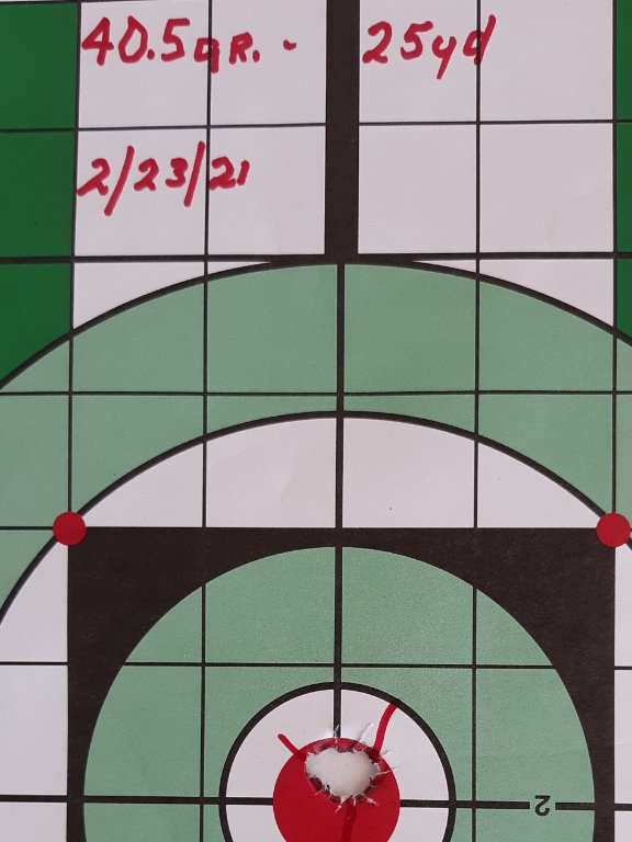

Finally got a break in the weather, hi today 69, sunny. Hit the range to see how it goes.
5 sets of 3 each ( saving ammo ). IMR 4198, Hornady 300 gr JHP.
Former load : 41 grs.
41.5
42.0
41.5
40.5
The winner was 40.5.
20210223_141523 (2).jpg (109.66 KiB) Viewed 715 times

I tried putting all 5 targets on here, would not work. These pics drive me nuts ( I know, short drive ). :lol:
Two others were close, but not this good.
