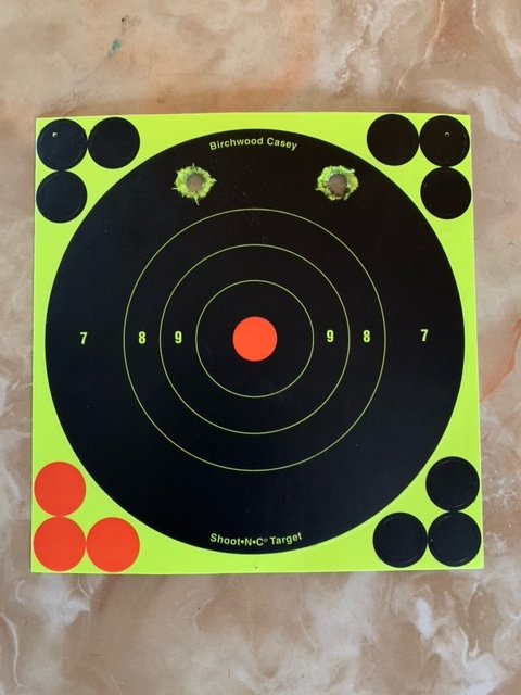

Ok, the range report...
My new Uberti 1885 High Wall 45 Colt. Shooting 7.5 gn Universal and 200 gr LFN.
First 2 shots, 100 yds on a 5" target. Not bad except after that the 2nd casing would not extract. At all. Went home and out to the shed to see what's what. I had previously read that the extractor is a bit of an issue with these rifles with straight wall cartridges. I pushed it out from the muzzle end with a cleaning rod and it just popped out. Tried some dummy rounds and they popped out. Tried some cleaned up empty brass and they come out. Extractor moves properly, no mechanical failures. Apparently the fired brass experiences some blowback, and that dirty stuff is enough to hang it up sometimes.
Both rounds shot great and the first case popped out fine. Sooo....I will use the rifle and hope that this issue starts to resolve itself after break in and lots of rounds. I may have a local gunsmith take a look but really it looks like the rifle is working like it was designed to. Clean cases pop out just fine. Anyhow, it is what it is. I will likely take it back to the range tomorrow (with a cleaning rod) and just shoot it.

Thanks for the report, RR. Two shots at a hundred yards into a five inch hole and within two inches of each other is awesome shooting. As for the stuck case, you will figure it out soon enough.

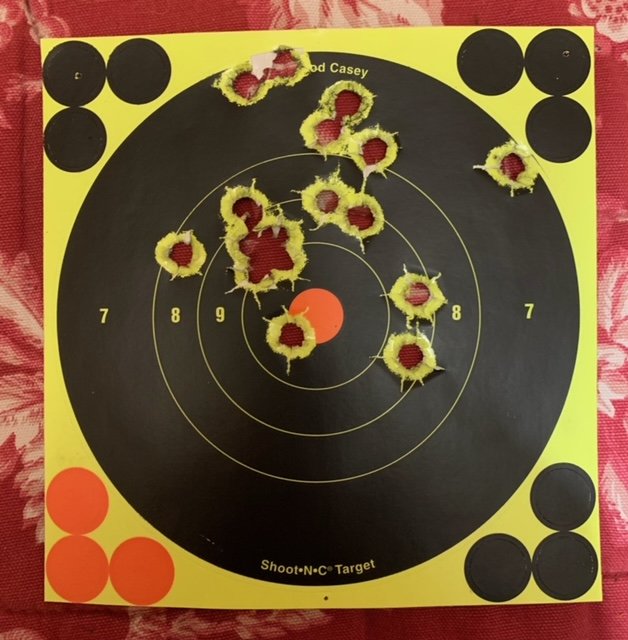

Thanks all. I actually just got back from the range again. 2nd trip. Had to try again. I gave the rifle a deep clean this afternoon again; scrubbed and scrubbed the barrel. It was incredibly dirty! I don't doubt there is stuff built up in there. I could not believe how much still came out on patches when it was cleaned twice before already. Tomorrow it will get cleaned again.
Shooting factory ammo, Winchester 250 gr LFN. Always liked this stuff, very consistent. This was a little better outing, there were a few that the extractor actually extracted. The rest I pushed out with a brass rod. Tomorrow I will pick up a wooden dowel to use instead until hopefully don't have to anymore. At any rate it's not a deal breaker, while I wait for my muzzleloader to show up in next month or so, I have a muzzle-unloader to shoot. I will not let it stop me from enjoying the rifle.

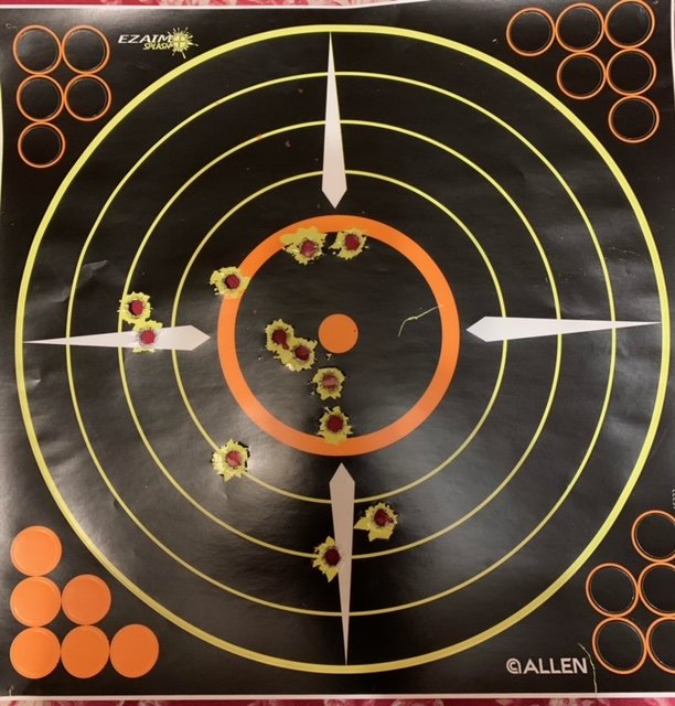

It is a real treat to shoot. No recoil at all, like shooting the Red Ryder. But certainly more velocity out of the 30" (not 32") barrel. Those rounds really hit hard even at 100+ yds. You can hear the wood splintering. Accuracy? Judge for yourself...
100 yds, shooting from 1 knee, all the rounds I shot are on the paper. 5" target. Pretty happy with the results for a first outing. I have no idea what I am doing with the rear tang sight but it seems to help focus in on the dot.
200 yds, shooting from 1 knee, went to a 12" target and again just raised the rear tang slightly with the screw adjust. All rounds on the paper. Wow, rifle is accurate I think. A hit with the Henry at 200 is a Hail Mary shot.
Happier than I was this morning, may shoot it again tomorrow. RR

Nice shootin' right out the box RR ! A little windage adjust and it will be right on. That target would be good for a 50 yd. first shots!RanchRoper wrote: ↑Sat Oct 31, 2020 4:24 pmOk, the range report...
Hope you get the extractor issue sorted out. Was the same brass being used for those shots?

This was factory new ammo, this morning were my reloads.

Your 2nd outing is incredible with those 200 yd shots and iron sights!!!!

My thinking exactly.fortyshooter wrote: ↑Sat Oct 31, 2020 9:43 pmYour 2nd outing is incredible with those 200 yd shots and iron sights!!!!![]()
Very impressive RR.
I'm sure you will get the extractor thing figured out.
