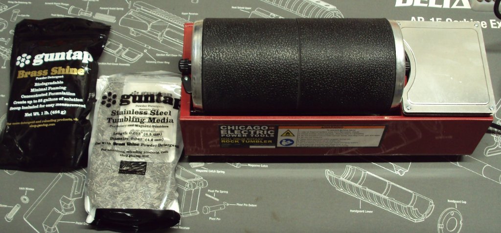

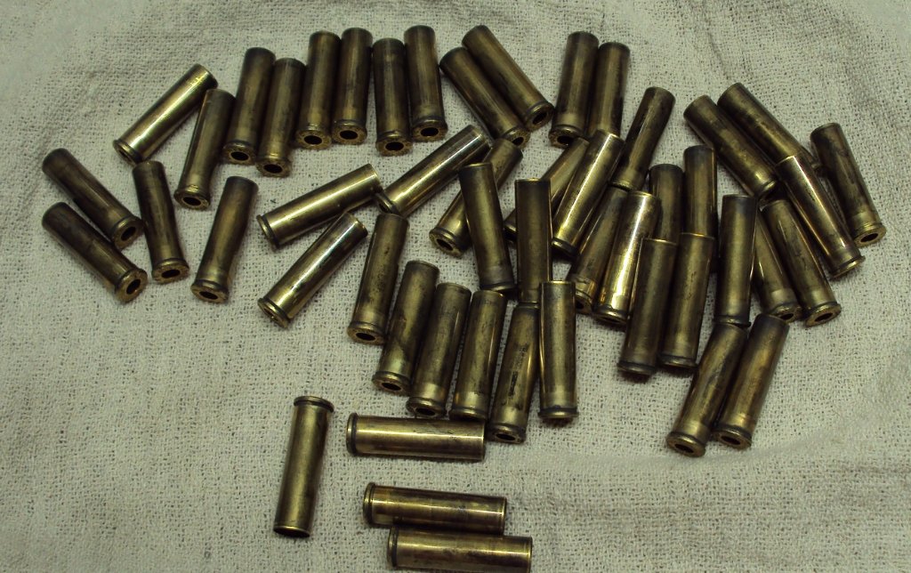

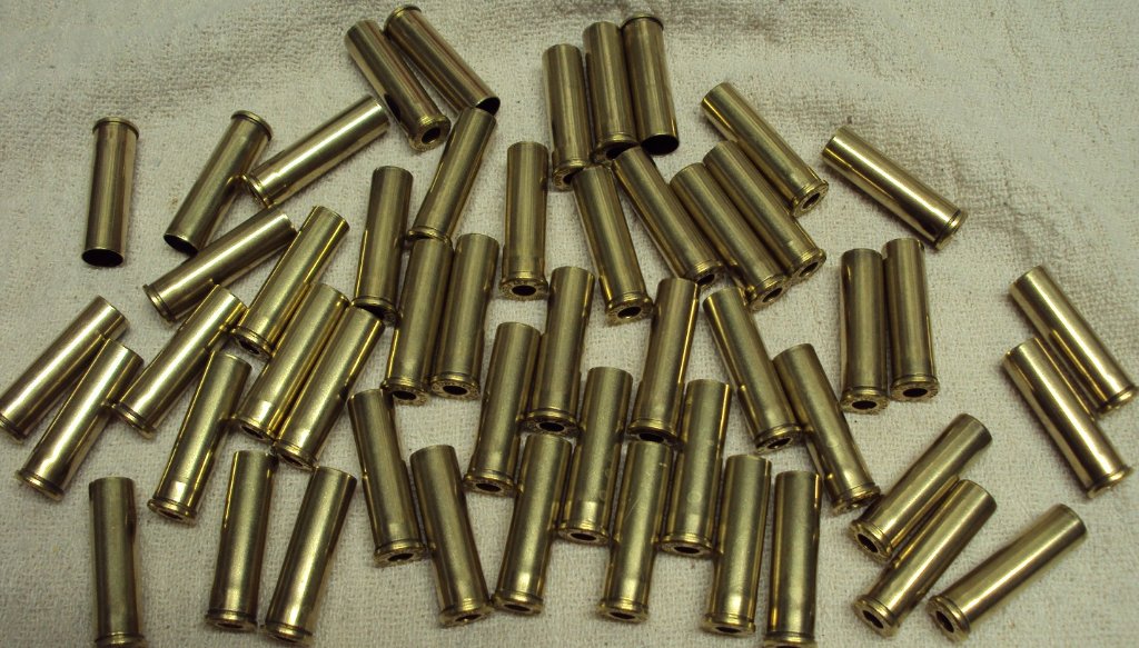

I read this thread with great interest. My sonic cleaner just doesn't clean the brass as well as I would like although it does a great job of cleaning clock works and gun parts. So I bought the Harbor Freight tumbler and GunTap powder and pins. This was my first batch with 20 min of run time. Clean inside and out. I'm sold!

There ya go! Glad it worked as advertised and that you're happy with the outcome. Another half-hour and they would really shine, but that's very nice for 20 mins. I may have to try a shorter cycle myself.
Thanks for sharing!
Yea neat ain't it?
When you are out of the guntap powder get a bottle of dollar tree lemon juice and throw about a 'shot' of it in the water along with a squirt of Dawn and tumble about an hour or so.
Make sure your sunglasses are on when you dump out the brass!
