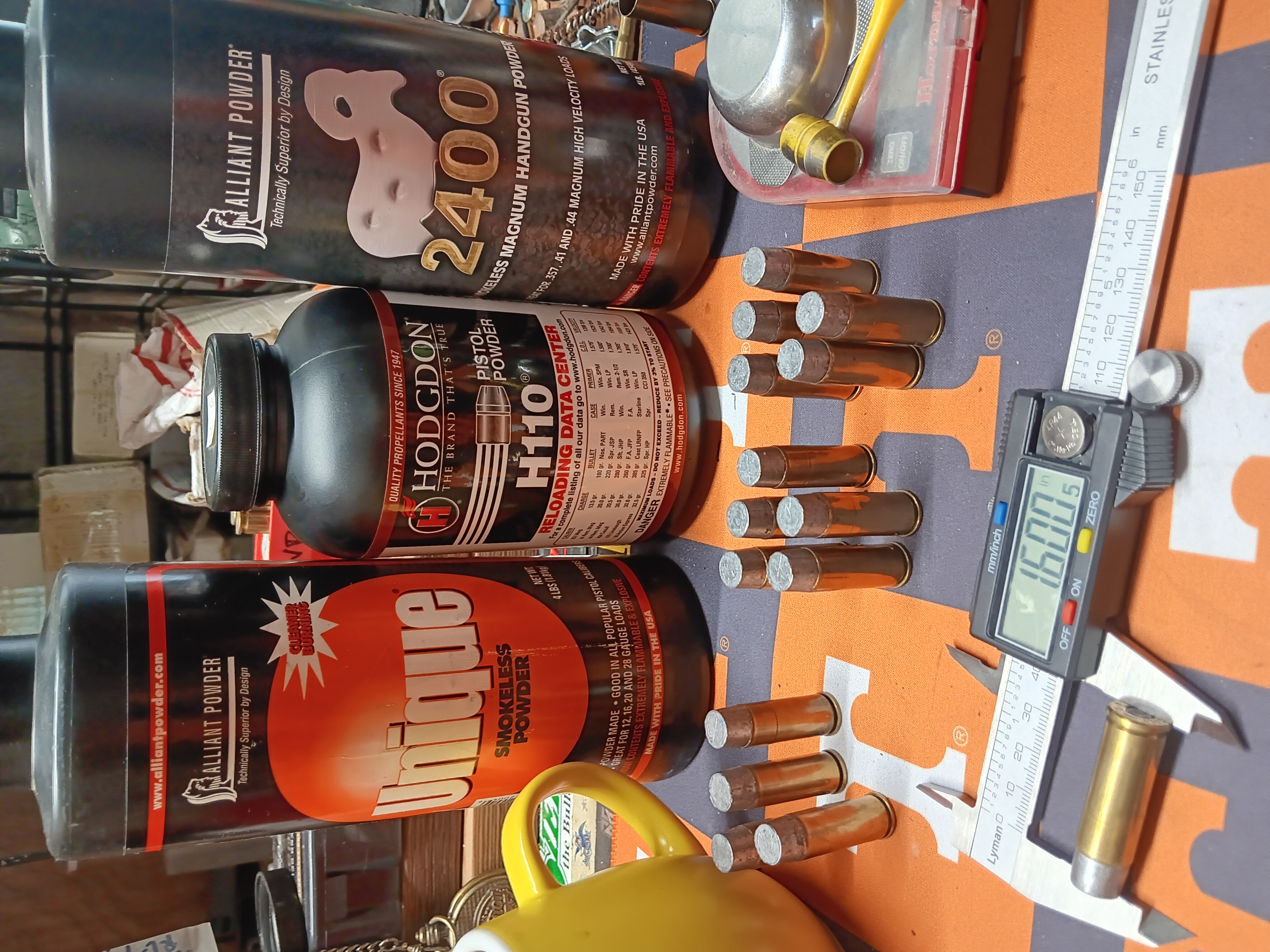

Post by Vaquero » Sat Aug 01, 2026 11:20 am
Stuffed a 45 colt cases with wfn 325gr MBC Slammers.
Five each to test in the Rossi R92.
Starting loads.
Unique 8.5

None of those showed promise, but the 2400 17.5 was the best. I don't believe it likes those heavy boolits. :lol:
I myself don't think I'd like shooting the H110 load from a handgun. That first round was an eye opener and the metal butt plate let me know it. :o :roll: :lol:

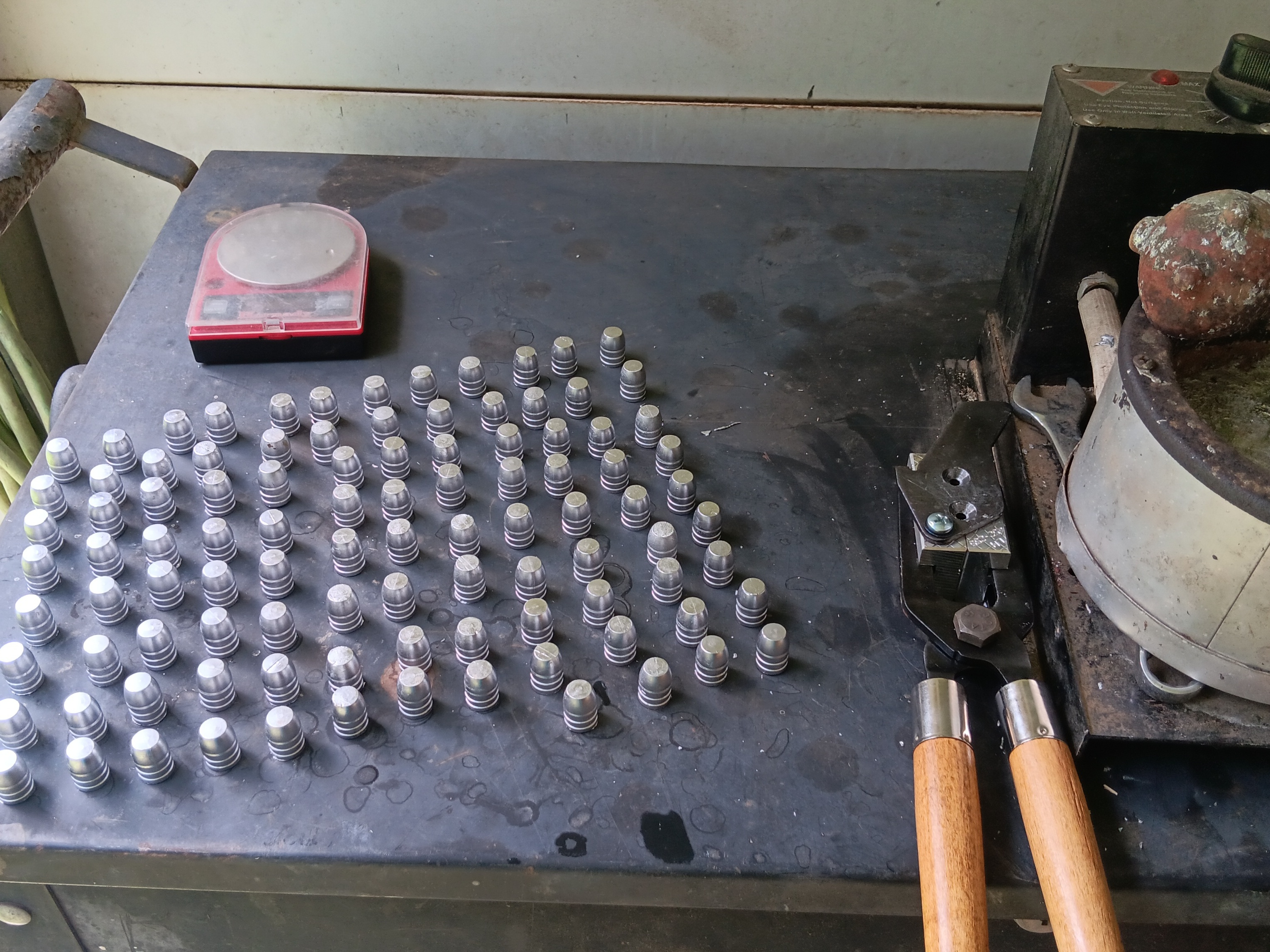

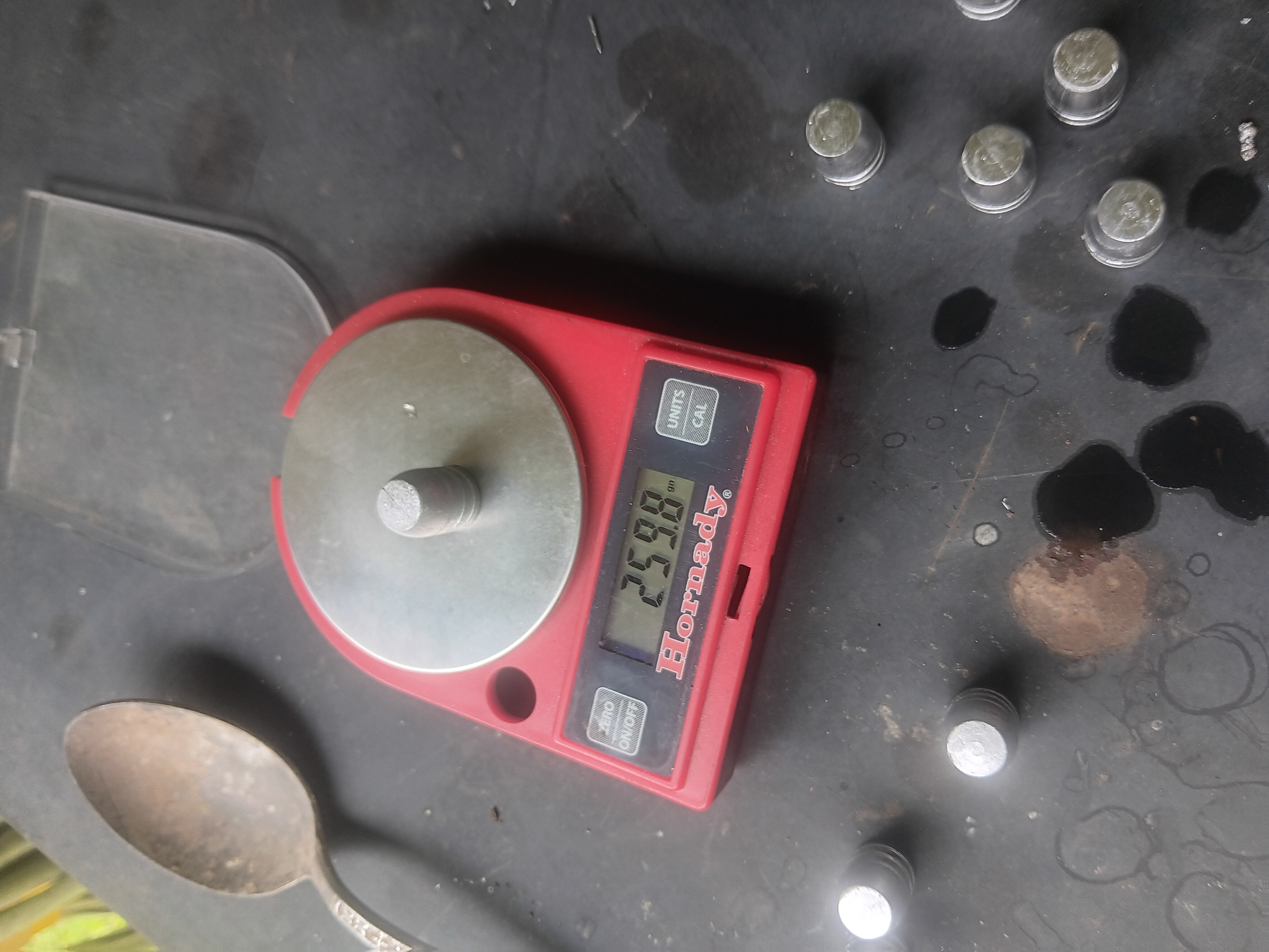

Post by Vaquero » Sun Aug 09, 2026 1:15 pm
Not at the bench but out in the carport I had a little casting session. Found a Lee 255gr mold that I truly don't remember buying. So this morning I decided to break it in. After about a dozen it started dropping some pretty pills.
Weighed a few as I was going along. From 258.9 to 262.3 grains.
