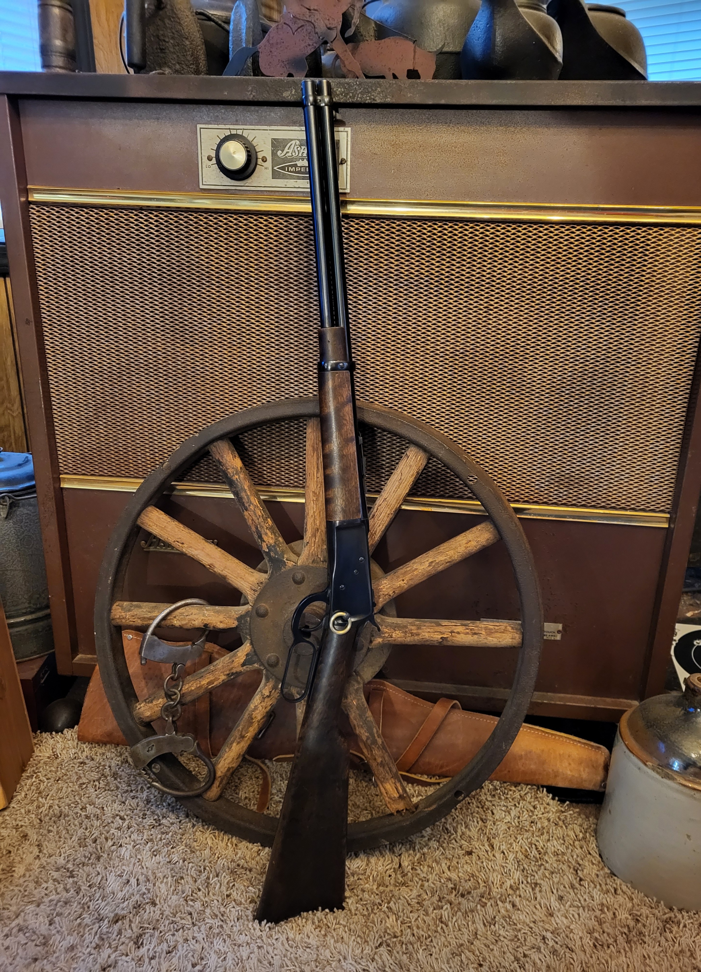

I used the bench to add a saddle ring to the Rossi 45 colt.
Definitely looks better to me now. ;)

Good looking Rossi Randy!

Forty said, "Good looking Rossi Randy!"
Thanks buddy.

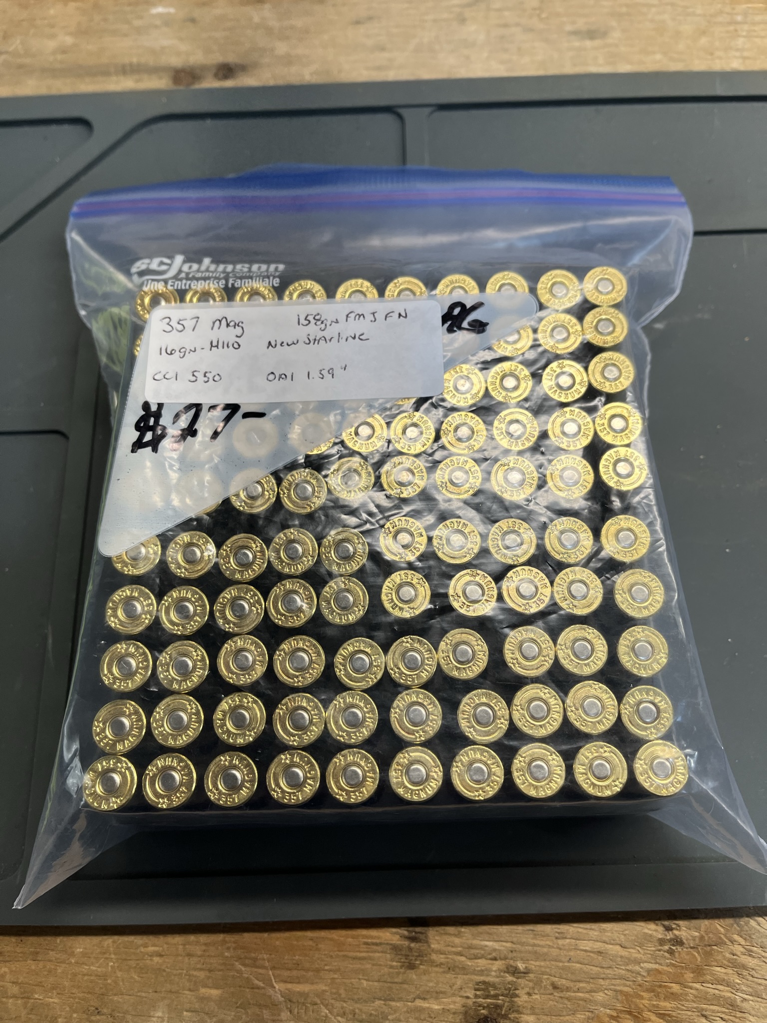

Speaking of 357. 100 FMJ 158g xtreme FN and 50 Hornady XTP both in new Starline brass with CCI 550 and 16gn of H110.

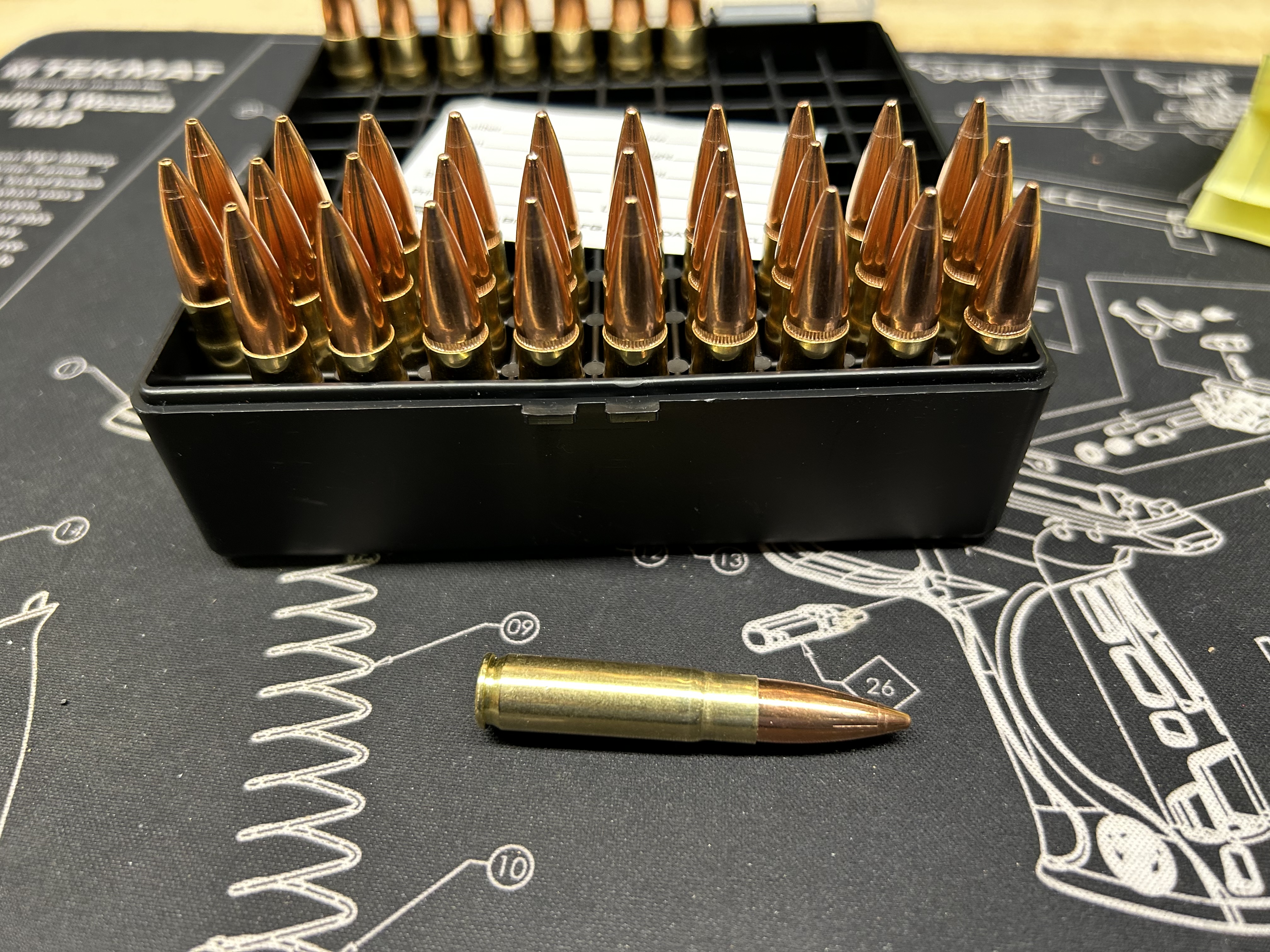

Took advantage of yesterday’s lousy weather and put some more 300 BO’s together. Using the Speer 125 gr TNT HP and Win 296 I wanted it increase my velocities from my testing done earlier. Big Al has experience with this caliber and made this suggestion to me. I stopped at 17.0 grains earlier so these are 17.5, 18.0 and 18.5. This exceed the Hornady data but is well under max in the Sierra data. Also I picked up a box of Hornady 150 FMJ-BT to see how they do against the 155 gr match bullet previously tested. This non match BT is much cheaper that the 155’s so hopefully they will preform.

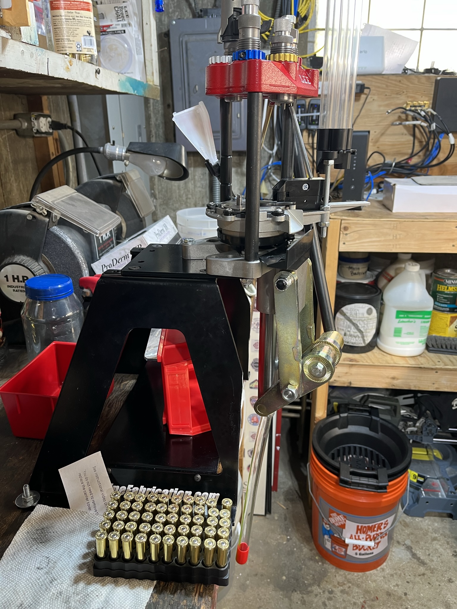

Went down to the basement and put the 40 S&W dies in the Dillon Square Deal. Took a while to get everything adjusted to my liking along with the guns liking. I recently bought a RIA 1911 in 40 S&W. Got a pretty fair deal on it so decided to add it to the arsenal. Besides it goes good with the Ruger PC in 40. I like 40 myself but I think alot of people treat this caliber like the red headed step child. Brass is cheap and I have alot of HS-6 which has been working well for me. Loaded 165 grhp Xtreme bullet today. Ran into some issues with some brass I wasnt aware of. Its Federal brass and in the head stamp there is an NT. Non Toxic is what it means and this brass has crimped primers. I didnt know that. Im now watching for them and throwing them in my brass recycle bucket
