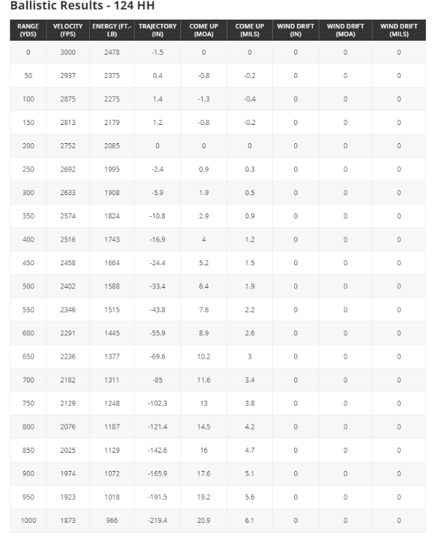

Finished up my load development using RL26 and Hammer Hunter 124gr
average of 2965 fps using 46.0 gr of RL26 an 2975 using 46.2 gr.
Hope the image works haha

Looks like my COAL With Hammer Hunter 124 GR bullets is 2.8975" so it looks like my hunting round will be sitting at ~2.87 assuming it retains the above accuracy. I was loading to 2.8500. Upping to 2.900 resulted in ~.5 gr more powder with the same realitive case fill% so I am assuming I will be close to that. Fuzzy math of course
again all theory and I have to redo my workup, but I should be sitting right at 3000 FPS with the Hammer Hunter bullets. Which puts me at 1500 ft/lb of energy at 550 yard
