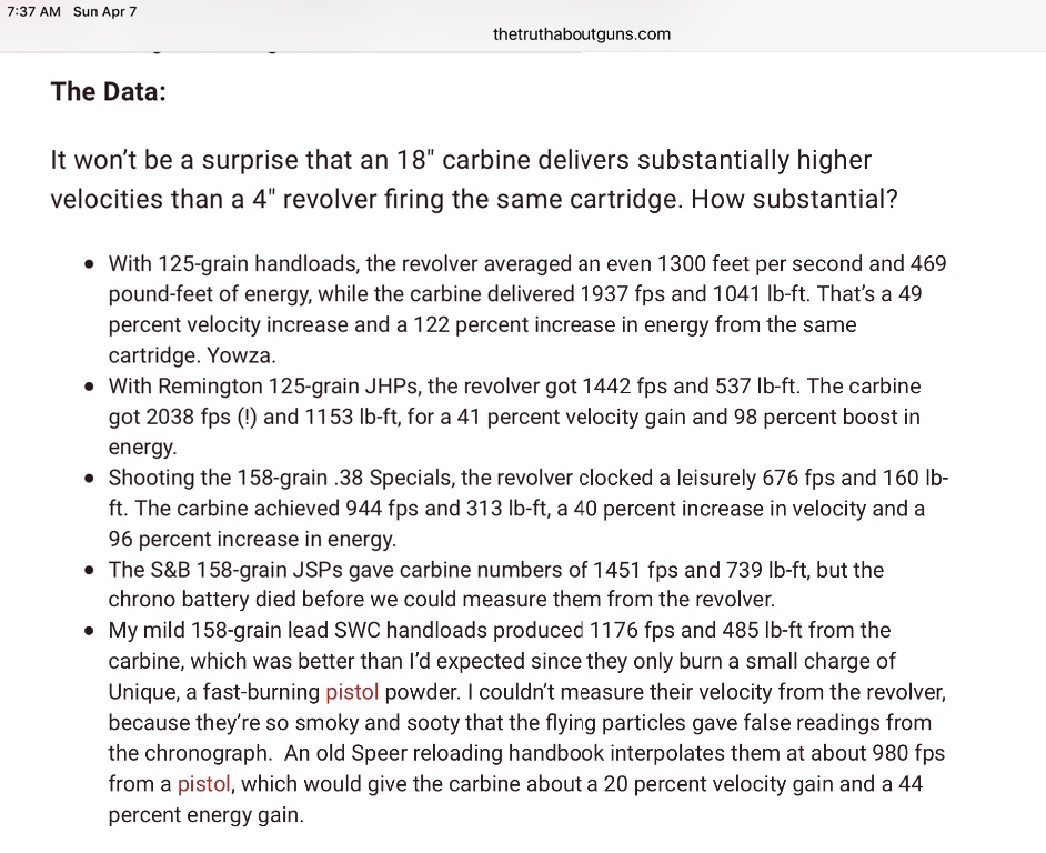

Rifletom wrote:I have some Federal Premium Hunting cartridges in .357, 180gr Castcore FP bullet. Stated on box muzzle velocity is 1250 fps, energy is 625. At 25 yds, velocity is 1200 fps, energy is 575. This seems in line with the HSM loads. Its those Hornady loads that seem all out of whack. Where did they get those numbers?
It really depends what length pipe your putting them through:
https://www.thetruthaboutguns.com/2011/ ... 57-magnum/

Redthies, all very true. But, Hornady doesn't mention on that clip on p.2 about barrel length. That was my concern.
Know what you're saying tho.
Re: .44 Bear Load
Oh I get it Tom. I looked at a bunch of other .357 data that corresponds with the lower power. It isn’t until I specifically looked for .357 AND carbine that the higher power loads showed up again.Rifletom wrote:Redthies, all very true. But, Hornady doesn't mention on that clip on p.2 about barrel length. That was my concern.
