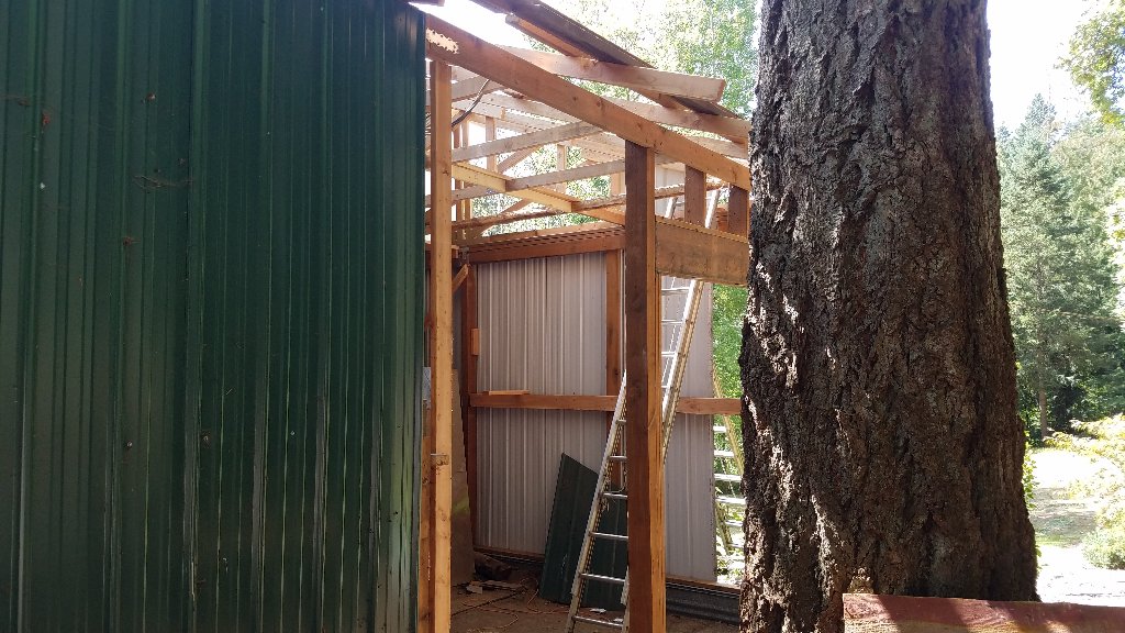

Post by Mags » Fri Aug 03, 2018 11:48 pm
Been holding off on picture updates. The temp bracing clutters up the pictures and makes it hard to discern progress. Wed I got the big door opening framed in and on Thur a good portion of the west wall section framed up. Today I finished up the west wall framing and handed off the power line from the old west wall section to the new. Sat I expect to demo the rest of the old west wall section and remove the temp bracing behind the big door. That will give a clearer view for good pictures. Then maybe by Sunday start working on the cord and web of the trusses. The span is already in place.

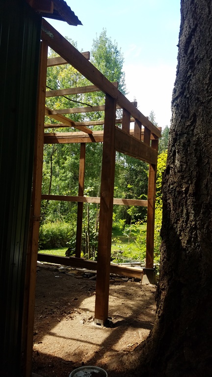

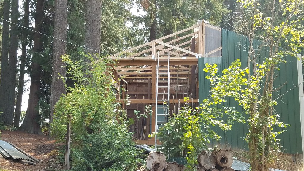

Post by Mags » Sat Aug 04, 2018 10:55 pm
Today's pictures. All old wood and temp bracing finally removed. Was going to start on the truss's tomorrow, but the boss said I needed to take a rest. Boss doesn't like me coming in ragged and too tired to take a shower.

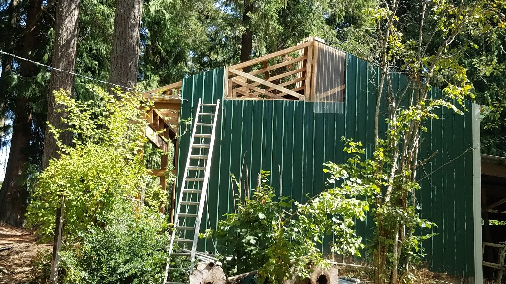

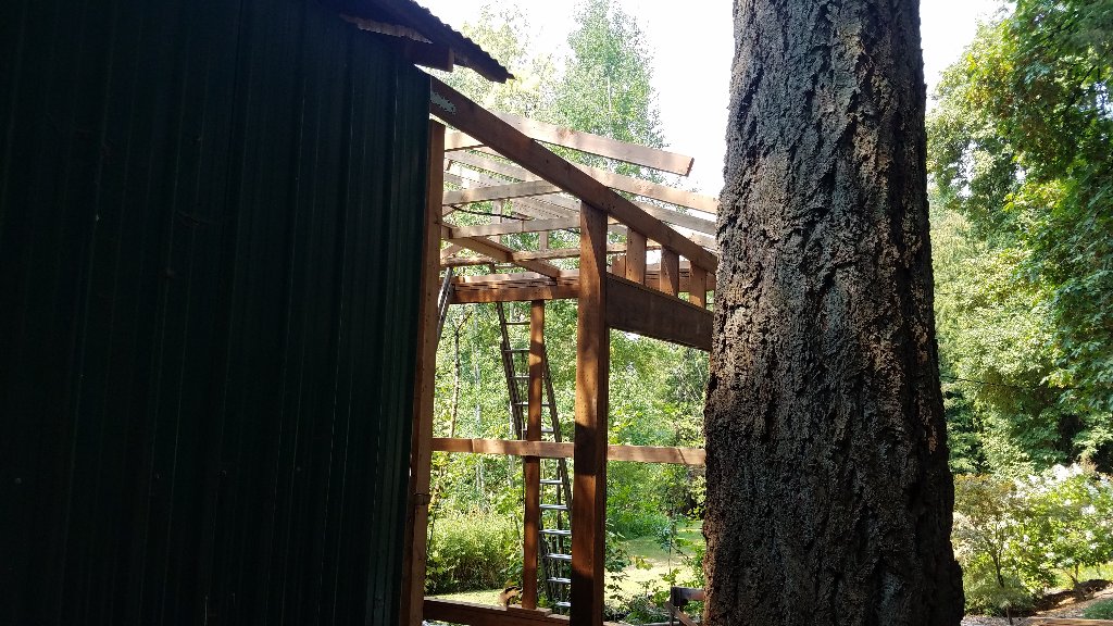

Post by Mags » Wed Aug 08, 2018 5:11 pm
Trusses are up.

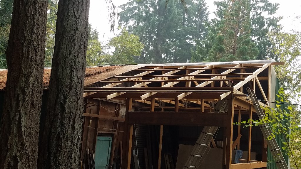

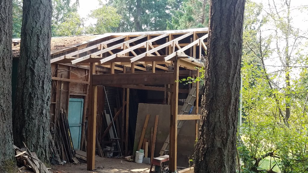

Post by Mags » Wed Aug 15, 2018 12:53 am
I haven't been working on this project very much the past few days. Had other things that needed doing and my knees, calves and ankles needed a rest. They get the workout going up and down the ladders. So to stay off the ladders a while I put in erosion block at the base of the west wall (no picture). Then went about putting up the horizontal stringers across the tops of the trusses, followed by a temporary sheet metal block above where the gutter will be to prevent the loose metal roof from sliding off while I'm try to screw it down.

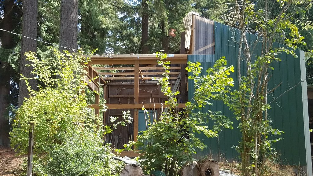

Post by Mags » Fri Aug 17, 2018 10:38 pm
Little bit of progress today. Waiting on the lumber yard for the metal roof panels. So worked on the wall panels some today.

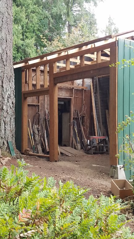

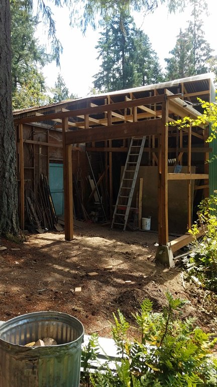

Post by Mags » Fri Aug 24, 2018 10:21 pm

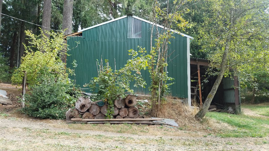

Finished up pretty much as far as I can go while waiting on the roofing material to arrive. Couple of pictures showing the door rough openings and the end wall. Will be working on getting the fire wood in over the next week instead.

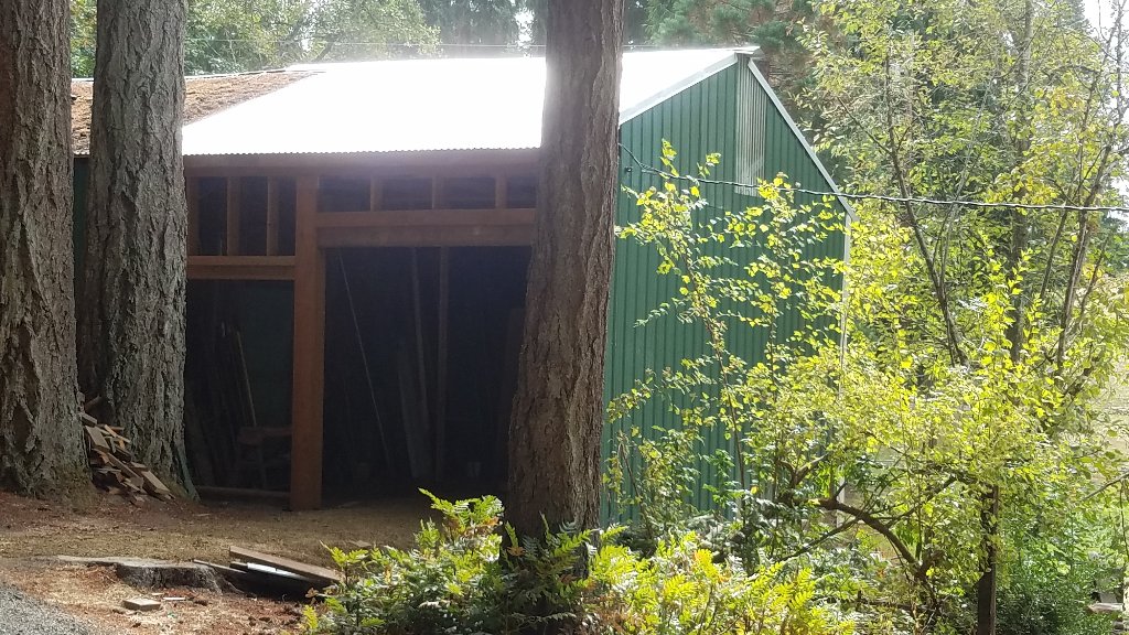

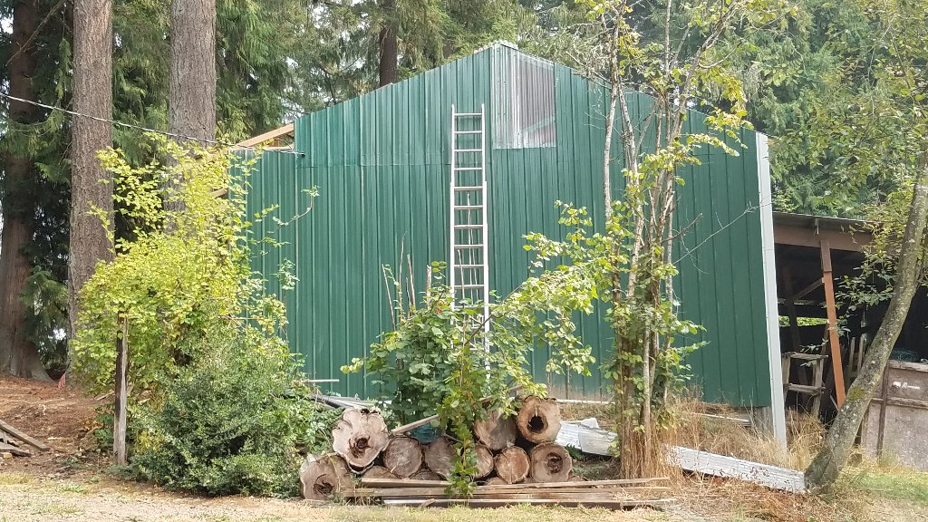

Post by Mags » Sat Sep 08, 2018 11:25 pm
Mags wrote::cry: Roofing on back order until after labor day. :cry:
...and then they delivered it to the wrong city!
Finally delivered Thursday afternoon. Unpacked the pallet Friday morning and got the ridge and first 3 panels up by myself before calling it a day. My son came over this morning and we finished the roof, the end gable flashing and the facsha board for the gutter. Way faster with my son's help. He's still young enough to gymnastics his way through the trusses using them as foot and handholds while shooting sheet metal screws into the adjoining roof panel. Tomorrow the gutters and then I can back off until later in the fall for the the doors. Gotta bathroom remodel working on too.

Post by Mags » Sun Sep 09, 2018 11:47 am
It does. Thanks RR and E2. With the delay I had been worried I'd get caught out in our typical Labor Day weekend deluge. This year that deluge didn't happen, so I'm relieved and glad I finally have it weather ready.
