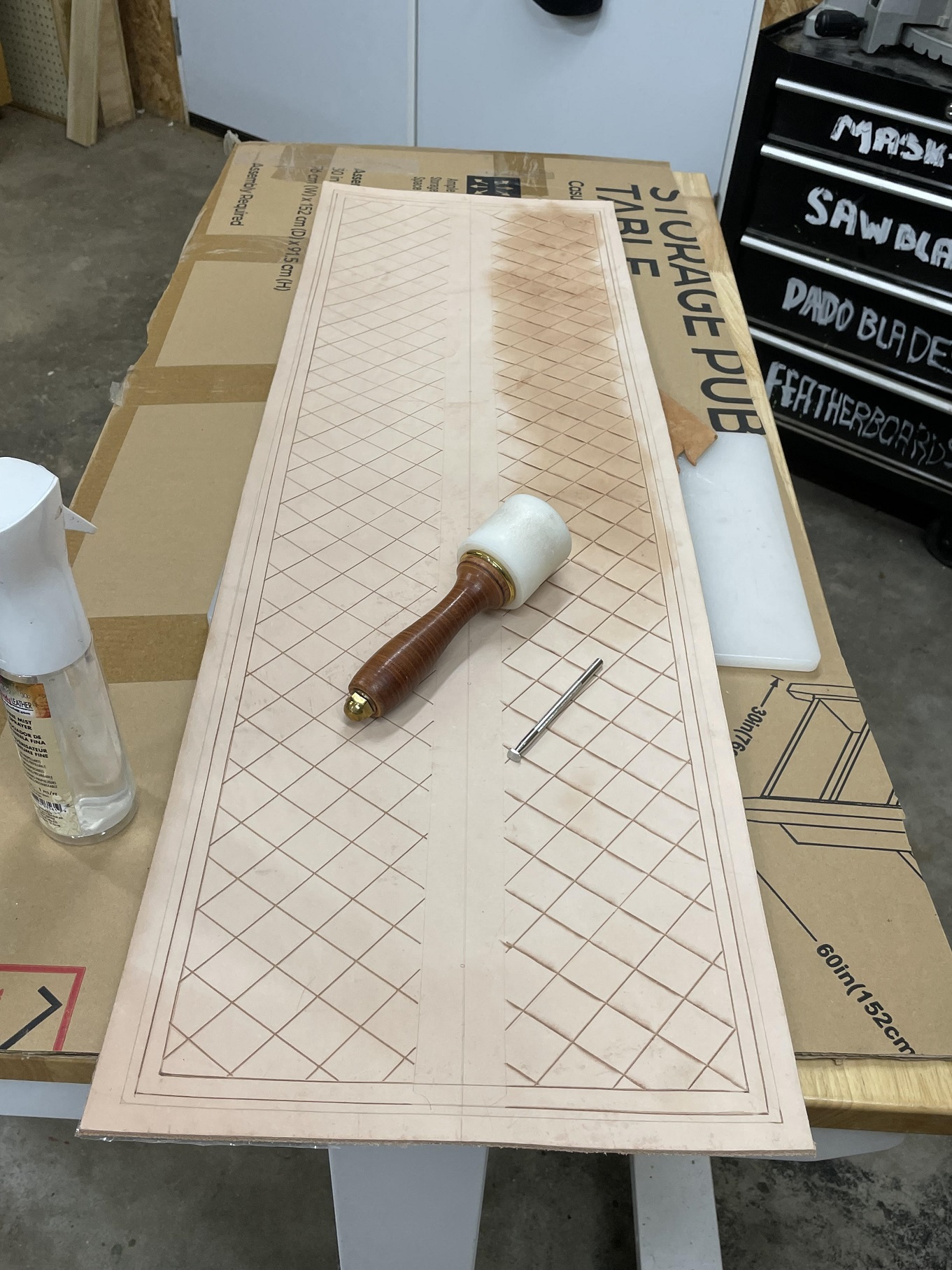

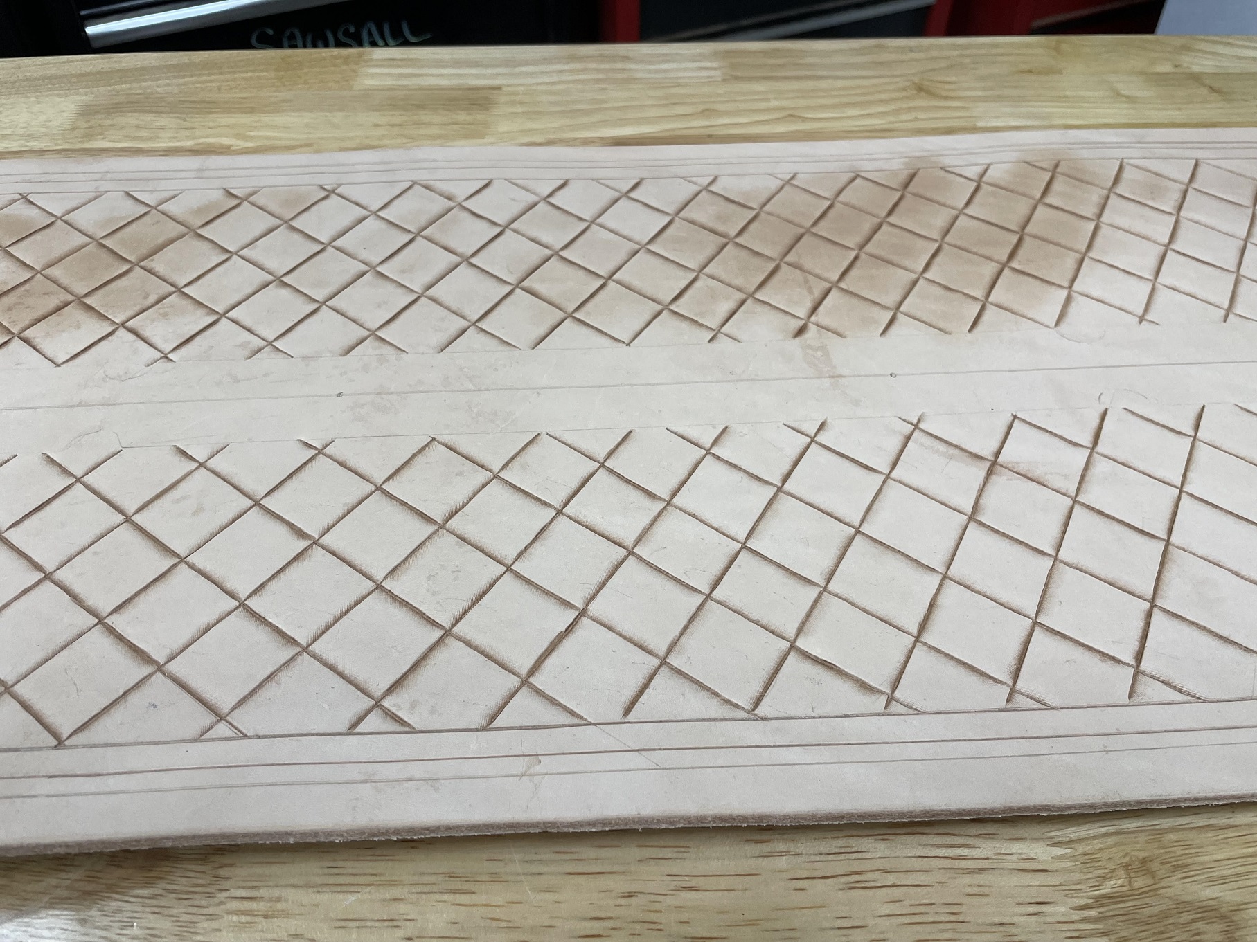

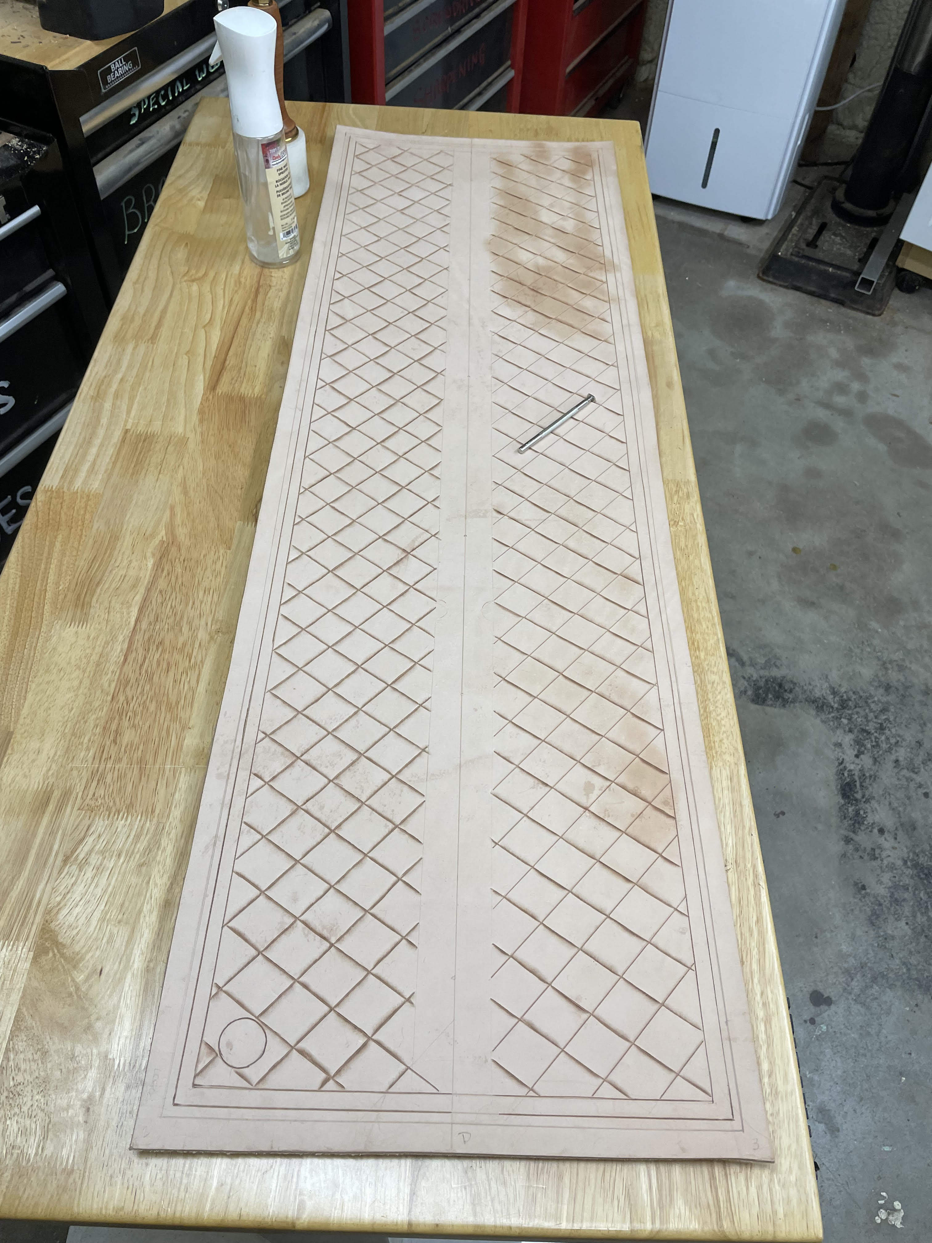

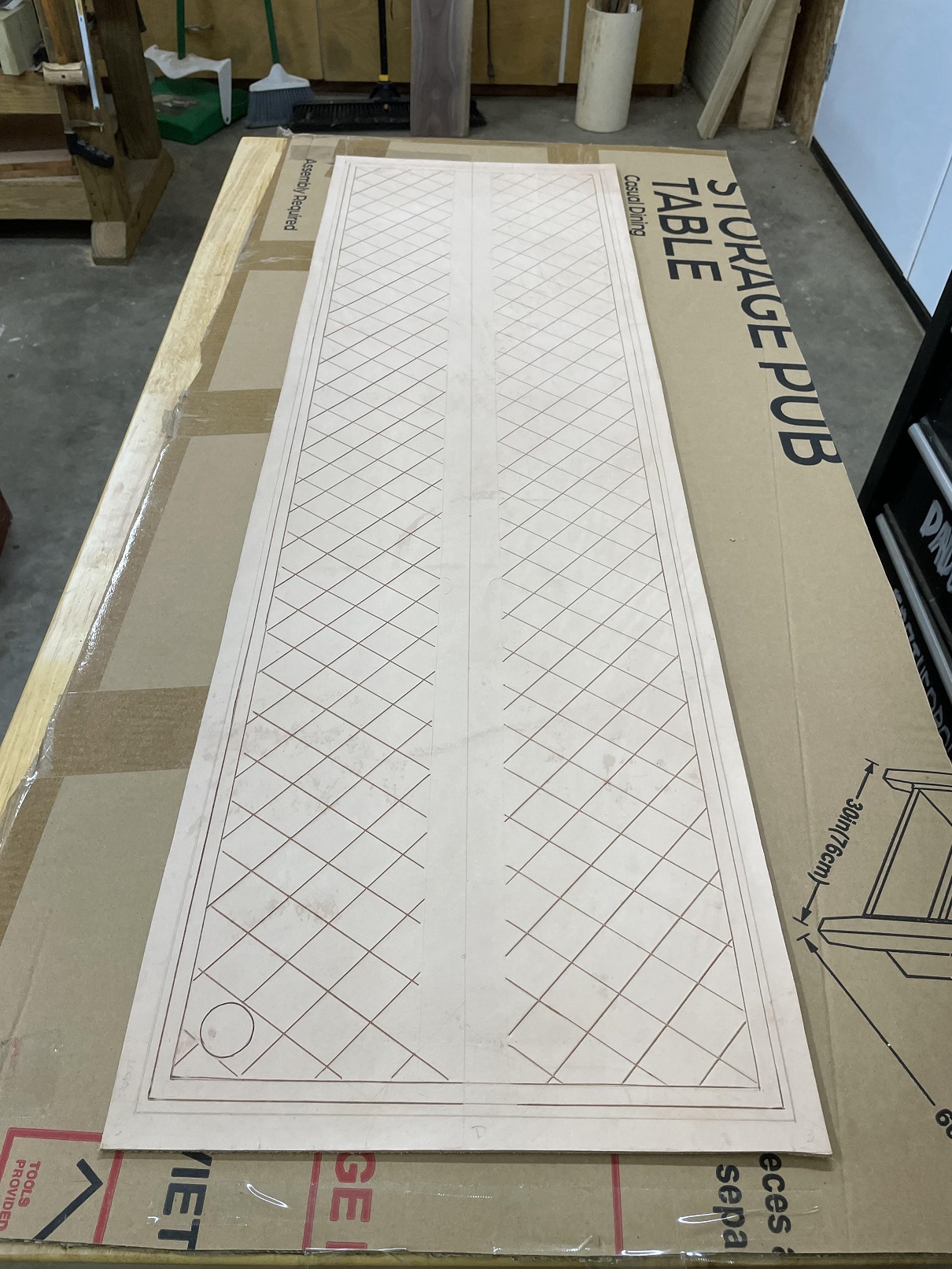

Got out for another couple hours. Took my spray bottle and "cased" the leather. This involves wetting it enough that the cutting is smooth and stays nice. It turns dark, and as it begins to lighten back to it's dry color and is cool to the touch it's ready to work. I take my time and cut in the design. The LONG border framing and the circle in the lower right hand corner for my logo I cut in free hand. The quilt pattern I used a ruler as a guide but still had to be VERY careful to follow my pattern. :shock: The pucker factor was HIGH.
27 design cut in.jpg (594.04 KiB) Viewed 3693 times
After the cut in was done I left the leather with weight on it to flatten and went to dinner with Miss T. The next step will be to begin tooling. Prior to tooling, you tape the back of the leather with Packing Tape or Painter's Tape to prevent the tooling from distorting the shape. Failing to do so will cause the leather to draw or spread and your perfectly sized piece of tooled leather will no longer fit. :evil:

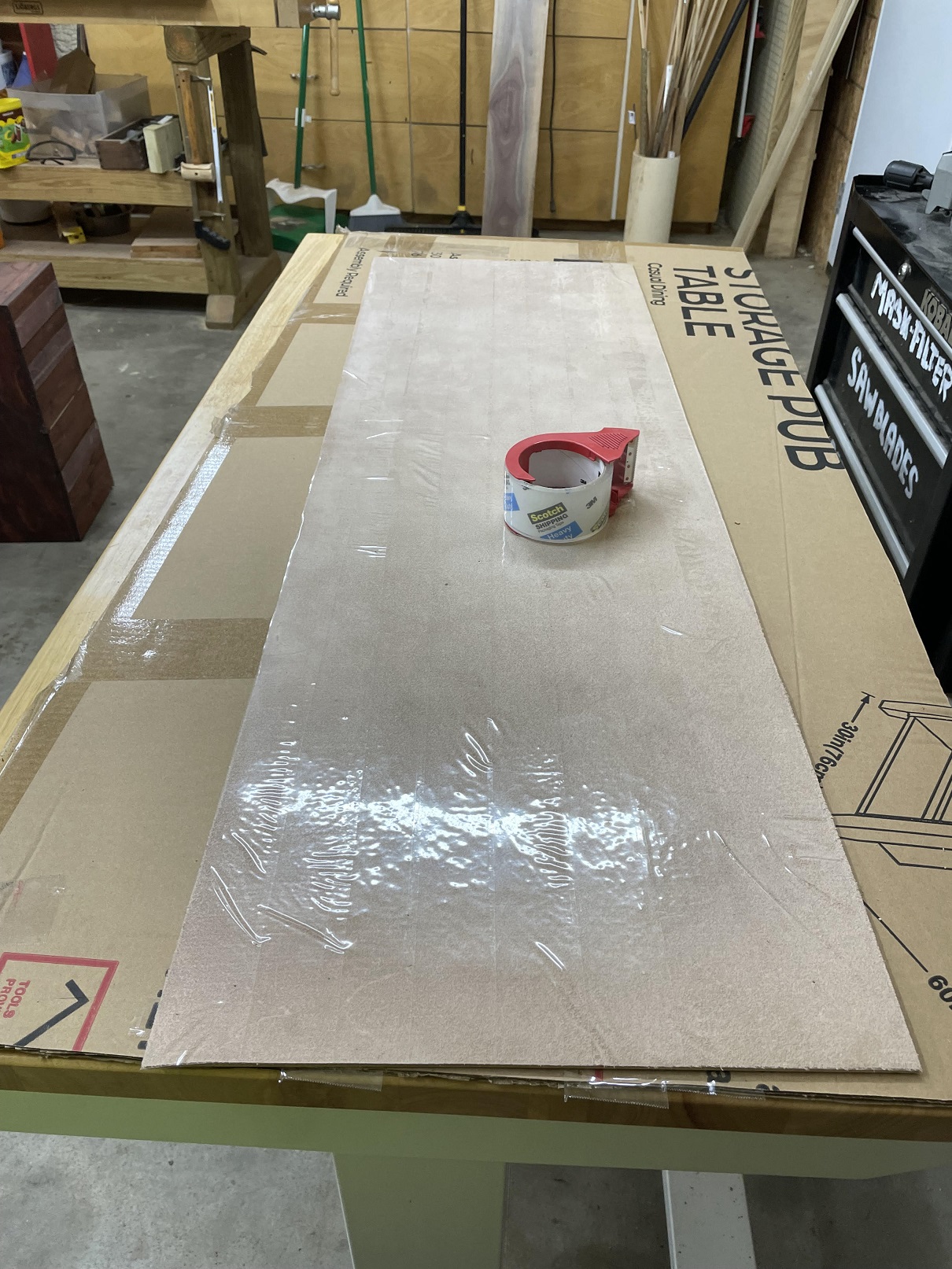

After dinner the leather had dried and I taped the back and we will be ready to tool when the time comes. I won't rush it.
28 back taped.jpg (652.17 KiB) Viewed 3693 times
I am looking forward to it, arthritic aches and all.

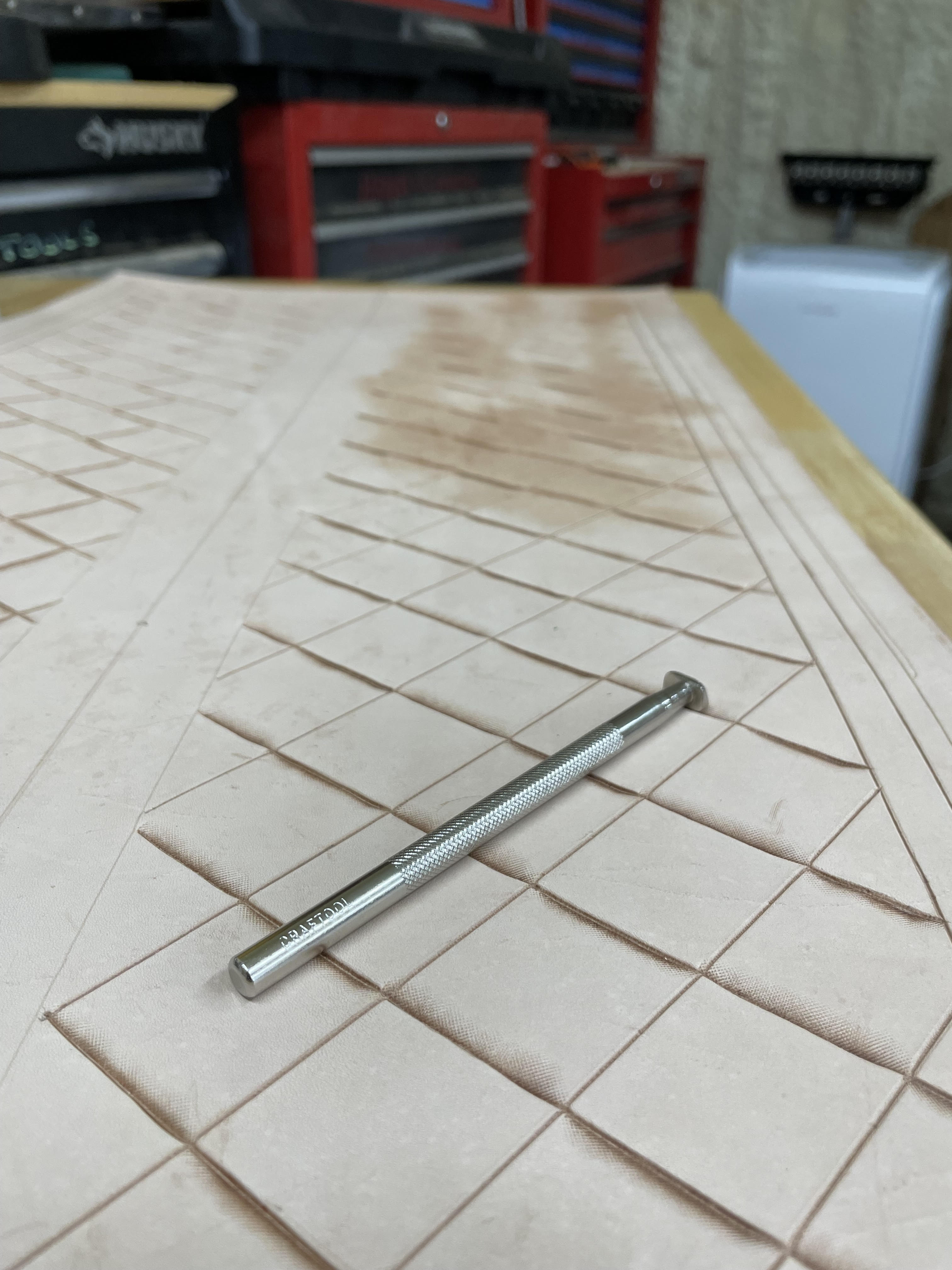

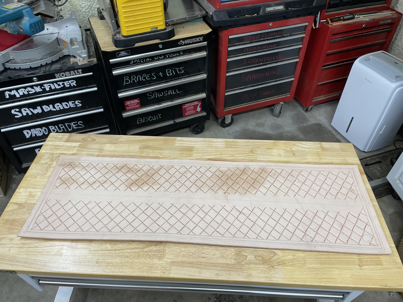

I got out this afternoon after morning chores, and started in on tooling. The first step is using a checkered bevel to alternate beveling on each side of each line. I did the diagonal lines going ONE way so far. There are a lot of line, and two sides, I did the lines on ONE side and you can tell the difference. Hands started to ache, so I stopped. If you push with weakened grip you make mistakes. (The mallet weighs a pound.) :shock:
29 started tooling.jpg (661.17 KiB) Viewed 3674 times
This is the very first step in a long process for the Basket Weave... but looking at the close up, you can already begin to see it appear....
30 close up view.jpg (598.04 KiB) Viewed 3674 times

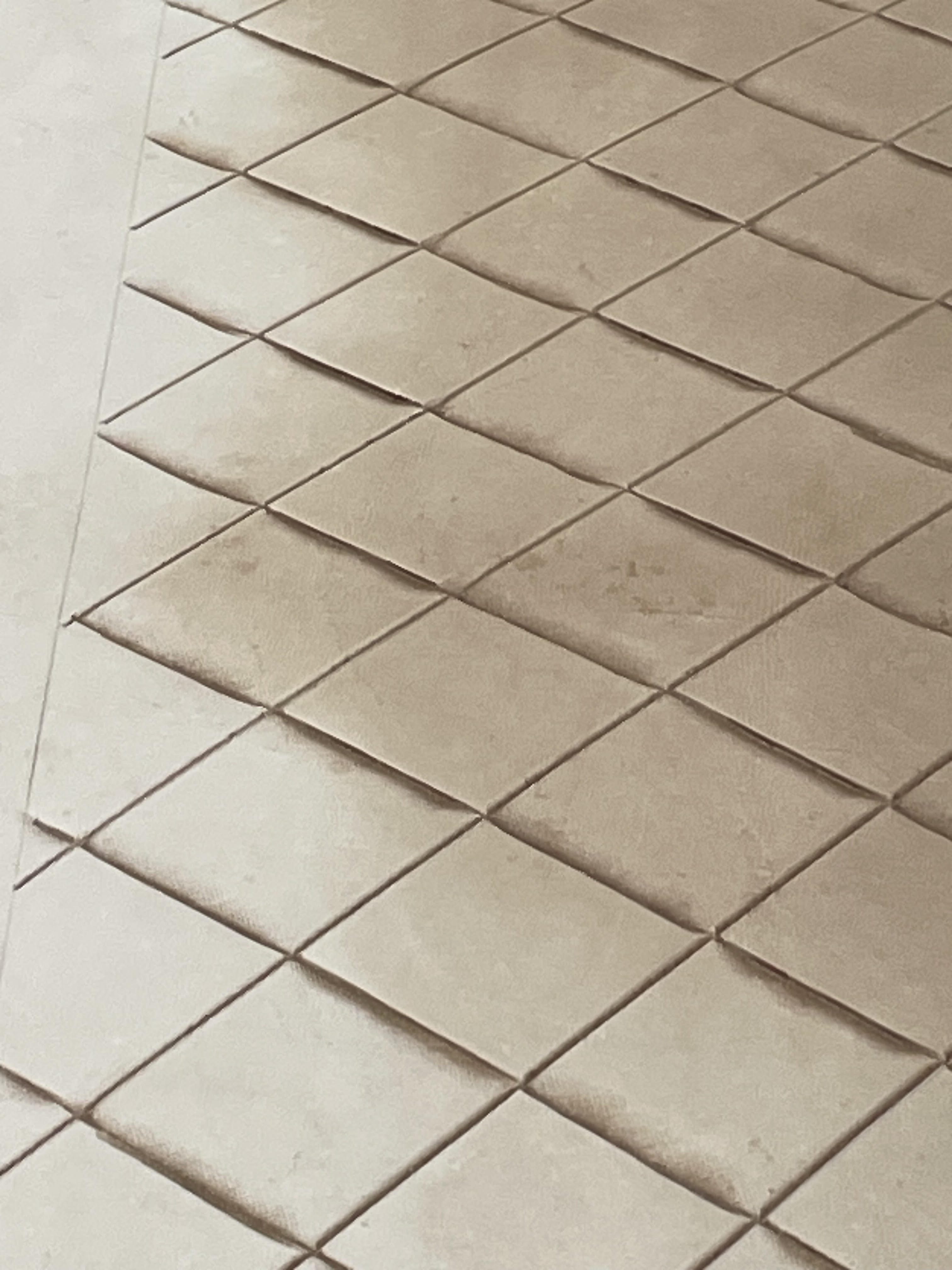

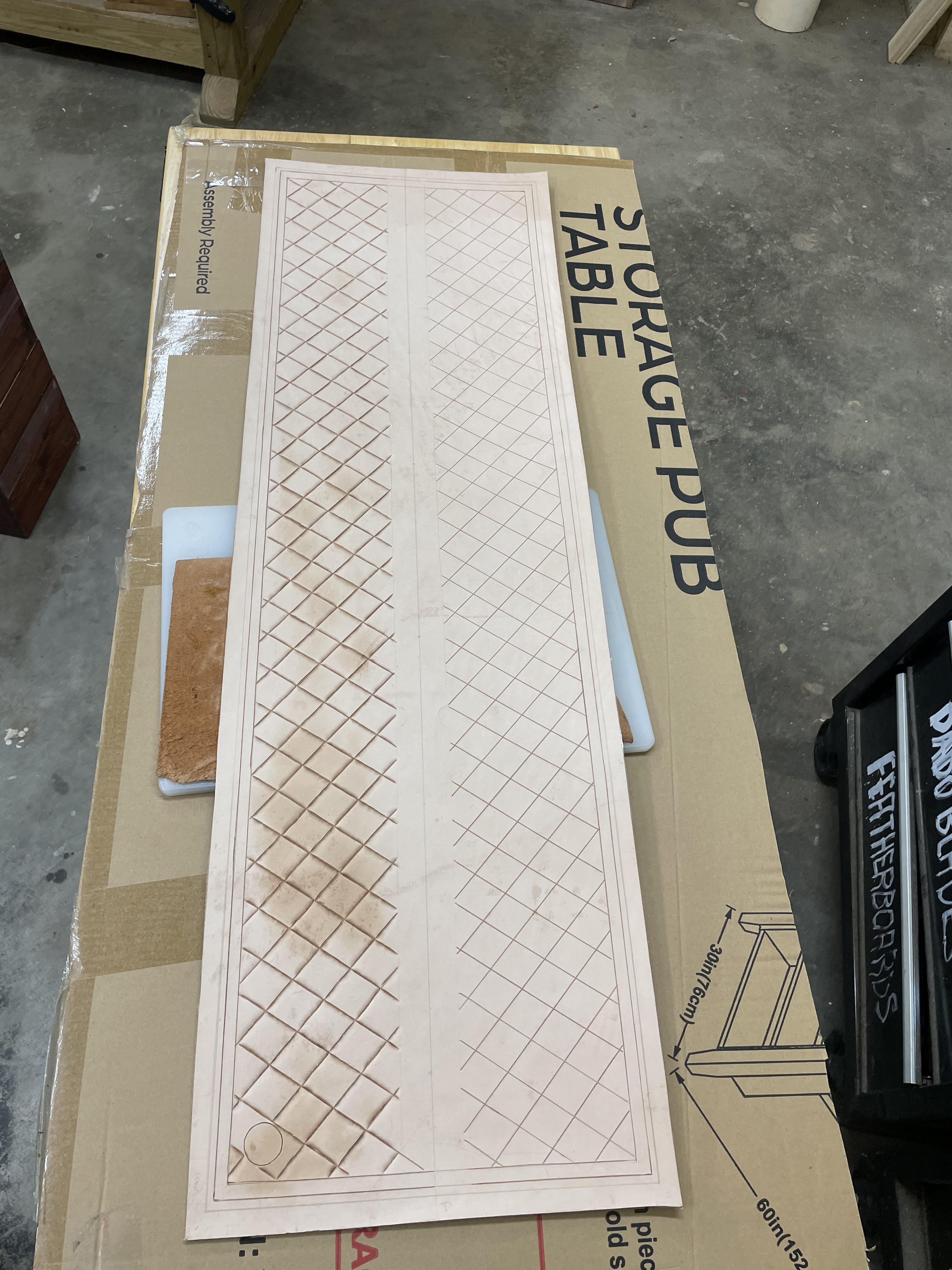

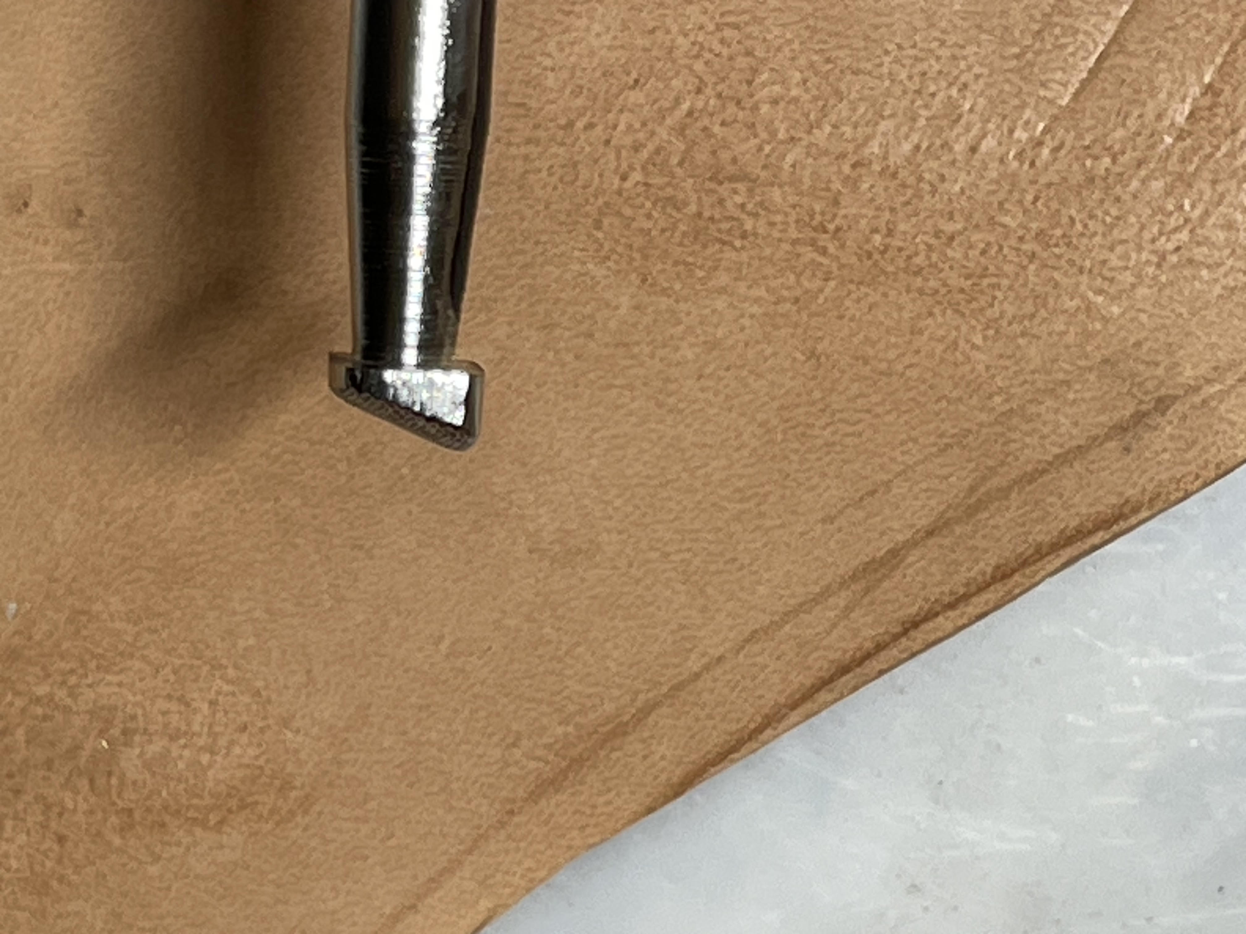

I got back out and worked on the beveling again. How about a better look at the bevel?
33 the bevel side view.jpg (643.75 KiB) Viewed 3667 times

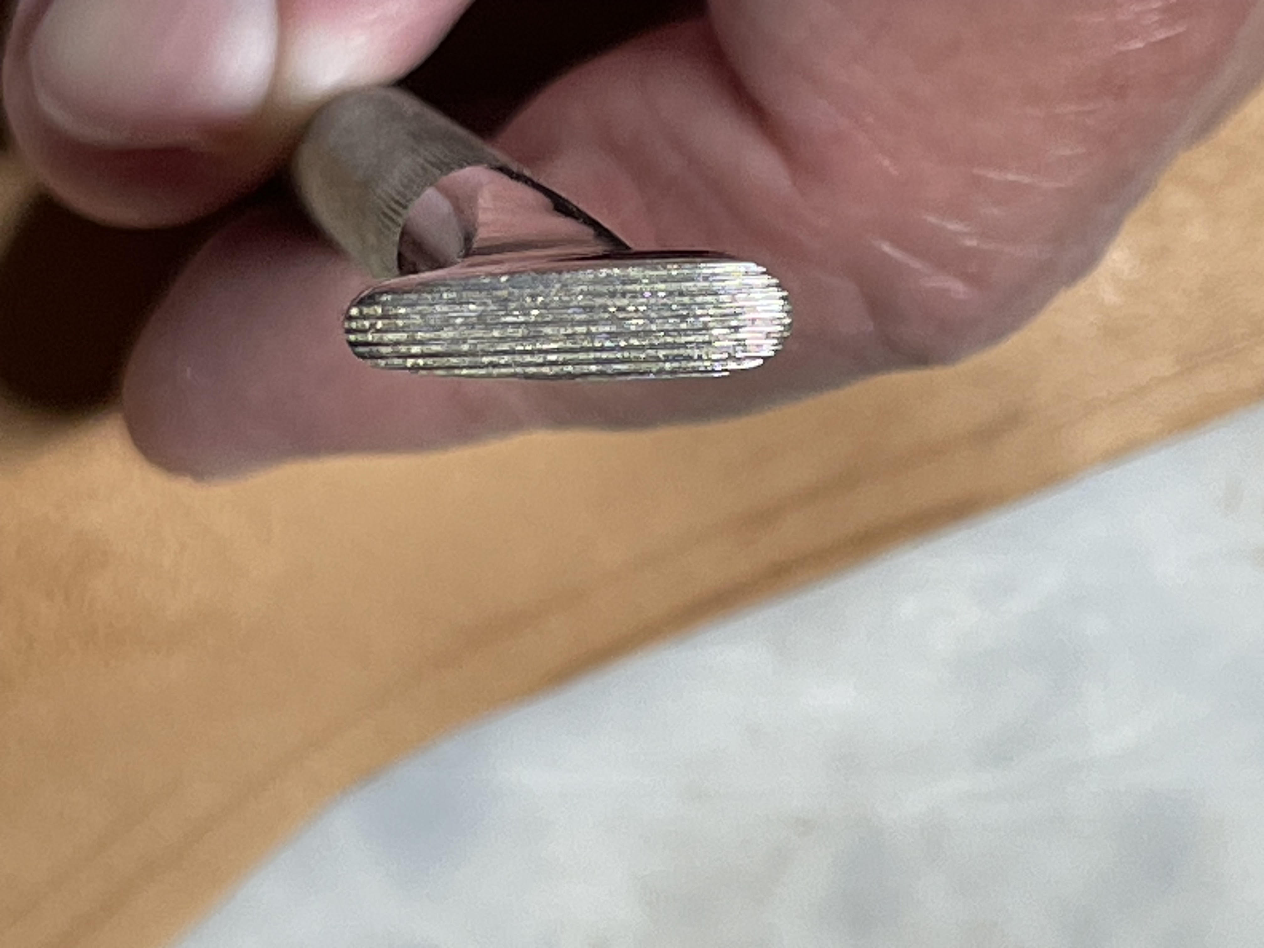

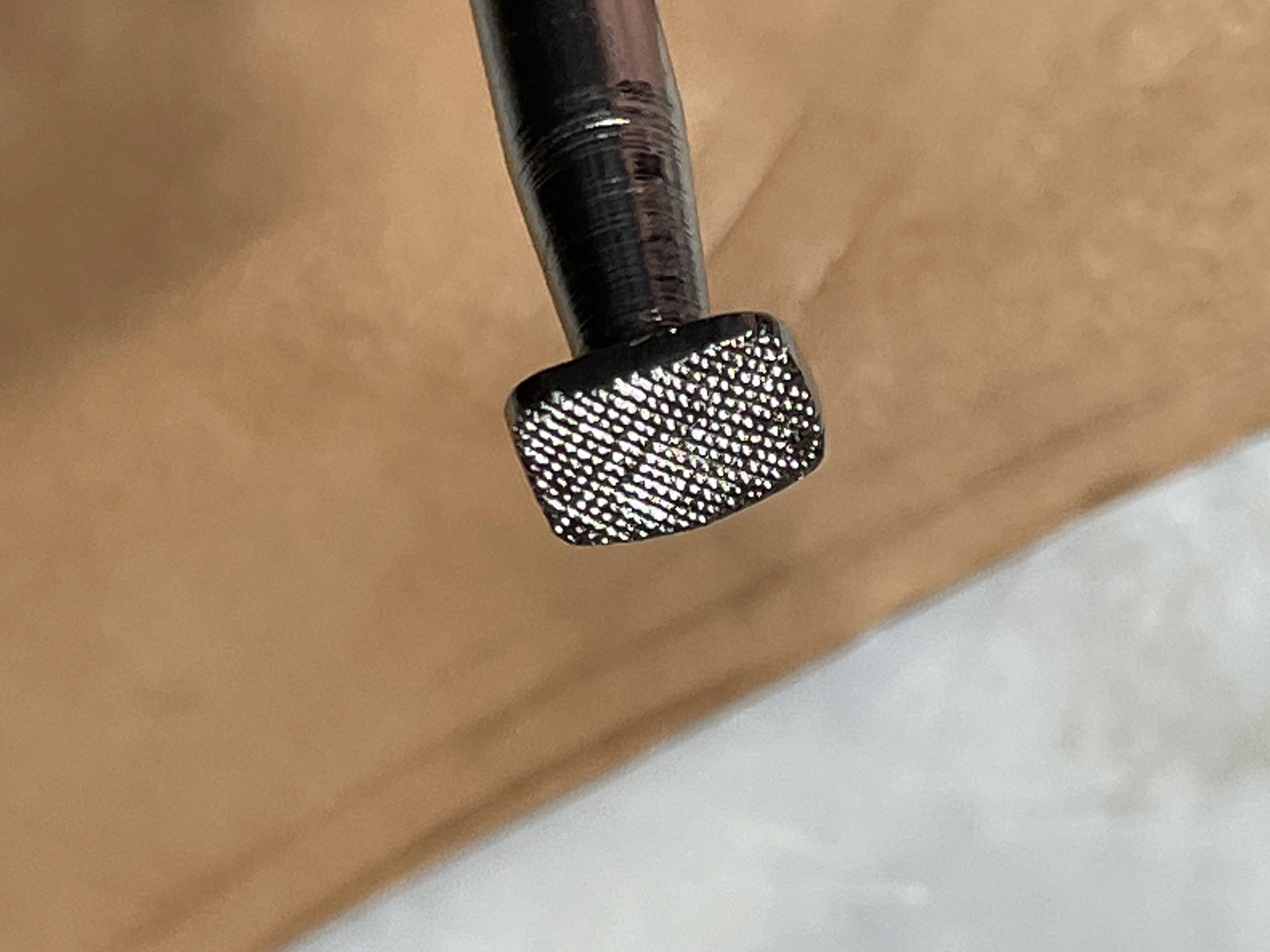

They call it a checkered bevel because it's ... checkered...
34 checkering.jpg (491.27 KiB) Viewed 3667 times
This helps it darken the leather and accent as you bevel the edges of the cuts or design. I got back to work, working the sides of the lines I had already worked in the first session. The trick here is to look at each "Block" and determine if your previous bevels faced IN or OUT. The blocks edges are pairs. If they have a pair of INs, they need a pair of OUTs or vice versa. Work your way thru the area and make that happen, working slowly so you don't mess up the pattern.
31 beveling done.jpg (844.12 KiB) Viewed 3667 times

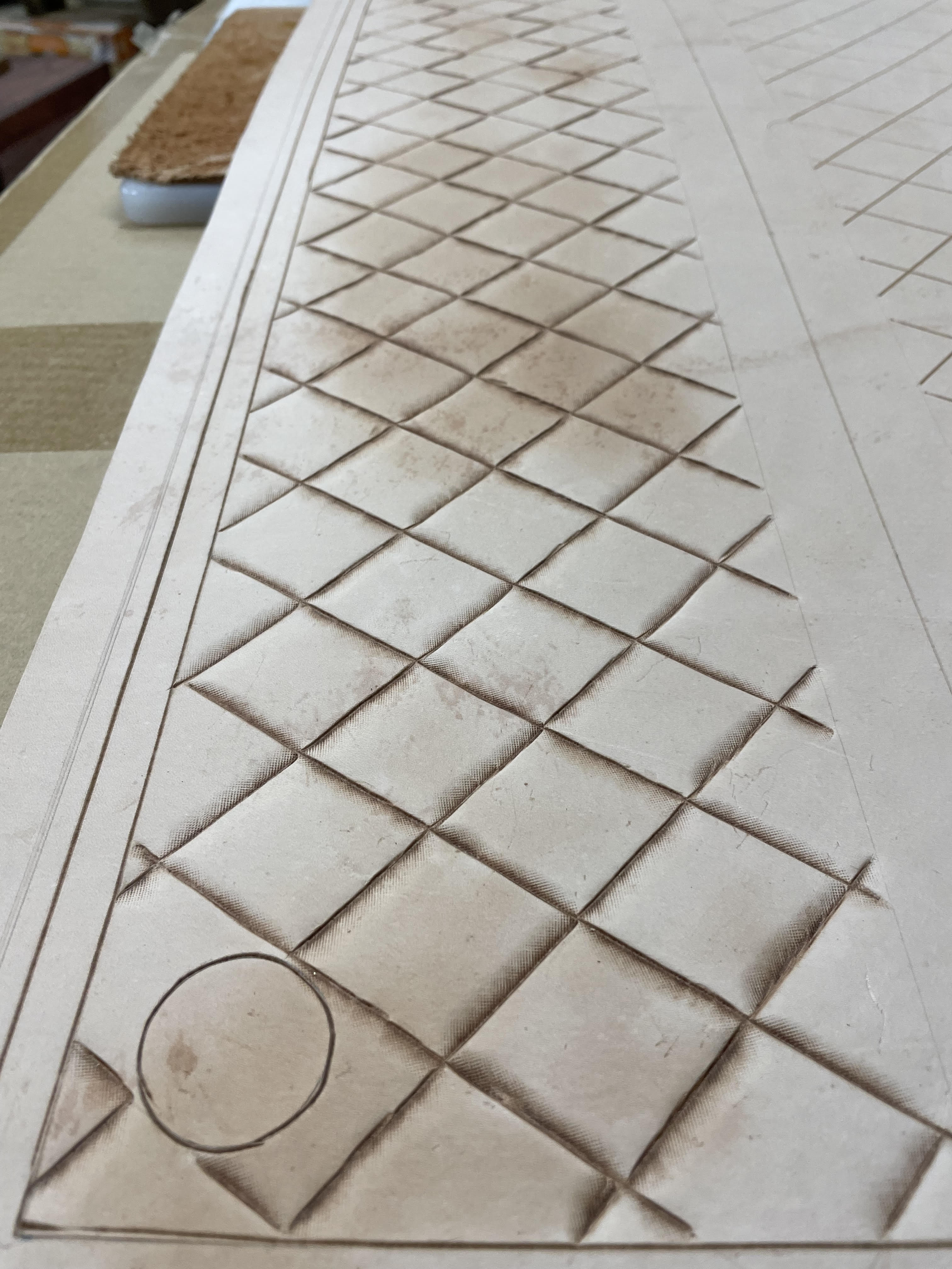

Back out for an afternoon session to tool the borders. The serpentine borders just requires one tool, and it's a slow and steady process. You tool one edge with the tool, placing the design down the edge, then offset by half on the other edge, and end up with the cool border. This is how you begin.
49 beginning serpentine border.jpg (412.73 KiB) Viewed 3658 times
Placement is everything. The back edge of the tool must be square, the width of your tooling window must work, and when you begin the second side, you must center the point on the loop on the other side. I finished the first side and it was looking good, slow and steady paid off.
50 One side done.jpg (361.48 KiB) Viewed 3658 times
I worked slowly thru the second side and thankfully, no errors of note.
52 both sides done.jpg (304.92 KiB) Viewed 3658 times
Here is the long view.
53 full view.jpg (611.91 KiB) Viewed 3658 times
I'll let the panel dry overnight and then begin the staining / finishing process in the morning, and get back to work on the display case itself. The investment in the leather background appears to have been worth the effort. :)
** I can go in first and flatten the little ticks and tabs where the tool left them to make the "snake" seem to sway within the window... some do, some don't... we'll see. I'm a bit anal, I'll probably take the spoon end of the scribe and do just that. (Tomorrow.) :twisted:
