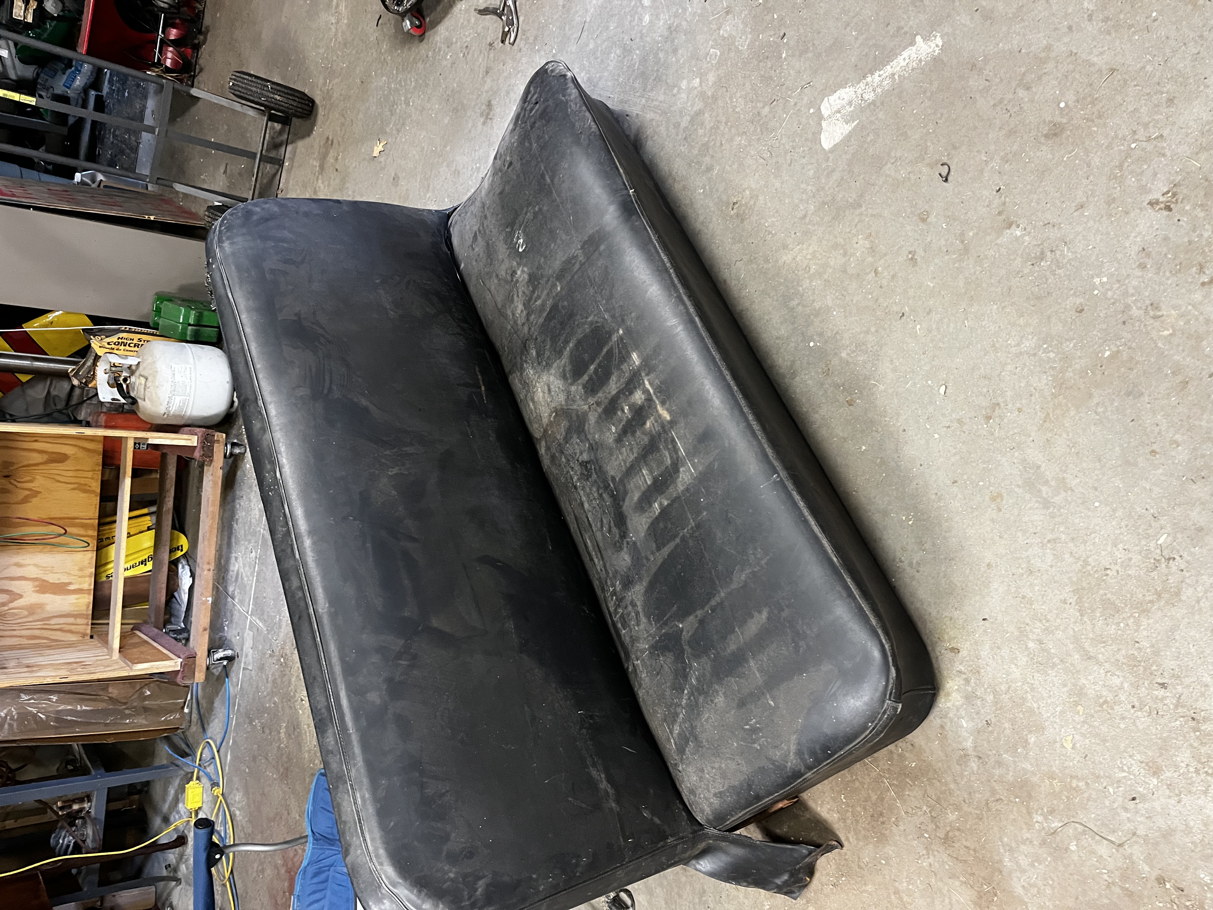

Hate the bucket seats installed in the truck so I have been looking for an original replacement. Found one in Cincinnati that was better than most and brought it home.

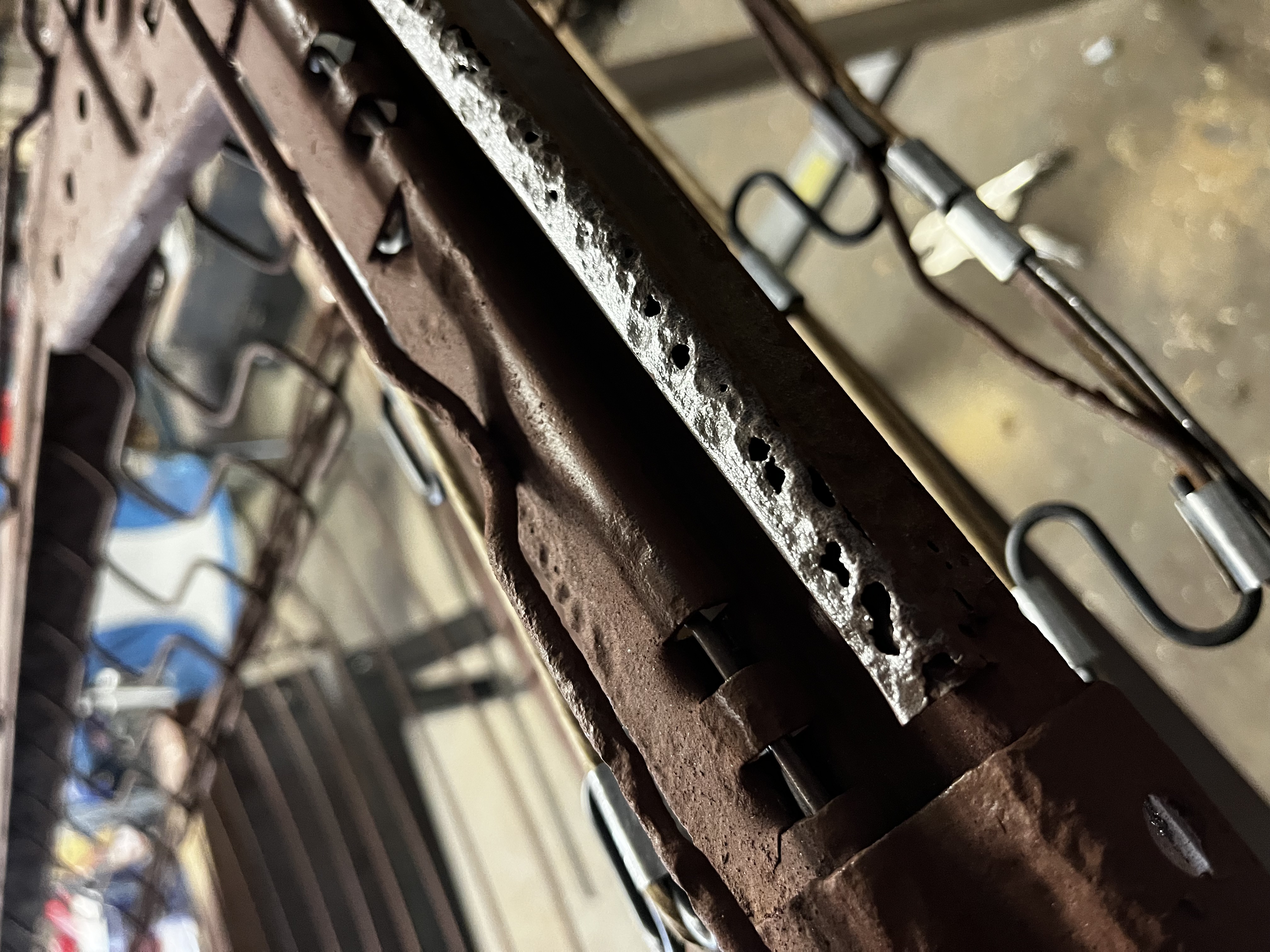

. It had some rust on the drivers side, a couple of broken springs as well as bad sliders, foam and upholstery.

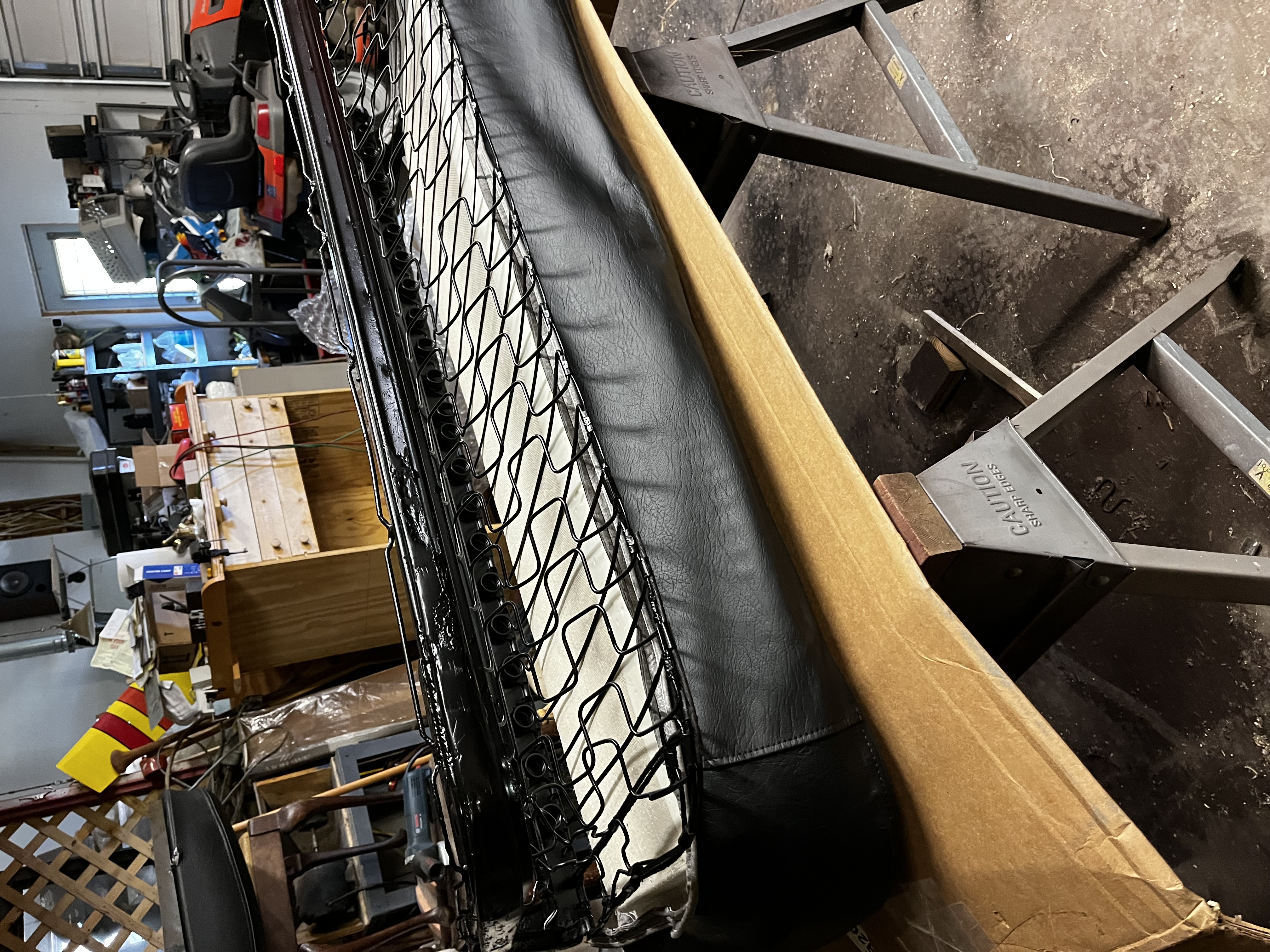

So I stripped it down and sandblasted the frame using a nifty devise from Amazon that attaches to a power washer. Then dried it off and primed it. I was able to get replacement springs for the side and had a friend repair the seat springs with a TIG welder since replacements are not available. Forced JB Weld into the rust holes on the drivers side
. The frame is solid so sprayed another coat of primer and two coats of black sealer paint. The back of the seat is stellar so it got blasted primed and paint. I got replacement sliders, new foam that is formed as the original and upholstery that mirrors the original vinyl. Now ready to tackle the new covering in the morning.

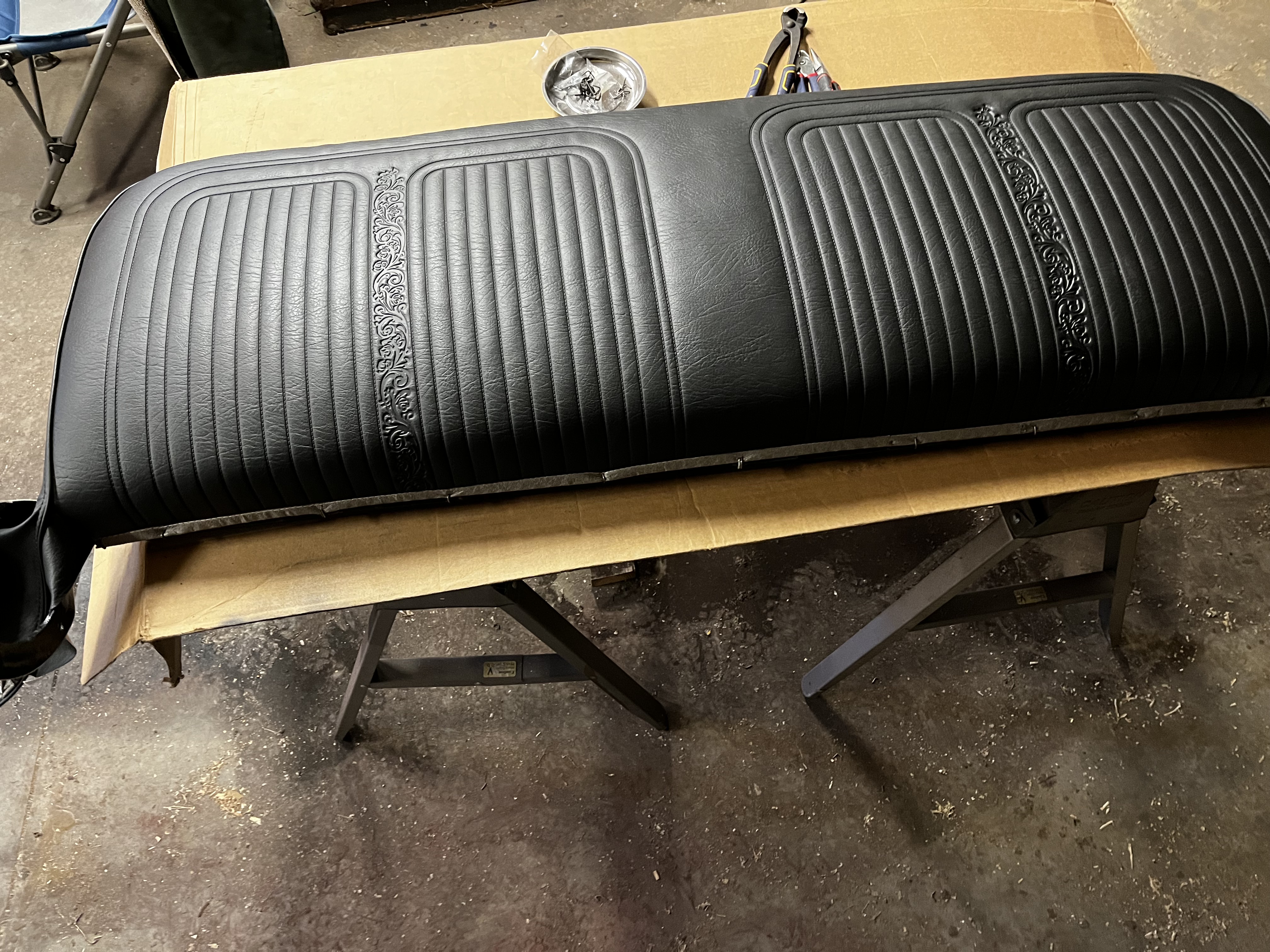

Post by Ernie » Fri Nov 17, 2023 3:10 pm
Got the back of the seat done and think it looks great.

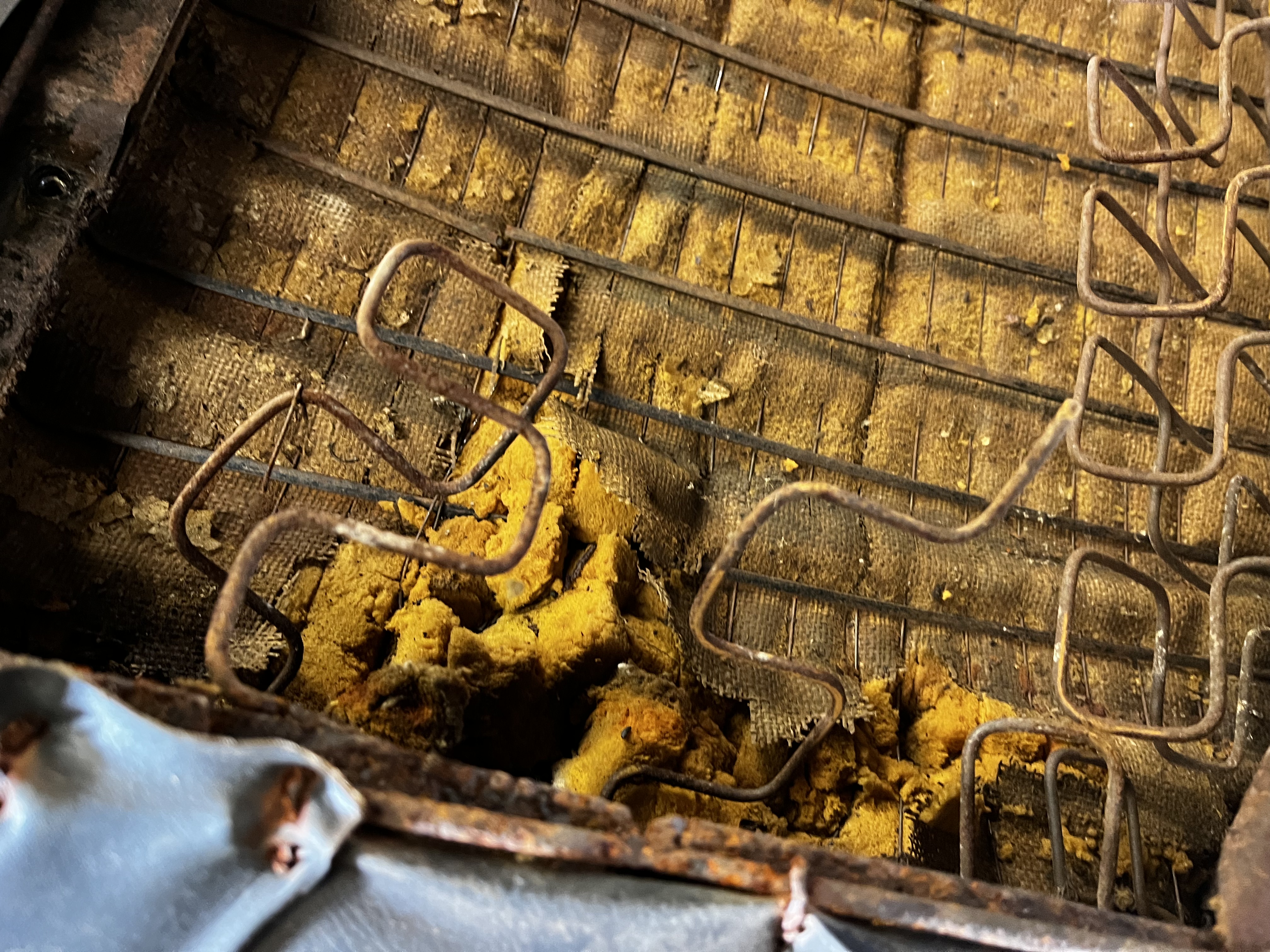

Set the bottom on the bench and set the foam for that on top and had to admit that it was the wrong foam. It was about 6" too thick for the upholstery to fit and I was not sure how I could even climb up on it let alone keep from hitting my head or getting my feet on the pedals.
Since I used one piece of the set I could not return it and I could not find the correct replacement without buying both parts. So I did what I probably should have done initially, I took it to an upholsterer and he will have it finished early next week. Then I will reassemble the seat to mount in the truck. I have this great piece of foam so I was thinking about making a love seat :lol: Sometimes I learn the hard way.

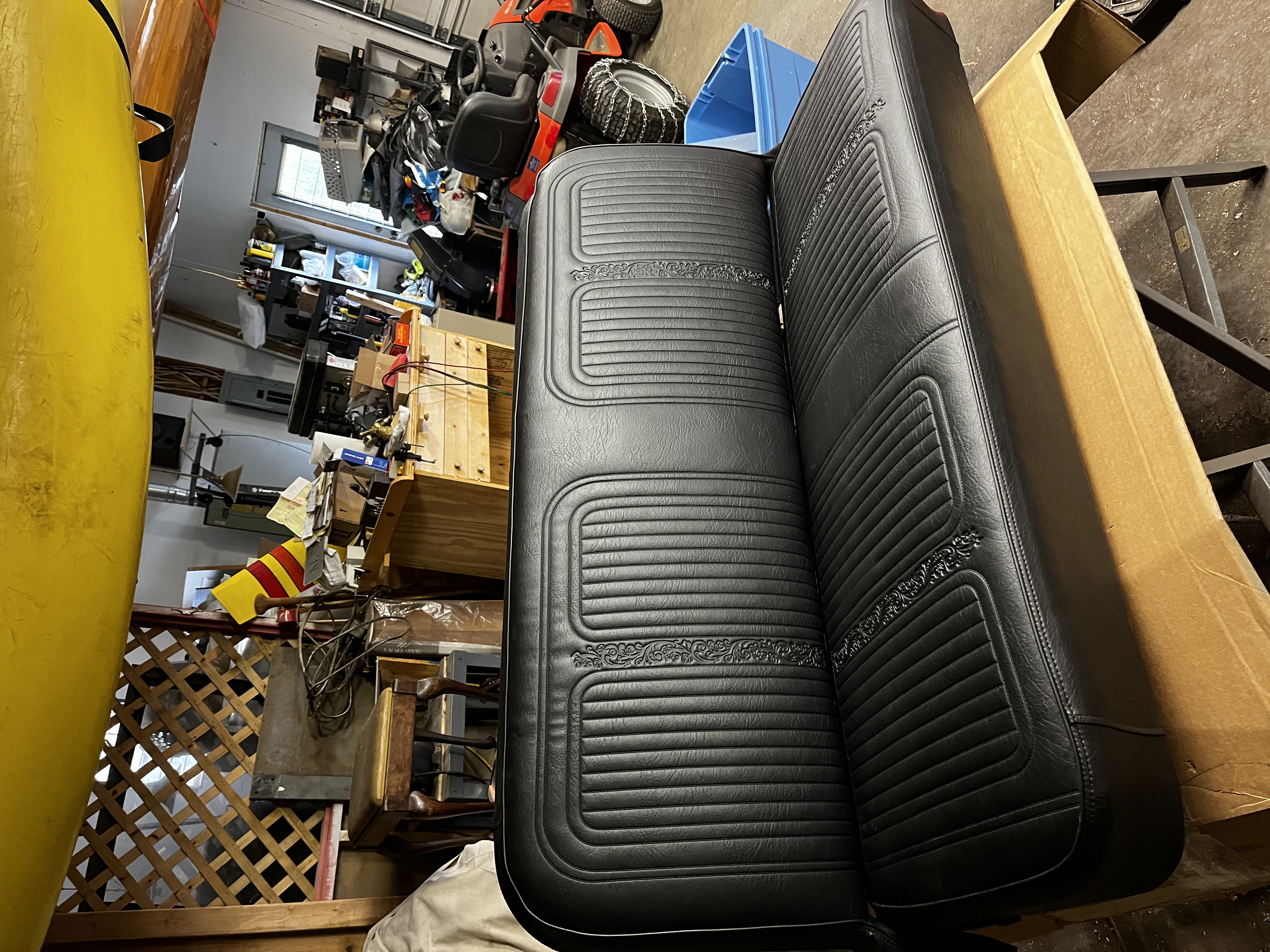

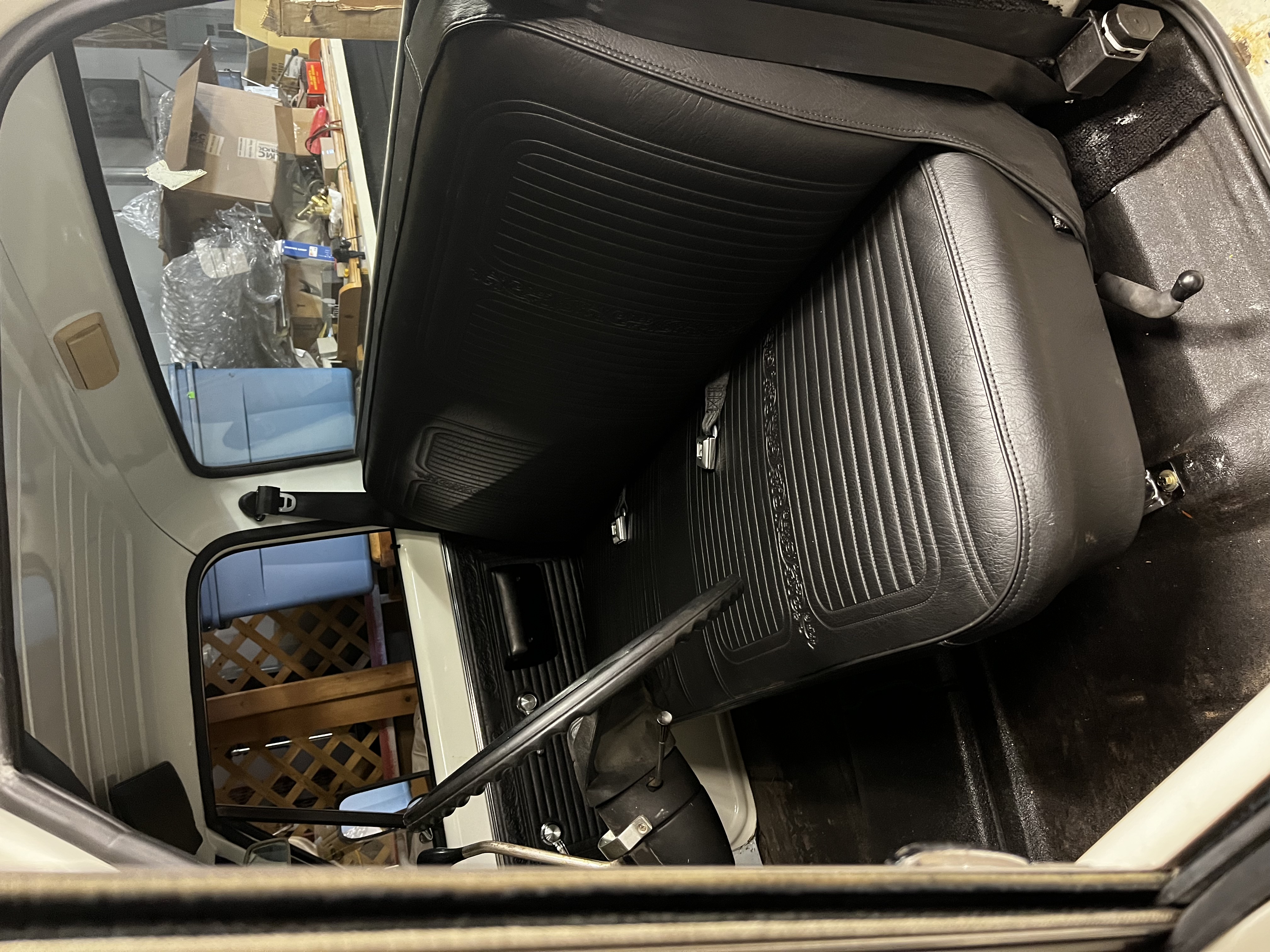

Post by Ernie » Sun Nov 26, 2023 7:08 pm
Got the seat assembled and sliders installed. Now have to get the truck inside to take out the bucket seats and find out what I have to do to mount the bench seat. Yes I sat on it and it was very comfortable.

Post by markiver54 » Sun Nov 26, 2023 7:18 pm
The seat looks great!

Post by Hatchdog » Mon Nov 27, 2023 10:22 am
Really like the pattern on the seat.

Post by BrokenolMarine » Mon Nov 27, 2023 10:32 am
That seat turned out really nice. Everyone today puts buckets in the trucks but I like bench seats. More room, not as confining, and I liked the old seat covers with the pockets across the front with the lateral pocket to hold the shotgun. ;) I had an old beater Ford Ranger, with the Navajo Blanket Style seat covers, and my Mossberg 500 rode in the slot, my wallet and checkbook in the pocket of the seatcover, always handy.
Hit a deer once with the Ranger and the Geico Agent had me remove the corner of the cover to check and insure the seat underneath wasn't trashed before he appraised the truck / Damage and was surprised the seat was perfect. I told him that I just liked the look/feel/utility of the cover vs that plain seat in the Ranger. :)
YOUR seat is beautiful.
Posts: 2544
Re: New (to me) 69 Chevy C20 pickup
Post by Ernie » Mon Nov 27, 2023 7:31 pm
Thanks, it is the original pattern for 67-72 and I am very happy with the results. Now to pull out the buckets and see if I can get this installed without tearing something.

Post by Ernie » Thu Dec 14, 2023 3:01 pm
Got the seat installed today along with the new seat belts and I am happy with the results. The upholstery pattern matches the door panels and it is much more comfortable. Looks like the trucks I remember. Received a new instrument panel that is exactly like the original and that is next on the list as soon as I get the new speedometer cable.
