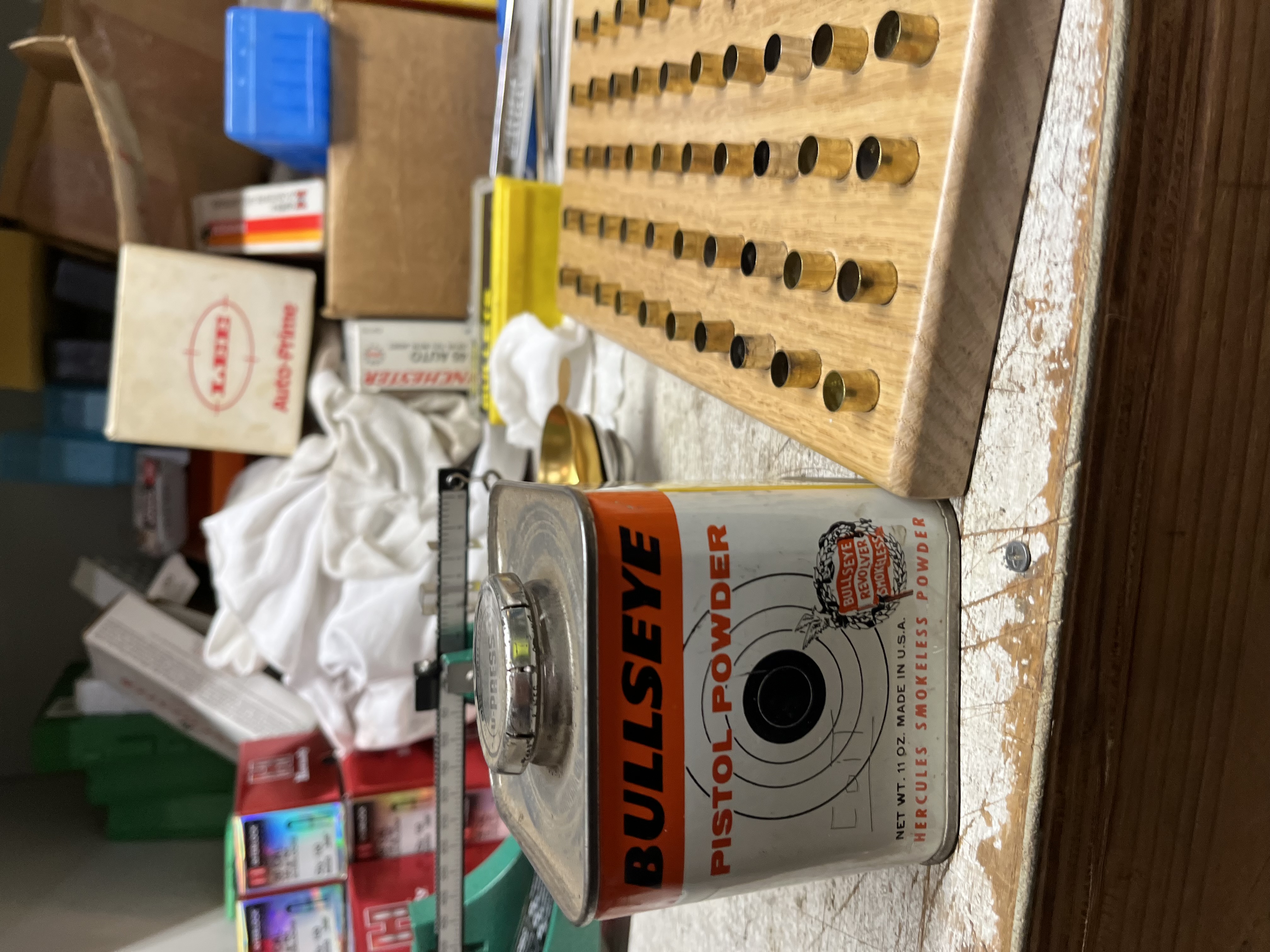

Post by Mr. Neutron » Mon Dec 19, 2022 5:47 pm
Loaded up some .380 ACP today for my little Ruger MAX LCP. Thought I’d throw some ear muffs on, and go outside and function check a few rounds. And saw this goofy mole on top of my grass, doing a 45 mph breast stroke kinda deal across the yard. How fortuitous to have a weapon at just the right time!!!!!
Oh, yeah………. The small cylinder worked great for the small charges it threw for the .380 today. Repeated well. Any minor variations (less than a tenth, I’d guess) are more likely due to the Bullseye powder than the powder throw itself. Made some ammo with it that very possibly saved my life from a charging (well, it was actually scootin’ away……) mole at 3 feet!

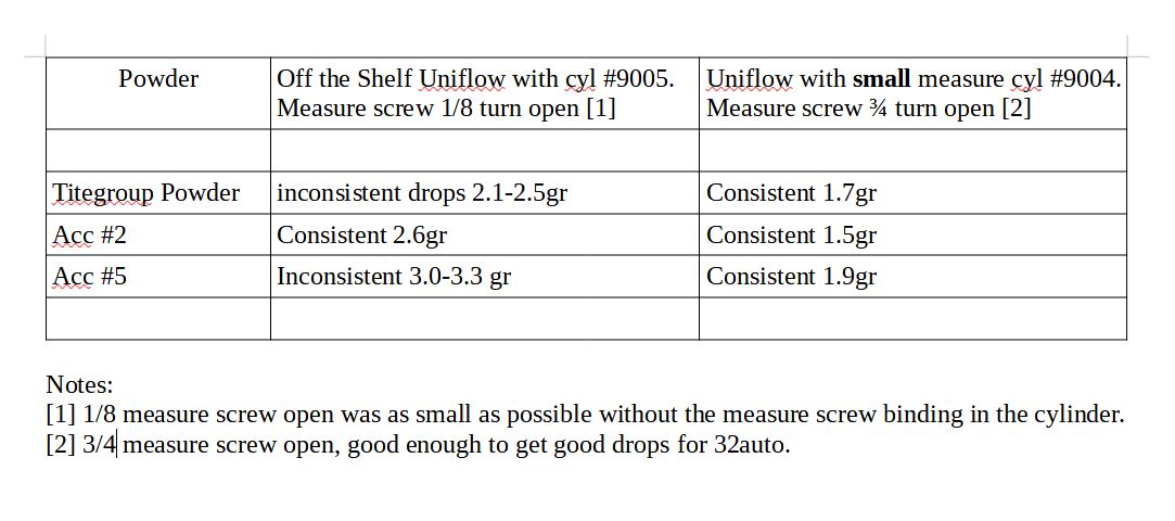

Re: RCBS Shortcomings
Post by Mags » Mon Jan 02, 2023 10:14 pm
Finally had some time today to look at the SMALL measure cylinder compared to the cylinder that ships with the Uniflow. I looked at Accurate #2 and #5 that JohnDavies suggested and Titegroup.
Off the Shelf Uniflow.
The smallest measure I could get with the off the shelf Uniflow was with the measure screw 1/8 turn open. Any tighter and the cylinder would not rotate. For Accurate #5 and Titegroup, I could not get consistent drops. The variance I would not be too concerned about if these were at rifle load scale, but for small caliber pistol this variance is significant. Only Accurate #2 gave consistent drops good enough for 380. Since the measure screw itself couldn't get any tighter, I could not get down to 32auto drops with any of these powders.
Uniflow with Small Measure Cylinder.
I got consistent drops with all 3 powders. Good for 32auto and 380. This with 3/4 turn measure screw open. Since I got what I was after for 32 auto I didn't pursue tighter measure screw turns.
Uniflow Cylinders.JPG (82.38 KiB) Viewed 1724 times
