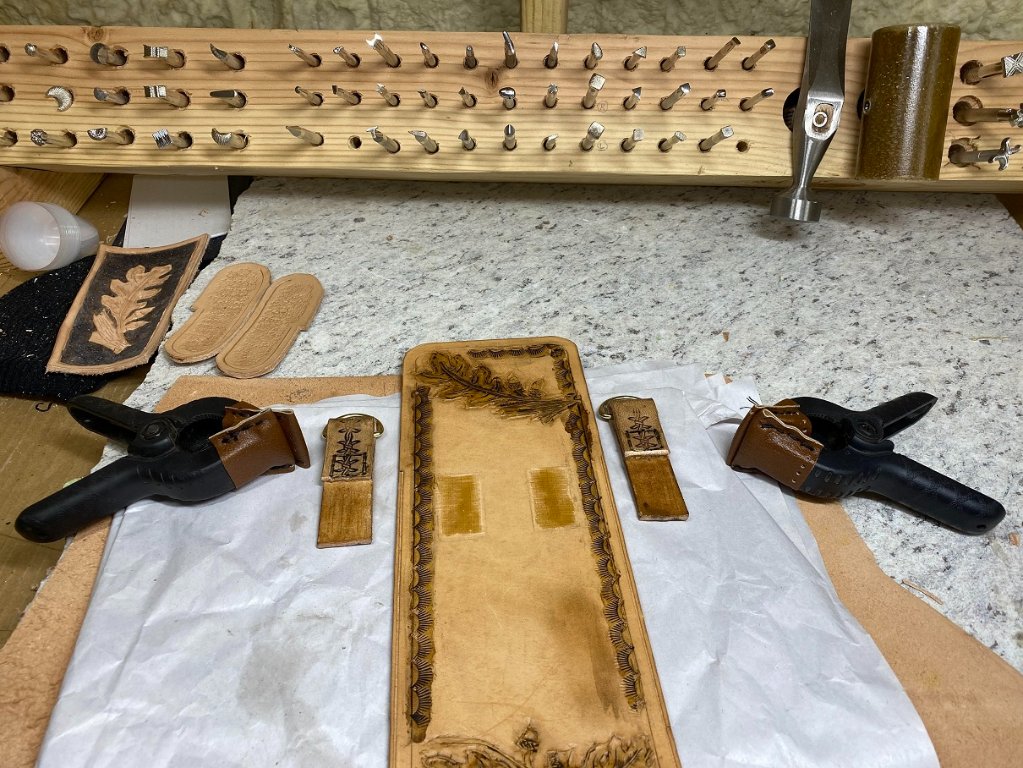

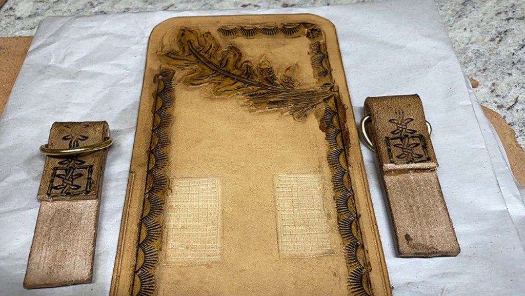

First step for todays work was to prep the main panel and the D-ring straps for the glue up. I took the sharp edges of the beveler and scratched up the areas where I would apply the contact cement to insure that there would be good adhesion. This insured a tight bond, at least until I could sew the Straps down.
30 Prepped for gluing.jpg (149.57 KiB) Viewed 9222 times
Next, I very carefully painted a thin coat of contact cement onto the prepared areas. This meant watching the tip of the brush, and spinning it to contain any drips prior to leaving the can. :evil: I learned this the hard way when I dripped on a previous project. Finish won't penetrate thru or adhere to contact cement. :twisted: Here the cement is applied and curing for the required time to turn tacky.
31 cement curing.jpg (203.42 KiB) Viewed 9222 times

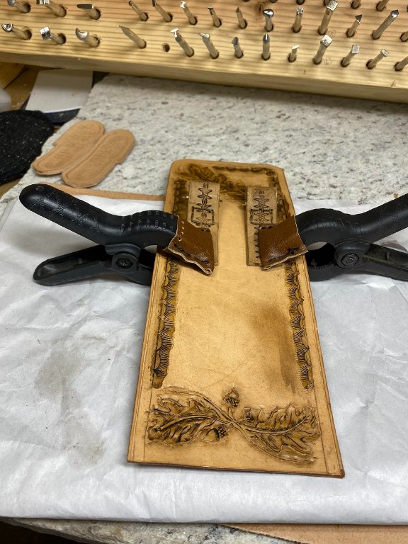

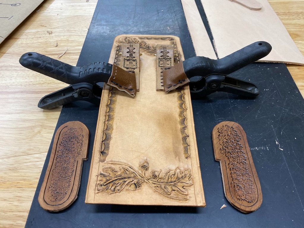

Next you CAREFULLY apply the straps in the indicated areas, insuring they are facing the correct direction. Putting one on UPSIDE down would suck. :cry: Not that I have ever done that. :? Put them on and put the clamps in place.
32 Glued and Clamped.jpg (106.28 KiB) Viewed 9222 times
While the glue sets, I oiled the side panels, then burnished the edges. Buffed them out and applied the antiquing. Then wiped away the excess and set them aside to dry. This means they are all drying and awaiting the sewing on of the straps.
33 ready for sewing.jpg (173.84 KiB) Viewed 9222 times
Once that is done a bit later, we can mark and measure for the box stitching, and we'll be done. Waiting in the wings... ?

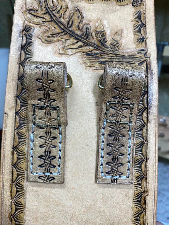

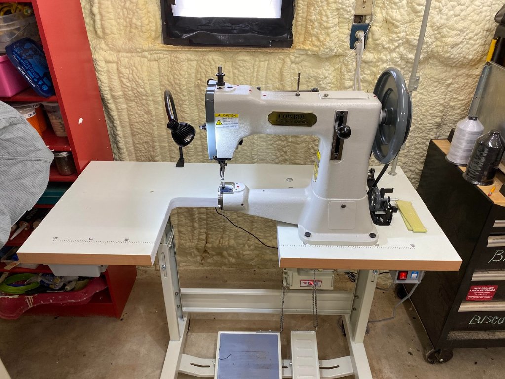

Got out in the shop and pulled out the big gun, My Cowboy 3200. Time to sew down the D-Ring straps. I was able to do that since I had access on the flat main panel. The box stitching will have to be done by hand. I had a high pucker factor here, haven't had much time at the controls of this thing and still learning.
35 cowboy 3200.jpg (159.69 KiB) Viewed 9212 times
It was slow and steady on the mark, but I was very happy with the results.
36 sewn down.jpg (155.13 KiB) Viewed 9212 times

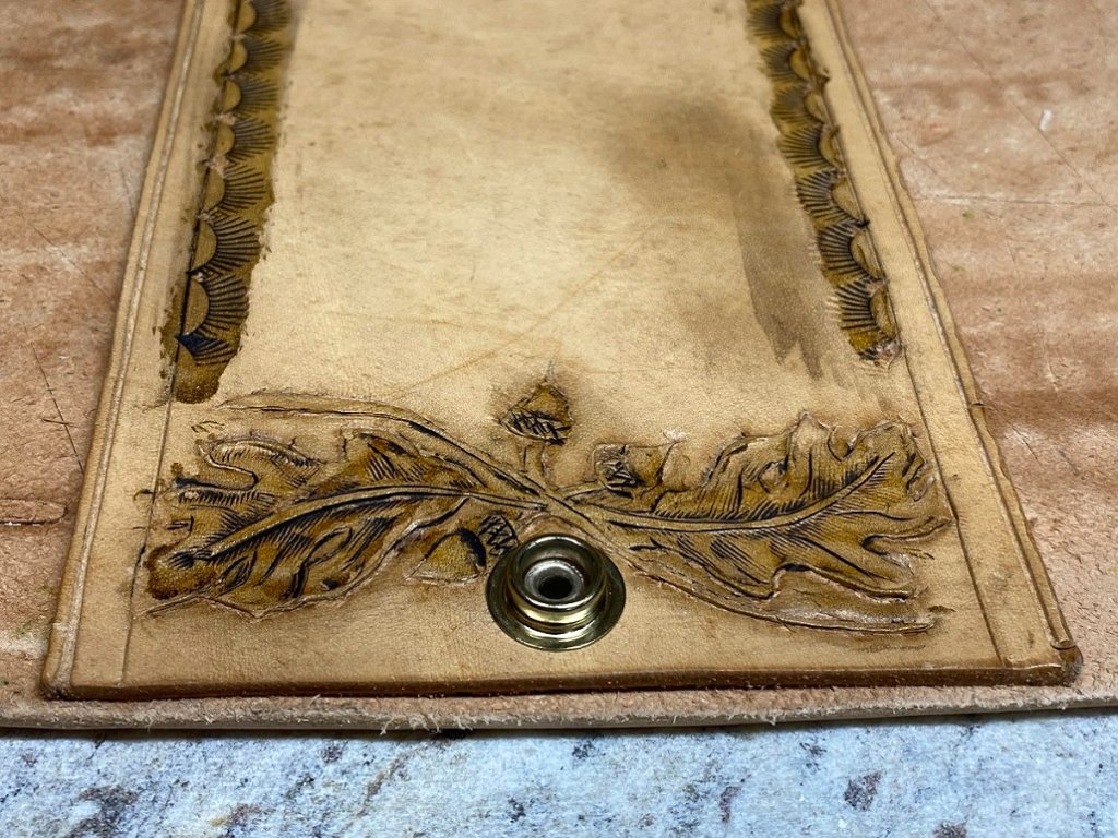

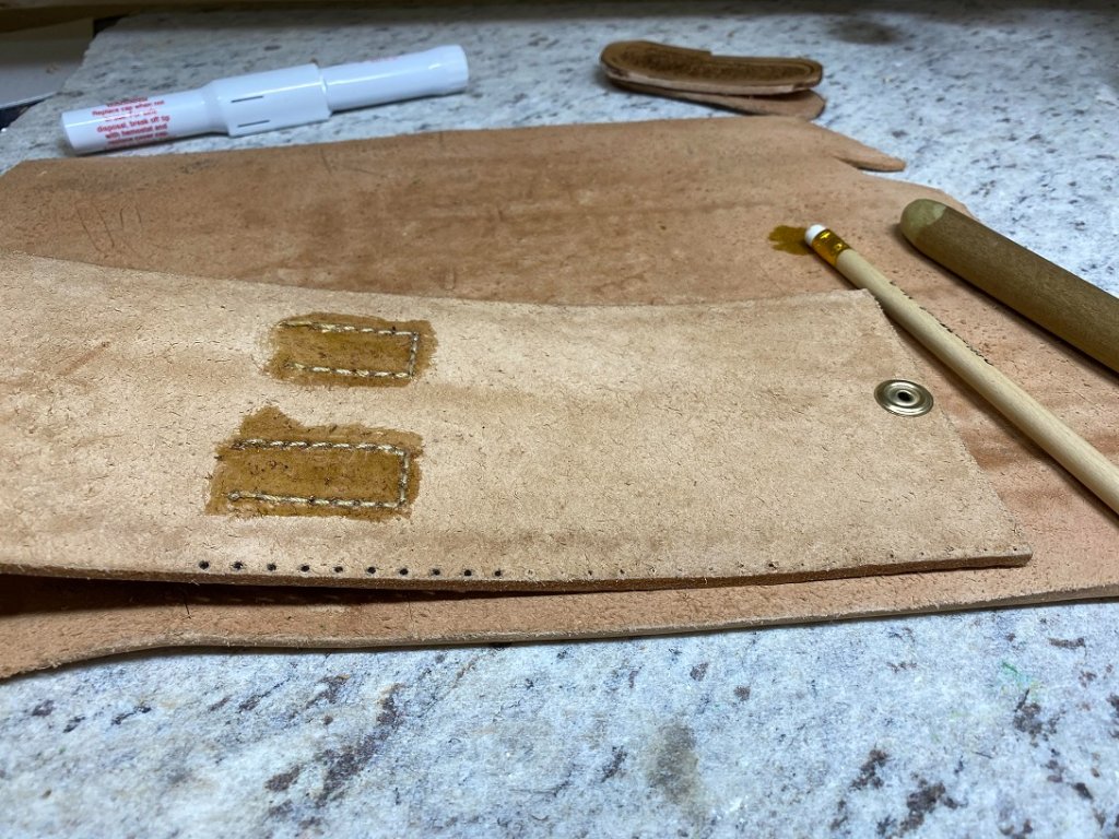

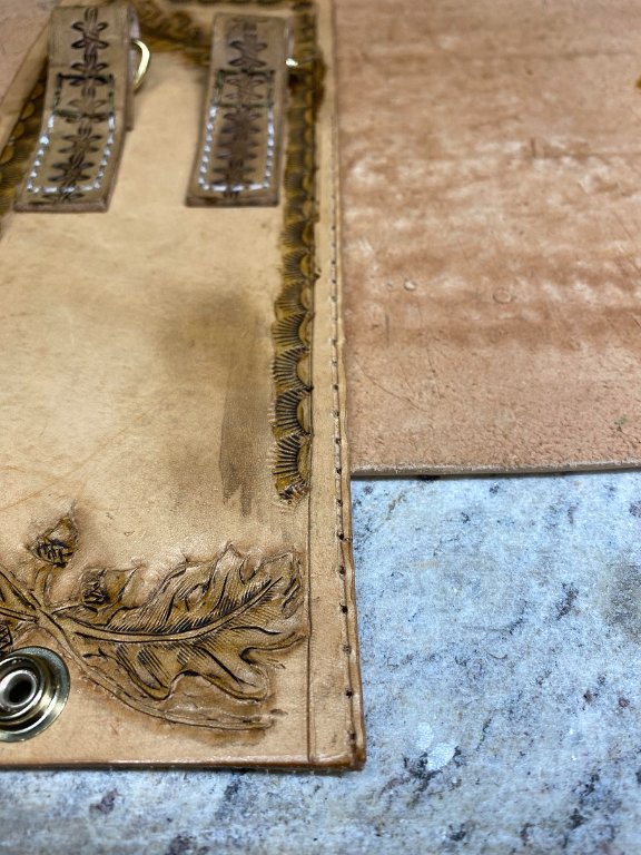

So, first step this morning was to measure and mark the location of the snap bottom for the pouch. Punch the hole, then seat the snap. Knocked that out first thing so I didn't forget after creating all the holes for sewing together the pouch and then having to try and seat a snap INSIDE the pouch. :|
37 snap.jpg (210.07 KiB) Viewed 9208 times

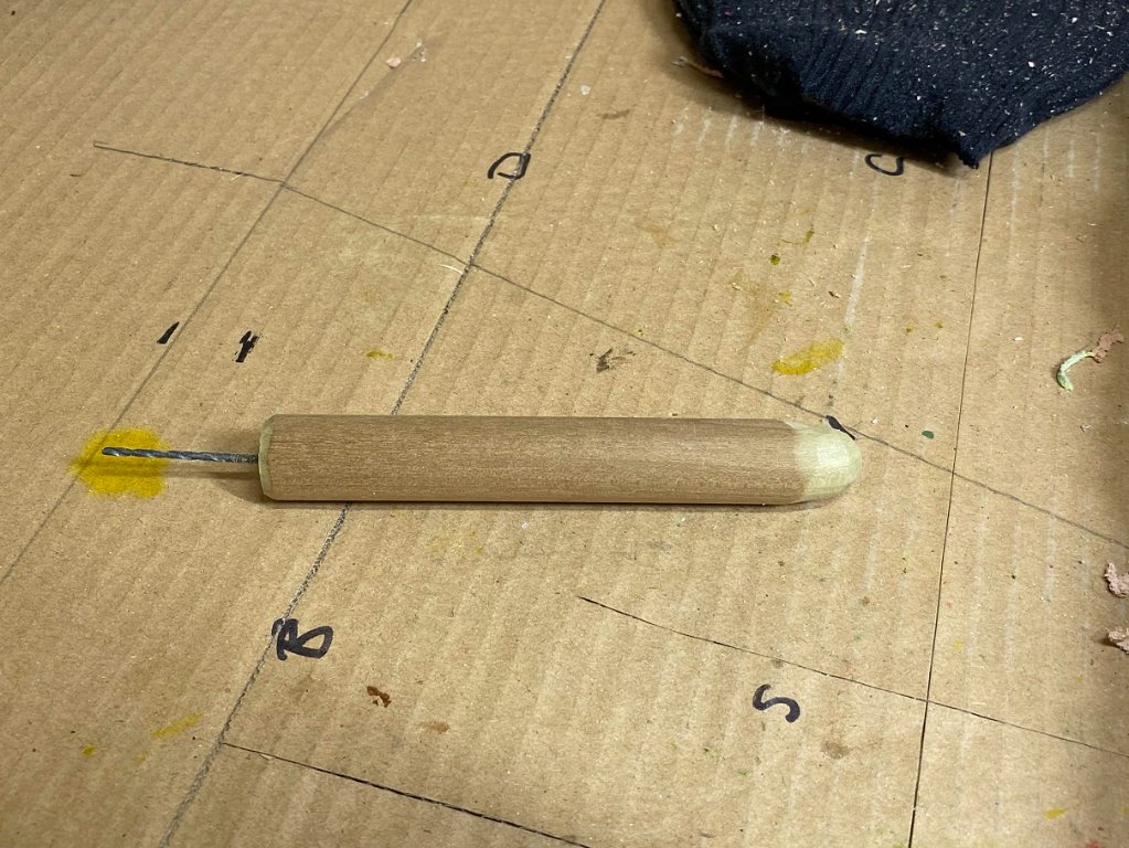

Once that was done, I marked the double line of holes that needed to be put thru the main panel. They are simple thru holes that normally I would have knocked out on the drill press, but I decided to knock out by hand. I didn't have an awl with a small enough diameter. Hmmm. Need a tool make a tool. I have seen that several times, so... I made one.
38 make a tool.jpg (185.58 KiB) Viewed 9208 times
It worked well, but I might make another with a fine finishing nail so I can just press through, rather than hand drilling. As you can see, the drill worked fine. The first line was nice and neat.
39 one side done.jpg (112.5 KiB) Viewed 9208 times

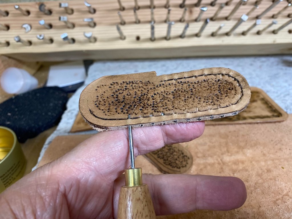

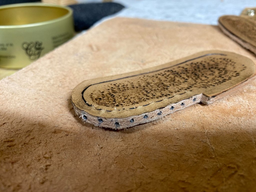

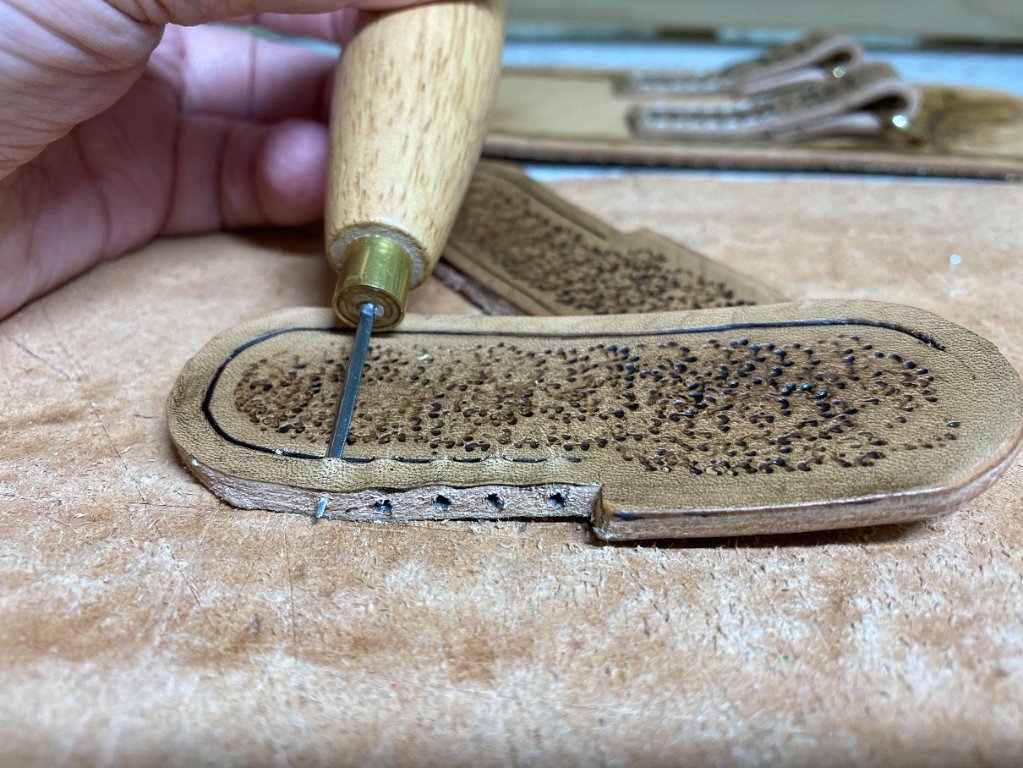

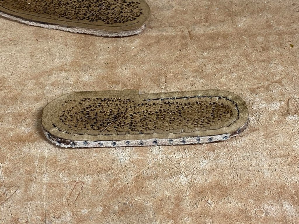

Out in the shop to prep the side panels for sewing. The process is slow and a PITA. :twisted: The first step was to align the main panel and mark the first hole. I did that and pushed the awl thru and formed the first hole, then pushed a needle thru the first pair, to lock that panel in place. With it locked in, I marked the first half dozen holes. I removed the panel and formed them. I put the panel back in place, and put two needles thru the first and last hole pairs formed. I marked another half dozen, then repeated the process. I worked my way around the side panel in this manner to insure the holes would align when it came time to sew.
Here is the process. For step one, you push the awl straight down in the surface to anchor the awl when you begin, then push at an angle that shoots for the center of the side of the leather.
42 one.jpg (175.84 KiB) Viewed 9198 times
The next step is to come back up from the side of the leather and out thru the starting hole and twist to open the path.
43 two.jpg (143.12 KiB) Viewed 9198 times
Then use that sharpened pencil bullseye trick on each hole.
44 bullseyes.jpg (144.69 KiB) Viewed 9198 times
Work your way all the way around, carefully insuring that all the holes are aligned and centered. This takes two to three times longer than the main panel. Maybe after a number of projects it will become easier. :? I got one done, and stopped. With all my joint issues, I know when to take a break.
45 done.jpg (249.08 KiB) Viewed 9198 times

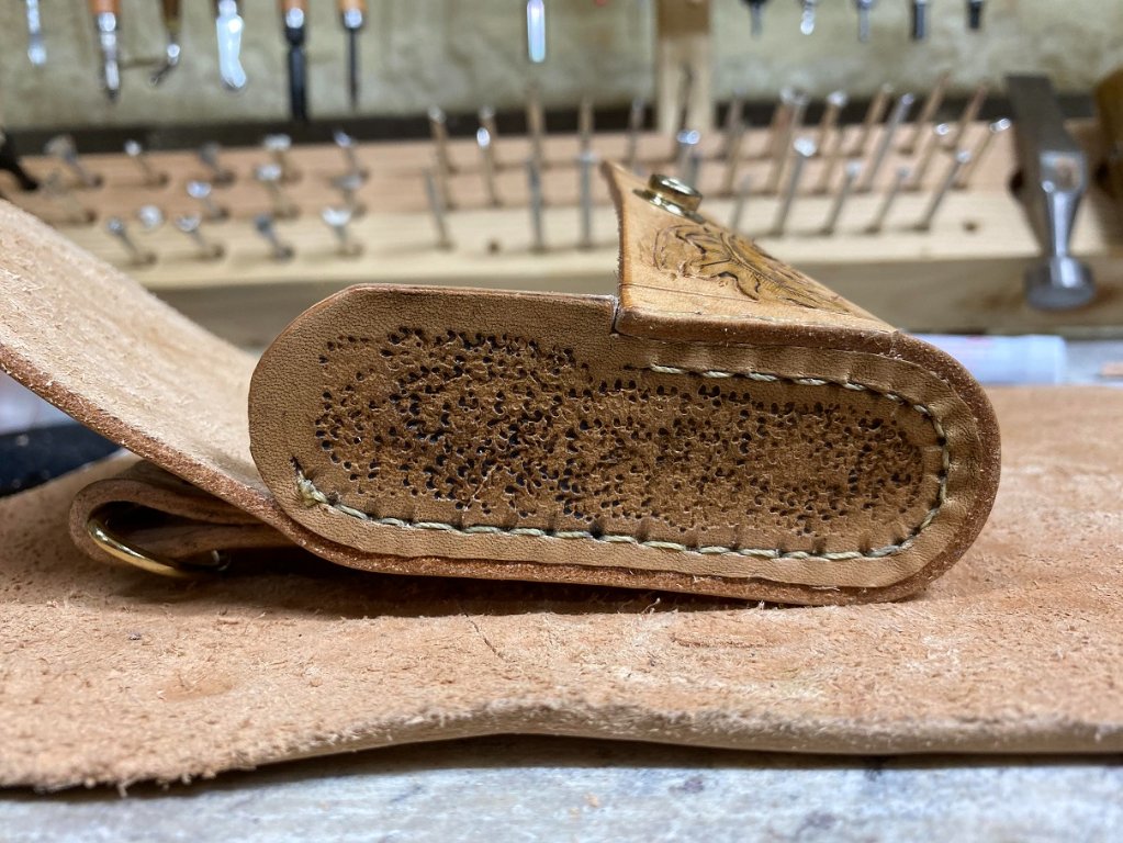

Out after dinner last night and got to sewing. All the prep work made the job "Easi-Er" ;)
I was very pleased after I finished the first side that it turned out well. I got a nod of approval from the Boss.
The first few stitches are the hardest as the project flops around, but once you get those tight, you have a better time of it.
You always leave the last stitch a bit loose to ease the next, then pull them both tight, then allow the last one to loosen a bit.
Repeat. When you backstitch the last, you pull very tight and lock them. Burning melts them together and you are good.

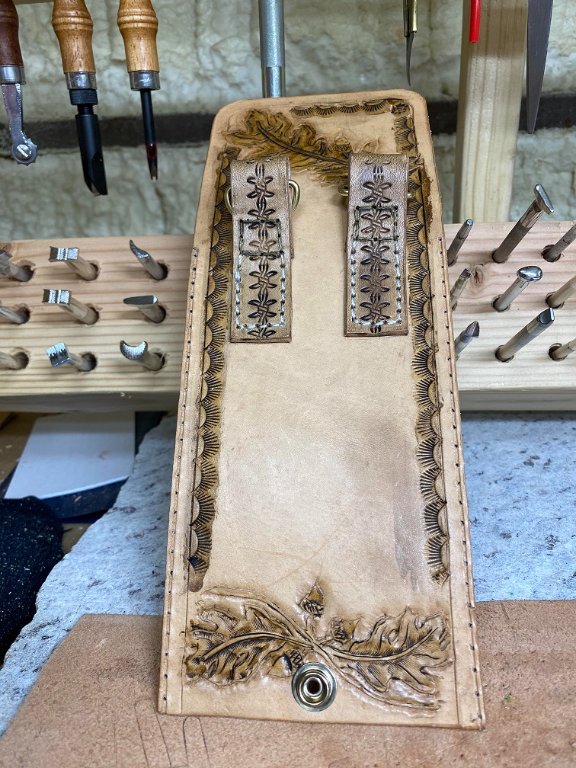

46 box stitch.jpg (178.01 KiB) Viewed 9193 times

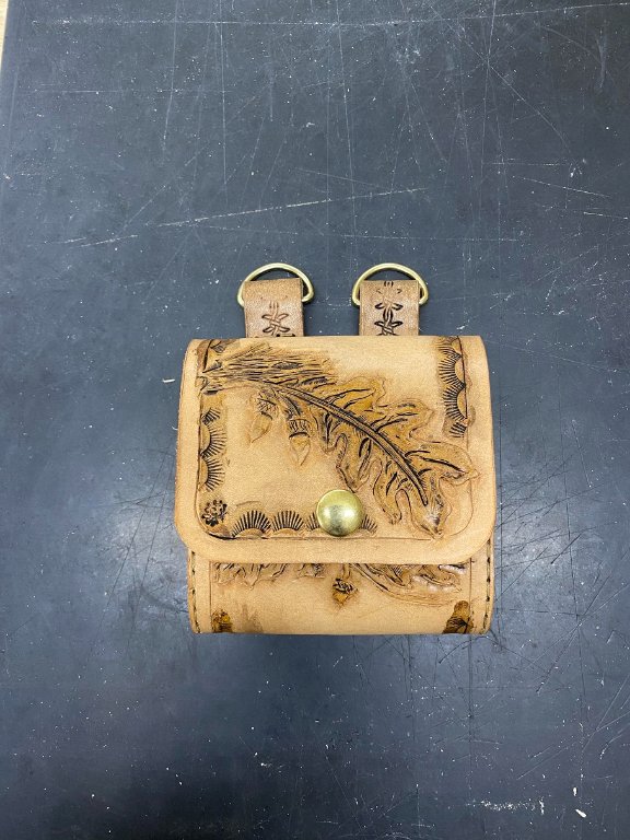

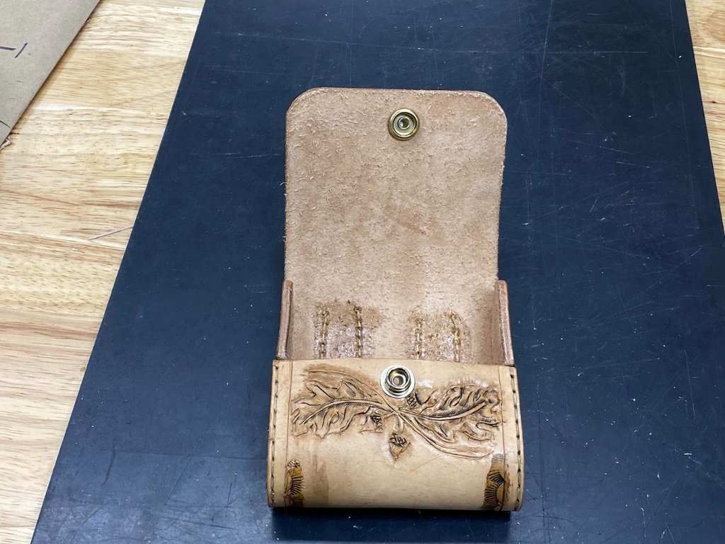

The very last pucker factor here was adding the top half of the snap, but that went well also, and I'm done. Except for waxing or adding leather sheen, that finish that gives those leather holsters that shiny look. I'll let the one who is to receive it decide.
47 done.jpg (102.07 KiB) Viewed 9193 times

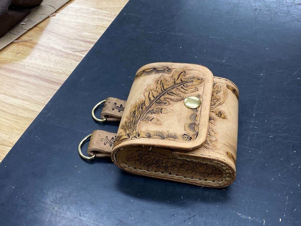

A side view:
48 side view.jpg (153.46 KiB) Viewed 9193 times
One with it open:
I was really happy as this is an original design and it turned out exactly as planned. I can and will tweek future builds as I do with every design. Each one gets minor changes. (Which don't always turn out to be improvements.) :roll: But, that's just the way we are... gotta tweek stuff.
I think it will work. If it dies later. I'll build her another.
