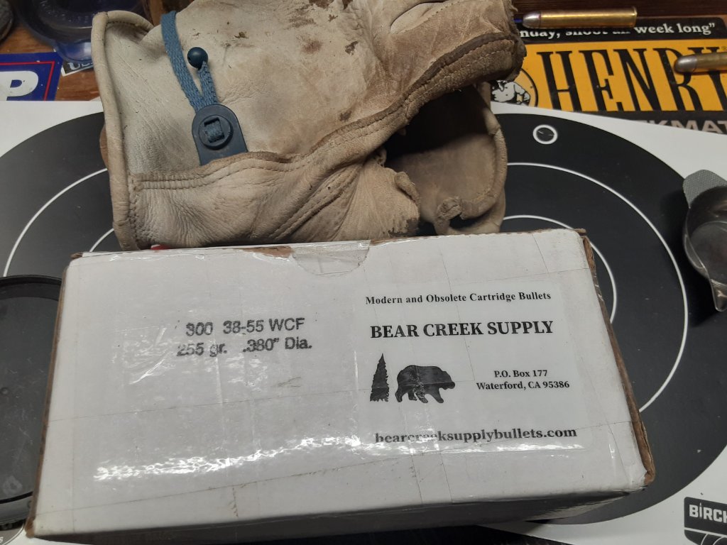

Just got home and these were sitting on the porch.
Will be loading a few later this evening.

Dang Vaquero, those are some working man gloves there !
Posts: 12158
Post by Vaquero » Thu Jul 08, 2021 8:03 pm
They do see a good bit of use, then double as my ridin gloves.👍

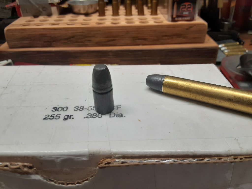

I wanna see one of them bullets otta the box

I loaded 5 with the 26.0 grs of Rel 7 and another 5 with 15.0 grs of 2400. That is one of the recommended loads the previous owner had good luck with.
Here's your pic.
Post by BigAl52 » Thu Jul 08, 2021 9:47 pm
Sounds good and thats a good looking bullet. I will be awaiting your results.

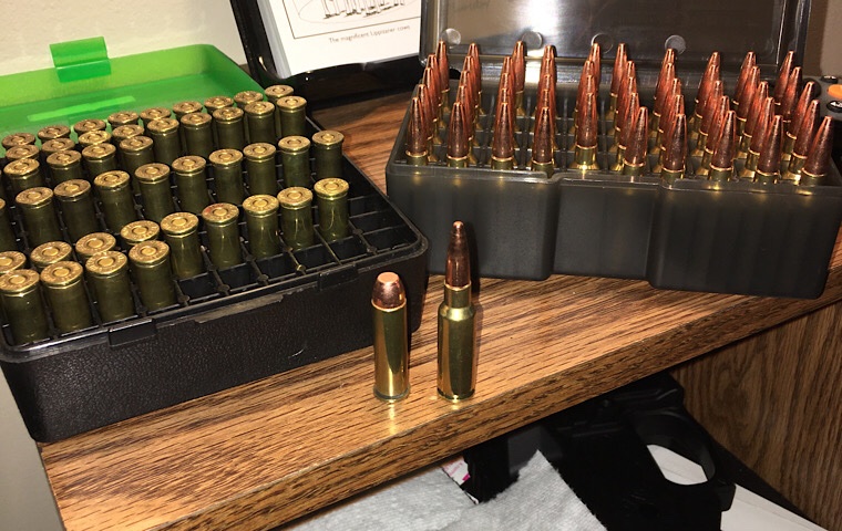

Two new ones for me. I have only shot 158 grain in my 357s’. In looking for a lighter load for the Ruger, I figured why not the 125? I did 3 different levels of W296. Minimum was around 12. Max was 20+. Loaded 12, 15 and 20. That 20+ gives 2000+ FPS.
The other, my new passion, is 6.5 Grendel. I have loaded mid range to become familiar with the rifle. I’ve done my function shooting and am ready to get down to it. I expect these rounds to fly just over 2000 FPS. At max load, this 16” barrel will only get 2500 or so. Quite serviceable.
Will be out to shoot soon.
