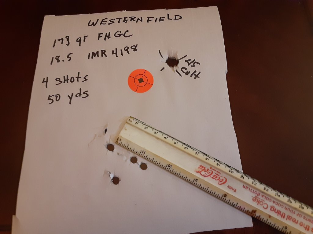

Hey oldbrass, that load wasn't very popular with the girls. The '66 Winchester like it best, and the '75 Marlin came in second, and the scoped Westerfield next.
When I was pulling the rifles out of the safe, the Ranger had a nylon shellholder on it with 4 cast loads.
Not knowing what they were I tore one down, looks like 18.5 grs IMR 4198.
Not bad with the scoped one. Definitely a good starting point.

That's some fine shootin' Vaquero, I'd take that seven days a week and twice on Sunday

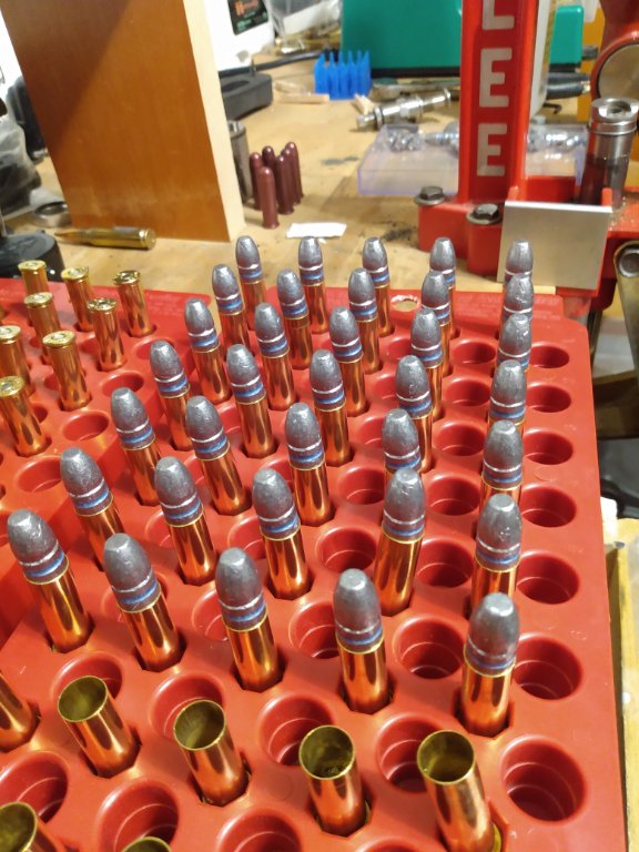

Stuffing some lead 158gr RNFP (round nose flat point) into 38 special cases over 4.5 gr unique.

Love the 158 grain for the .38 OB, I drop Bullseye or HS-6 (HS-6 the most consistent). Looking Good !

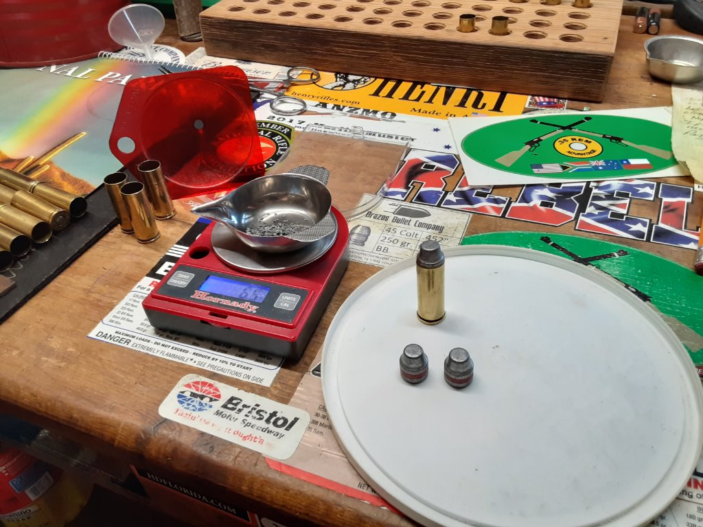

Just finished 107 45 colts, last of the clean ones.
There are about 2 dozen from the other afternoon that need cleaning.
These I loaded with 6.5 grs Red dot and some 190 gr swc. The bullets were free, a friend gave them to me year before last.
Nice little plinkers for the back deck. ;)

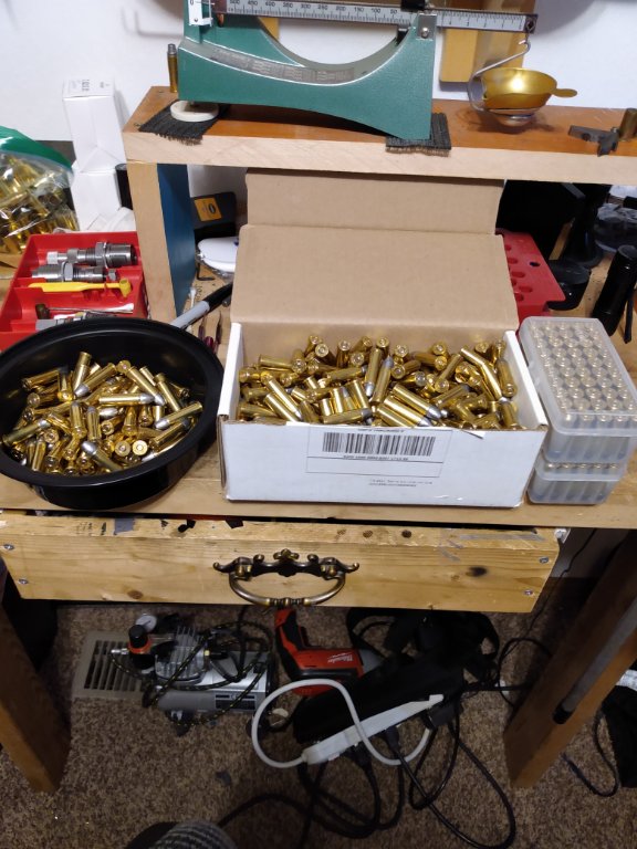

Just finished running 500 more 38 special thru the crimp die. Wish I had some more storage boxes.

Yeah, I’m running out of storage boxes too. Cleaned and prepped another 100 cases. Sized, belled and primed.
I ordered a batch of 125 grain plated flat point bullets. Trying something new to me. Looking for that elusive 2000 FPS round. Not a hunting load, just for fun. Paying $.15 each for bullets is annoying.
Everglades bullets providing the little fun pellets.
