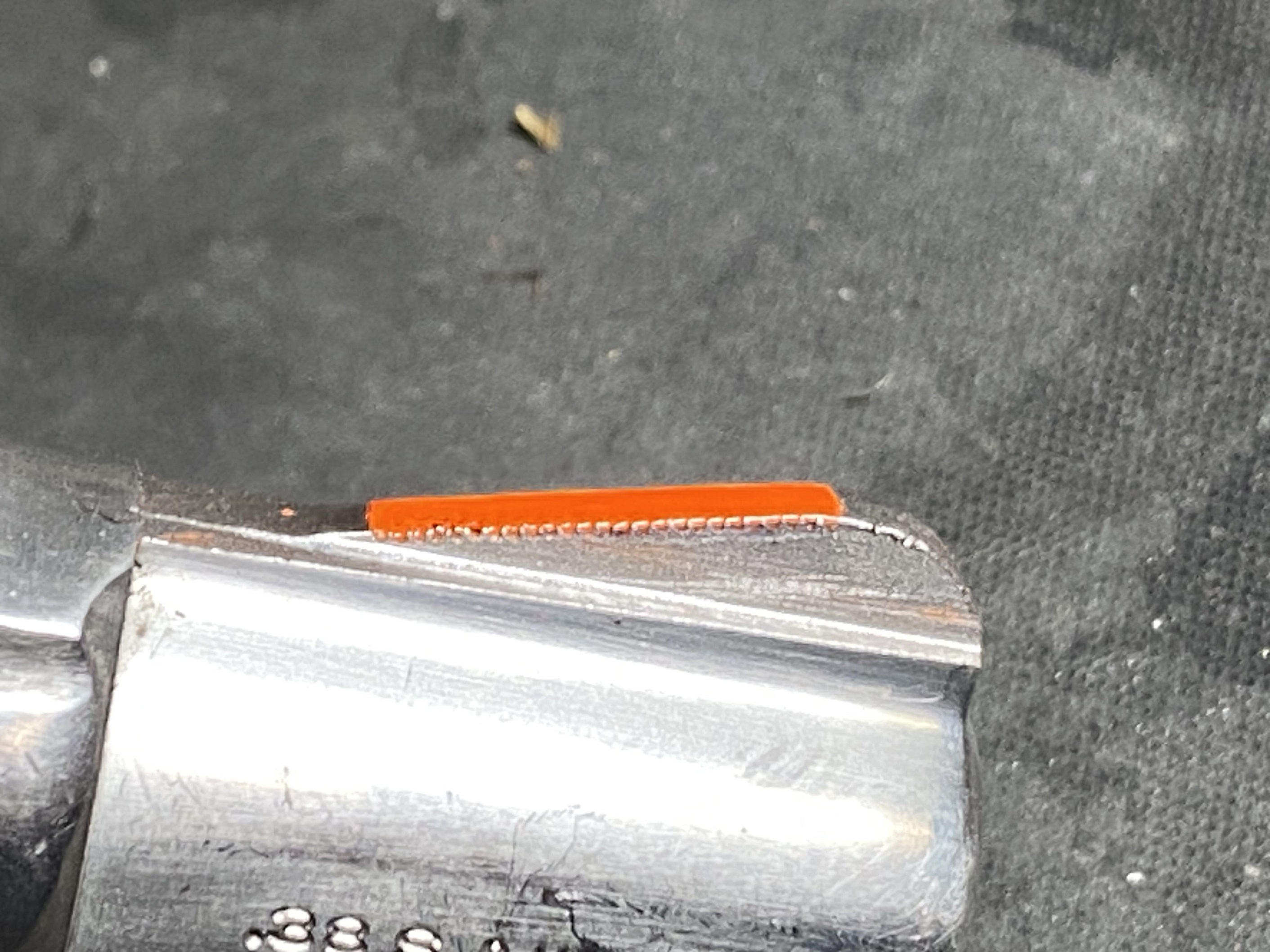

I painted the two extra coats on the front sight. It's started to look bright. After I clean up the edges when this dries, I'll put two coats of clear polish on it and call it good. I'll see how I shoot at 7 and 10 yards today. I'll add another revolver to the mix and shoot that at 10 and 15 yards. Longer barrel. 8-)

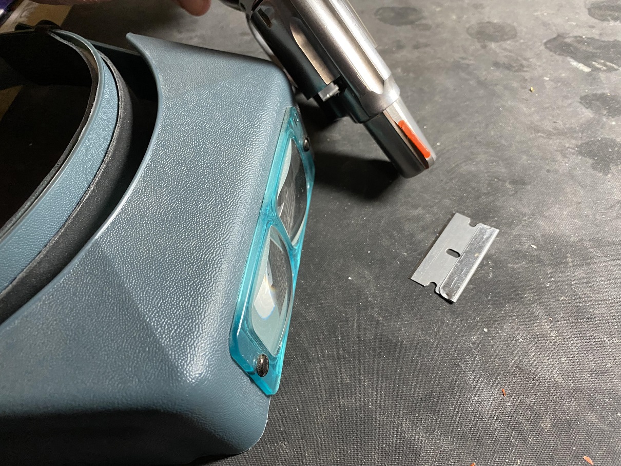

Time to clean up the front sight in preparation for the final coat of clear polish. In recognition of old eyes, the clean up kit will consist of my Opti-visor and a razor blade. This is the gunsmithing (Okay, armorer's,) visor... HIGH magnification. Tina always laughs because the focal length is about FOUR inches. :lol:

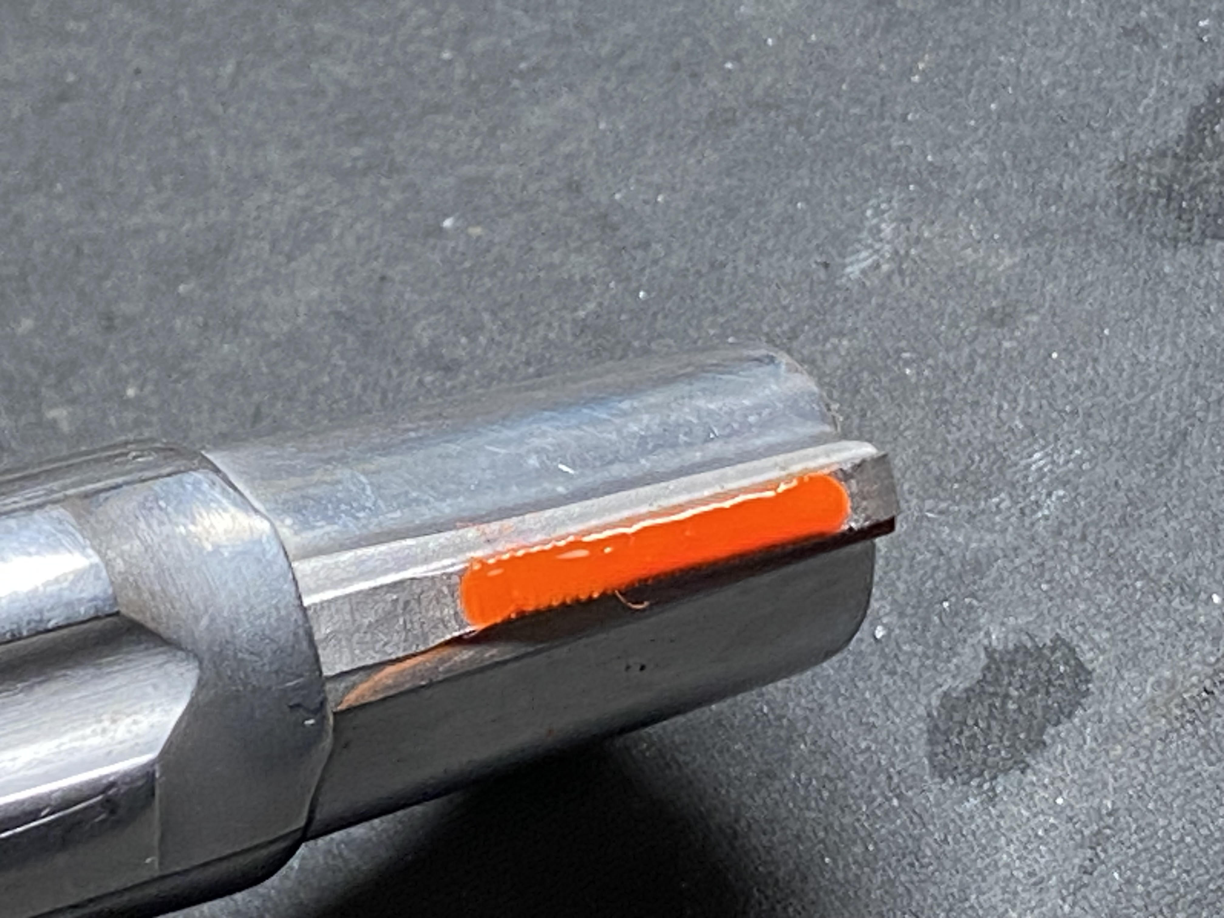

Using the visor and the razor blade, I am able to square up both ends of the orange stripe on the top of the sight and clean up the sides. I also used a nail file with a piece of Emory Paper held against it to clean up any scratches on the side of the sight. There were a couple light ones.

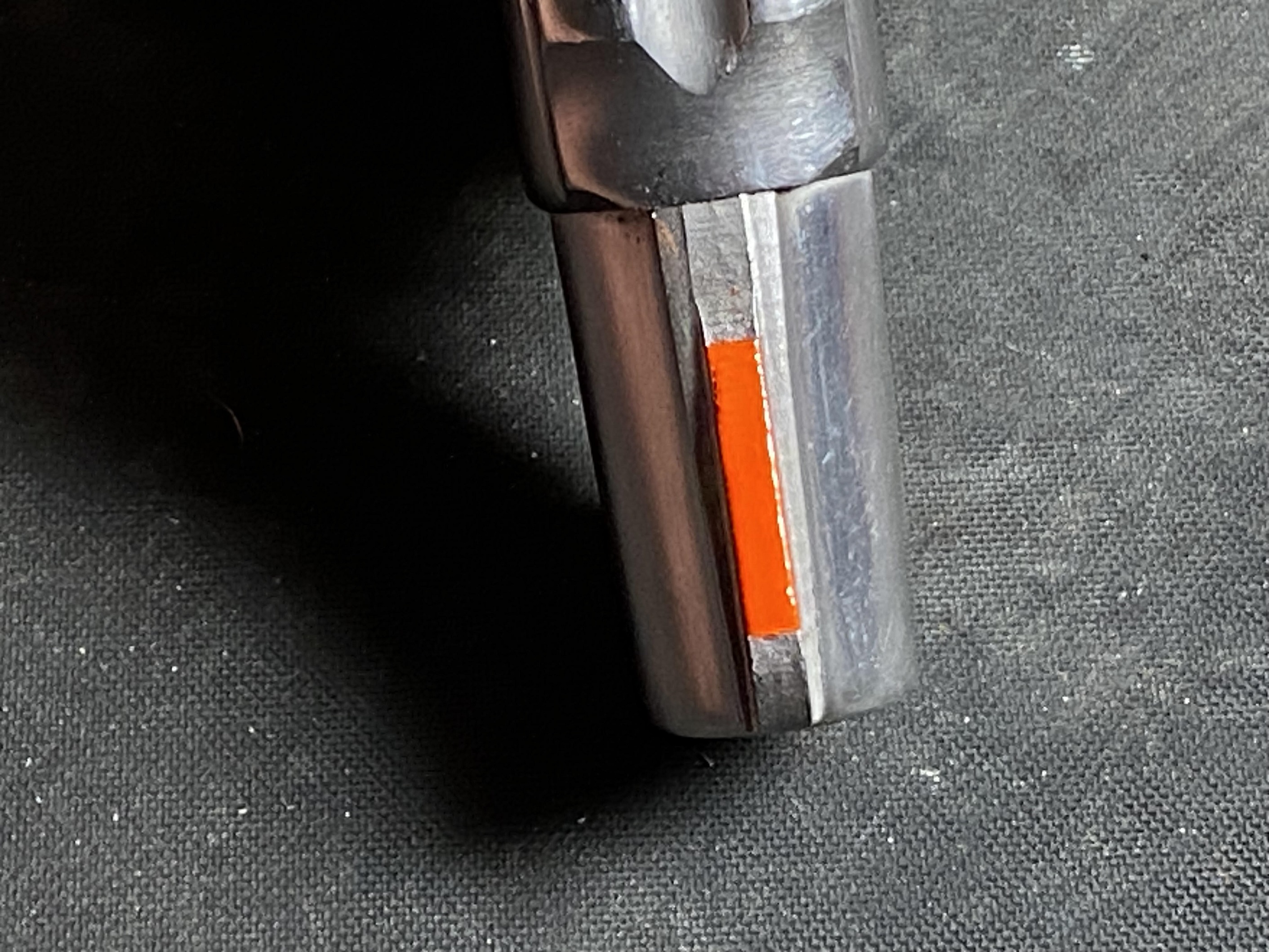

Painted on the final coat of Clear Polish, and we are good to go this afternoon when I slip back out to the range. I am looking forward to it. I will find out if it was the sights, or if I was "milking my grip."
