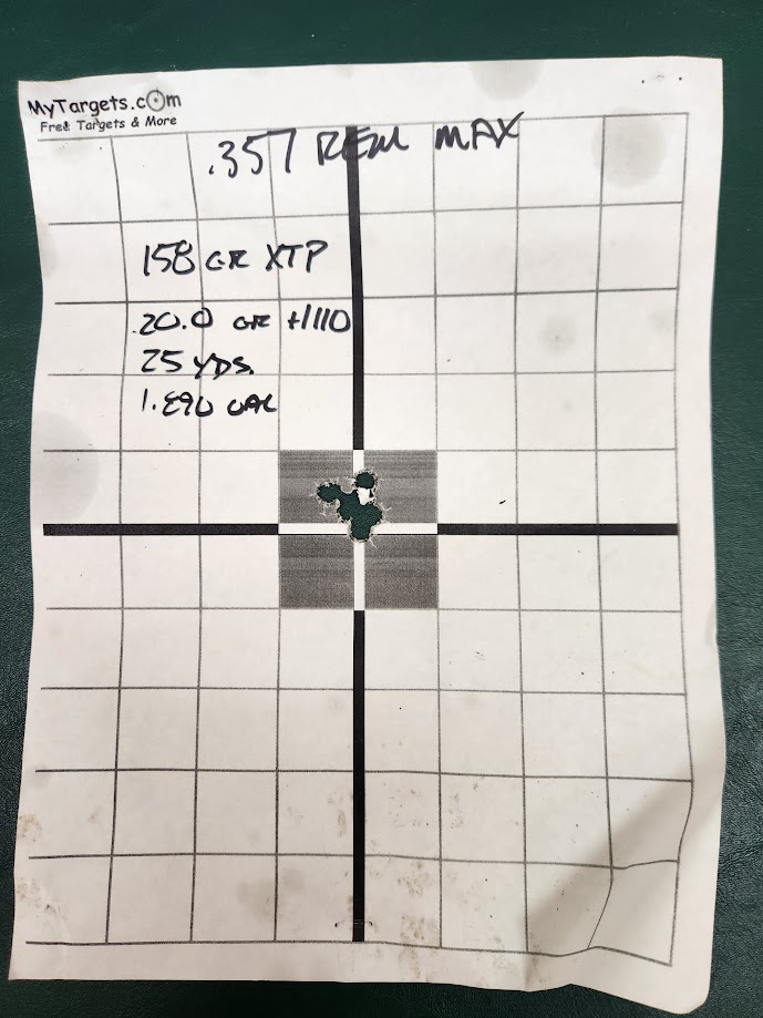

Working up some loads:

It looks like you're off to good start!! Was it easy to find brass?

Holey Schmoley, that's one hot load! I load 6 grains less Lil Gun for my 158 XTP FP and that is a stout load for .357 Mag. The rifle sure likes it though.
I'd be interested to see what that does at a little further distance, and if you hunt, how that works on game.

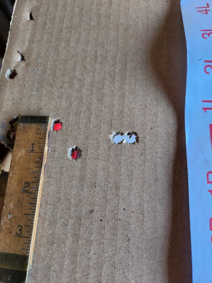

158 Grain Hornady XTP w/ 28.0 gr Lil' Gun (wanked the last shot to the upper right)

100 yard test w/ 158 Grain XTP w/ 28.0 gr Lil'Gun ( group was ~2 inches X ~1 inch)
10 shot average muzzle velocity 2488

180 Grain XTP w/ 25.0 gr Lil' Gun at 100 yards. 2258 f/s average 2 inch group

First 3 almost the same hole at 100 yards. Last two a bit higher (barrel was getting warm). I think I can live with this load. Will fine tune scope adjustment closer to deer season.
