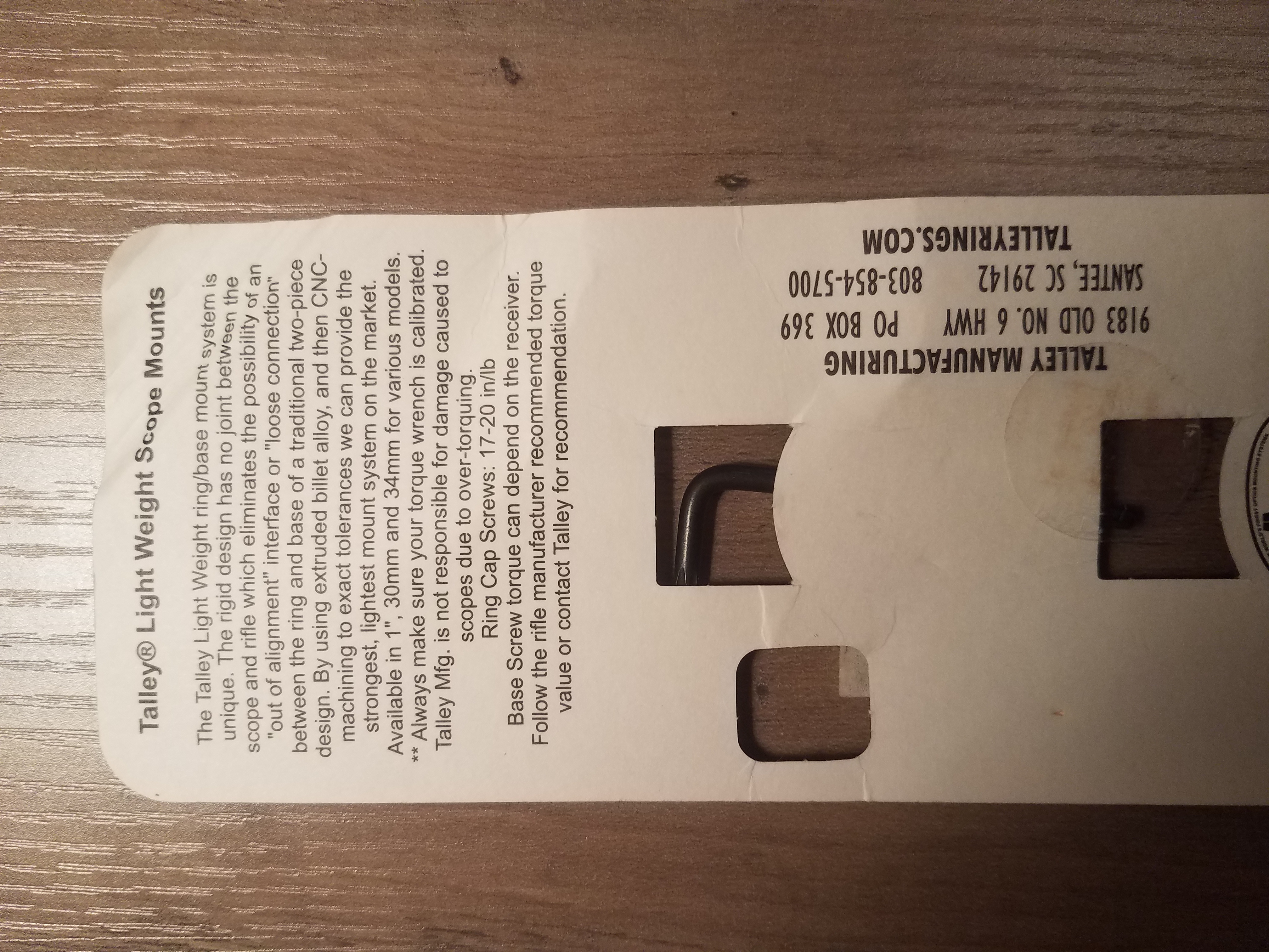

Oh wow, Don't have my notes in front of me right now, however, if memory serves me correctly, I think I went 15 to 18 inch lbs. and used purple locktite. I bought and used a Wheeler Fat Wrench driver and have not had to re-adjust since. I will re-post if I discover I'm wrong. Sorry FP, I know this might not help given that I'm unsure, but I think those are the specs I used. I do remember though that the ring cap screws were recommended by Talley to be at 17 to 20 inch lbs. I just confirmed that. The torque on the base is per gun mfr. recommended specs which is how I arrived at the 15 to 18 inch lbs. I believe that is what Henry told me. One can always go tighter, however, overtightening can result in a stripped receiver...
Posts: 8545
Re: Big Boy Base Ring and Base Set
Post by Mags » Tue Jan 31, 2023 1:38 am
I used the values that were on the instruction sheet that came with my bases.
