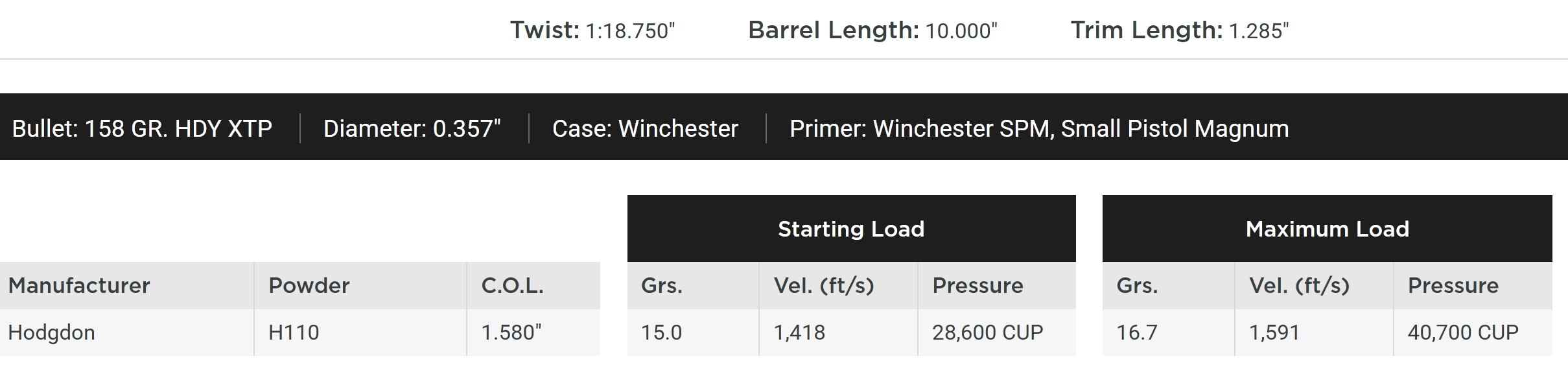

The online Hodgdon reload center lists this in a 10" barrel.
Screenshot 2025-09-28 092400.png (98.62 KiB) Viewed 1709 times

Yep, that is pretty much what the book says. Lyman 16.3 grains 1178 fps. Nosler 14.9 1460 fps. Hornandy 15.6 1250 fps. I will load some starting around 14.0 and see what I get. Just thought I would ask if anyone had any experience with H110 using 158 gr bullets In 357 mag.

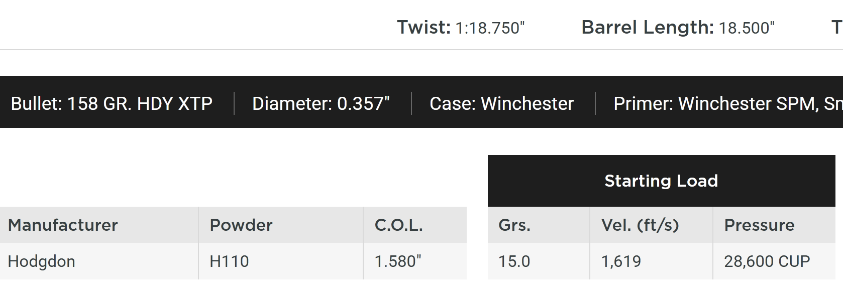

I bet one is gor pistol le gth barrels ie the 10" and the other is carbine length

I bet one is for pistol length barrels ie the 10" and the other is carbine length
The fps is quite a bit higher for carbine 18.5".
Screenshot 2025-09-28 092039.png (73.23 KiB) Viewed 1684 times

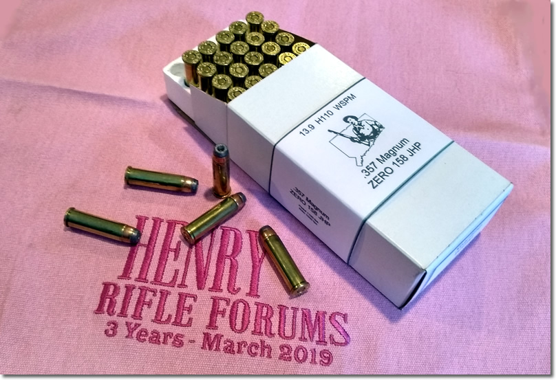

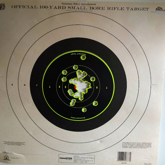

Early in my shooting career (scant more than a decade ago), I looked for a single load that I could use in both my Big Boy and my SmokeWagon revolver. I'm just a plinker, so my only considerations were that it worked well in both guns and was accurate. Since then I've shot a few thousand of them. It's a mild load by anybody's standards, but I don't want to beat up the guns or myself. I just want to have fun shooting. It's accurate in my Big Boy out to 50 yds.
13.9 grains of H110 / 158 grain jsp or jhp bullet (Zero).

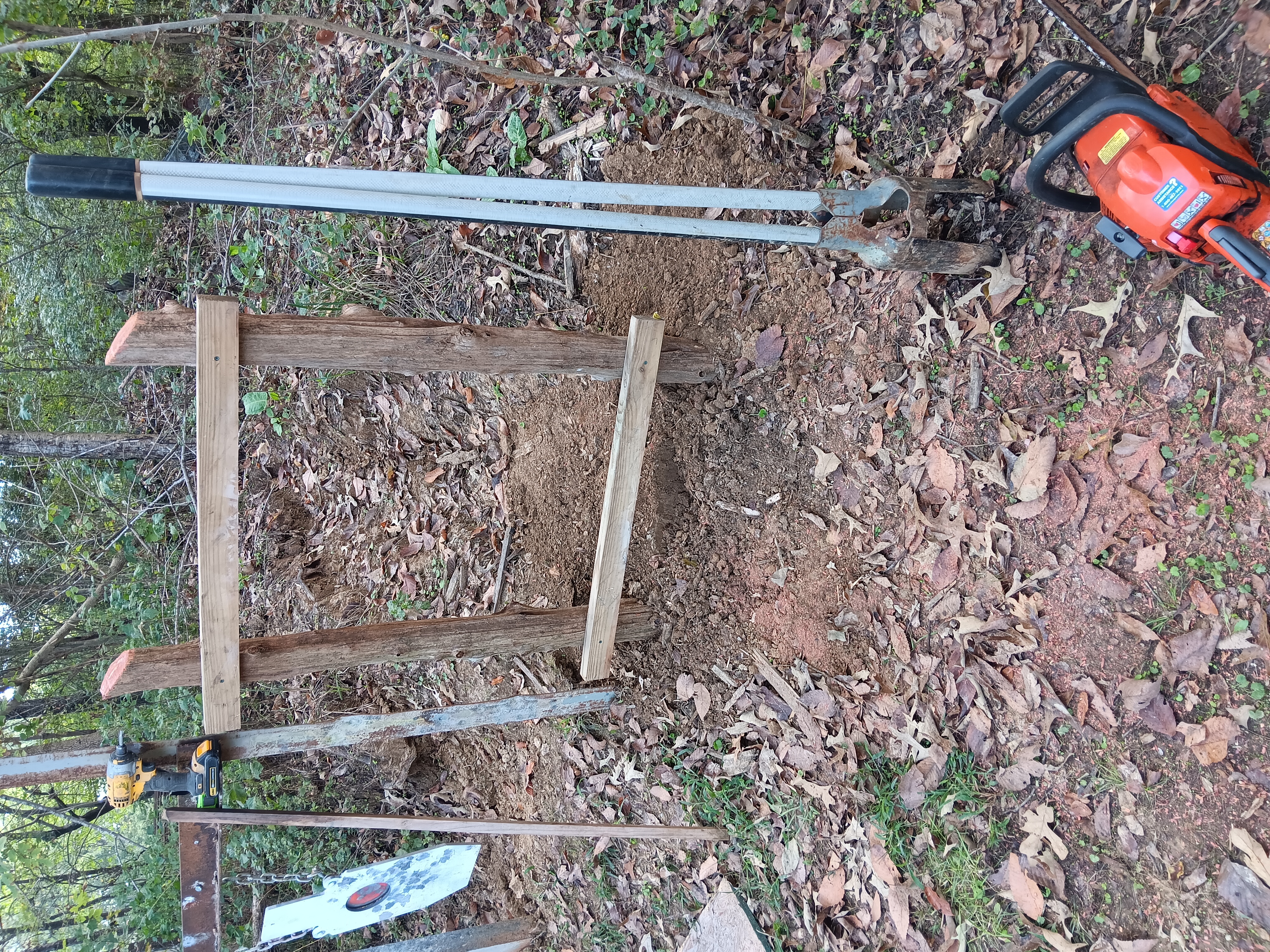

Worked on a new target stand this morning for just such things... 8-)
[attachment=0]20251002_092903.jpg[/attachment]
